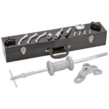

After fighting the hub assembly with the slide hammer for a good hour, it finally came off the axle. Now, the problem is this. The axle had been clicking for a week now, I found out why when I started working. The shaft came apart. The boot that is inserted into the differential is stuck in place and the rest of the axle is out. I ran out of time and ideas so I put the wheel back together so that I could at least roll the thing. I've essentially got a 3 wheel drive truck right now.
