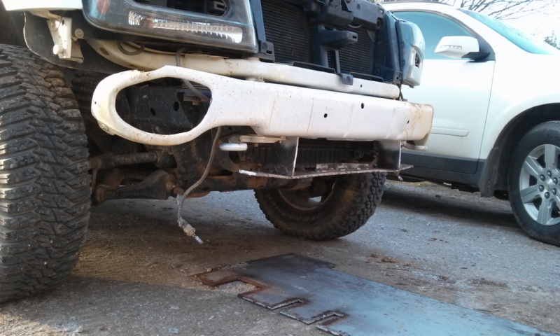

Recycled 1/4 inch plate.
Bridge is welded to bumper, hidden by bumper cover.
Plate is bolted to bridge at front, MDB oil pan skid at rear.

I like the diamond plate look. Do you have any finished pics? (I'm assuming it wasn't done by the jack and chunk of concrete holding it up.)
by BWGuy » Fri Feb 28, 2014 8:26 pm
Actually, the jack and the block were just a simulated obstacle to test the strength of the skid. I was aiming for something that would support the weight of the front end, static anyways. I reckon I might spray it black at some point, but except for that or any repairs that might be needed at some point, it's done.

by BWGuy » Sat Mar 01, 2014 11:37 am
Just a couple more pics without stuff in the way...
If i were doing this again, I probably would have just cut the front ears into the plate rather than weld on separate pieces lke I did, but that would have been just a little less fun.
The red bolts attaching the piece are recycled from my 2000 Saturn L100 (Special Edition).
