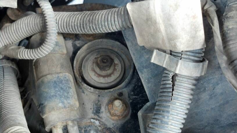

by Trail X » Mon Apr 01, 2013 12:50 pm
The Roadie wrote:Can you throw up a picture of your upper bushing, washer, and top nut? Perhaps you ARE a pavement puss after all. Or BDS had a bad batch of poly bushings and you got good ones.
Left and right attached. They have held up well... not sure what else to say about it.

by NC_IslandRunner » Mon Apr 01, 2013 5:50 pm
Mine have been installed for 3.5yrs and look like James. I must have got some of the ones they accidentally made good also.
by mikekey » Mon Apr 01, 2013 5:57 pm
Maybe there is a connection. I'd be curious to know how old each of the ones that failed are. Mine where installed back in June or so I think.
by djthumper » Mon Apr 01, 2013 6:07 pm
I wouldn't just go by age but the springs that are being used...
by 06MidnightBlue » Mon Apr 01, 2013 7:41 pm
djthumper wrote:I wouldn't just go by age but the springs that are being used...
True. The added pressure by the spring can put extra stress on the mounts.
06MidnightBlue
Posts: 597
Location: CA, Sacramento
by mikekey » Mon Apr 01, 2013 7:54 pm
I have stock springs. Can they possibly be adding more pressure than those with 88's and 89s?
by djthumper » Mon Apr 01, 2013 8:38 pm
Not likely but others have bumped up their spring sizes as well... So it would not hurt to add that to the data collected. Having a little extra data for analyst doesn't hurt.
by jonbo2002 » Tue Apr 02, 2013 12:34 pm
I might get kicked out of the room for this, but are you maybe over torquing the nut onto the bushing? I just know I am famous for over tightening things and it comming back to bite me later.
jonbo2002
Posts: 509
Location: MI, Springport
by Trail X » Tue Apr 02, 2013 12:40 pm
If it's assembled properly you can't really over tighten them. There is a metal sleeve that limits how far you can tighten the top strut nut.
by jonbo2002 » Tue Apr 02, 2013 3:30 pm
JamesDowning wrote:If it's assembled properly you can't really over tighten them. There is a metal sleeve that limits how far you can tighten the top strut nut.
ok got ya sorry, I was just going off my own (Captain Distructo) problems I have made for myself with other thing. I haven't done Struts as of yet so I wasn't sure if this was the case.
jonbo2002
Posts: 509
by navigator » Tue Apr 02, 2013 9:28 pm
I think in some cases folks have problems by not tightening the nuts enough.
