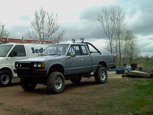

Personally, I don't want a strictly on road truck but I don't need a total trail rig either. The lift isn't cosmetic, it will be enough to get a set of real tires under it and make the truck capable of going where I go. More lift than what your tire needs is a waste IMHO because it just raises your center of gravity but your axles clearances are not any better, no good for a on road or trail truck. Right now I think a longer front springs with the same spring rate as factory sounds perfect for the direction Im going with room to grow. Added spring rate in the rear will help with my towing. Heres a couple pictures of my old Nissan IFS, it was fun but I broke front end parts more than my solid axle trucks so I'm keeping the trailblazer modest. To each their own :cheers:
