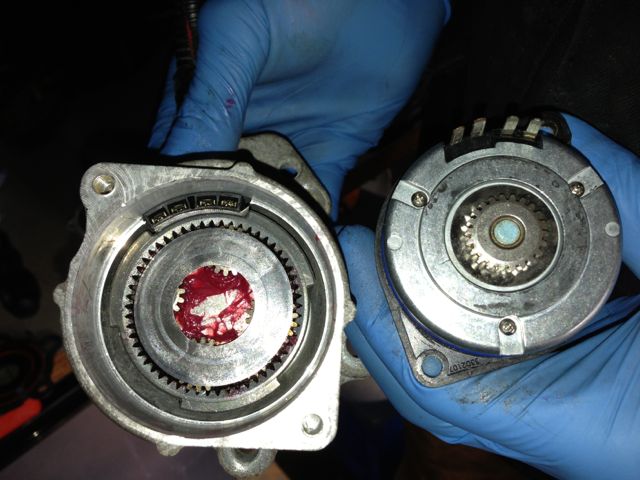

Since I had the suspicion that it was the EM, I removed it today to take a closer look. I will assume that everyone up to this point can successfully get the EM off the TC. I didn't take any pics of that part. It's very easy, 4 bolts, and the wire harness, and is very openly accessible from the mid undercarriage area. I removed the EM, and because it was under a load, when I pulled it off the TC, there was excess torque stored, and it subsequently put the TC into neutral. I would suggest while you have the EM off, cycle through the 4WD switch, and ensure that the motor turns. This will be easily identified by the gear at the flush end moving slightly.
Once off the TC, the rest is rather simple. There is a plastic/rubber gasket that is on the front, which can be removed by some set clips that must be unclipped. This appears to be a reusable gasket.
See Picture #1
Picture #1

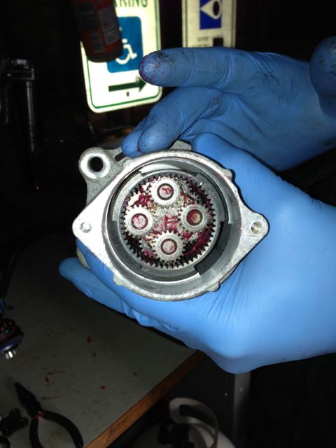

Next step is to remove the cylindrical cover that houses the actual motor. This has two torx screws. THis cover should pop off of a blue O-ring. THere may be some resistance, as the cover is lined with 4 magnets for the motor. You can now pry at the seam of the motor, and remove it from the planetary gear set. The motor itself is plugged into the power cable housed in the inner wall of the gear sets. Pull the motor off until it unplugs, at this point the plug is the only thing securing it in the housing. Once removed, there will be a thin thrust washer that lays on top of the gears, remove and set aside.
See Picture #2
Picture #2
At this point, you can see inside the planetary gear set-up. There are 4 sets of reduction gear, ranging from small at the top, to big at the bottom. These are easy to remove, as they are stacked in order of size. As you can see, for all 4 layers of gears, there are 4 gears, and one plate that they all sit on, on a post. Beneath this plate, is another fixed gear that sits inside the next stack of 4 below it. This will be become more clear once you open it up. Keep all 4 sets of gears/plates set aside once you remove them.
See Picture #3
Picture #3
While taking the gear sets out, you should be able to see whether or not there is something wrong/broken/cracked, or otherwise keeping the innards from moving. In my case, everything moved as it should have, all the way down to the base gear. I put a little bit of grease back on each layer, and reassembled in reverse order.
