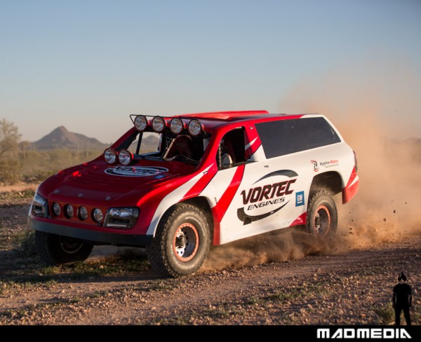

by Trailblazin Ahead » Thu Feb 04, 2016 10:17 pm
Anybody remember Larry Ragland. Oh prerunner Trailblazer. Baja winner in his Trailblazer
