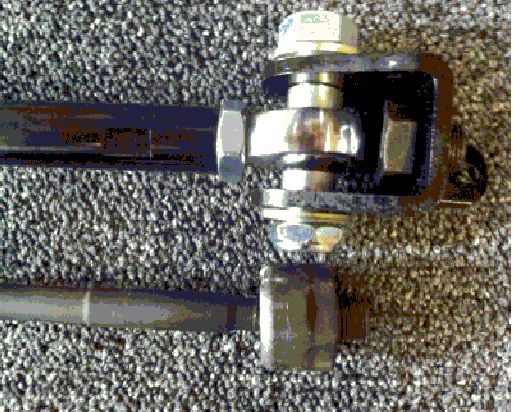

by Lauron » Tue Sep 25, 2012 12:56 am
After reversing the UCAs, I found the TB to be very squirely. This was extreme with the worn out(soft) front shocks I had. Side winds would be a really fight even with stock tires. The new shocks made this tolerable but the initial experience caused me to investigate. When I removed the old front shock, I cycled the front suspension and found significant toe in on compression and toe out on extension. This was after an alignment.
My observation as to why this is happening: the UCA flipped moves the ball joint slightly farther outside which caused positive camber in my case. The alignment correction, pushing the lower control arm out, needing a significant lengthening of the tie rod to get camber in spec.
I tried moving the steering rack lower, by removing a rack bolt. This did not help. When I loosened the inner tie rod end leaving one thread engaged in the rack, I got an improvement. This pushed the pivot point out about 1/4". So my conclusion is the inner tie rod pivot point needs to be moved out board to compensate for the LCA being farther out. Anyone else observed this?

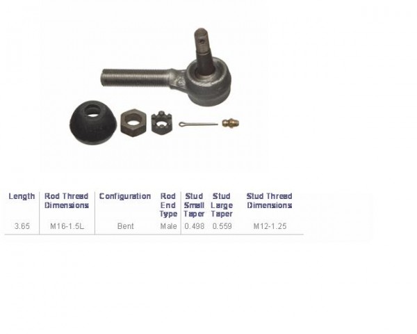

A possible solution: an adjustable inner tied rod end. The inner tied rod end screws into the steering rack with a 18 mm x 1.5 mm pitch thread. I propose to use a matching 18 mm female clevis attached to the steering rack with an 18 mm stud. Stud length to be determined. The attached FRP example is a poor boy example but I propose to use a solid clevis The clevis, unless something is available, would be custom to match the heim. To strengthen the tie rod, I would bump the rod size to 16 mm expecting to match up a male heim with a male outer tie rod end through an adjustable straight tube with weld in left and right hand thread tube adapters. I was looking for something like the attached Moog end to match our spindle.
I followed the tie rod mod using the 2500HD outer noting the taper difference.
James Downing measured and calculated the taper sizes.
"Your numbers show the 2500 as a 6.2 degree taper, stock to be 8.6 degree taper, and the heim conversion to be 7.1 degrees."
So the problem is finding out the actual dimensions of a suitable short outer end. The Moog spec only gives you part info. Anybody else have a source for the tie rod end dimensions or has some one identified a short 16 mm outer that matches our spindle with or without the need to reamer the spindle?
Thanks,
Ron

by Trail X » Tue Sep 25, 2012 8:49 am
Interesting... so your theory is that there is significant enough of a difference between the locations of the tie rod inner joint and the lower control arm inner joint that it creates significant roll steer?
I'll be honest, I have my UCAs flipped, and I've never really had any complaints, but I do agree that mine doesn't track great in heavy crosswinds.
Anyways, the basis of your solution is in extending the inner ball joint pivot point away from the rack, right?
As for outer tie rod ends, we've found that the full size tapers are not significantly different than ours, and can bolt right up without issue.
