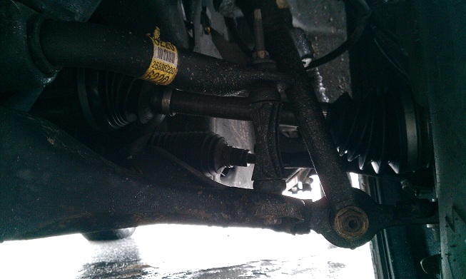

by mk3smitty » Thu Jan 12, 2012 4:41 pm
just got my truck back from the dealer they said for me to take the lift off because it is causing the angle of the axle to be to much which will cause my front dif to go out agin. while driving it this morning i noticed it to be a little stuf in the front end i put it in 4wd because there its snow everywhere up here and had a little vibration in my front end i have never noticed this before also a little bit of binding when i turn while backing up but i thank thats just from turning a little to much i have pics i thank i am just gonna get a dif lift and roll with that

by Trail X » Thu Jan 12, 2012 5:08 pm
I have the equivalent to about 3.5" or 4" up front, and I don't have any binding issues.
What is the stiffness from? Do you mean steering-wise?
Your axles don't appear to be overly stressed.
What lift do you have? How is it designed? It may be allowing your suspension to unload too far, into dangerous territory.

by Trail X » Thu Jan 12, 2012 5:20 pm
The ready lift design (outside the strut) as a 3" lift, could be dangerous for your parts. Can you get a height measurement of the spacer itself?
However 'ready lift' markets their units as 2", and I believe some people have tried them out without much issue.
You can easily tell if you have too much lift by lifting either tire off the ground by the frame, and trying to spin it by hand (in 2WD).
