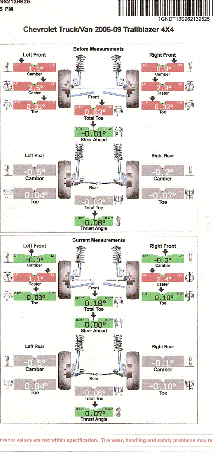

v7guy wrote:03envoy wrote:Hello, I will be getting marks 3 in kit soon and I plan flip the UCA's but what do you torque them too? How many foot pounds? Not sure if needed but just thought I would ask. Thank you! Also, What amount of spacers could I add without getting near putting the CV in a binding situation? Maybe 3? Thanks again,
Trent
Of all the issues, caster is the least important to tire wear. Too much positive caster (that you have) contributes to a heavy steering feeling and possible bump steer. You're a heavy SUV. That isn't an issue. I would trade my camber issue for your caster specs in a minute.navigator wrote:Only the caster was out when they finished ...
