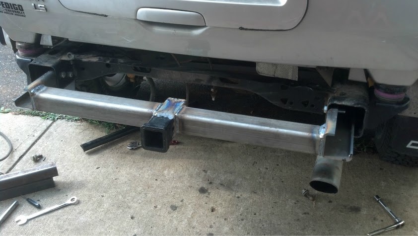

I will be basing most of this from Barton's build of the 3" BL rear, which . Of course, it wont be exactly the same, mostly because my fabrication skill level is about 0.07% of sir Bartons. I'm going to be building a single swing type as opposed to the dual swing design since it will be easier to build. So far I've got the bumper's frame welded up, and that includes mounting rails (3x3x3/8" angle), mounting nuts tacked on, main cross-tube (3x3x1/4" square tube), and the receiver tube. I added a fourth mounting bolt on the bottom of each frame rail for piece of mind. So, with (2x) 3/8" brackets each mounted with (4x) grade8 5/8" hardware, I don't think its going anywhere. Oh, don't forget the loctite! Also, I followed Mikes shackle mount process detailed for welding these main structural assets of the bumper. As it stands, this should be a class IV receiver.

by Trail X » Sun Jan 21, 2018 1:07 am
Looking forward to seeing this take shape. The start and the finish are generally the longest, so I expect to see some good progress here soon. What's your plan for the swing arm. Spindle, or heims?

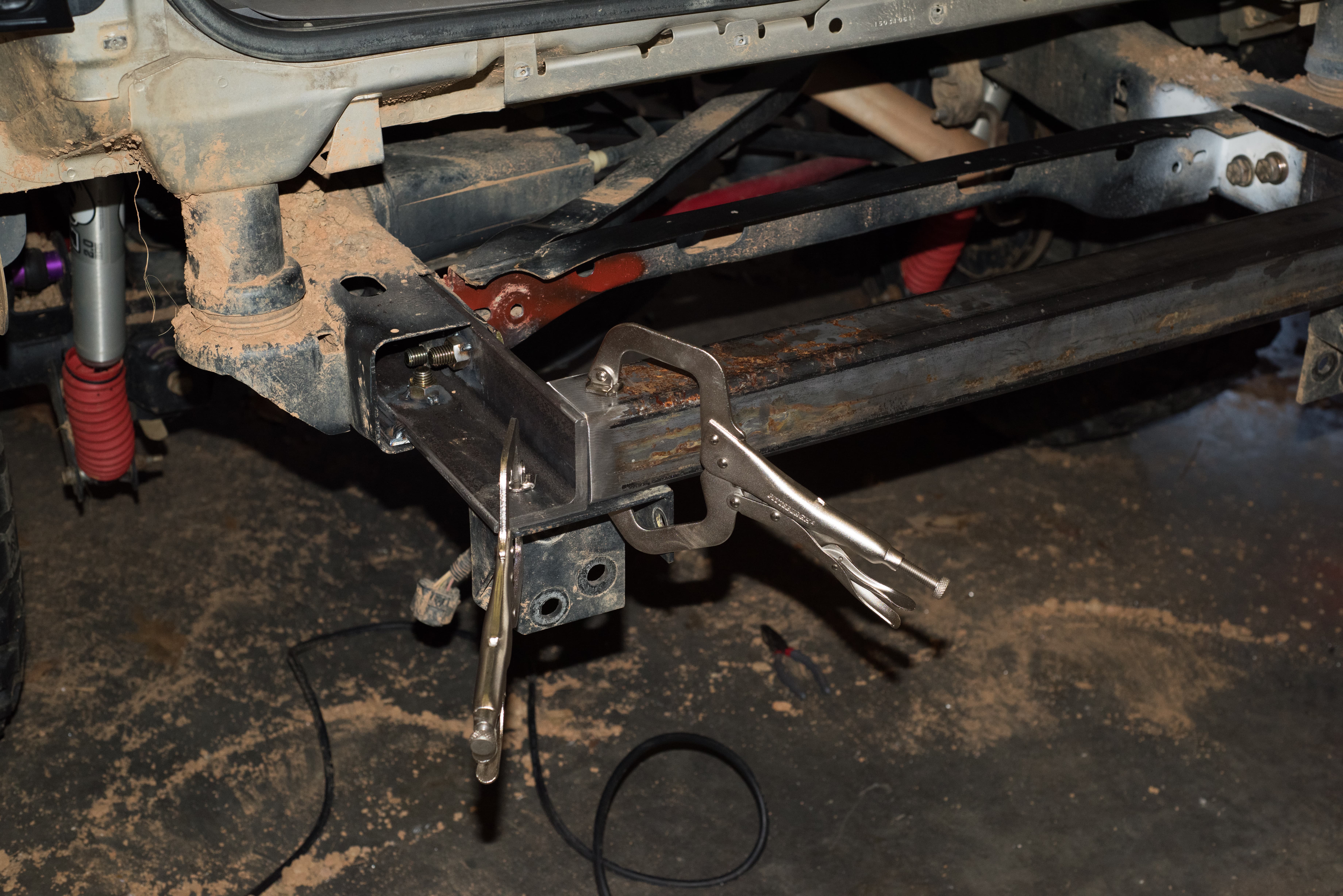

by mason10198 » Wed Jan 31, 2018 3:53 pm
Bit of progress from this past weekend. Still taking measurements here and there and figuring out angles to get the main body together. Attempting to add to the Fusion model as well.ImageImageImageImageImage
