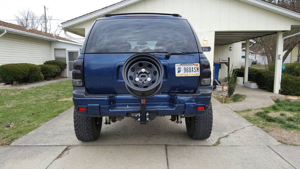

*Exterior: Mark's 3" body lift. 03-07 Silverado tow mirrors wired for a trailblazer for added visibility, switched out with stock when not towing. MDBFAB skid plates, and Mike's 3" body lift winch bumper with Tuffstuff4x4 10k econ winch mounted to it. Also added flexyflares and built a custom made fold down tire carrier for my spare 35x12.50r15s.
