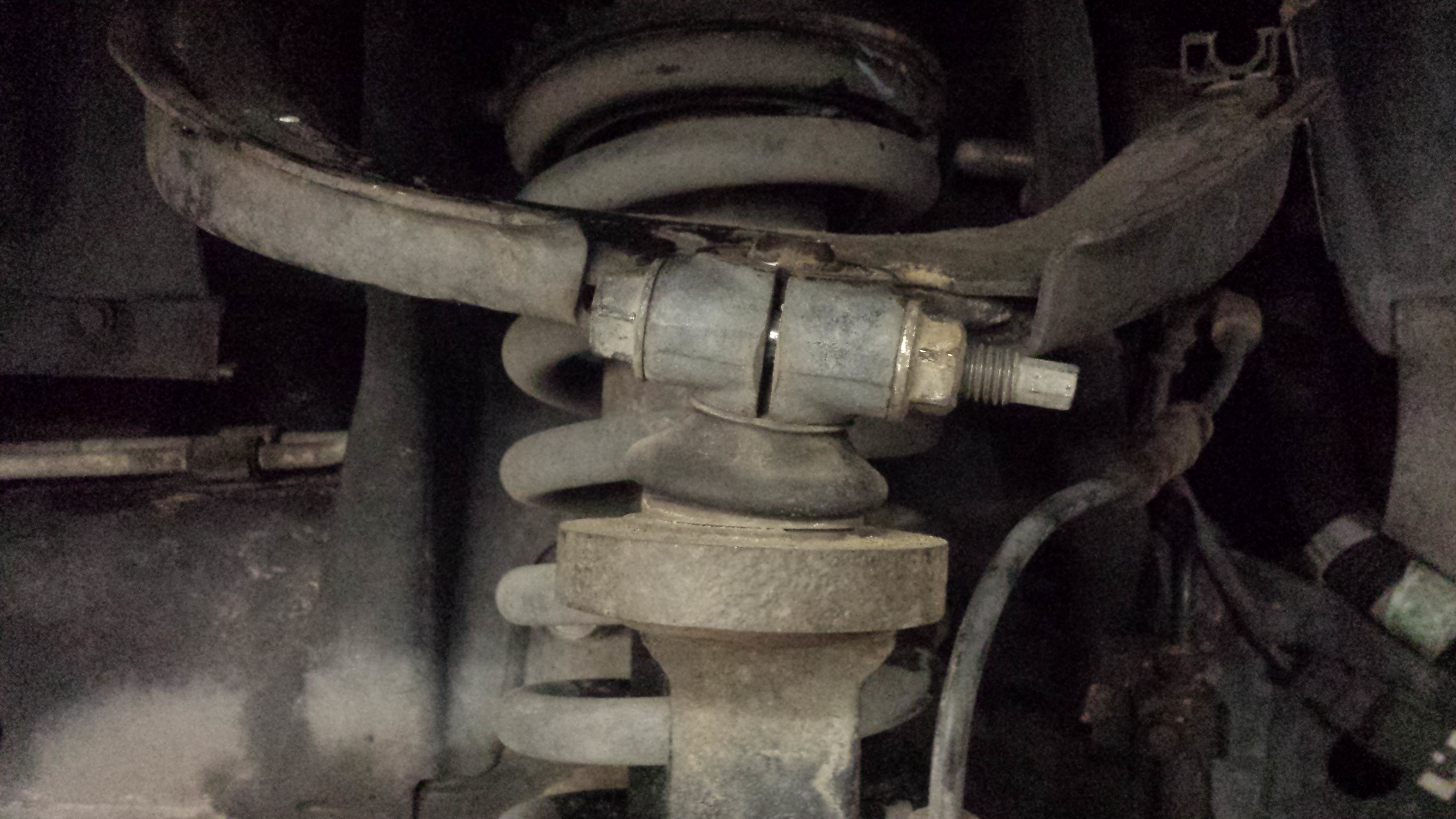

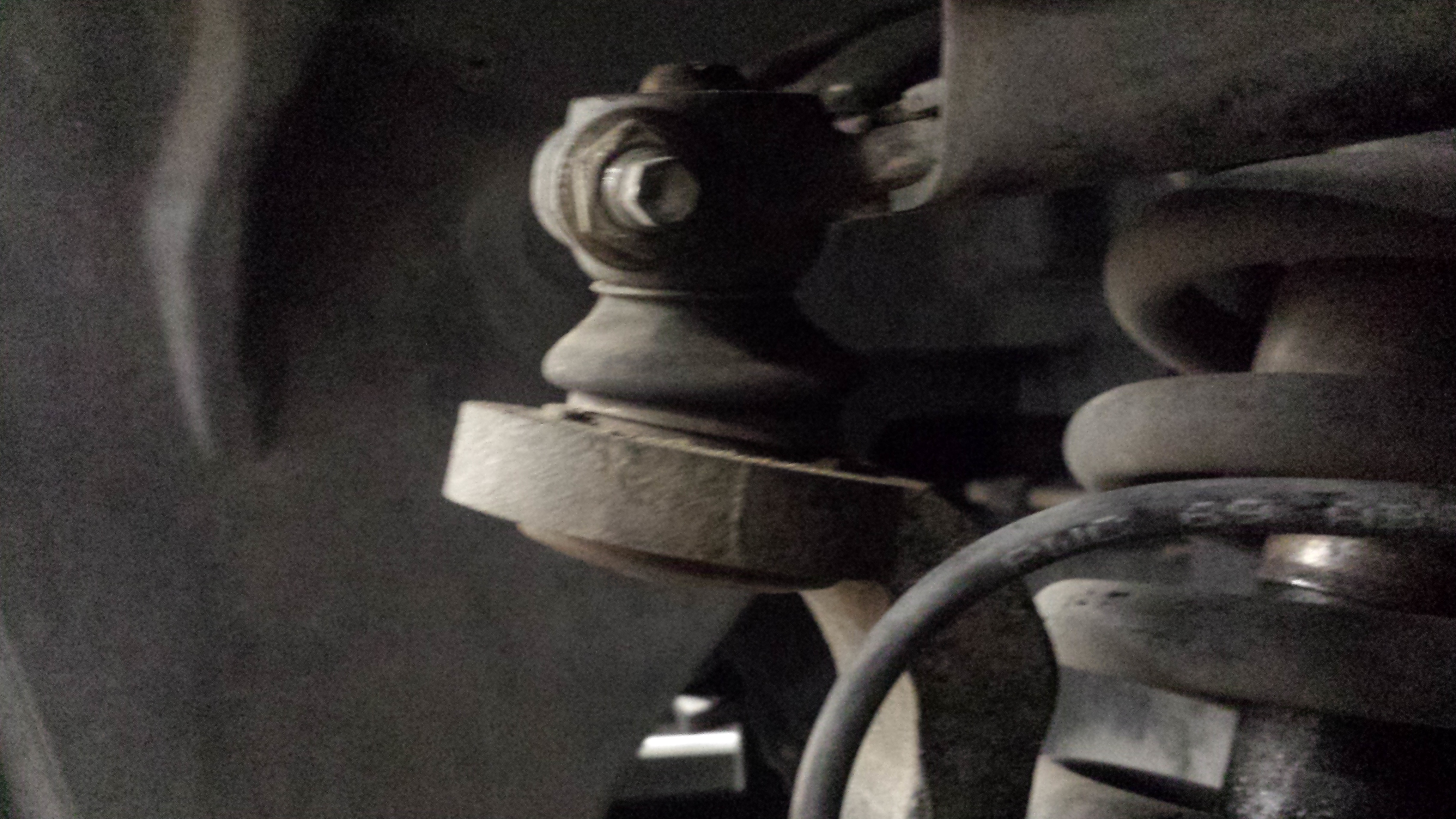

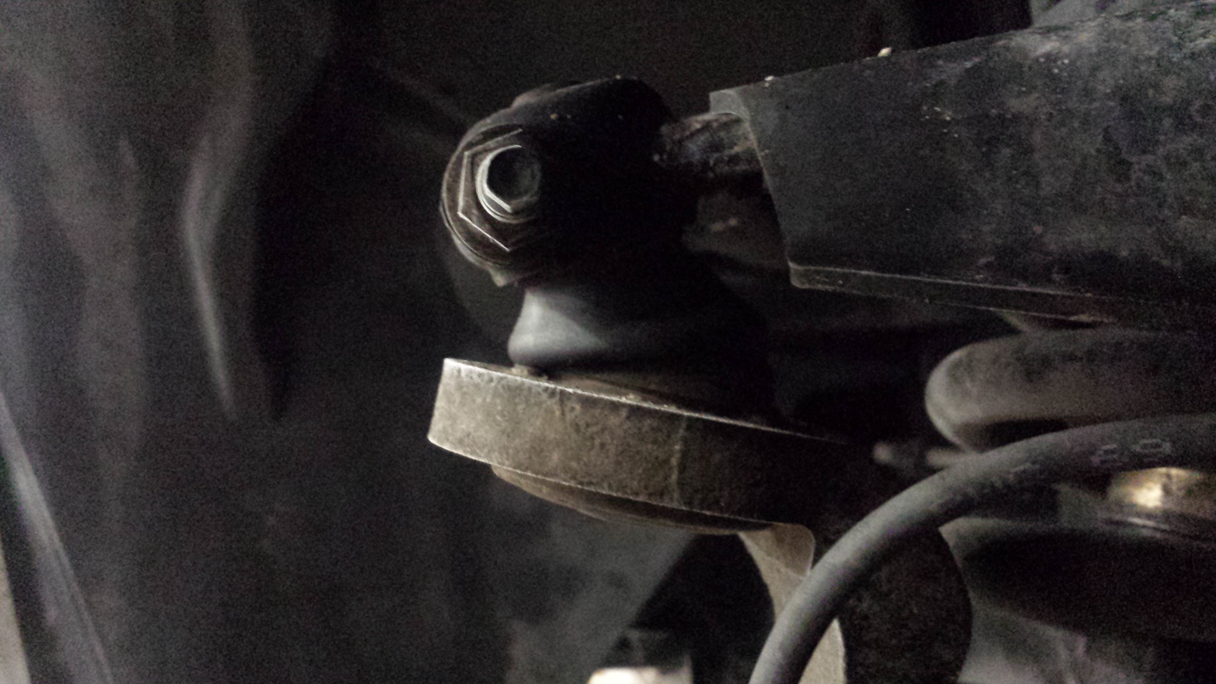

I got the UCA's flipped. That's not that hard at all. I had seen were some people were cutting there inner fender liners and such. I had t slightly bend the inner lip of the forward left fender to clear the head of the bolt. Other than that they just came out. After I was done I went over to the alignment rack to see where everything was. :mechanic: It was all over the place. I worked it around a bit deciding how much camber I wanted vs caster. Flipping the UCA's cost about 2 deg of caster and pretty much maxed out the adjustments. There is a little wiggle room in the front for caster but that's it. The drive seemed good. nice and strait no pulling or wandering. The real question is did the lateral shake go away.......Nope :wallbash: Looks like its going to be the CV's Anyway its going to be a while till I get more doll hairs for CV's as I had blown both front shocks when lifting it today. Here are a few pictures of todays venture
Stock location of the UCA and ball joint angle with the lift.
Rear view of the upper ball joint UCA flipped
Side view of the upper ball joint with the UCA flipped
