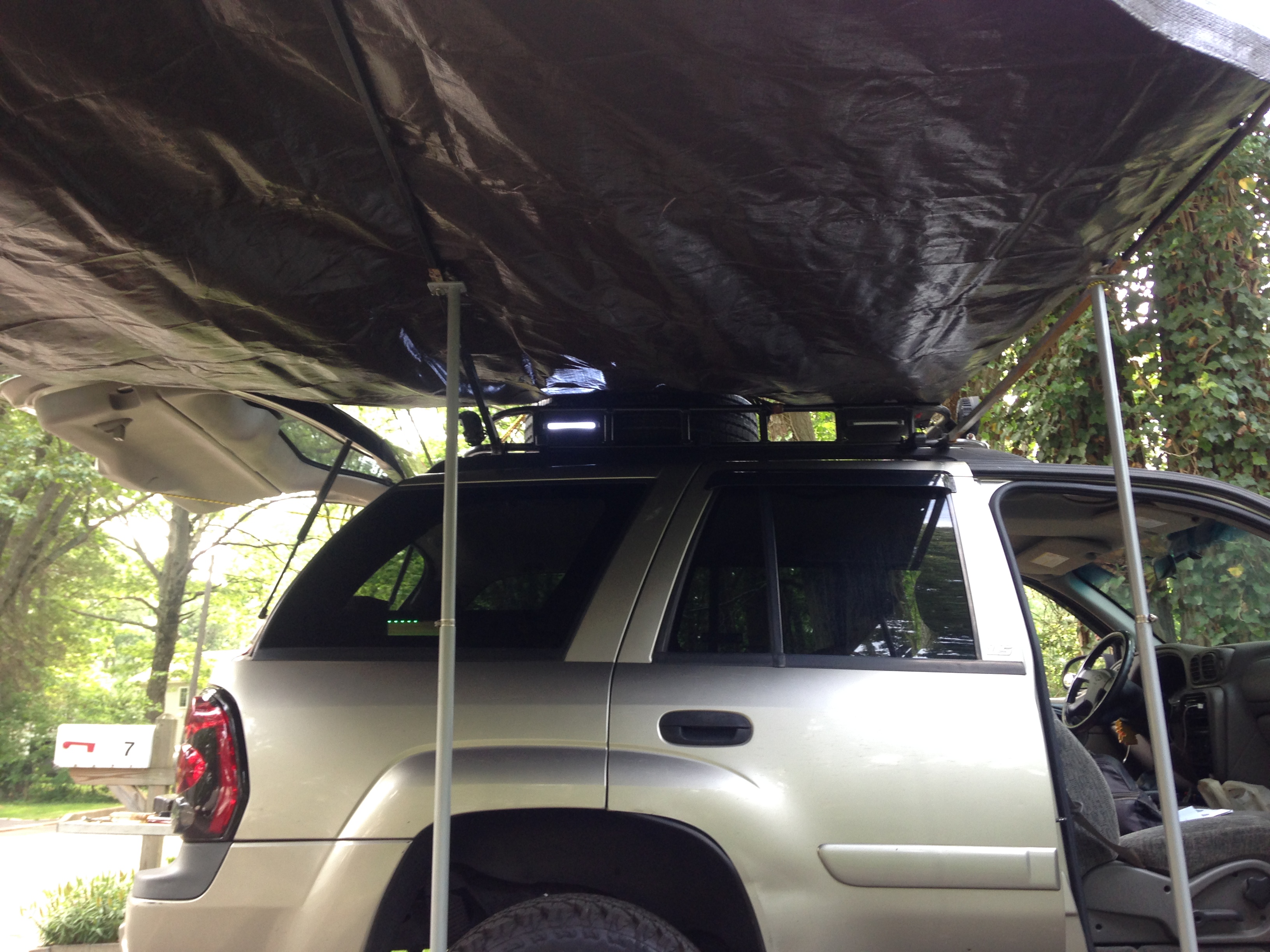

Got a new tarp for the canopy/awning (8'x10' silver/brown for sun and light relection) and spaced out my canopy poles. They're now fixed just shy of 4', front to back; and extend 90" past the stock roof rails.... bungee the tarp around the tailgate and I have a full 8' of sun coverage, from the front of the rear door to more than half way down the tailgate.
Simple design... the support poles and tarp are all you have to carry. The telescopic 'beams' are mounted to the underside of my roof rack (1",3/4",1/2"). Pretty cheap for how sturdy it is...
