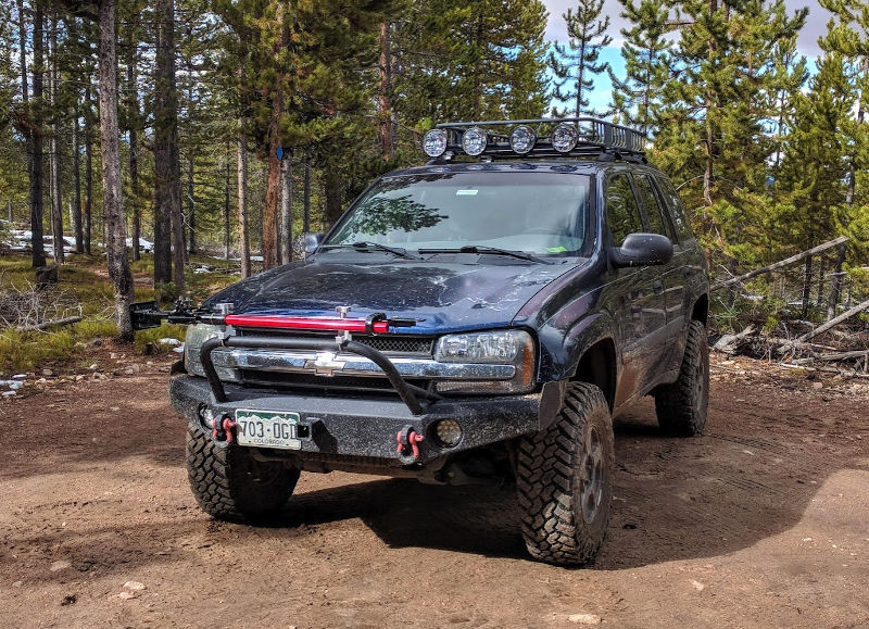

It started when I found a used 2003 Chevy Trailblazer LS on Craigslist in May of 2014. It only had 65K miles on it, and the price was right.
Here's what the vehicle looked like when I bought it.
Stock 2003 Trailblazer
Here's the current view (will change as things progress).
Finished:
  • Bilstein 5100 ride-height adjustable shocks + Traxda inner-strut spacer (3" lift)
  • Z71 rear springs and BDS gas shocks
  • MarcMC's panhard bar drop mount
  • 5 265/75R16 Nitto Trail Grappler summer tires
  • 4 265/75R16 Bridgestone Blizzak W965 winter tires
  • Resonator delete + straight pipe exhaust
  • Remove factory spare tire
  • Wilco HitchGate spare tire carrier
  • Two custom locking jerry can mounts on spare tire carrier
  • CB radio with antenna mounted to spare tire carrier
  • Inno roof rack (shortened so I fit in my garage) with extended Curt basket
  • Transmission cooler
  • Burtonmd bumper, oil pan skid, radiator skid
  • 2 42-watt flood lights mounted inside bumper
  • 2 Hella 500 lights mounted on the roof rack
  • 2 Hella 500FF lights mounted on the root rack
  • Front and rear swaybar removal

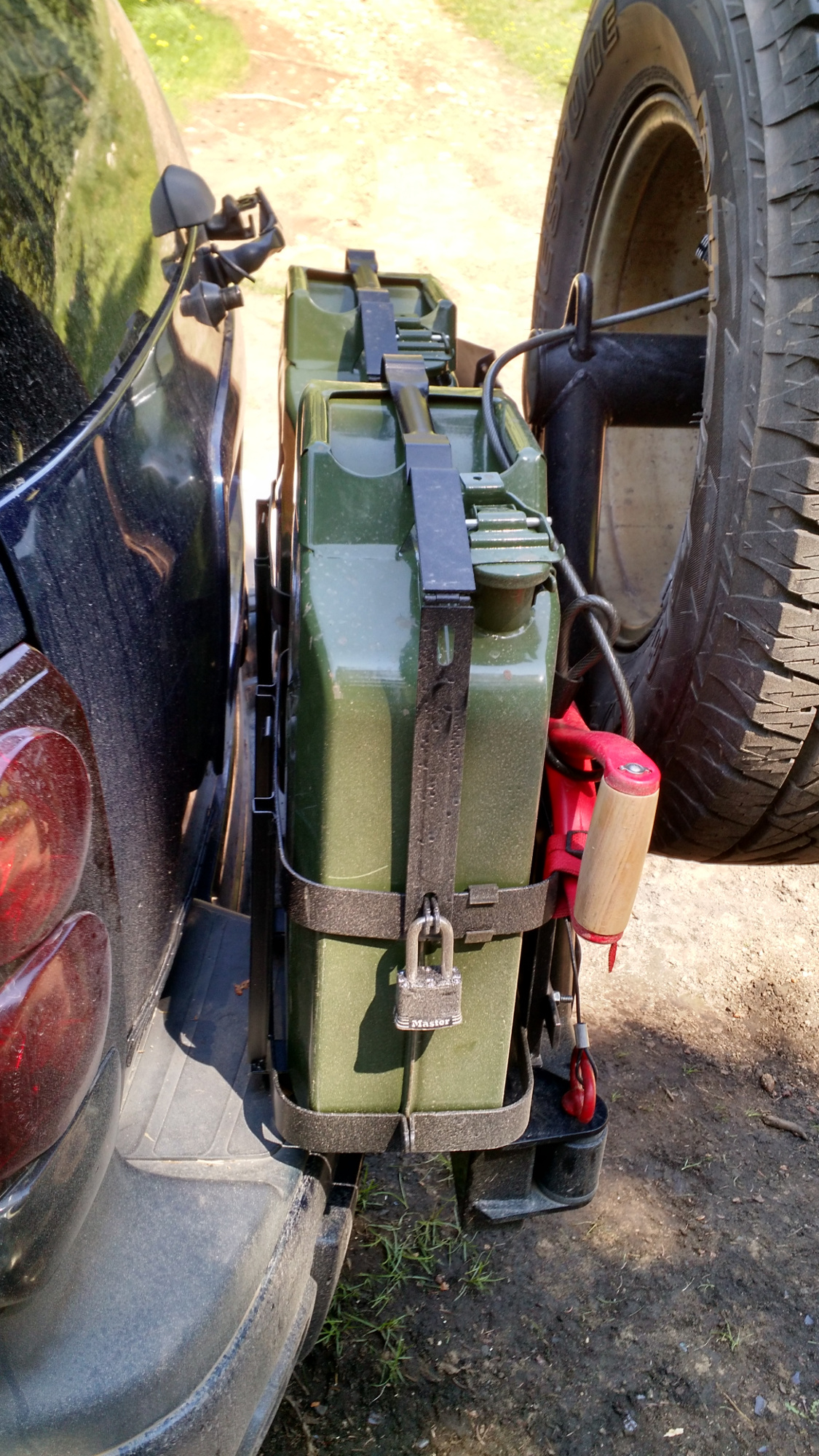

I have read mixed reviews of the ability to hold a 265/75R16 tire using the stock spare tire carrier under the back end of the truck. In the end, I'd rather have the tire hanging off the back of the truck. It just makes everything easier and keeps the spare tire away from rocks.
But, there are limited options for our trucks when we want to carry tires on the rear end. There are a few custom rear bumpers that include a tire gate, and I have seen a few others use modified aftermarket solutions. I was starting to head down that route myself until I found a Wilco HG TireGate locally on Craigslist.
The tiregate normally retails for about $780, which is a lot IMO for a hitch mounted tire carrier. I found mine locally for about $400. The guy was selling his after using it for a year or so, all because he didn't like how far it carried the spare tire away from the back of the vehicle. I figured I could use this to my advantage and get or make a jerry can holder in that extra space.
Unfortunately, Wilco wanted a ridiculous amount of $ for their jerry can holder. They want $330 for the bar that attaches to an existing Wilco HG TireGate, shown here. (It doesn't come with the jerry cans.)
Wilco's jerry can add-on
I figured that I could drill a few holes and use some 2"x3/8" steel bar from Home Depot, plus a couple of $35 jerry can holders from Amazon to create my own solution. (I also ordered the jerry cans on Amazon.) The other thing that I didn't like about the Wilco product is that it holds the jerry cans high in the air. I'd rather have them just above the bumper, so I can open the rear window when the cans are in place. After a couple of hours of planning, drilling, painting, and mounting, this is the solution I came up with.
It's been working really well. One thing I didn't anticipate was how much air pressure changes would affect the jerry cans. Going from 5K feet to 14K feet above sea level and back can really make them expand or collapse. They expanded so much during one trip that one can broke a weld on one of the mounts. Nothing that some creative drilling and a few bolts and nuts didn't fix though. I just need to keep in mind that the cans can change shape based on air pressure and temperature.
I added a license plate light to the tire gate, wiring the light in to the towing harness and feeding the wire along the bottom of the tire gate. Even with the bushings that allow the gate to swing, the light seems to be well enough grounded to allow it to function well, so I didn't both adding any extra grounding for the light. When I went back and added a CB radio antenna to the tire gate, I did add a ground for it and soldered that in to the ground wire on the towing harness. This effectively means that the tire gate cannot be removed, unless I want to snip those wires and make a removable harness for them.
