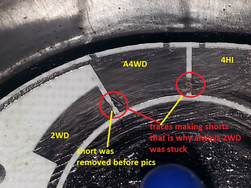

I found the traces in the switch were in short some positions and that was the reason for that the switch always remain in only one position.
the pics are in the reverse order but shows that was the problem.
9. solution traces cleared and save money.
TO assembly again in the reverse order.
before to insert in the dash test the switch to see if everything is working.
8. solution traces cleared
7. Solution Traces cleared short removed
6. traces with short
5. traces with short
4. switch open 2
3. switch open
2. carefully push the locks to open slowly the switch
1. Remove dash to free the 4*4 switch.

Out of curiosity, how did you remove the shorted sections?
by roshirim » Mon Jun 29, 2015 1:49 pm
Trail X wrote:Out of curiosity, how did you remove the shorted sections?
Hello mr. TRAIL X
Yes sure like the shorts were made because the internal wear of the traces, was very easy to remove with a small plain screw driver or a razor but carefully . I did not need any special tool like welder or tin or multi meter, it could be great for any that have a multi meter to measure the contact resistance to measure the electrical short.
but was not necessary just remove the excess of wear and solved.

Jorge, great find! Was there any dietetic grease in there? If not did you happen to add some? The dark material between the traces is carbon and bits of metal cause from wear and arcing when switching. Dietetic grease should eliminate the problem by helping to lubricating the switch. Cheap GM! What would something like this cost in Mexico?
by roshirim » Tue Jun 30, 2015 11:37 pm
TBYODA wrote:Jorge, great find! Was there any dietetic grease in there? If not did you happen to add some? The dark material between the traces is carbon and bits of metal cause from wear and arcing when switching. Dietetic grease should eliminate the problem by helping to lubricating the switch. Cheap GM! What would something like this cost in Mexico?
hello thank you for your comments.
yes there was dielectric grease yet, an smalll amount but yes.
the cost for a new switch here can be around 50 dollars plus 25-30 dollar for the installation. this can be for some people 3-4 days of salary(in our currency).
but the most part of time we can not find the switch available.
in the junk yard can be around 20-30 dolar. of course if there is one in good condition.
some people can purchase the items by internet but most part of people does not.
cheers jorge
