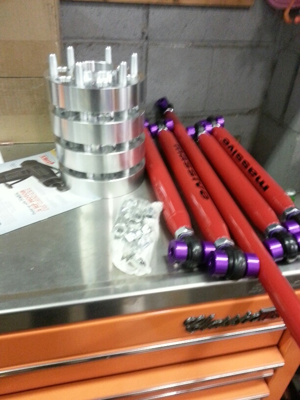

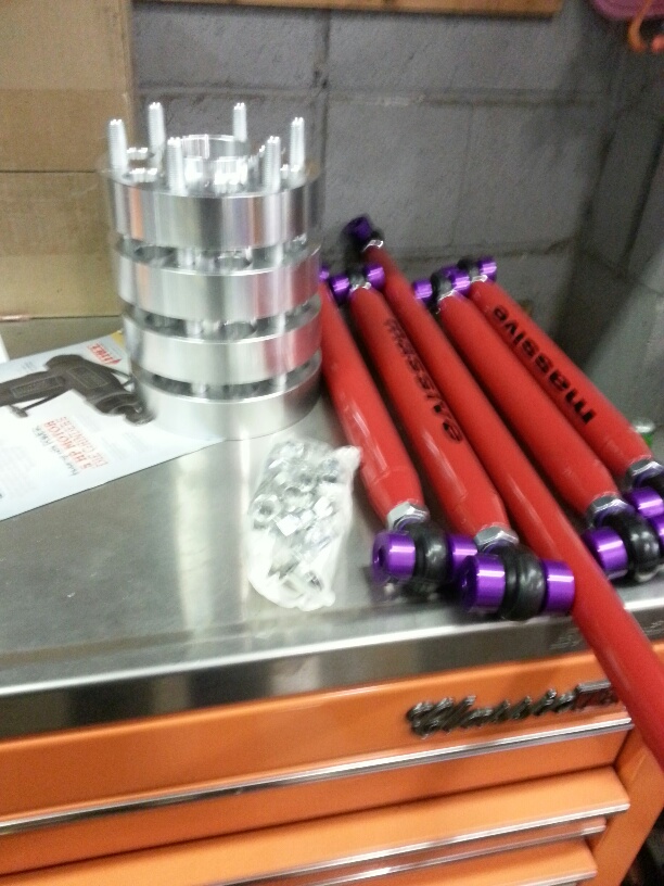

The first of the parts have arrived tomorrow Ill be getting my wheels, It will be a few weeks until my body lift comes in and I have time to install it so they will pretty much only be paper weights for a while. I am hoping to get my springs, shocks, struts, and suspension lift tomorrow as well so I can get busy this weekend. Also I currently have a 8" rear with 3.42 gears, so this saturday I am taking a little trip to Jersey; hopefully I will come home with an 8.6 with an open carrier! Oh also I have new upper and lower ball joints for both sides but i got them late in the day and left them sitting on my tool box, so until I install them I really didnt think a pic of them was needed.
Prothane front control arm bushings
Massive Speeds rear upper and lower control arms, Markmc 1.5 wheel adapters

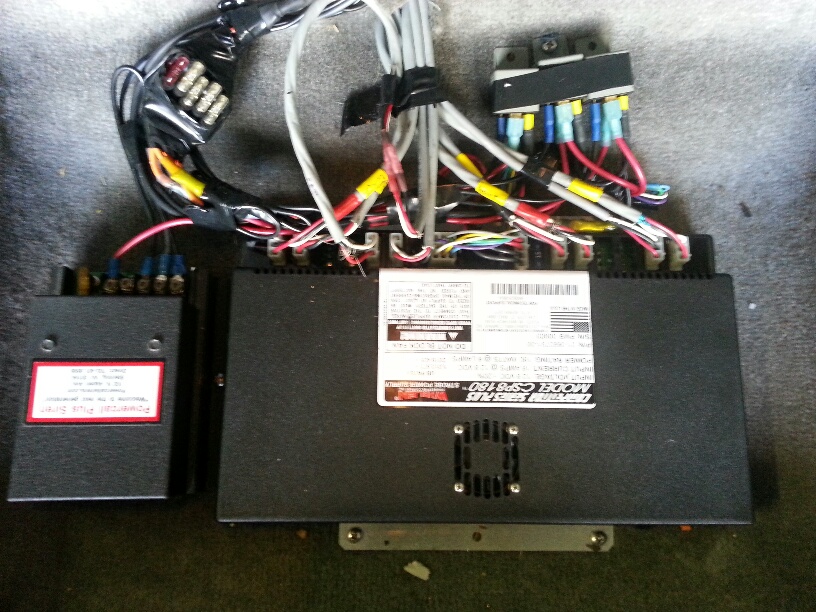

by exb5182 » Sat Mar 15, 2014 10:45 pm

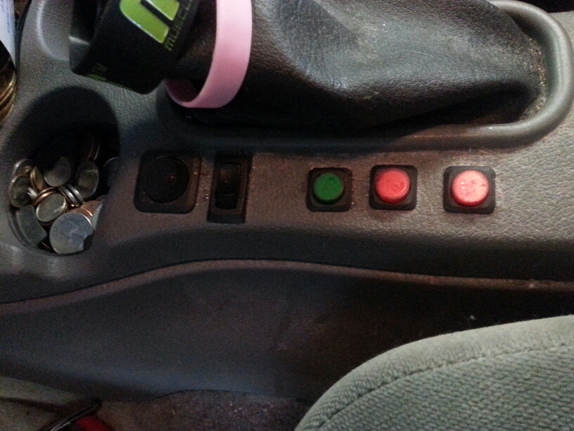

My emergency lights install job
I have my switches for my lights mounted next to my shifter for easy access. One toggle for siren, one for my priority green, The green push button is for white strobes, the two red buttons work the red strobes and led dash light. All switched are wired to relays mounted in the back
Here is some electrical stuff I already have previously installed Strobe Pack and remote siren pack

by exb5182 » Sat Mar 15, 2014 10:50 pm

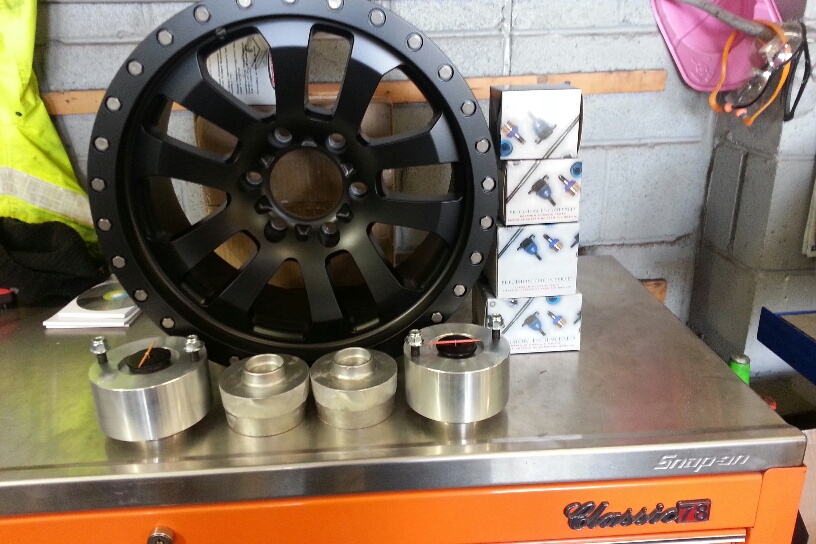

Some more parts arrived on Friday. Here are the wheels I went with (Procomp), My spacers from Markmc, and the ball joints made it in a picture as well.
Parts Yayyyyy

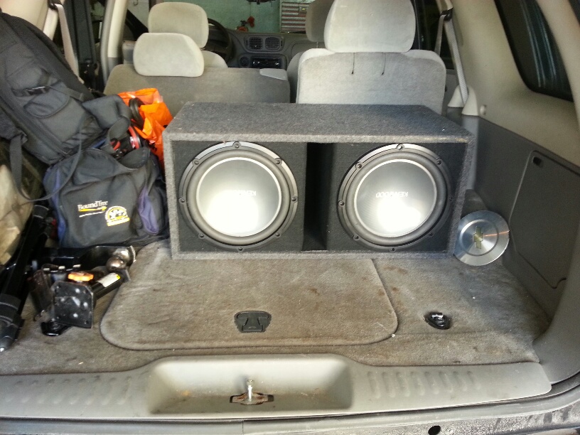

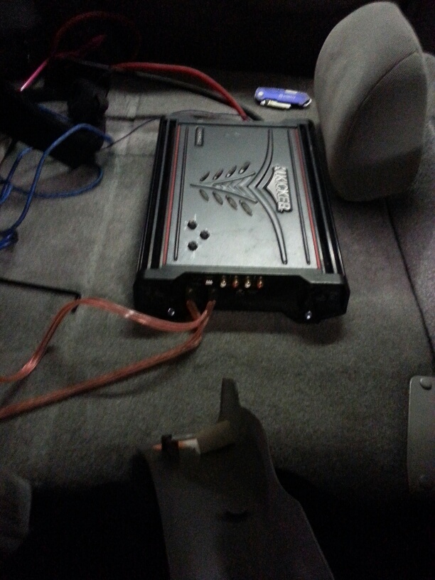

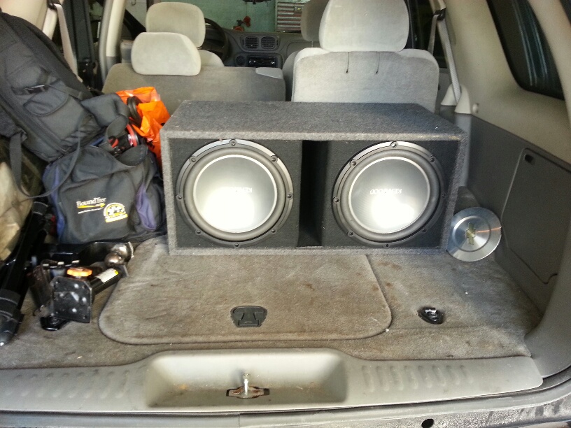

Radio Up grade. I got a free amp and 2 12s from my ex (this week next week will probably be different). She swears they worked perfect when she took them out of her car a year ago. I guess amps over heat in closets hahahaha
amp during install, I never got to finalize and clean my wiring up so dont judge.
upside down because by the time I got to this point I just didnt care bc Ill have to move them again

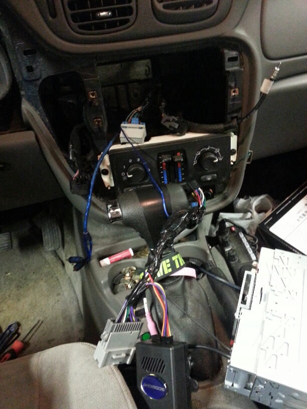

by exb5182 » Sat Mar 15, 2014 11:00 pm

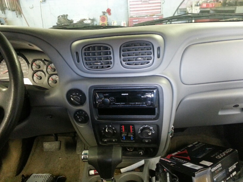

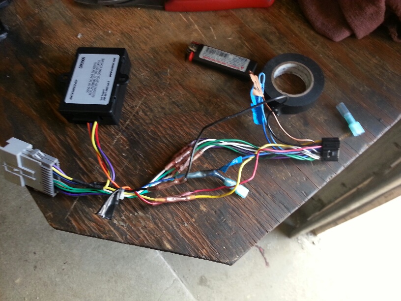

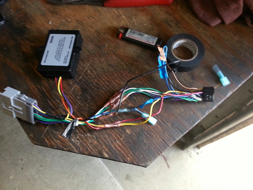

Bought a new head unit and had some fun installing
interface kit wiring. I use heat shrink butt connectors on everything. Keep the moisture out keep the current flowing.
Interface kit all cleaned up. I used a spade connector for the amp remote wire to make removal of harness easy.

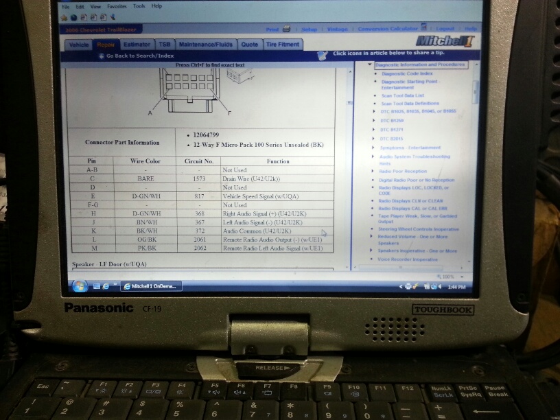

by exb5182 » Sat Mar 15, 2014 11:03 pm
Its nice working in a shop and having the right tools. More of my radio install.
I actually hate this program because I am used to the alldata platform but ondemand does have all the info just takes a while to find.
where'd that hole come from?

Finished product... I had to grind the bezel slightly due to the rounded edges and the head unit not sitting properly. With only having 3 hrs of sleep and driving all day I was kinda in a rush and always slack on the finishing quality I do on my own stuff.
headunit installed
bluetooth mic

by exb5182 » Sat Mar 15, 2014 11:27 pm

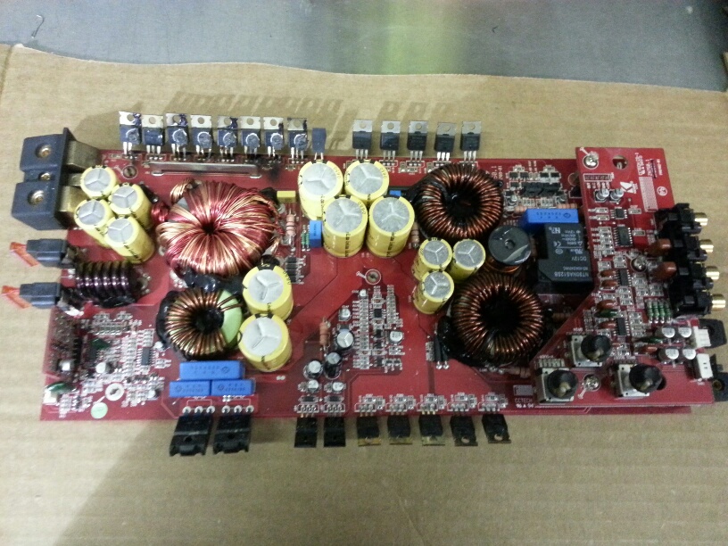

So the reason I only slept a few hours after i hooked everything up the subs weren't working. My ex said they worked perfectly so I retraced everything I did 5 times and then decided to look deeper at the amp. The power light was on and the fault light wasn't; that's one more reason I doubted my self. She wanted me to hang some drywall and the subs and amp were what she offered me
good news is these will only run me a few dollars and I can easily solder them in. bad news is I spent 3 hours making sure my work was correct
A row of bilateral transformers (fets) were melted. this is usually cause by under powering an amp or over working one and normally you can smell it... "worked perfectly" Well those few hours of sleep were spent in her bed atleast hahahah.

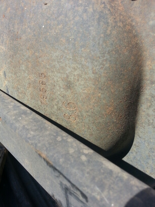

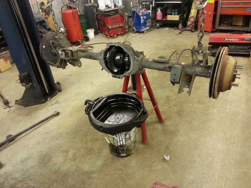

by exb5182 » Sat Mar 15, 2014 11:31 pm
Ok so my big trip of the weekend was to north jersey to pick up this gem
This came out of an 08 SWB with a 4.2 the guy told me on the phone it was out of a SWB with a v8. Either way it was a SWB with 18s that had an 8.6. he was just happy to get rid of it, it had been sitting there since 2009. He couldnt comprehend that I could careless about what gears were in it hahaha
8.6 stamped right on the cover.

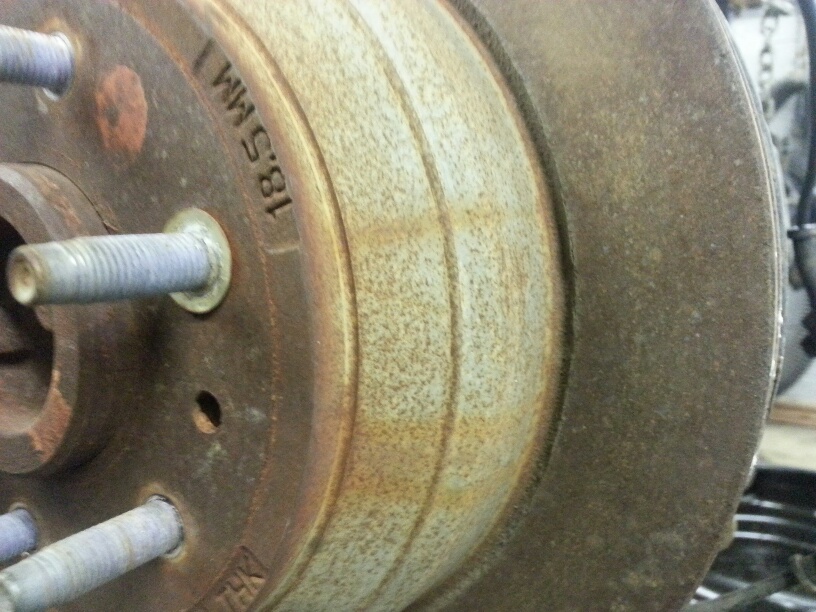

Here are some more pics of this past weekend. Im still waiting on my shocks and struts to come before I mess with my suspension, hopefully they will come this week sometime. If not I was told my body lift shipped out today so I should have something to do!
Anyone that has worked around cars for awhile should know why I took this pic. Although the rotors are rusted from sitting outside for a few years they had no groves in them and these retaining clips on the rotors are only on there for one reason... to keep the rotors from falling off on the assembly line. The first brake job they get taken off never to return again. So the way the rotors looked and these clips tell me this axle has very low mileage.
Just wanted to take a looking side to make sure everything looked ok

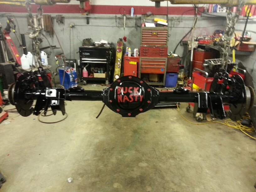

by exb5182 » Wed Mar 19, 2014 8:55 pm
Had to do a little cleaning and painting and i ran out of stuff to do so I got a little creative. Lol its a little nickname my friends have called me for years.
lol
lol yea I was bored

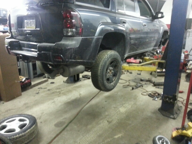

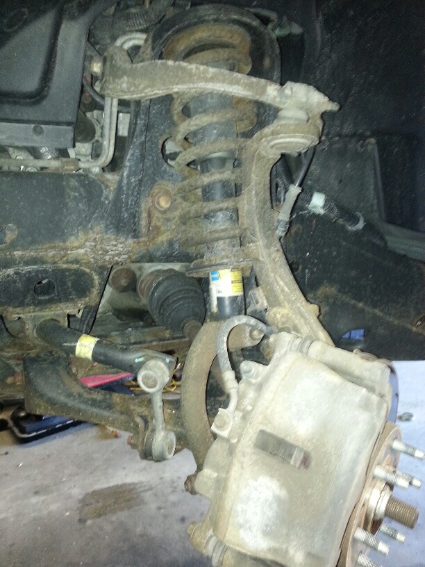

by exb5182 » Mon Apr 07, 2014 12:57 pm
I didnt realize how much work was ahead of me at this time
Factory height
Ball joint time

by exb5182 » Mon Apr 07, 2014 1:01 pm

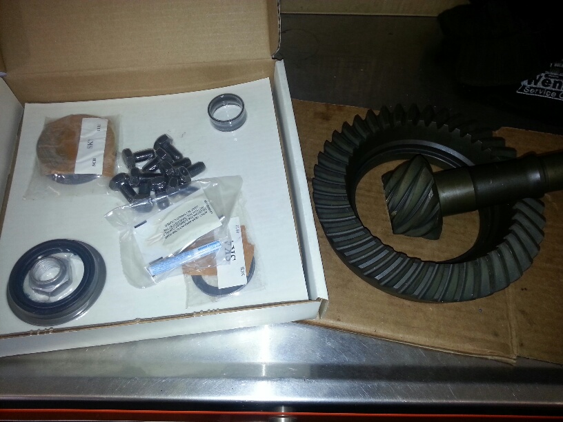

Waited for 3 weeks for bilstiens to find they were on national back order so I order ranchos after getting the wrong ones I finally got them
Precision gear 4.56 r&p for my rear and a minor install kit
Struts

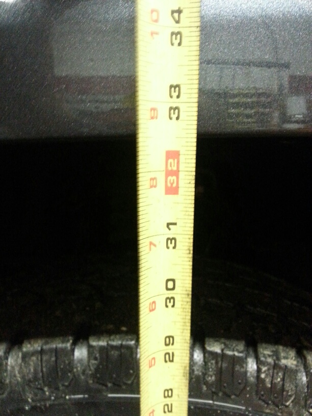

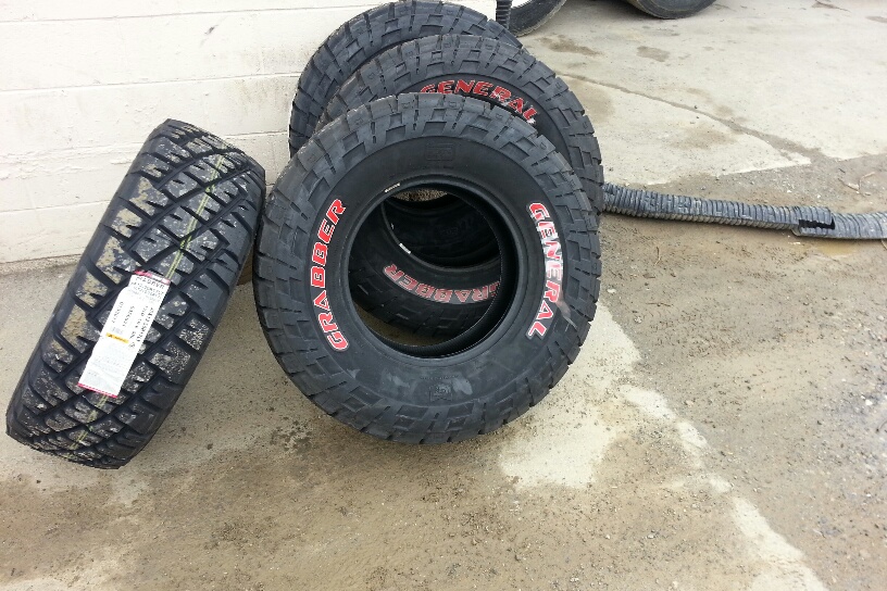

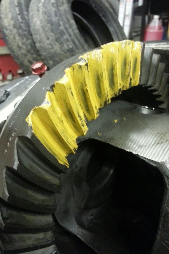

Finished up body lift and another night working on my rear
Tires are in 35 12.5 17 grabbers
.05 backlash and a decent pattern im good with that
Ft fender height with 3" body

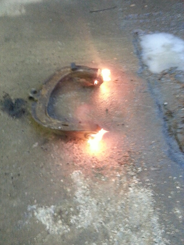

Friday night done work at 5pm time to get my 35s on
I dont think the epa would like the rubber burning
Had to burn my old bushings out for my poly bushings
Getting to work on my suspension
