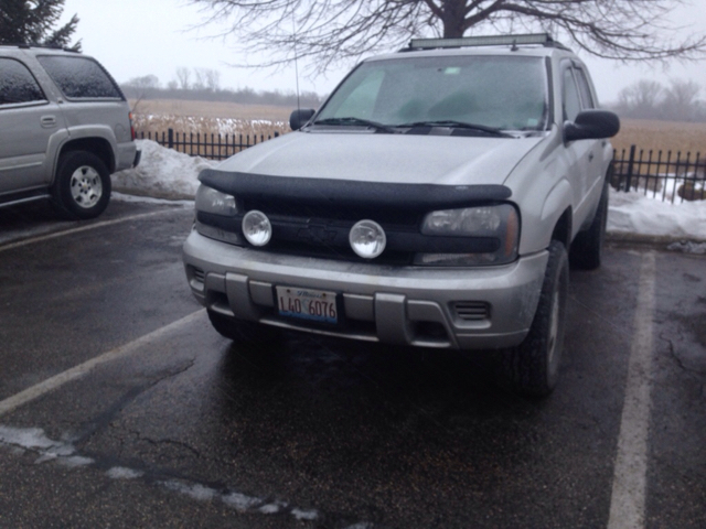

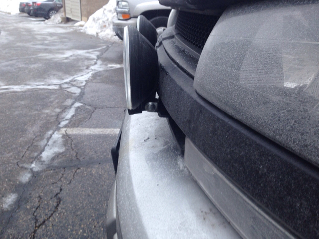

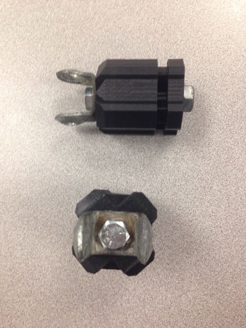

Designed mounts for my lights yesterday. Finished up printing them today and installed them. Just need to run the little bit of wiring and then adjust them.

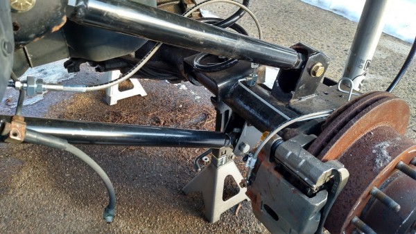

started running brake lines and bolted up the calipers.

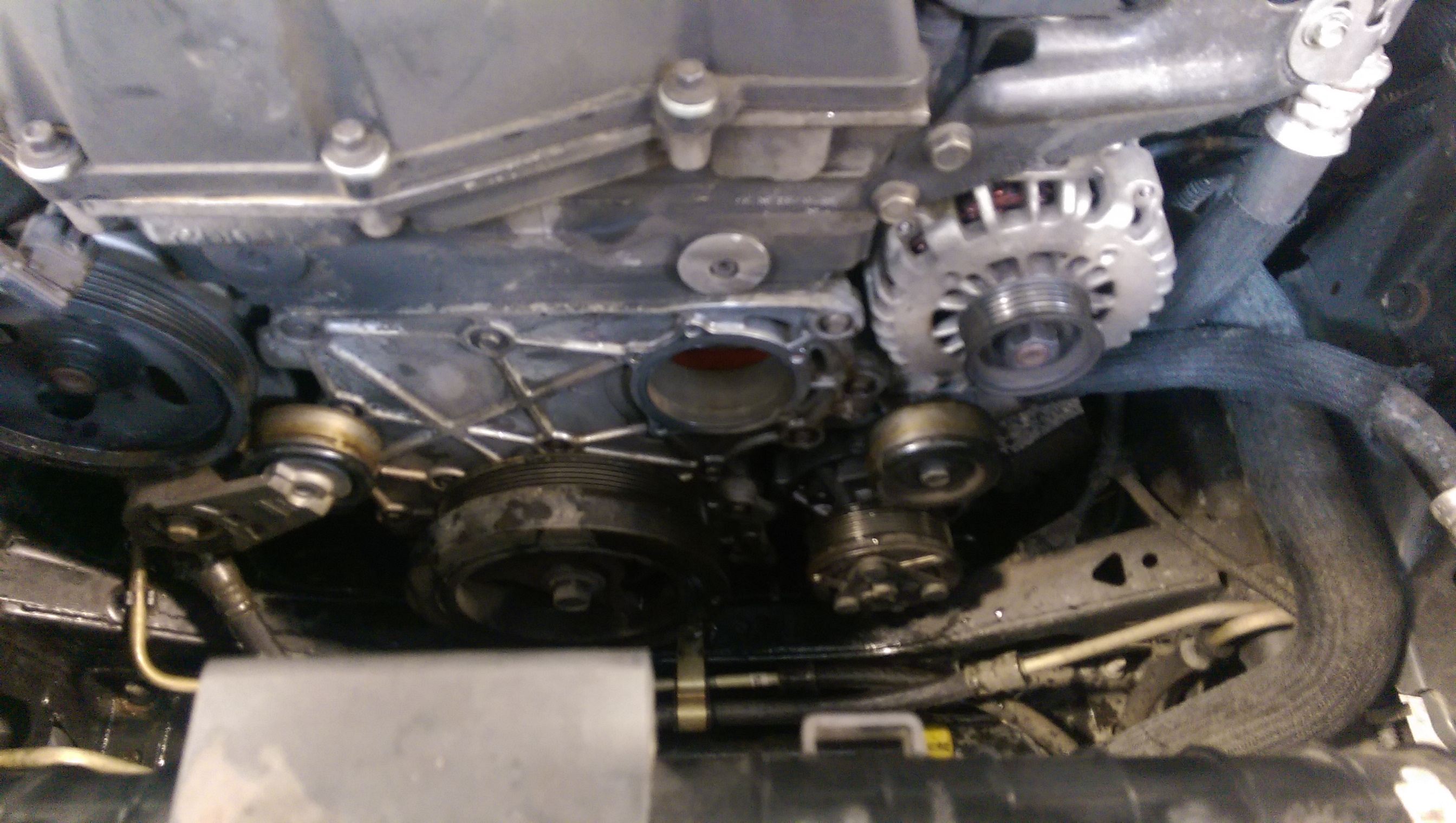

Heard some squeaking coming form the front, and found the fan all over the place... time to replace the water pump.
Quick and easy fix.... except I got impatient and broke 2 bolts off in the block :facepalm:
at least I had a nice walk to Carquest, silver lining right?

How in the world did you break them off in the block? Mine came out real easy.

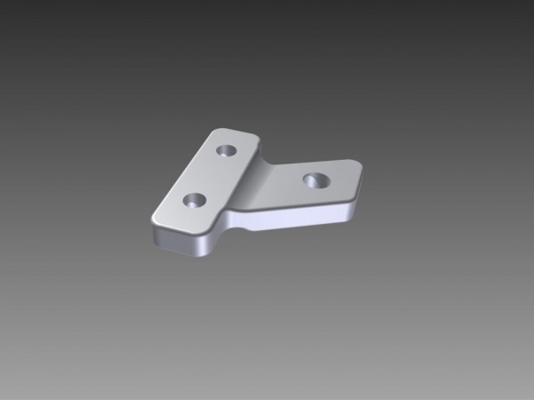

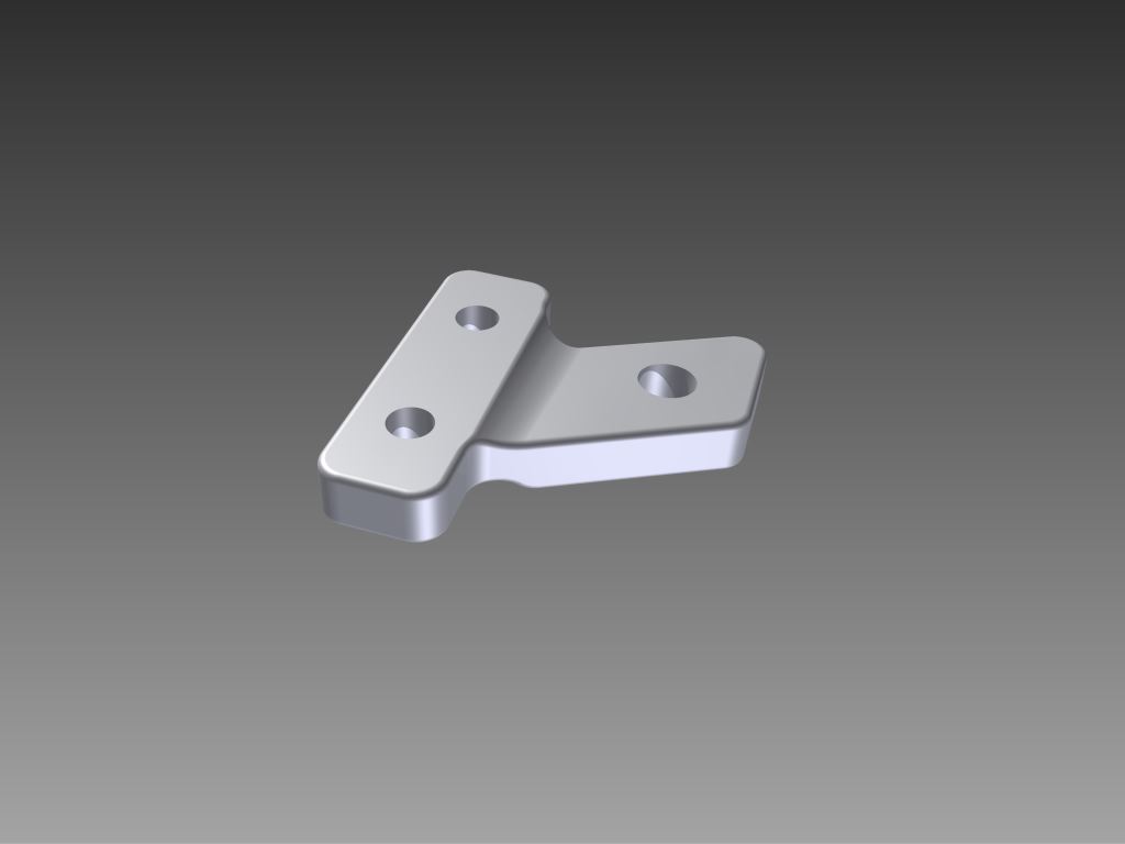

Your mount gave me an idea. I made one in Inventor that I could print for you if you'd like to give it a try. Could have it print this afternoon and send it out to you after this weekend. It's slanted back at the antenna mounting point. I would just need to know the offset distance to clear the RTT tho. Here is an initial rendering. It'd be printed in black.

I'm assuming it'd mount to the roof rails where mine is? I'd be concerned for plastic mount holding up with the twisting because of the leverage against it. Also, the offset will have to be rather large to clear the RTT. We're talking 5-6 inches
by galacticfuzz » Fri Feb 27, 2015 1:55 pm
Ah yeah, that would be too much of a lever against it. I know I've not had any issues with the mounts that I've made for my lightbar to the roof rails but I couldn't tell how far out that had to stick to clear. The twisting would be the weak point. I know I looked at running simulations upwards of 75-100lbs but that was with only a 3" standout.
