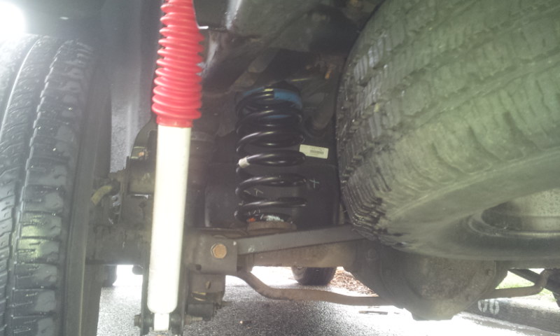

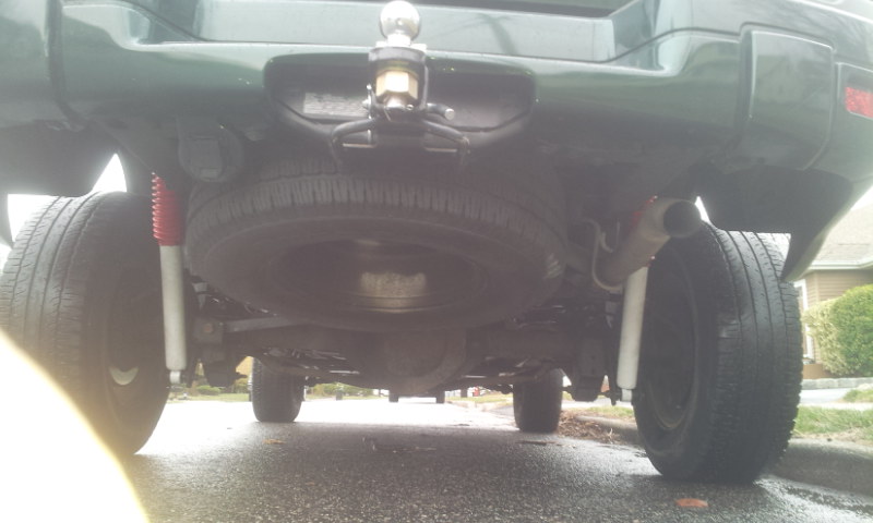

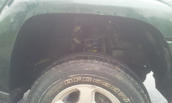

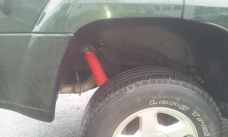

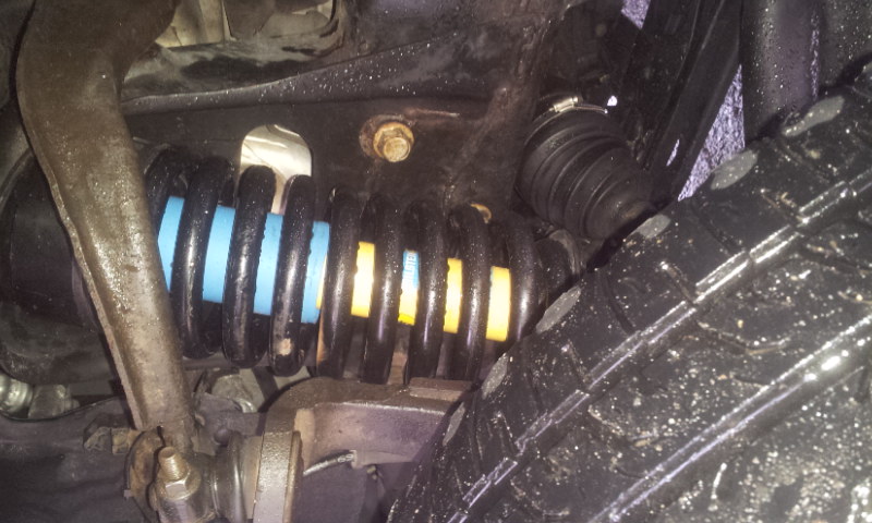

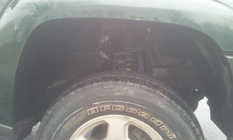

At the shop installing my new front and rear suspensions:
Issues: One of the screws from the front strut mount broke, I have to wait until Monday to buy the part
Shocks Skyjacker N8030 bushing (button) does not fit the bracket I had to remove the bushing from the old shock and adapt it to the new one.
Here is some pictures
Suspension 3.jpg (12.16 KiB) Viewed 21464 times
Suspension 2.jpg (12.5 KiB) Viewed 21464 times
Suspension 1.jpg (12.74 KiB) Viewed 21464 times
darring70
Posts: 291
Location: NJ - Fair Lawn
by navigator » Mon Apr 01, 2013 6:31 am
darring70 wrote:....Shocks Skyjacker N8030 bushing (button) does not fit the bracket I had to remove the bushing from the old shock and adapt it to the new one.s
This is a pretty well documented "feature". It is one reason so many folks went with the BDS shocks at first. Most of us running the SkyJackers(and others) just put several washers on either side of the bushings to take up the slack. You should like those shocks though, they ride good.
by darring70 » Mon Apr 01, 2013 7:15 am
Actually the problem was not add some washers, the pronlem was that the hole of the bushing was to wide for the bolt, but it is fixed
Thanks

by djthumper » Mon Apr 01, 2013 9:49 am
What do you mean too wide for the bolt?
by darring70 » Mon Apr 01, 2013 10:00 am
I do not know how to explain it but the button part of the shock has a bushing and like a metal tube inside the bushing, that metal piece is to big so when the bolt that holds the shock goes through the shock is still lose
darring70
Posts: 291
by djthumper » Mon Apr 01, 2013 4:15 pm
ah but the washer would hold it firm or get a half inch bolt...

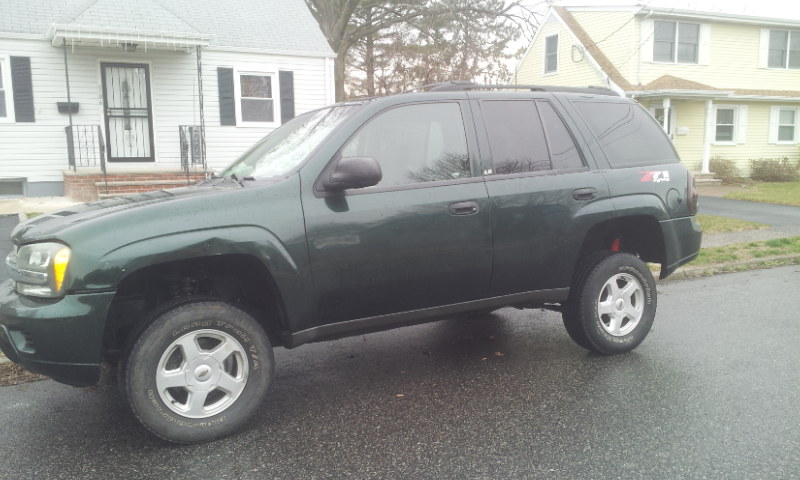

by darring70 » Mon Apr 01, 2013 5:15 pm
Rear suspension installed
darring70
Posts: 291
by darring70 » Mon Apr 01, 2013 5:17 pm
Front suspension installed
Overall
darring70
Posts: 291
by dvanbramer88 » Mon Apr 01, 2013 5:19 pm
Looks good! Now all you need is those tires and skids and you're ready for TECORE!

by darring70 » Mon Apr 01, 2013 5:29 pm
Rides great, better than my 2007 tahoe

by djthumper » Mon Apr 01, 2013 5:33 pm
darring70 wrote:Rides great, better than my 2007 tahoe
Of course it will when you borrow the springs from the Tahoe...
