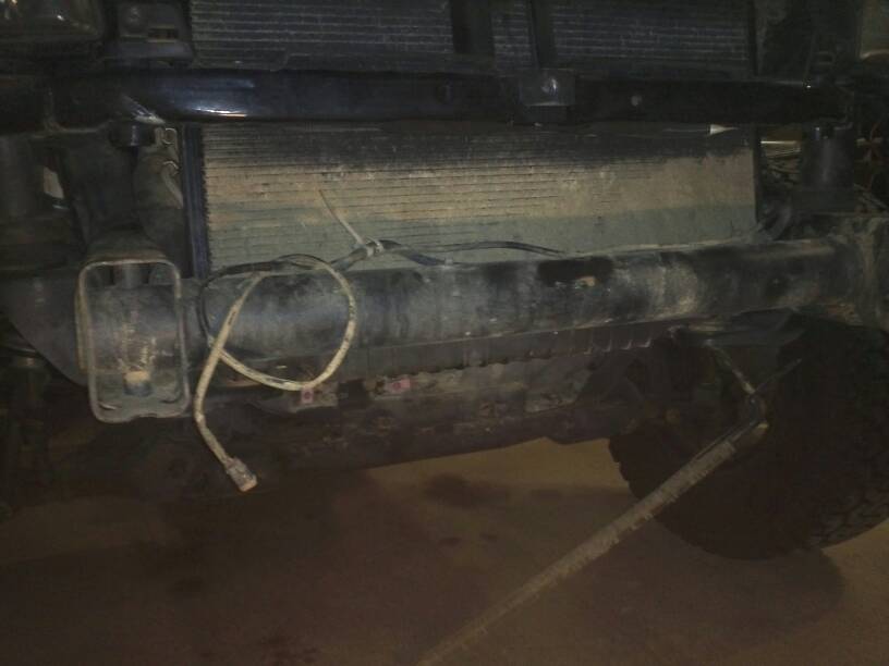

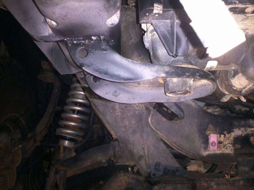

I raised my radiator.
I decided to go electric fans which meant my fan and shroud are no longer tied to the height of the engine. so I cut off my radiator mounts. I shortened them 3" and welded them back on. I did not have to change any hoses or anything.
I'm really happy with the results. I hope to have better air flow, less damage risk, and I now use the OEM upper radiator mount with my body lifted truck.

Smart change. Makes complete sense with a body lift. Any issues with the engine coolant hoses or transmission lines?

Trail X wrote: Any issues with the engine coolant hoses or transmission lines?
The coolant hoses moved with no visible change. The transmission cooler lines only needed a little massage to clip back into all its brackets.
I am still scratching my head on how/where to mount the power steering cooler. My 2 ideas are...
1. Move it up into the grill area and zip tie it too the A/C condenser.
2. Try to find 2 Trans coolers. One for power steering fluid and one for Transmission fluid. I would mount them side by side in front.
by dvanbramer88 » Sat Apr 19, 2014 1:13 pm
ErikSS wrote:Try to find 2 Trans coolers. One for power steering fluid and one for Transmission fluid. I would mount them side by side in front.
I have that configuration. I got a little 5"x5" cooler I'm using for PS cooler. It sits right next to my trans cooler which is like 8"x11"
by DustinC1989 » Sat Apr 19, 2014 1:14 pm
I like option 2 personally since I plan on doing the same thing down the road
