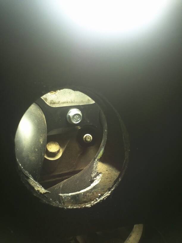

I had to cut a hole threw both layers of my strut tower to allow access to the damaged spark plug thread. Once I had straight on access I was able to tap the threads clean and install the spark plug. Using hole saws, I had made a larger hole in the front piece. The cut out from the front piece was close to the right size to fill the back plate. I made a new plate for the front strut plate. I decided it was enough excitement for one day. Hopefully I don't have anymore of these issues.
