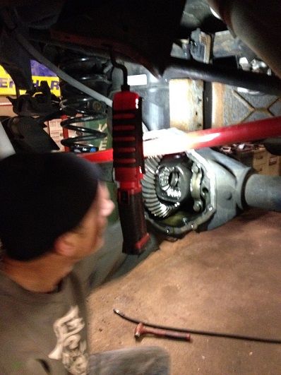

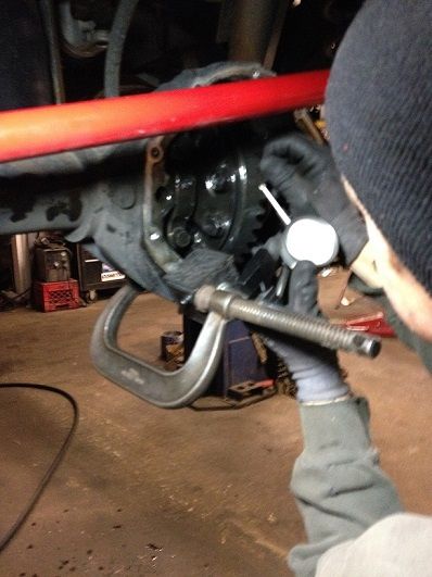

Installed
  • 4.56 rear gears (Yukon YG GM8.5-456 w/pinion bearing kit PK GM8.6)
  • Powertrax 92-07863005
My friend Gary starting the re-gear
Checking existing backlash after 11 years & 120,000 miles. Magnetic base wouldn't work, the differential housing is aluminum

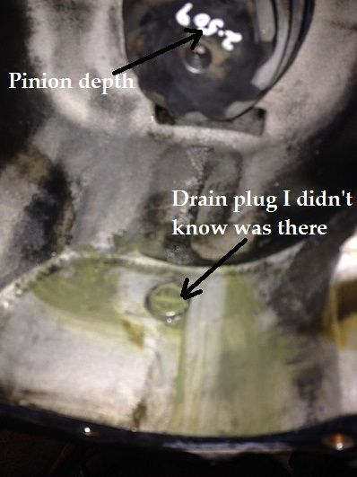

Finished setting pinion depth
Start of many tries to install the Powertrax (four to be exact)

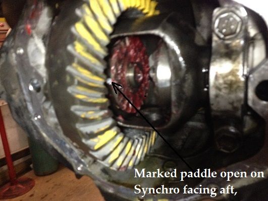

Marked paddle opening on Synchro facing aft, On the left side I marked oppisite side of Synchro because opening faced fwd and I wanted my white mark to face me.
OK the re-gear went good (some what), reused the pinion shim to set the depth. Reused the carrier bearings and outer shims. The backlash came out within and the pattern looked good so we went with it. But the spring in the junk ass pinion seal would not stay in place. The kit came with two seals (no numbers on them) so we picked the one that looked the closest to the OEM and on the way home I notice it was leaking. I pulled over for a bite to eat and got on the phone to Randy's R&P told the guy :hissyfit: "Your pinion seals are junk shit" before I asked if the GM OEM seal would fit their Yukon Pinion he said yes and gave me a P/N 710506 so I stopped and picked one up from AA. So once the snow melts I'll change it out.
I got in a hurry wanting to get on the road before the snow and was having issues installing the Powertrax until I stopped and read the instructions
for the umpteen timeImage Once that was complete I tried to button things up only to find out the rear cover that I primed, painted and undercoated was wrong. Yes the one that I emailed Summit Racing and asked "Will this cover fit my GM 8.6" so I reinstalled the old rusty one. Then I snapped one of Gary's $200 Matco 3/8 drive ratchets trying to loosen the fill plug, after a little heat I got it out and filled her up.

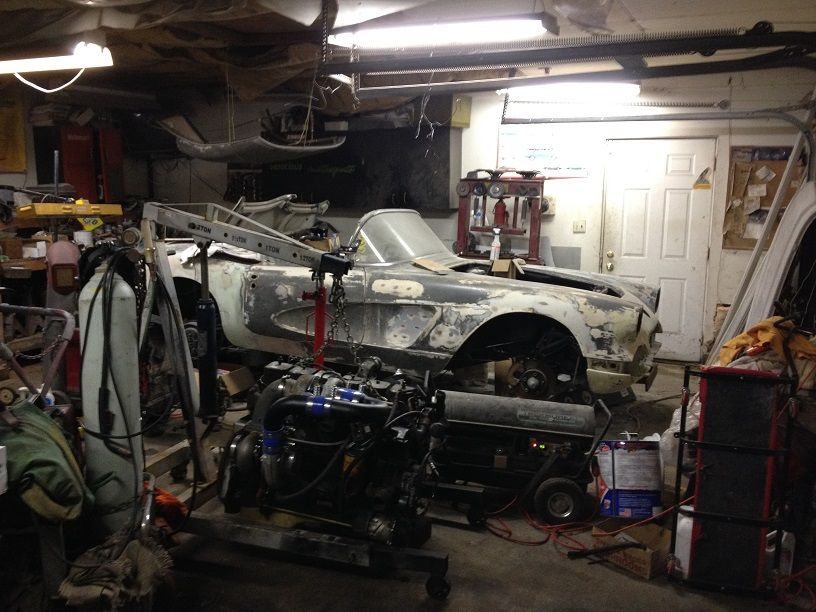

by Opeth » Fri Jan 03, 2014 11:04 am
Are we admiring the bondo'd car or what appears to be a cummins 6BT?
by Chango » Fri Jan 03, 2014 12:40 pm
Opeth wrote:Are we admiring the bondo'd car or what appears to be a cummins 6BT?
I was looking at that too...does it have twins on it?

Yes, two weeks ago when I stopped by to set a date for the re-gear that cummins was in pieces all over the bench. He did a complete rebuild with a 5K twin turbo package, he's just waiting for the owner to drop off more funds and then he'll install it back in the dodge dually 4x4. That bondo'd car has a story. Uncle Lee bought it after returning home from two tours in Vietnam, it had wheelie bars and a blower out the hood. He never really did anything with it. Uncle Lee passed away in the late 90's and now his brother JR (Gary's father)tinkers with it from time to time.

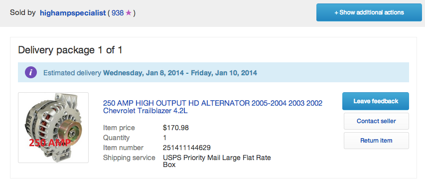

by TBYODA » Mon Jan 06, 2014 10:16 am
Regulator1175 wrote:Today I installed my new 200amp alternator
Details were you pick up and $$ if you don't mind.;)
by mikekey » Mon Jan 06, 2014 11:51 am
Regulator1175 wrote:Today I installed my new 200amp alternator, new starter, outer tie rods, green filter, and gator belt. Unfortunately the tension pulley has not arrived yet and the idler pulley was the wrong size, so I still have a lot of noise. I then got it in to a buddies shop for a free alignment.
Here is the final product.
We left some positive camber since the coilovers only have 100 miles or so on them. We were thinking that as they settle a bit the tires will come into correct specs.
It was great timing as well. I pulled 6 cars out this evening, and got my wife to work safely. She was the only CNA to show up for third shift!
I'd be interested as well in knowing which aftermarket or (rebuild kit) you use.
Since I just replaced the battery last week and I'm planning out my e-fans & dual battery setup I was thinking of purchasing the DB Electrical 250amp high out put alternator. http://www.dbelectrical.com/p-9753-alte ... envoy.aspx
by Regulator1175 » Mon Jan 06, 2014 2:34 pm
This is the one I purchased.
There is also this one available that I looked at.
by mikekey » Mon Jan 06, 2014 3:01 pm
Regulator1175 wrote:There is also this one available that I looked at.
That is a way better price than the one listed on DB Delectrical's website. Guess I'll have too pick this one up instead. :thumleft:
