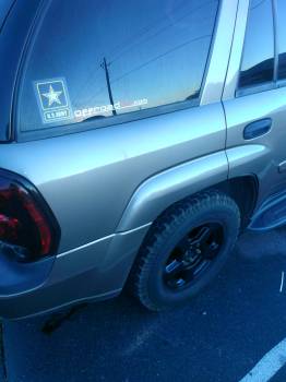

by OKTrailblazer » Mon Oct 28, 2013 9:15 am
Put on the Offroad TB sticker, mount tires on new rims!

Looks good Corey!
