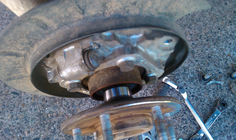

Remove both wheels and the rear brake calipers, brackets, rotors, and shoes.
Use some compressed air to blow all the dirt and debris out of the assembly. Now's the time to check your rear axle seals. Mine were dirty, and had a tiny amount of seepage (expected), but weren't leaking.

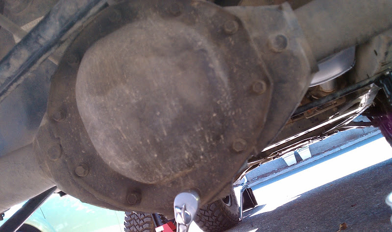

Unbolt the diff cover. (13mm bolts) Have a catch pan ready for the gear lube which will spill out.
Here is the G80 carrier. Note how clean my internals are. This is because I had the cover off earlier to try to discern what was wrong with my G80 before ordering parts. Yours will most likely be much darker.

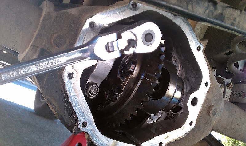

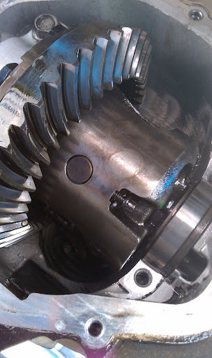

Grab the driveshaft and twist it. This will rotate the carrier. Rotate it until you see the reatining bolt (3) pictured above. I unscrewed it partially to make it easier to see, your will be tight. The correct tool for loosening this bolt is an 8mm 6 point wrench or socket. Using a 12 point socket will cause the bolt corners to round. Ask me how I know.

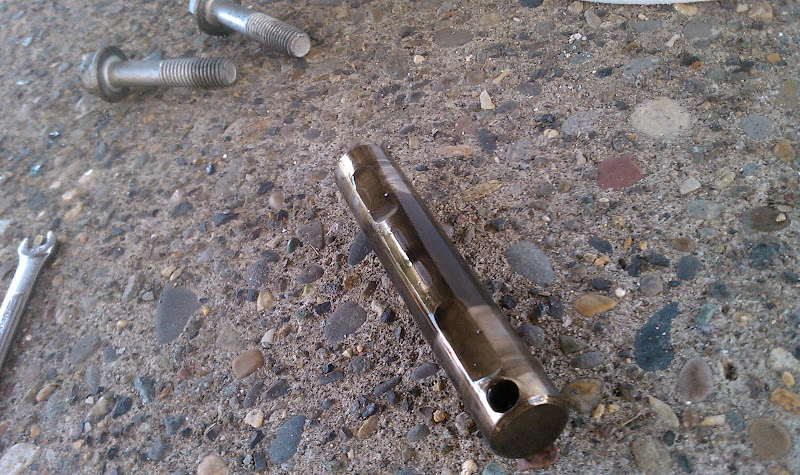

This bolt holds the alignment shaft (2) in place. You can see the end of the shaft in the above pic (the large circle). When removed this shaft should side out of the carrier fairly easily. You may need to rotate the carrier a bit and push it out from the other end. Here's what it looks like.

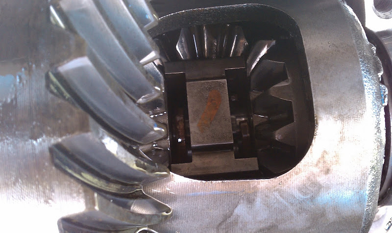

This shaft also keeps the axles in place. Now that it's out go to each hub and push in towards the center of the truck. Each axle will move in about 1/4". Go back under the truck and rotate the carrier until you see this.
The large metal piece is called the thrust block (12). On either side you can see the C clips (they are brownish in the picture). These hold the axles from falling out of the differential. We need these out, so use a small magnet to grab them.

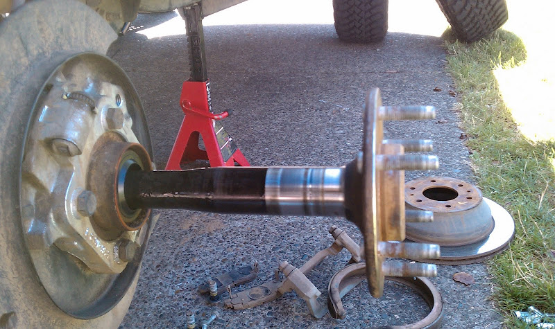

Carefully pull each hub out about 12" and let them sit. You'll probably get some extra gear lube draining out of the housing.

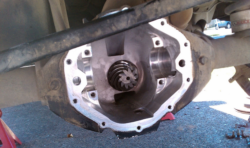

Remove the bearing caps. The bolts are 18mm. Mark each one for side and orientation, as they need to be installed the same way. Be ready, as the carrier may start to move on you as you remove the caps. Don't let it fall if so. Pull the whole carrier out and put it on your work surface. Keep track of the carrier bearing races and thrust washers on each side, which will probably try to get away from you.
Ta-da! The carrier.
Now go back to the housing. Get out some brake cleaner and spray/blow/wipe down everything. The cleaner everything is, the more harmonious your life will be.
Do this now so the housing has time to air dry. We don't want any brake cleaner contaminating our new gear lube later.

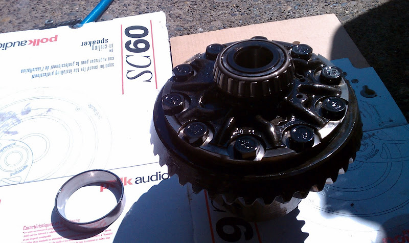

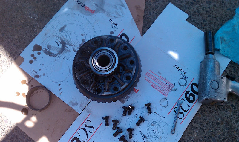

You don't have to remove the ring gear, but I wanted it out of the way. The ring gear bolts have left handed threads. This means clockwise will loosen them. Remove all of the bolts. An impact gun helps.
Look on the side of the carrier where the ring gear attaches. You'll see some numbers stamped into the side. Make note of the closest bolt hole to those numbers. Partially screw a bolt into that hole. Partially screw a bolt into the hole opposite of that one. Tap both bolt heads gently in an alternating pattern to remove the ring gear. Remember to put the bolt back into the first hole so we can reinstall the ring gear back in the same orientation.

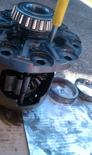

We need to remove the governor parts (11 and 4). There are two holes in the left side of the carrier. Using a punch we can knock the governor parts out the other side. I broke a punch getting the weight out. It's really in there.

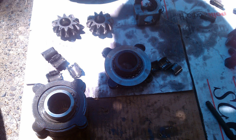

With the governor assembly removed, reach into the carrier and give one of the side gears (7 or 13) a twist. This will pop the spider gears (6) out. Place those aside. Then pull the right side gear and clutch plates out. They may fall apart on the way out. Don't worry, just refer to the diagram. Pull the left side next.
Inspect your side gears(7 and 13) and spider gears (6) for damage. Chipped gear teeth is a very bad thing, and means your rear diff is probably on borrowed time. A gear kit with all 4 is available from GM, but is expensive. You might be better off finding another G80 carrier to rebuild or cannibalize parts from. Inspect the alignment shaft (2) for wear. It should be perfectly round save for 4 flattened portions.

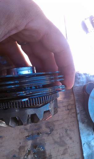

Here's my left side gear assembly. This is where most of the magic happens in the G80. Two of the clutches (18) in mine are completely gone.
You need to check the gears on the cam plate (14) and governor (11) for damage. Any problems with these gears meshing and your G80 will work sporadically at best. Replace them if they're chewed up at all.
Replace clutches as necessary. The left side assembly is together with a snap ring (17). The shaft keyed discs and tabbed discs go on in an alternating pattern, along with the spring, and plate. There is one tabbed disc that goes against the cam plate (14) it will have significantly more material on it than the others and should be pretty obvious. Use the new spring in the disc kit. Follow the diagram if you're unclear on assembly.
