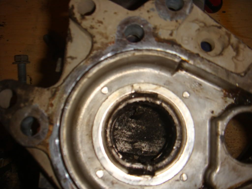

The only one I see of your pictures is this one:
You need to be hitting this one from the seal side, hitting it towards the inside of the vehicle. There's nothing holding it in, it's just a press.
by Mudwheelin » Thu Dec 22, 2011 8:28 pm
Wow, they really press them in there. I must have hit it 30 times and it didnt move. Ill give it a few more wacks tonight. How do I remove the outer seal?(the rubber thing)

by Philberto » Sun Feb 12, 2012 7:13 am
Just thought I'd chime in on this one. Mud sent me his old housing (the one pictured), though it's quite a bit cleaner now. All I had to do was take a screwdriver (tip wrapped in electrical tape), whack my way down the side of the ridges on both sides, alternating, and pop! Whole thing (bearing and seal) came out in less than 5 minutes. After a thorough cleaning, I've installed new bearings and the new seal, and the outer side is ready to go! I'll be reusing my inner, so no need to mess with his, but just thought I'd share the easy method to get these things out that requires no specialty tools. Just use a c clamp, shop towel, clamp the outer housing to the side of a work table, then use previously mentioned screwdriver with taped head and a MFH and you're good.
