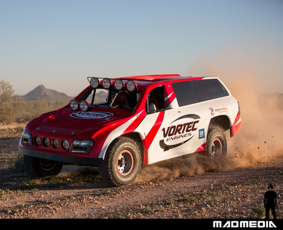

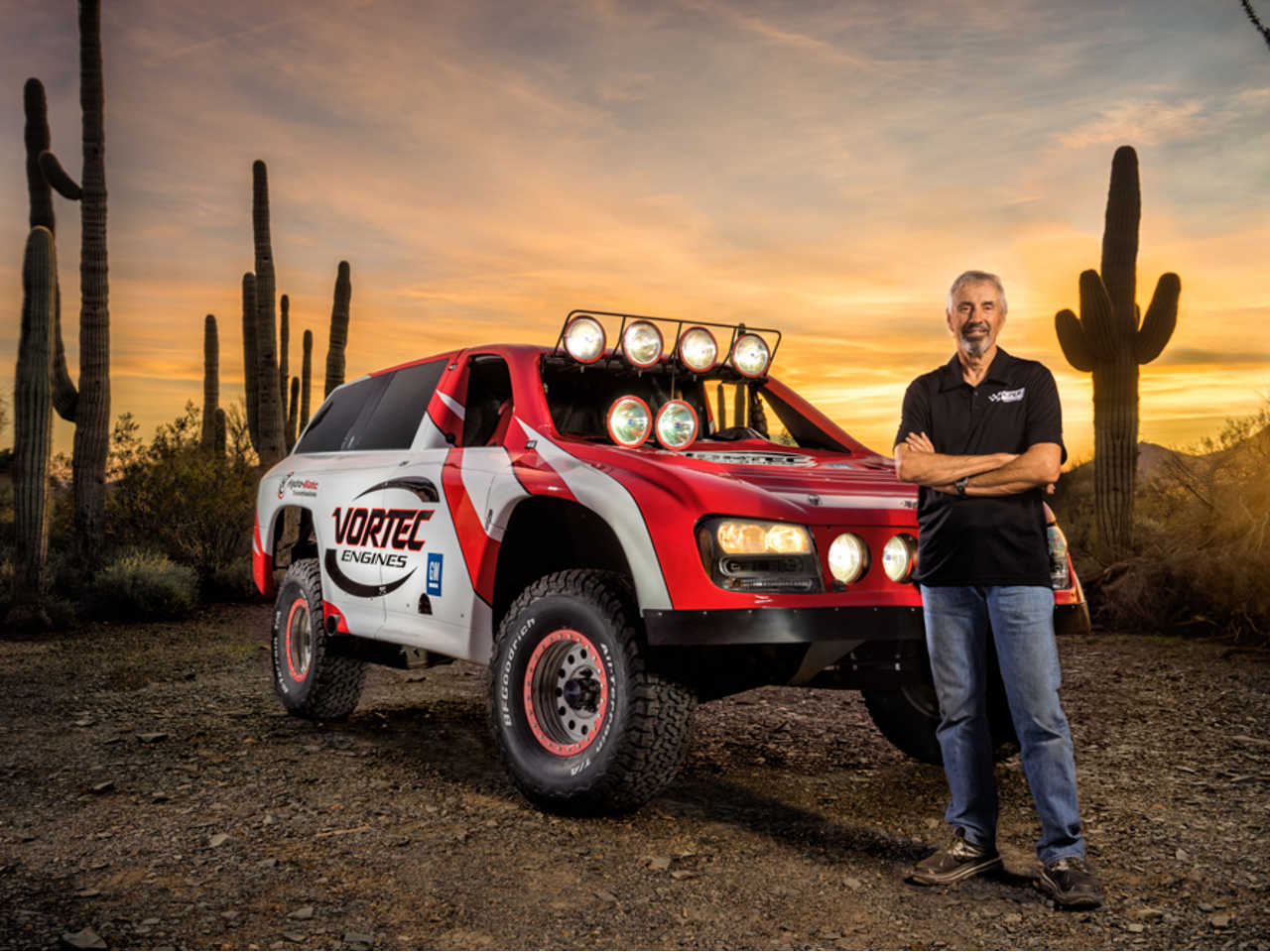

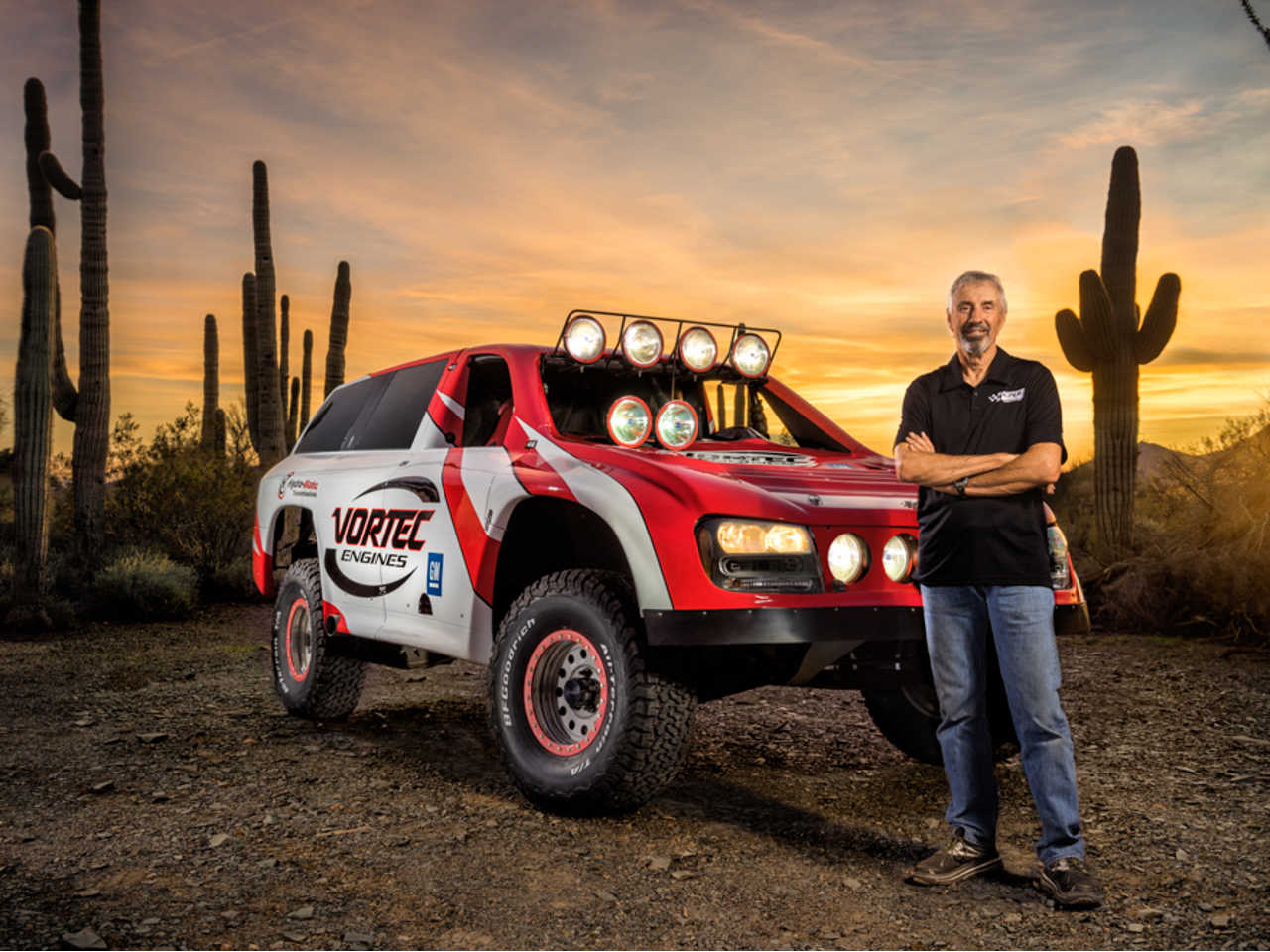

Anybody remember Larry Ragland. Oh prerunner Trailblazer. Baja winner in his Trailblazer
