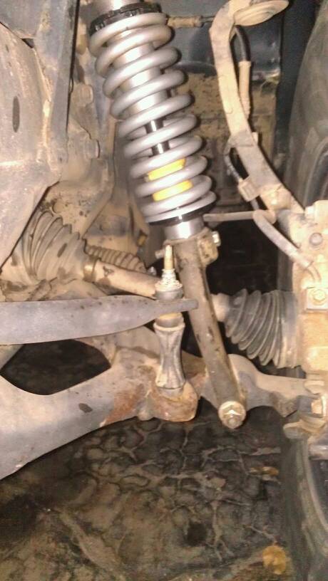

So what's the final verdict on the factory pre-set perch position? is it the same as stock height or not? I have yet to take measurements, but mine are not all the way to the top, so I don't know if they are pre-set to some lift, or if they are at stock and these can be, in fact, used to lower the truck.
KE7WOX
Posts: 1226
by ErikSS » Sun Nov 24, 2013 9:38 pm
I had marks 3".... And seriously collapsed springs. All I can tell you is that the Radflo at factory preset was the same as my 3" lift and collapsed springs. Sorry the information is really useless. I threaded mine down almost to the bottom. 3 1/4" of thread above my collar. I didn't gain any vehicle height after 3" so I stopped.

Erik - How bad is the angle on your CV joint?
firefox2501
Posts: 208
Location: VA, Chantilly
by ErikSS » Sun Nov 24, 2013 9:51 pm
I don't find it too bad. A lot! But no bind.

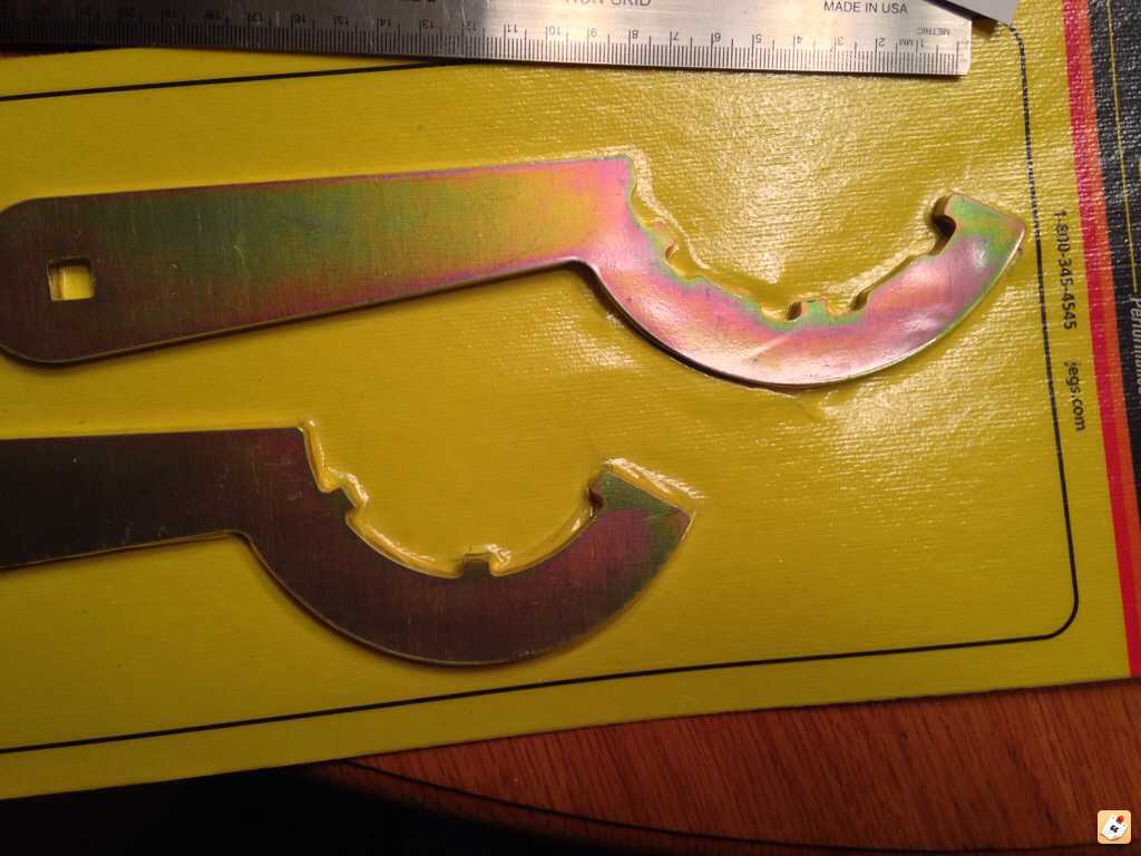

by TBYODA » Mon Nov 25, 2013 12:22 pm
I got mine today. If any one cares they are 18 3/4" from end to end and the upper spanner fits them. :mechanic:
