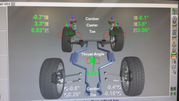

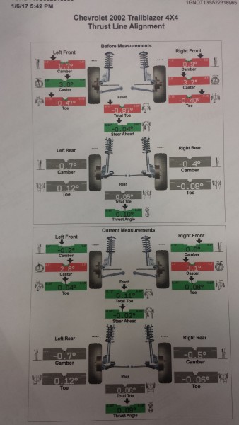

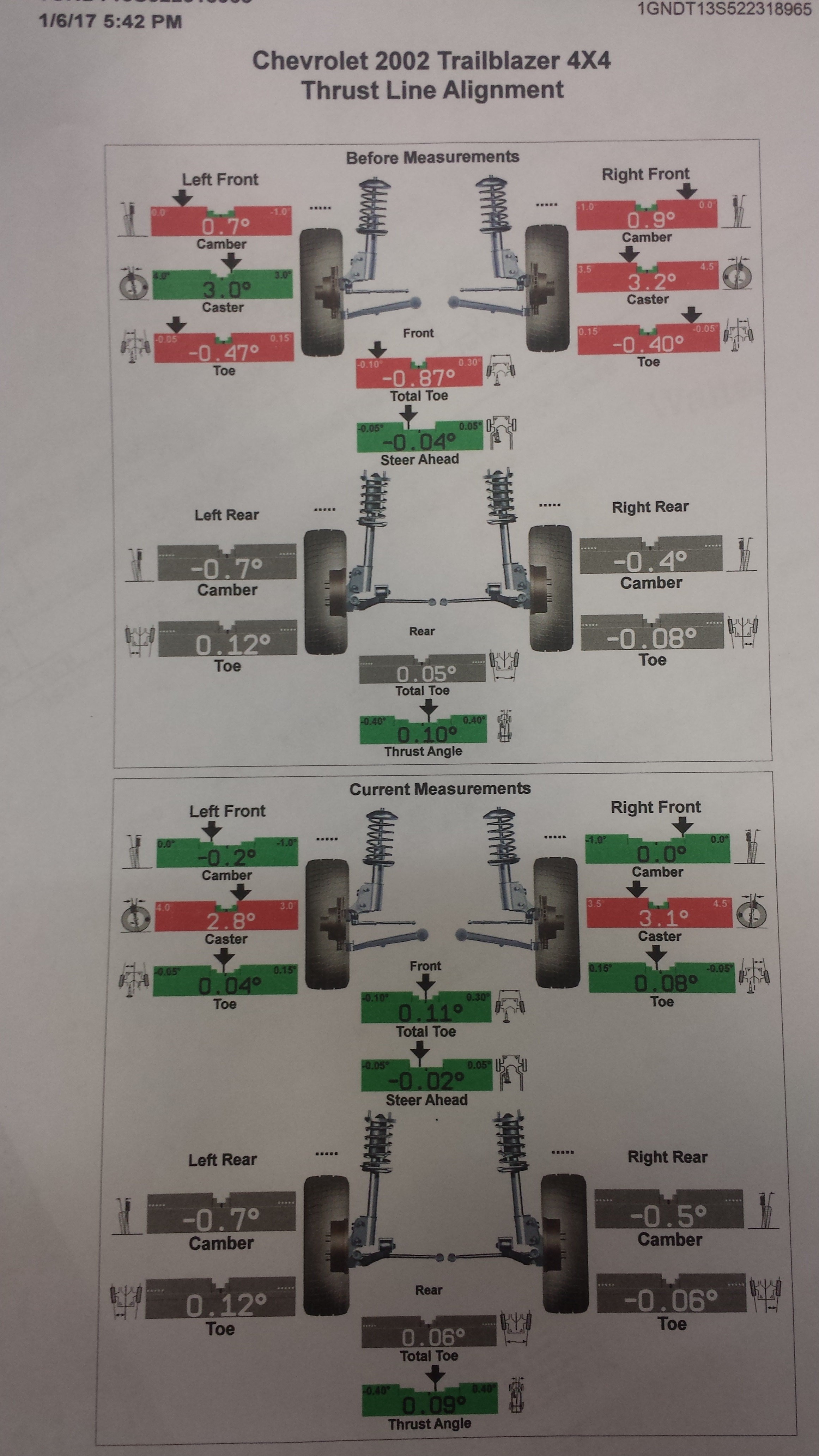

HARDTRAILZ wrote:I had exactly that and an alignment cured it.
--when you say you set the alignment...Its prolly not good enough unless you work at a shop with an alignment rack. Also you definitely need an alignment after flipping the UCA.

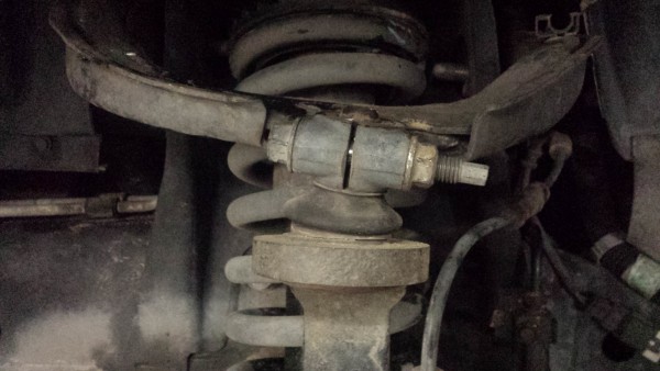

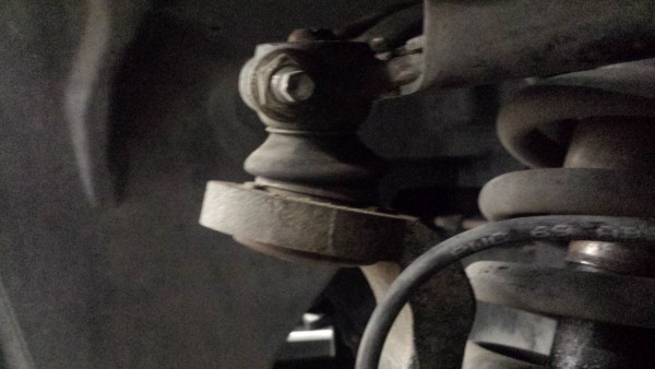

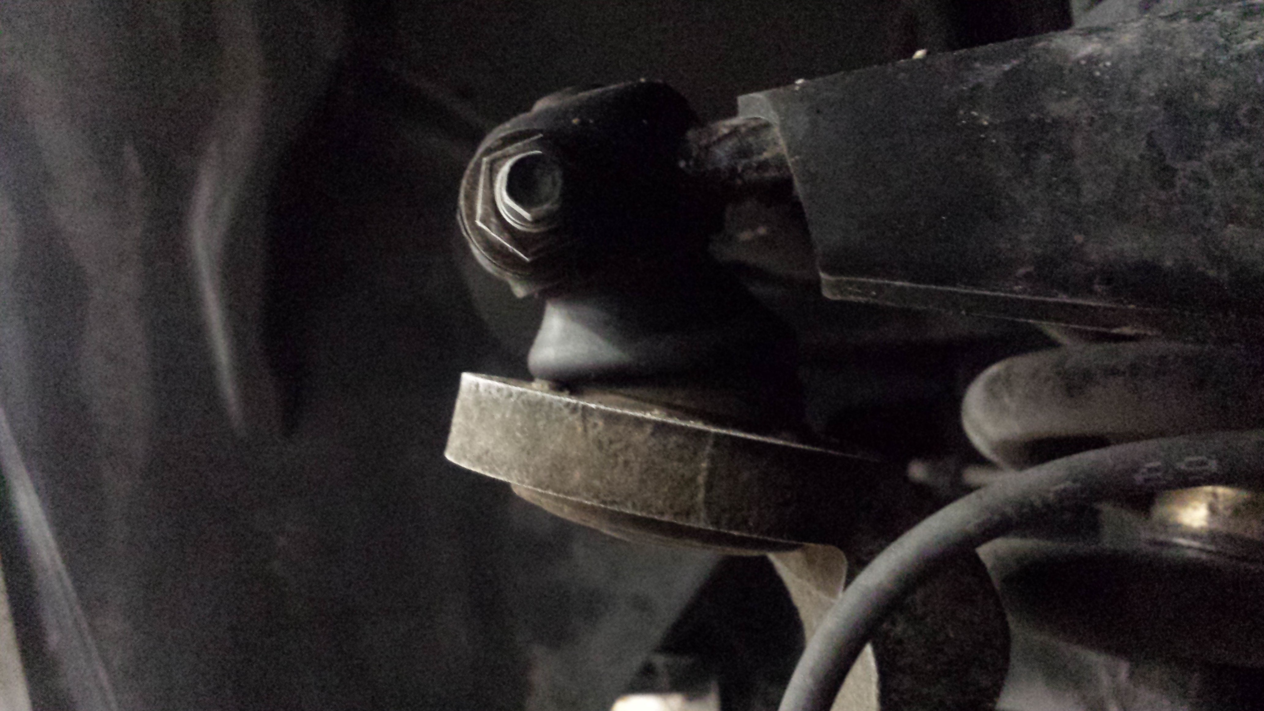

HawkeyeC25 wrote:So i couldn't tell from this post - did you already flip the UCA's??
Something that isn't mentioned much on here is how the UCA flip actually pushes the upper ball joint out and creates positive camber. This is a GOOD thing, because after the alignment, the lower control arm should have to go out to compensate. This relieves a little of the aggressive CV angle we get after the lift.

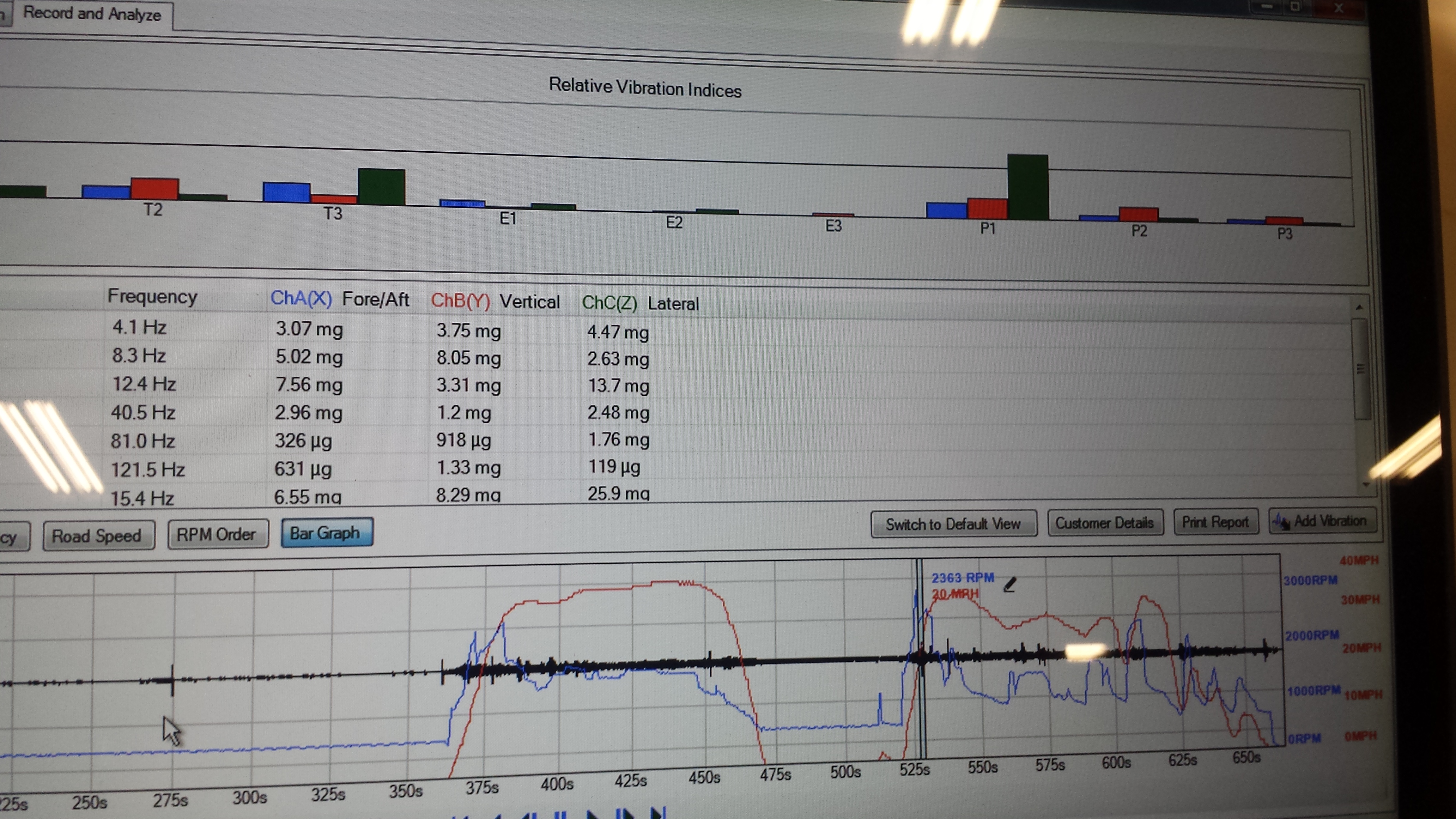

Neat software btw! You're definitely at Tire RPM (~4hz @ 20mph) plus its harmonics. I'd be willing to bet you'd see it light up at 24Hz at this speed if all 6 rollers of the CV are bottoming out throughout the rotation. It also makes sense that it's CV if more torque increases the amplitude since it would lift the front of the vehicle more and accentuate the CV angle.

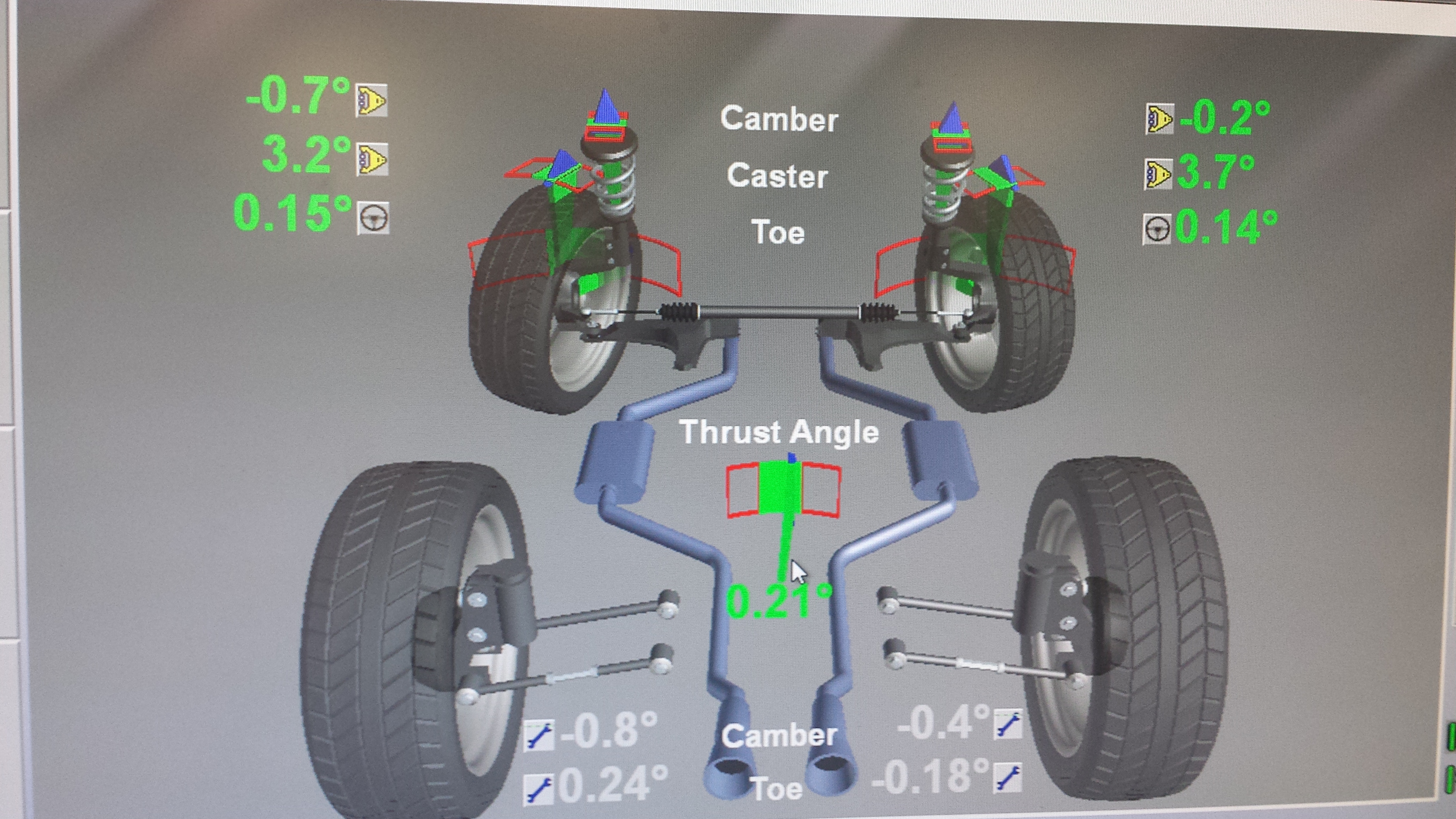

It was all over the place. I worked it around a bit deciding how much camber I wanted vs caster. Flipping the UCA's cost about 2 deg of caster and pretty much maxed out the adjustments. There is a little wiggle room in the front for caster but that's it. The drive seemed good. nice and strait no pulling or wandering. The real question is did the lateral shake go away.......Nope
