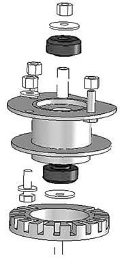

Not exactly sure what you're talking about. Do you have BDS or Marks or some other?
If the layout of what you have is anything like BDS, the stack up should be just like whats imaged below.
BDS setup.JPG (12.36 KiB) Viewed 9771 times

by Jmar2007 » Wed Jun 25, 2014 1:53 pm
The center washer was the one I had on top to begin with but it went right thru the upper hole and was rattling. I have the large washer on top now because it seats against the hole and is tight with no rattling. I will try to take a picture when I get off work if its not raining. Does anyone have a picture of theres they can post to me so I can compare?

by Trail X » Fri Jun 27, 2014 2:23 pm
If that's the case Jared, shouldn't the upper mounting hardware for the front strut be exactly the same as stock? Or did your kit come with new strut mounting hardware?
Per my understanding, the larger washer needs to go on top in order to handle the extreme impulse loads that the shock experiences when the suspension hits full droop.
