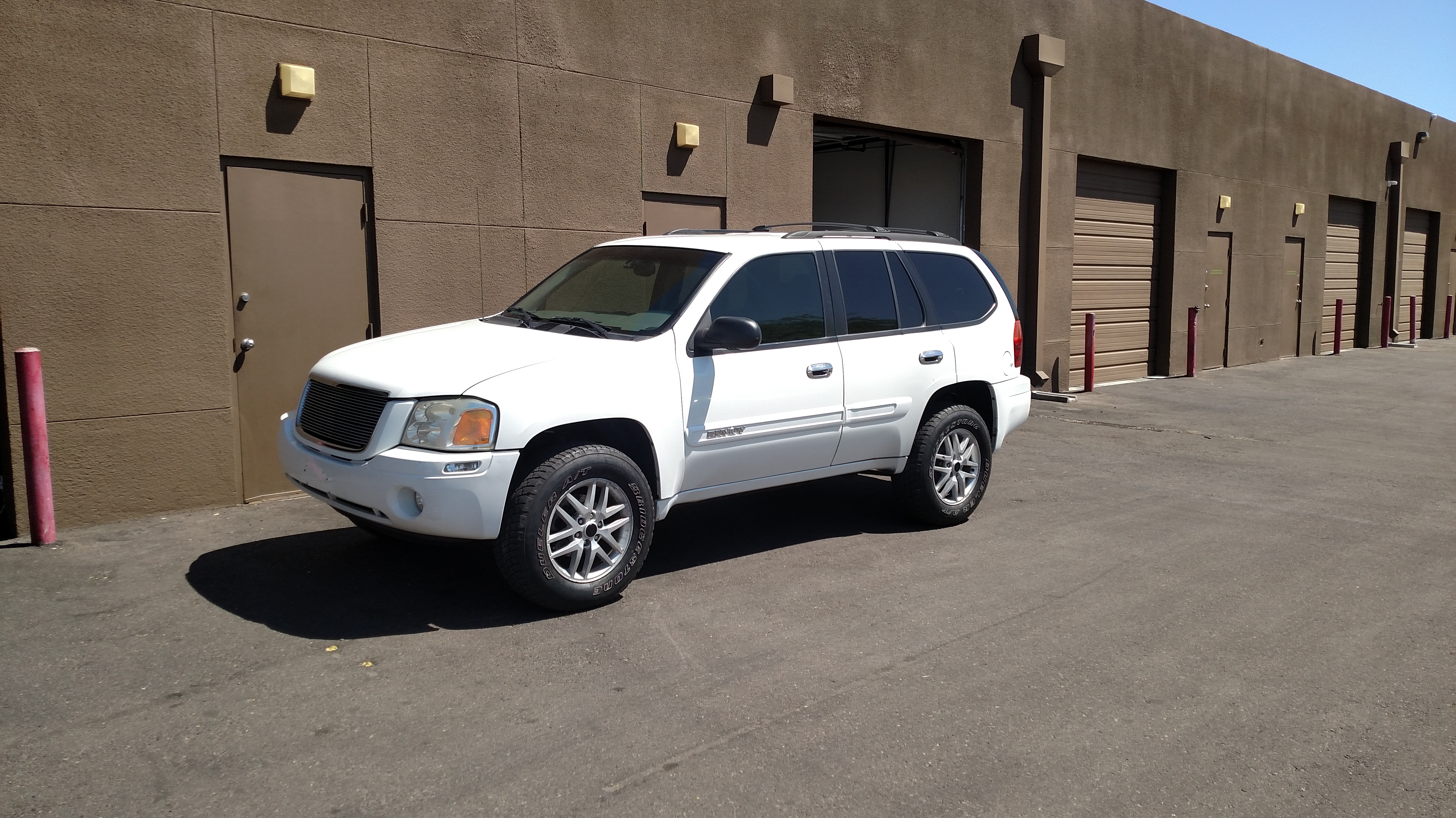

by Tricguy007 » Sun Apr 15, 2018 5:25 pm
I just bought a set from the Lug Nut Guys on eBay and they even have 12.9 studs only hub centric

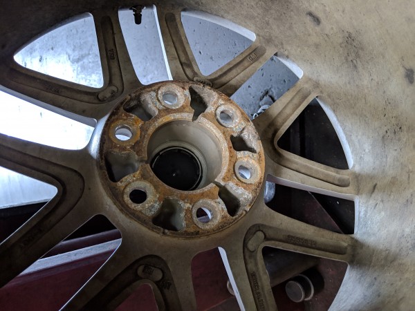

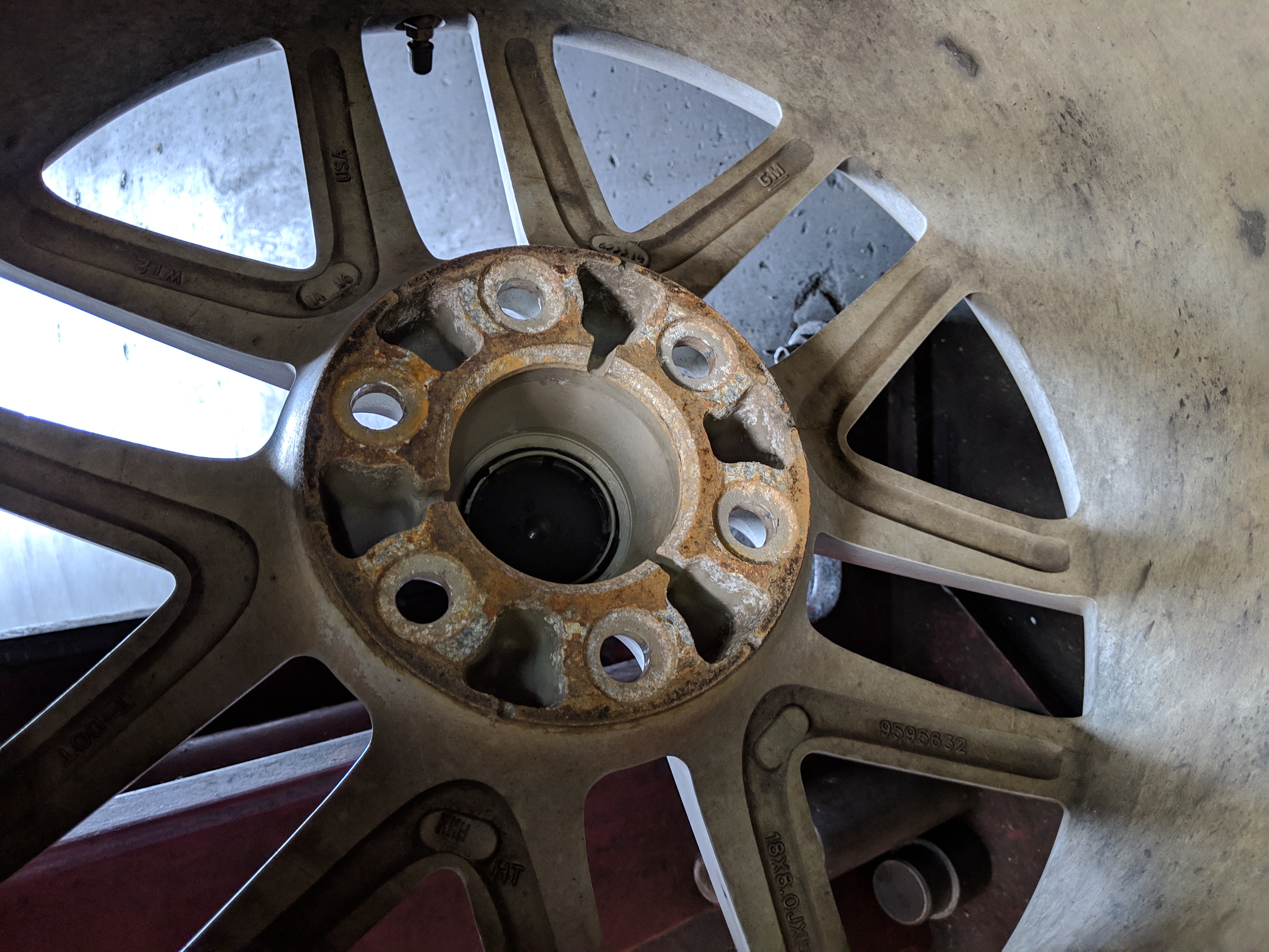

by Tricguy007 » Mon Apr 16, 2018 12:36 am
If you use Saab 97x wheels you don't need to cut the wheel studs, spacers I'm running 1.25" spacers, the wheels have a pocket between the stud holes so the .25" the studs stick out doesn't interfer with the wheel
