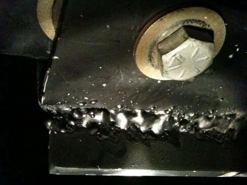

post pics of the welds
by Hpimichael02 » Sun Oct 10, 2010 8:38 pm
The welds were nice and he decided to go on top of them for some reason, you could see the penetration on both sides of the metal so it's def welded together

Sorry pics from iPhone with flash light

I'd grind those welds and maybe lay a nice steady bead over the top of em... I'm no pro though.

by bartonmd » Sun Oct 10, 2010 8:54 pm
Those are known as "booger welds"
Grind them flat and weld them for real... Or better yet, get it all prepped (ground and paint removed), then take it to a welding shop and pay the $15 minimum charge for them to lay a couple fat beads down on there...

yeah, um... I'd seriously reconsider doing much even driving around with those welds holding the bumper on... From the looks of your flux core welds, I'd much rather have it fully welded on with you running your flux core welder, than your brother running his 220 MIG...
by Trail X » Mon Oct 11, 2010 8:56 am
Those welds are pretty bad looking... was he doing it blind?
But I still highly doubt that it's the WELD that is making the noise... probably a bushing.

I agree, but it needs to be fixed...

Hpimichael02 wrote:The welds were nice and he decided to go on top of them for some reason, you could see the penetration on both sides of the metal so it's def welded together
Not to come off too rude, but there is nothing nice about that. If that was done with a 220 mig, it looks like he had the gun about a inch or two away from the weld with epileptic seizures. :shock: . Like Mike said, GET IT FIXED.. and don't winch with it,... kinda scary :? !!

Please just get some proper welds on there before someone gets hurt with that thing. It may seem solid up untill it falls off the truck, Im not trying to be mean but those welds suck and I wouldn't trust the weight of the bumper on them let alone using the bumper.
