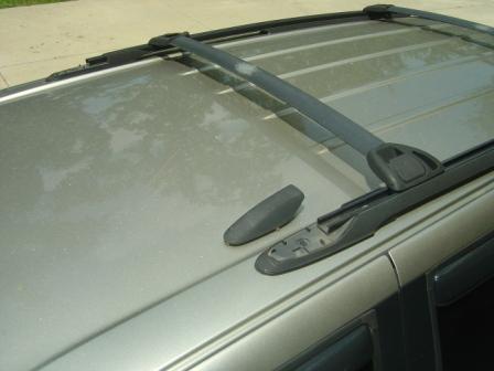

Ok I know its been done a hundred times but here is my current mod and how I went about mounting the light bar.

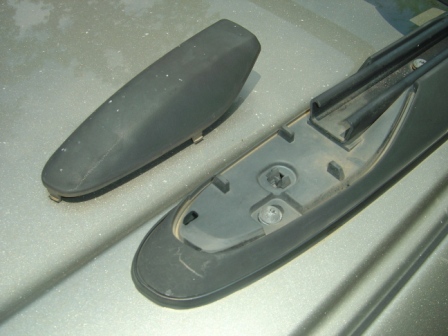

First I have to not that if you have an older TB or Envoy be careful when removing these bolts. My front passenger side was rusted to the nut that is pressed into the sheet metal which made this mod a pain in the a@*.

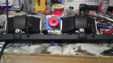

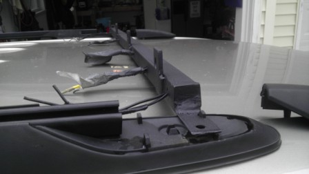

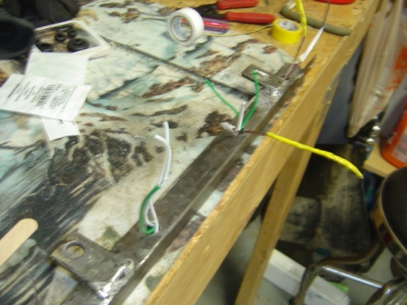

using square stock I just lopped off the ends leaving a tab for the mount to the roof bar. Welded tabs for the lights and drilled the entry holes to run the wire inside the bar
No body had mounted to the front bolt yet

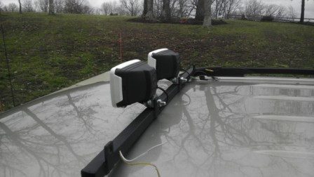

by Jimbo121 » Wed Dec 21, 2011 7:19 pm
I wish we could attach more then three pics :facepalm:

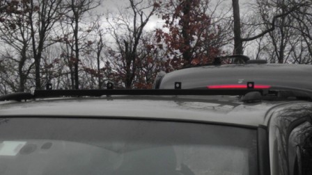

keeps it nice and close to the roof line to eliminate wind noise

by Jimbo121 » Wed Dec 21, 2011 7:24 pm

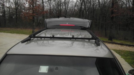

Still waiting on the other two 550s, the bar is attached to the roof with the front mounting bolt of the rack slide. it is sandwiched between two grommets to cut and vibration. Even at highway speeds it doesn't cause any noise at all.
Even my squad car roof lights caused noise at 70mph!!!!

I used that same method for part of my half-roof rack. Seems to hold well, but I was a bit worried about pulling out one of those rivet nuts. I guess I could always pop a new one in.

by Jimbo121 » Mon May 21, 2012 6:17 pm
Welding the ends shut and running the wiring inside the tube, using gromits on the wires as they exit the tube are all things that I did to limit that. I have to say I haven't had any noticeable noise.
