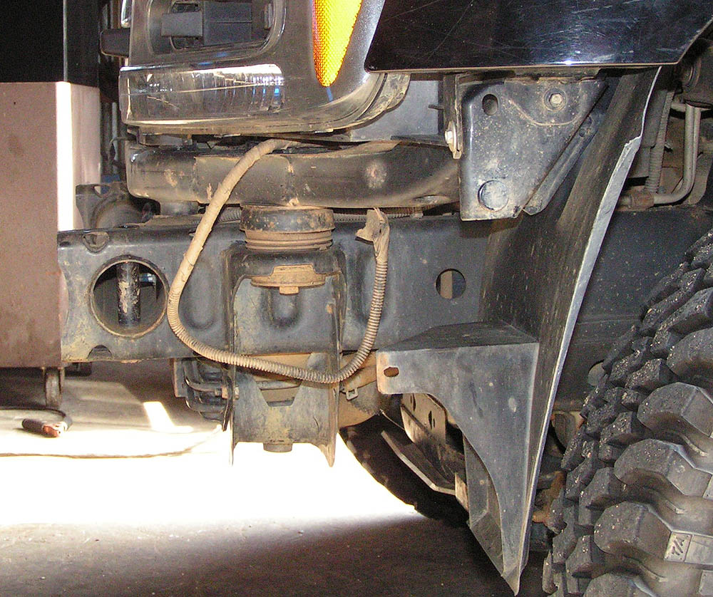

A design/ technical question for you Mike: Some of the bumper manufactures who do not want to even consider doing a TB bumper make a big deal out of the fact that their shackle mounts are not just welded to the face of their bumpers, but a hole is cut in the front face and the shackle mount goes thru the hole and is welded to some internal part(s) of the bumper as well as welded to the front face. I do not have enough knowledge to know if it makes a real difference, if it is a ease of production thing, or if it is just advertising hype. Which style are your shackle mounts and why?
IMO, it's not just fluff... There's just plain old "more weld" if they go through and weld on both sides... Plus, if they're just welded on the front, you're putting tension on the welds, instead of shear and compression if it's welded along the back... On Kyle's bumper (and the way I plan on doing all of these), the shackle mounts are actually 5" long... 2" sticks out the front and the other 3" is in behind. It's single-pass welded around the front, then tripple pass welded around the back, then along the top edges, it butts up against the bumper crossmember that mounts to the top of the frame, and it welded all 3" long to that, on both sides...

Pretty sweet Mike. Would it be easier to just manufacture the front in 3 pieces?
Also... just a suggestion, but can you bring the vertical bends inward a bit to line up with the headlight inner edge? I mean... I'm not a potential customer :raspberry: , but I figured I'd offer it up as an idea. Your complication may be the frame position? I know you want to use the bottom plane as part of the mounting system, right?
As for mounting a winch in there... with the front face only sticking out 1" from the frame ends, I think it'd only give you 3" max between the frame tube and the front of the bumper. There just isn't room unless your bumper sticks out at least 7" more.
by bartonmd » Mon Jun 21, 2010 1:30 pm
JamesDowning wrote:Pretty sweet Mike. Would it be easier to just manufacture the front in 3 pieces?
Yeah, that's how I'm doing these... It'll look the same after grinding the outside welds smooth, but it'll be cut and bent as the center and 2 sides...
Yeah, to keep the bumper closer to the vehicle, and help approach angle, the current 37" (Kyle's prototype is 40") is really about as close as I want to go, as the outsides of the frame are 36".
The bottom of the bumper is on the bottom of the frame, and there is a cross plate right on top of the frame. The If somebody wanted to mount a winch INSIDE the bumper, I would suggest mounting it on top of that cross plate, so there's more room (above the frame cross tube) for the winch, and it sticks up out the top of the bumper...
