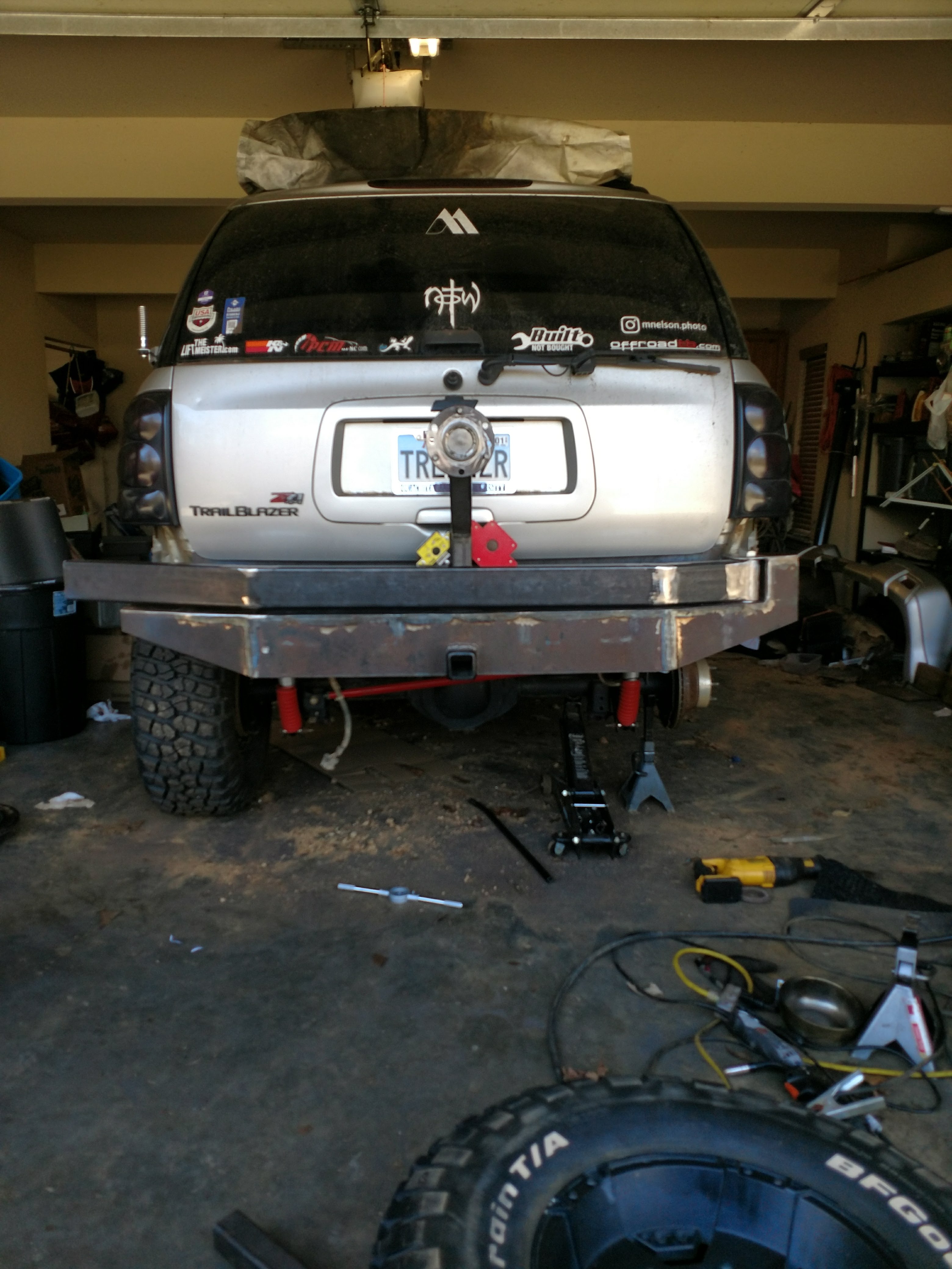

by mason10198 » Sat Feb 03, 2018 4:00 am

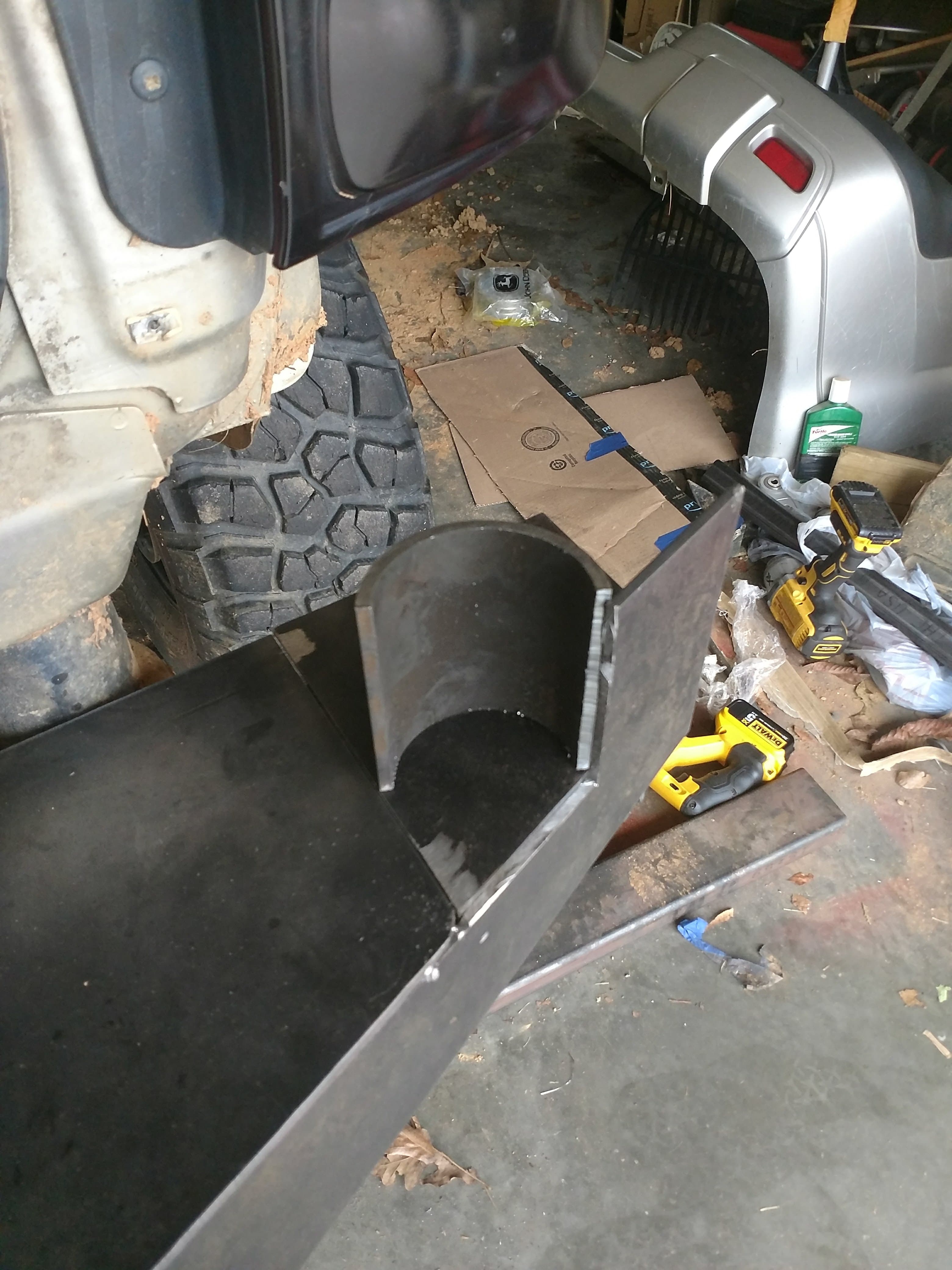

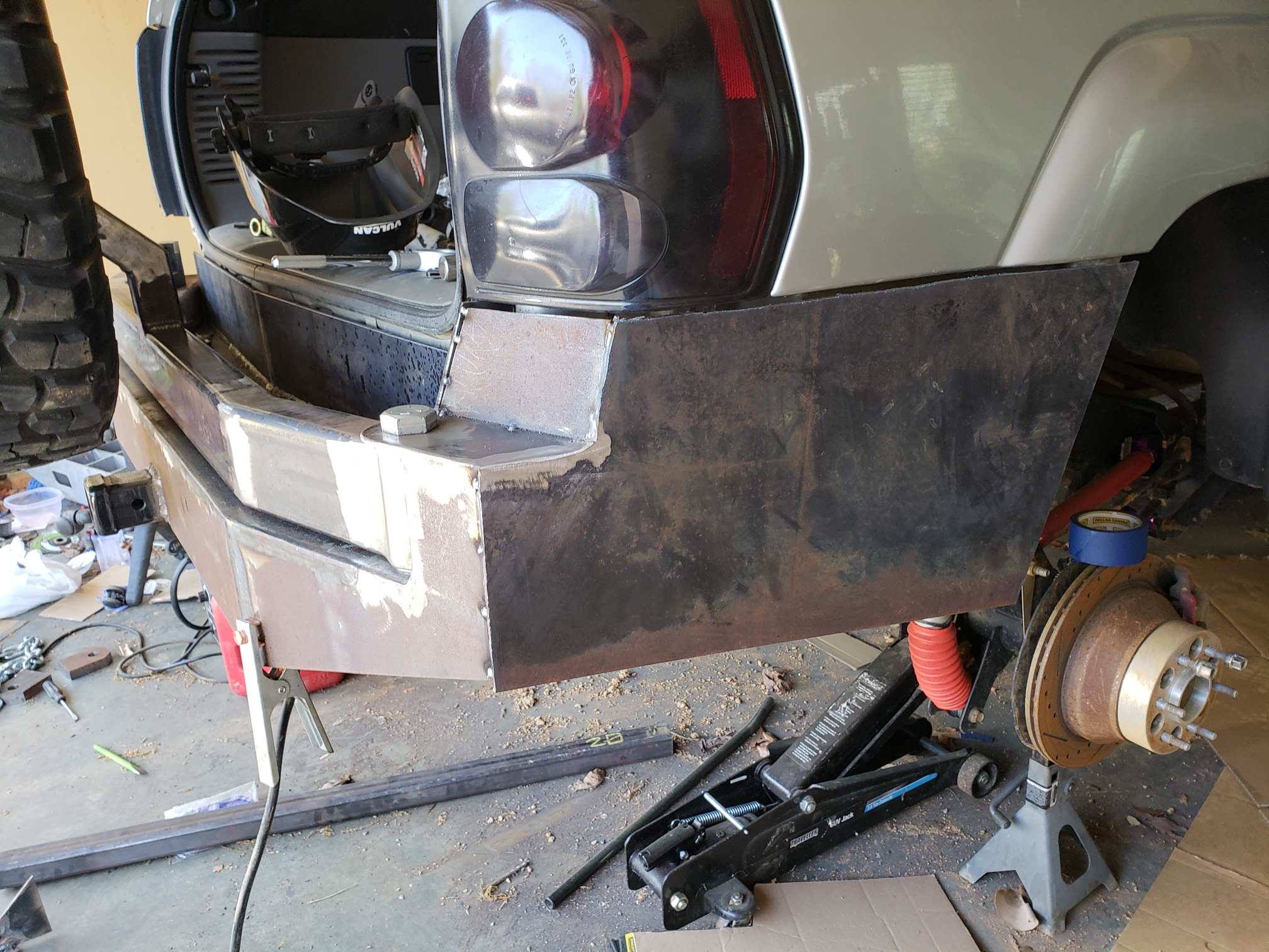

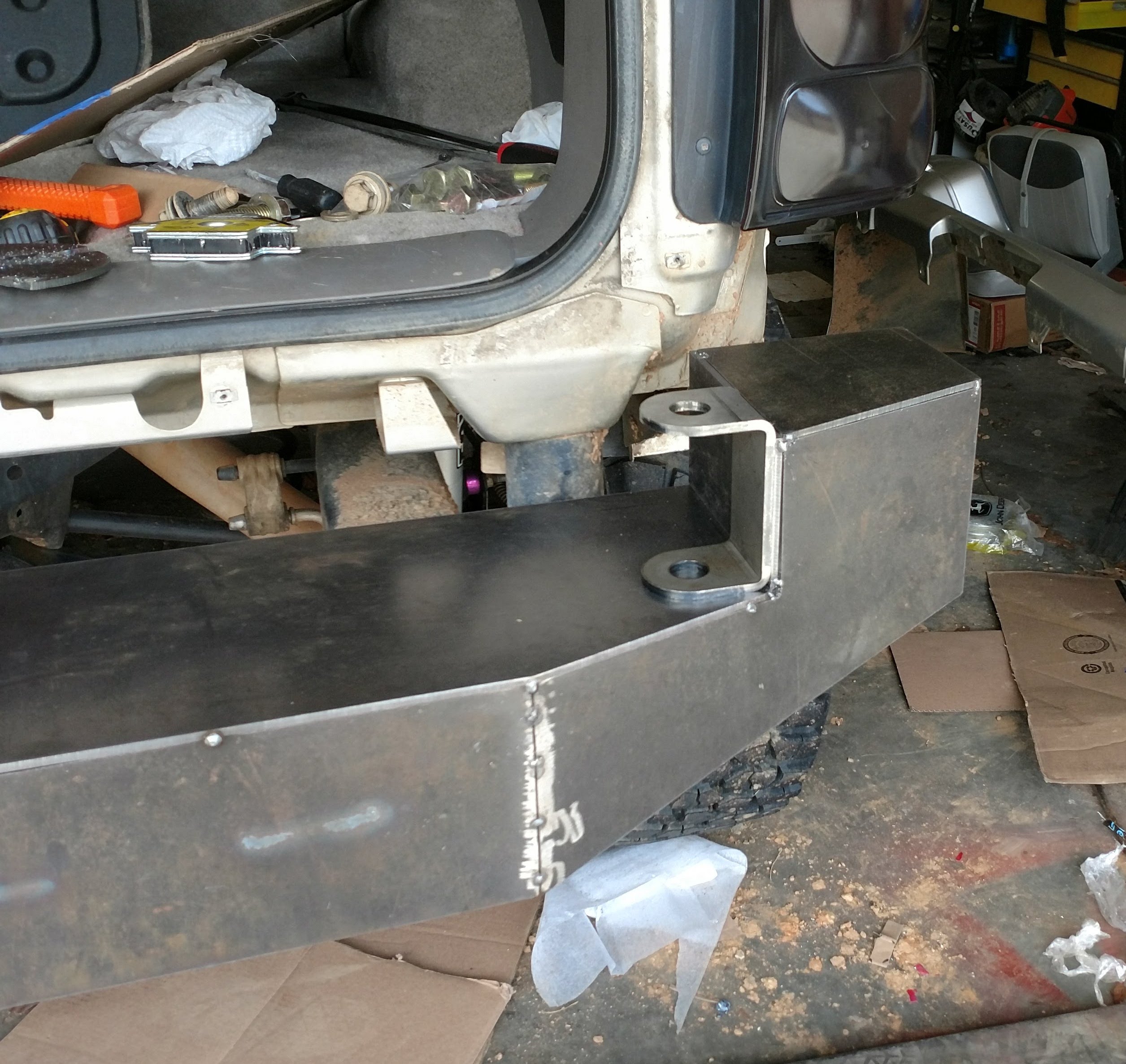

Got the main step plate in! Unfortunately had to cut it as two halves because my CNC isn't big enough to cut the whole thing. Put 2 massive gussets under each "half" (post a pic of those later). Should be getting more done this weekend... It almost looks like a bumper now!ImageImage

Looks like a good start!

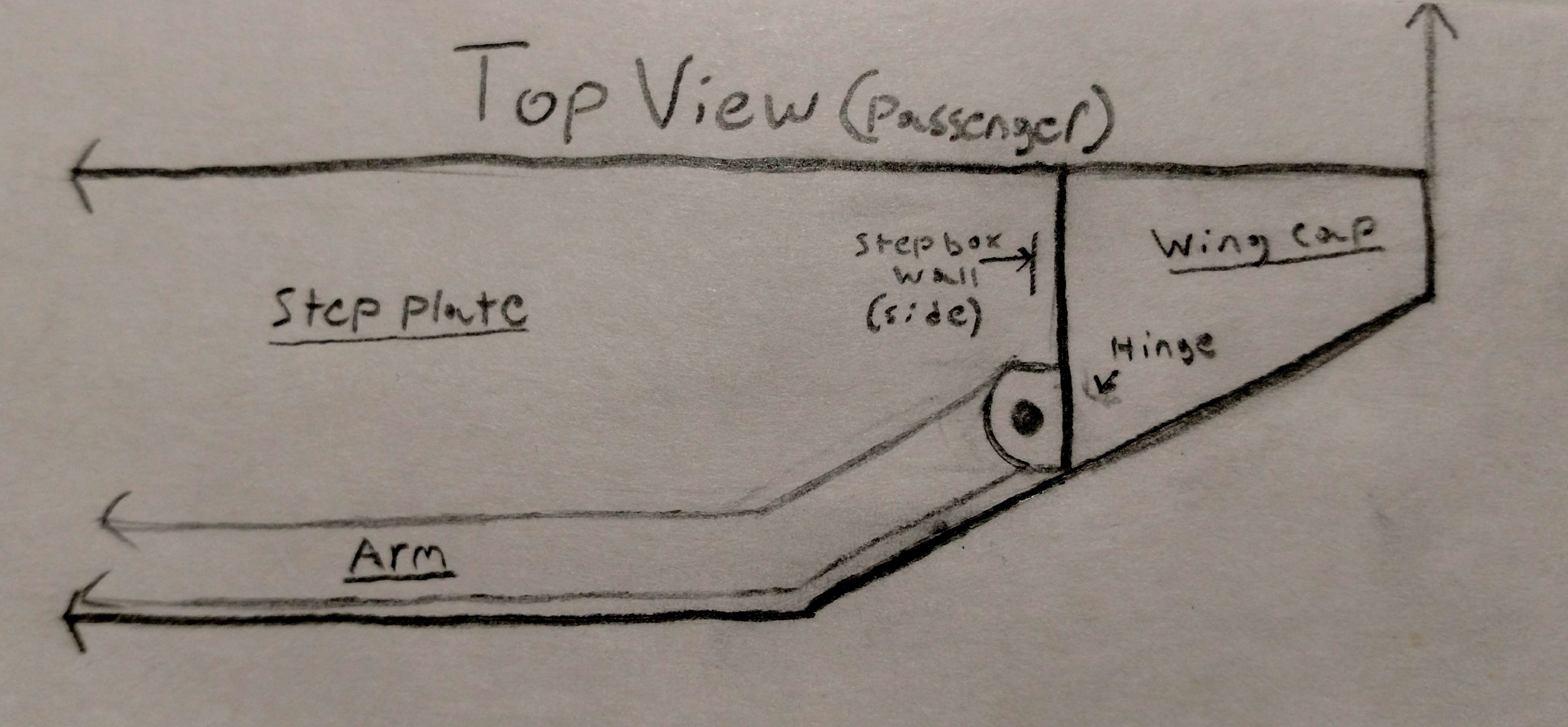

On paper, that would look like this from the top-
idea1sketch

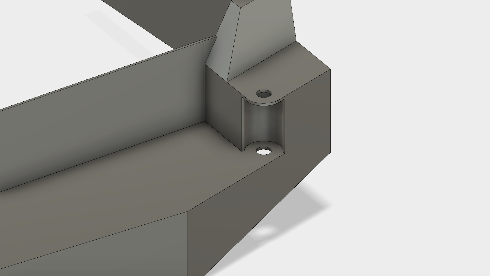

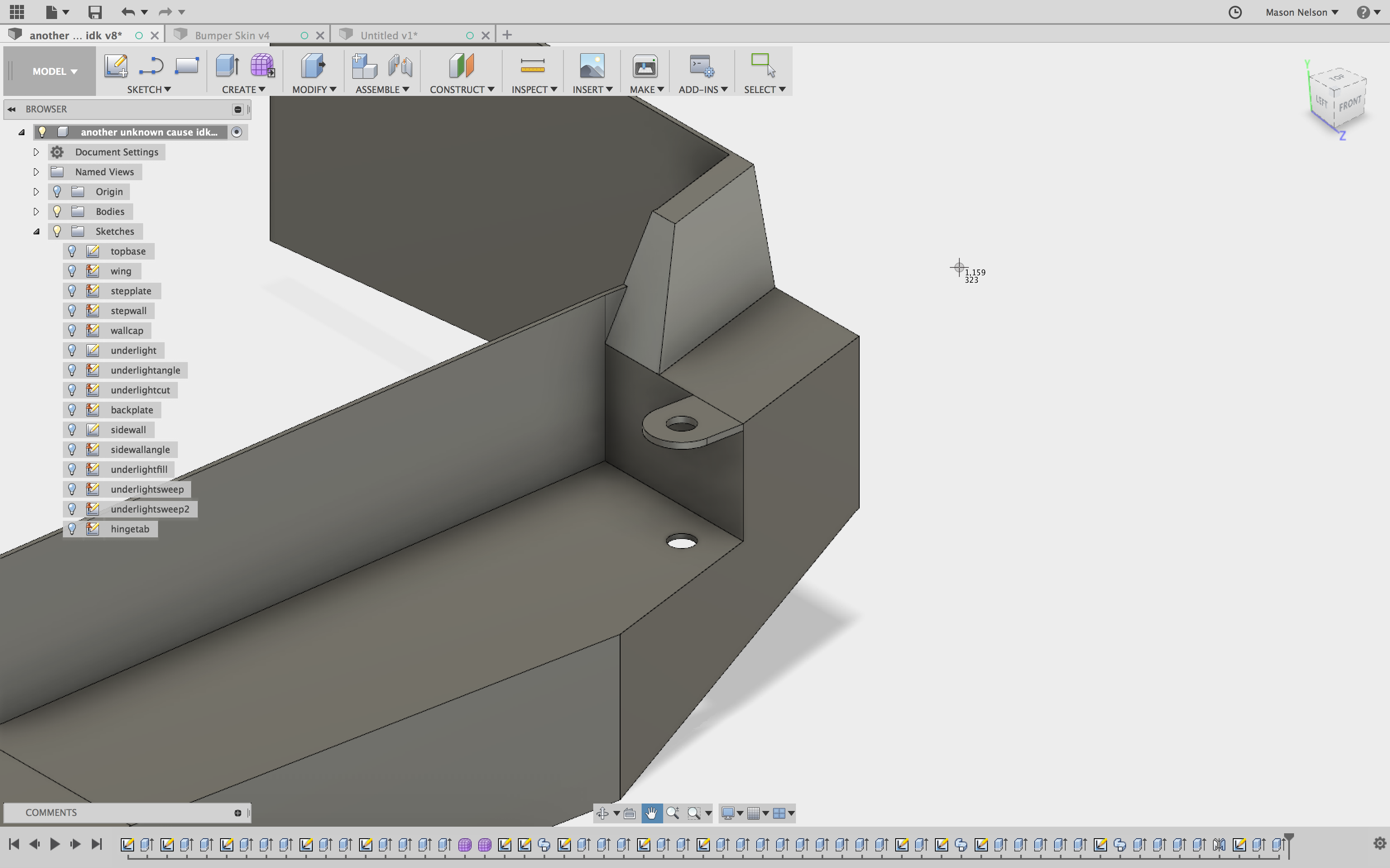

-and when chucked into the Fusion model, looks like this-
idea1model

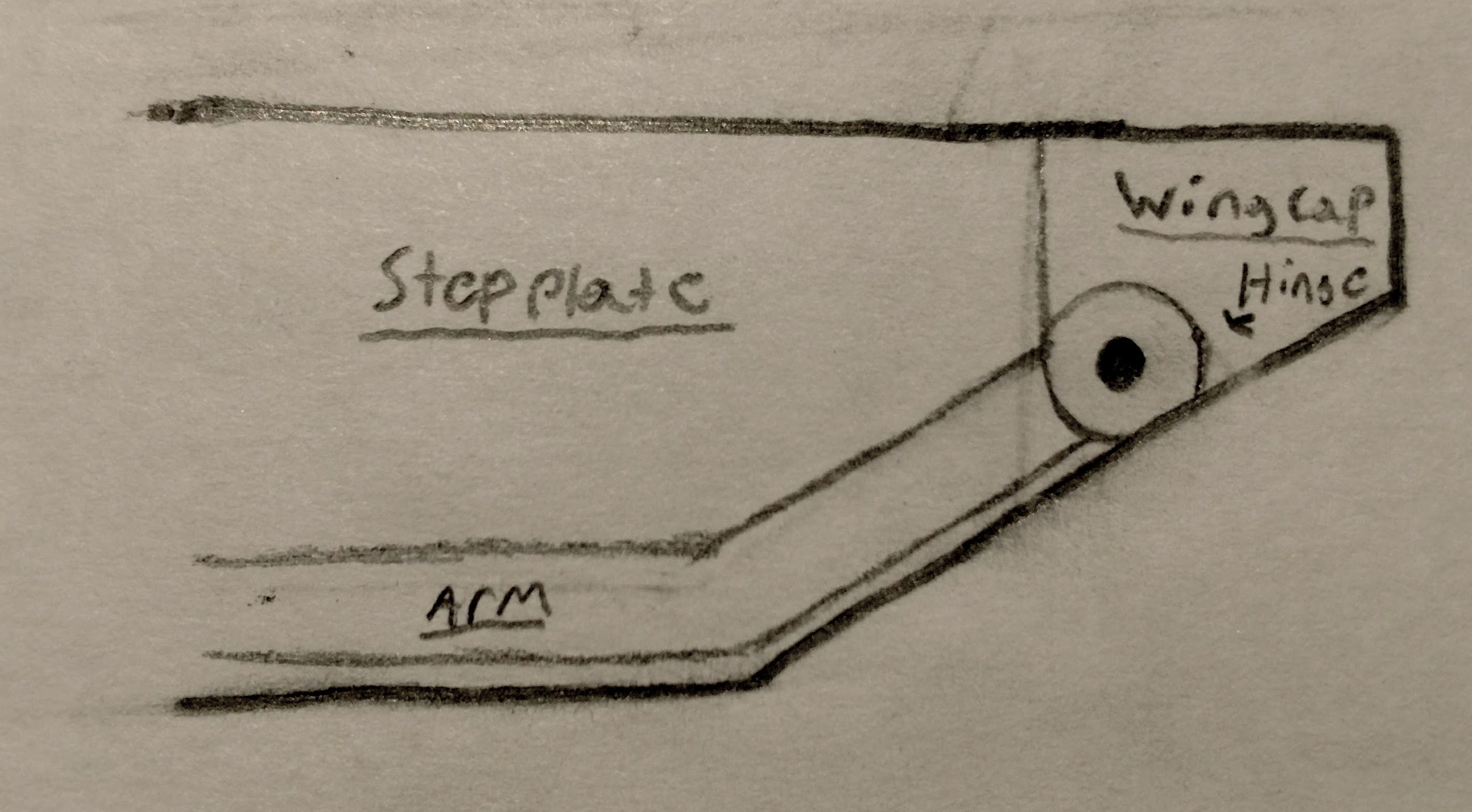

BUT with a little more thinking, I think it might be better to essentially forget that bracket, and just fully incorporate one into the bumper itself. Which would be almost exactly the same as what I just showed above, except 'pushed' towards the passenger side, into the 'box' that the step plate wall and passenger wing come together to make. Which, on paper, looks like this-
idea2sketch

SO, when I modify that idea a little bit to work with my big phat hinge instead of heim links, I get this-
betteridea
-which I think will be a way better option both functionally and aesthetically.

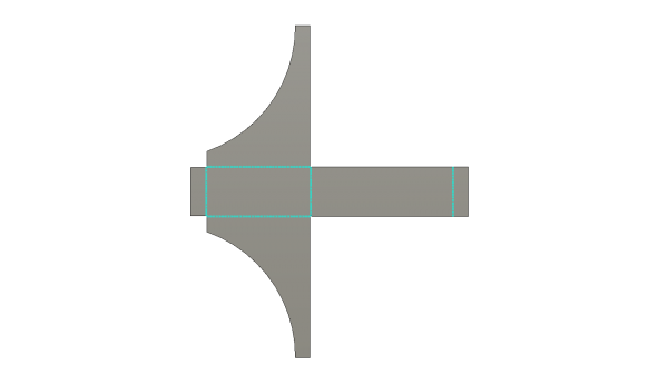

by mason10198 » Fri Feb 09, 2018 3:20 pm
After a little more work in Fusion:
GIFs are so much fun...

by Trail X » Fri Feb 09, 2018 6:15 pm
Looks good, just don't forget to draw in your welds. I think you're going to run into your welds on full open. It'd make sense to also have some space between the between the arm and the step plate. Normally you want it to at least ride on a washer or two so you're not scraping your arm across the step plate.
by mason10198 » Sat Feb 10, 2018 12:56 pm
Yes, I still have to raise everything up a fraction or two to get it to fit, I just hadn't done that in the model yet. Working on that part and the radius today hopefully

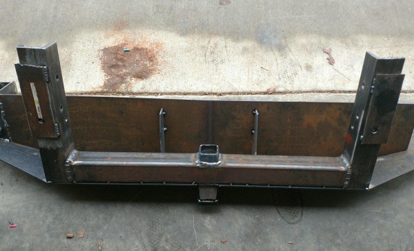

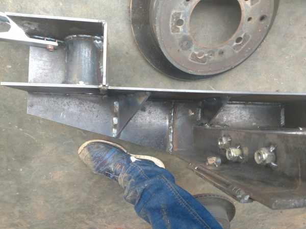

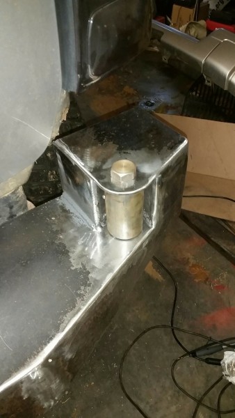

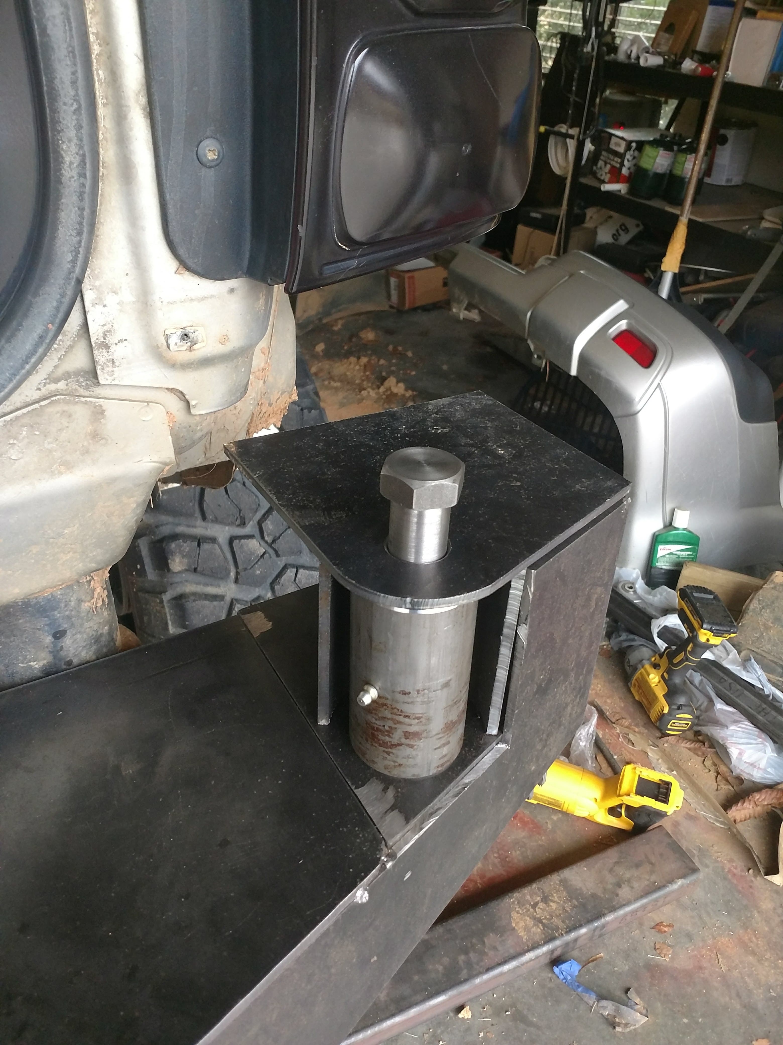

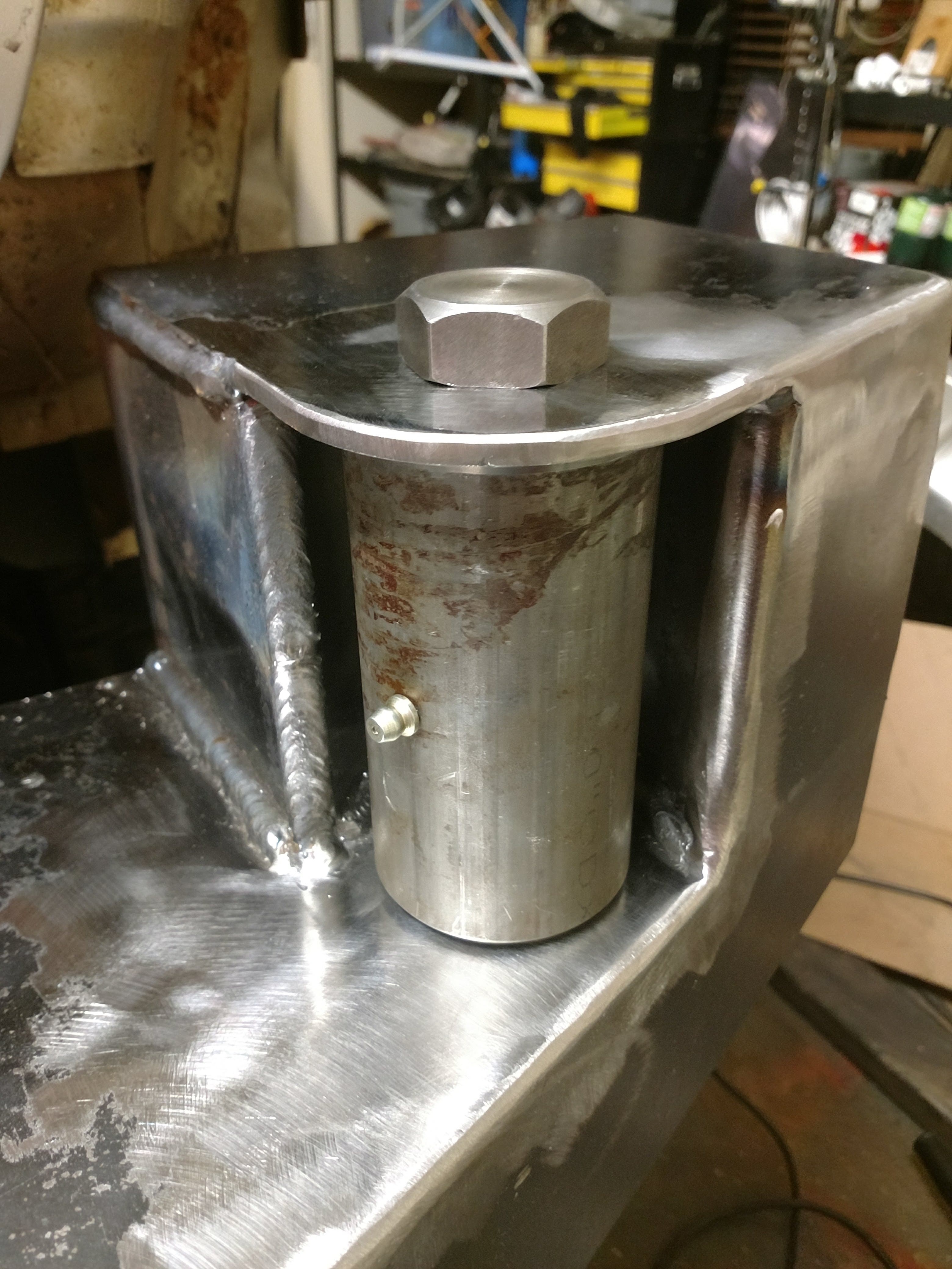

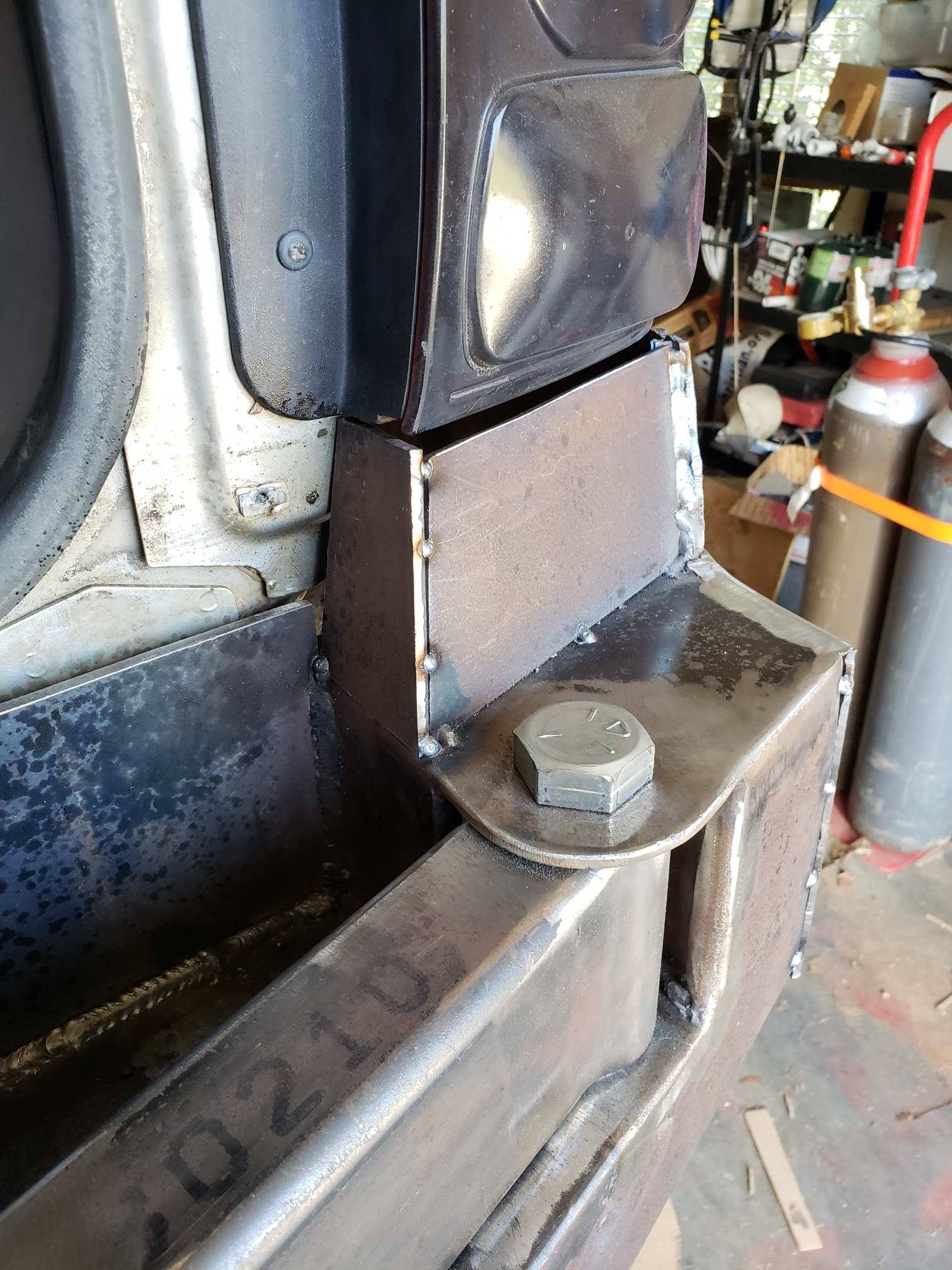

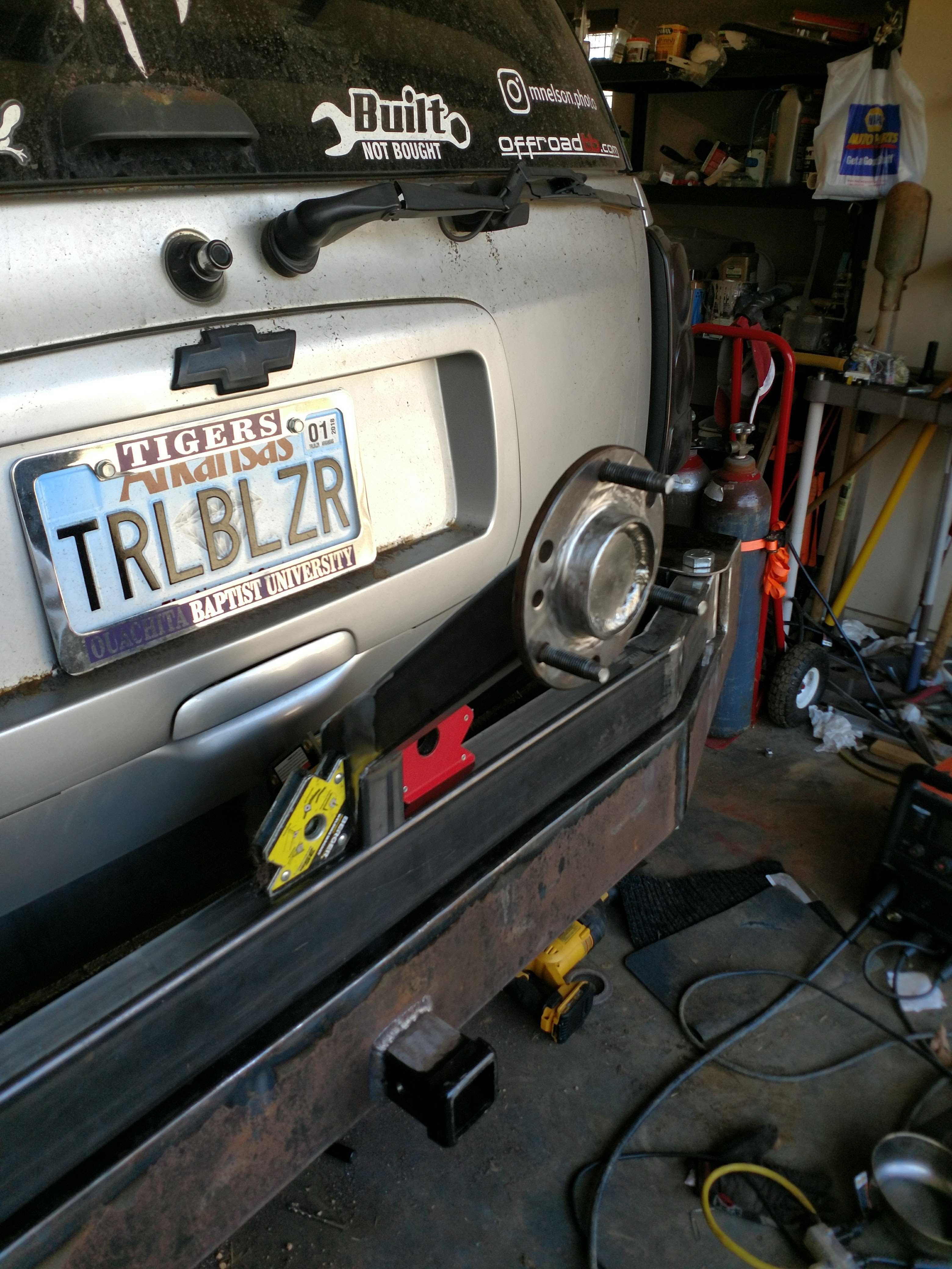

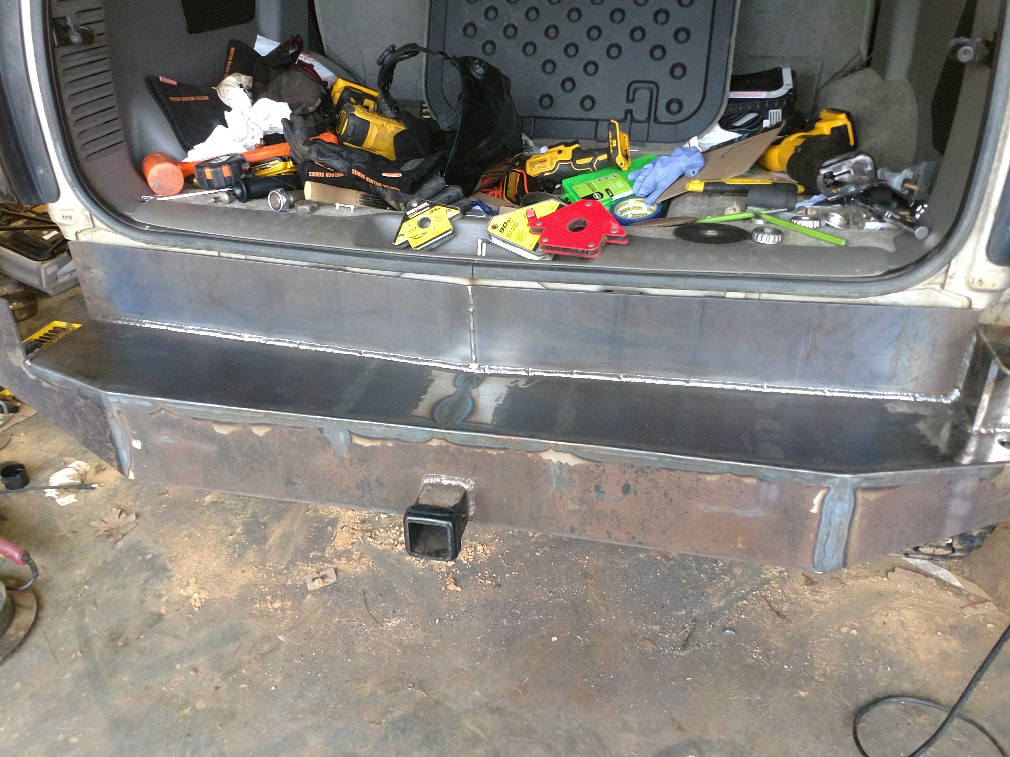

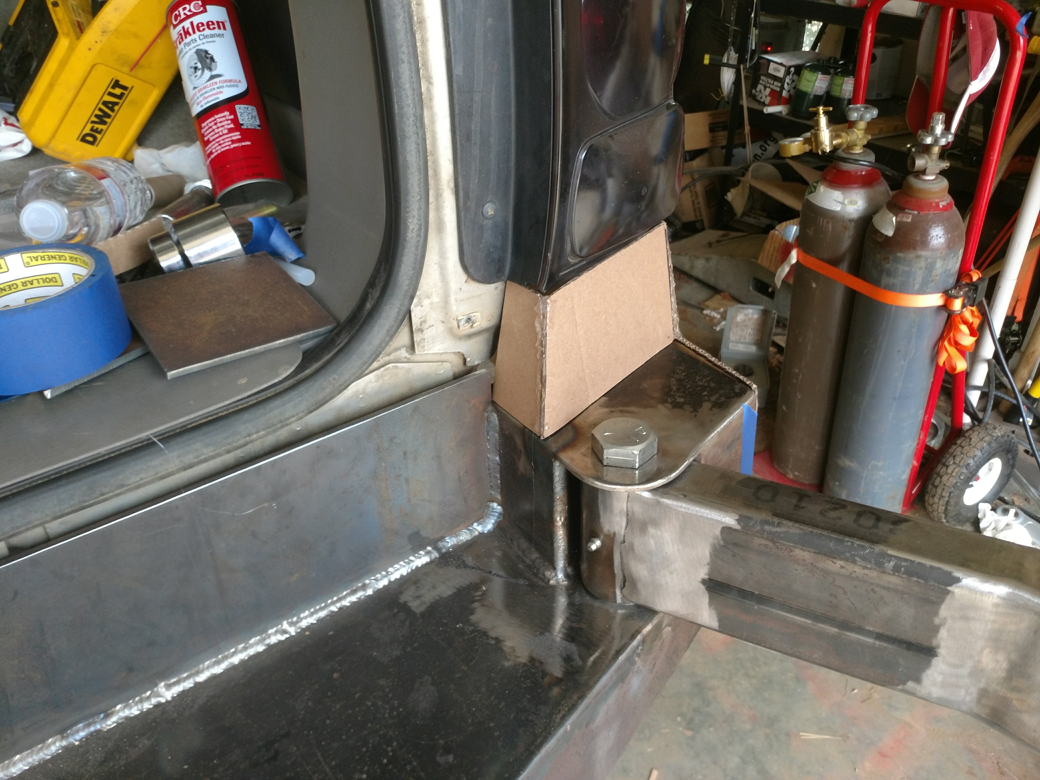

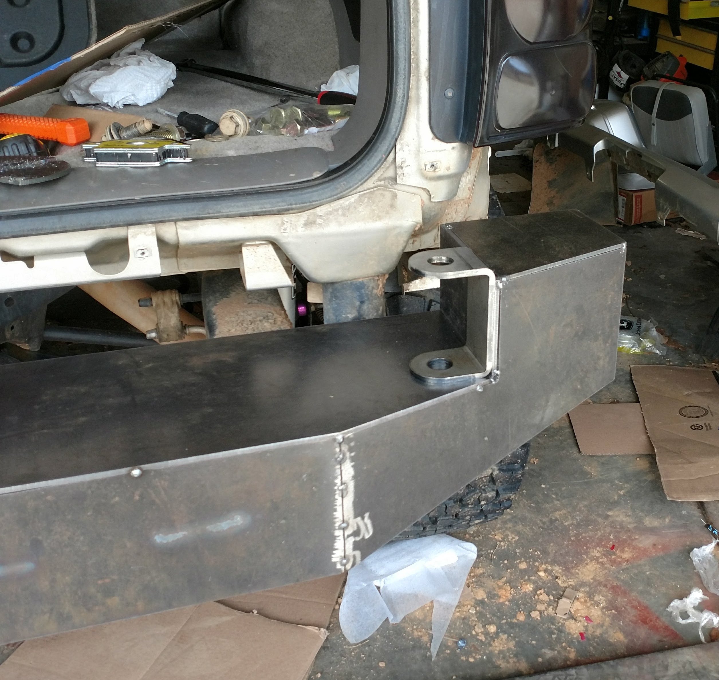

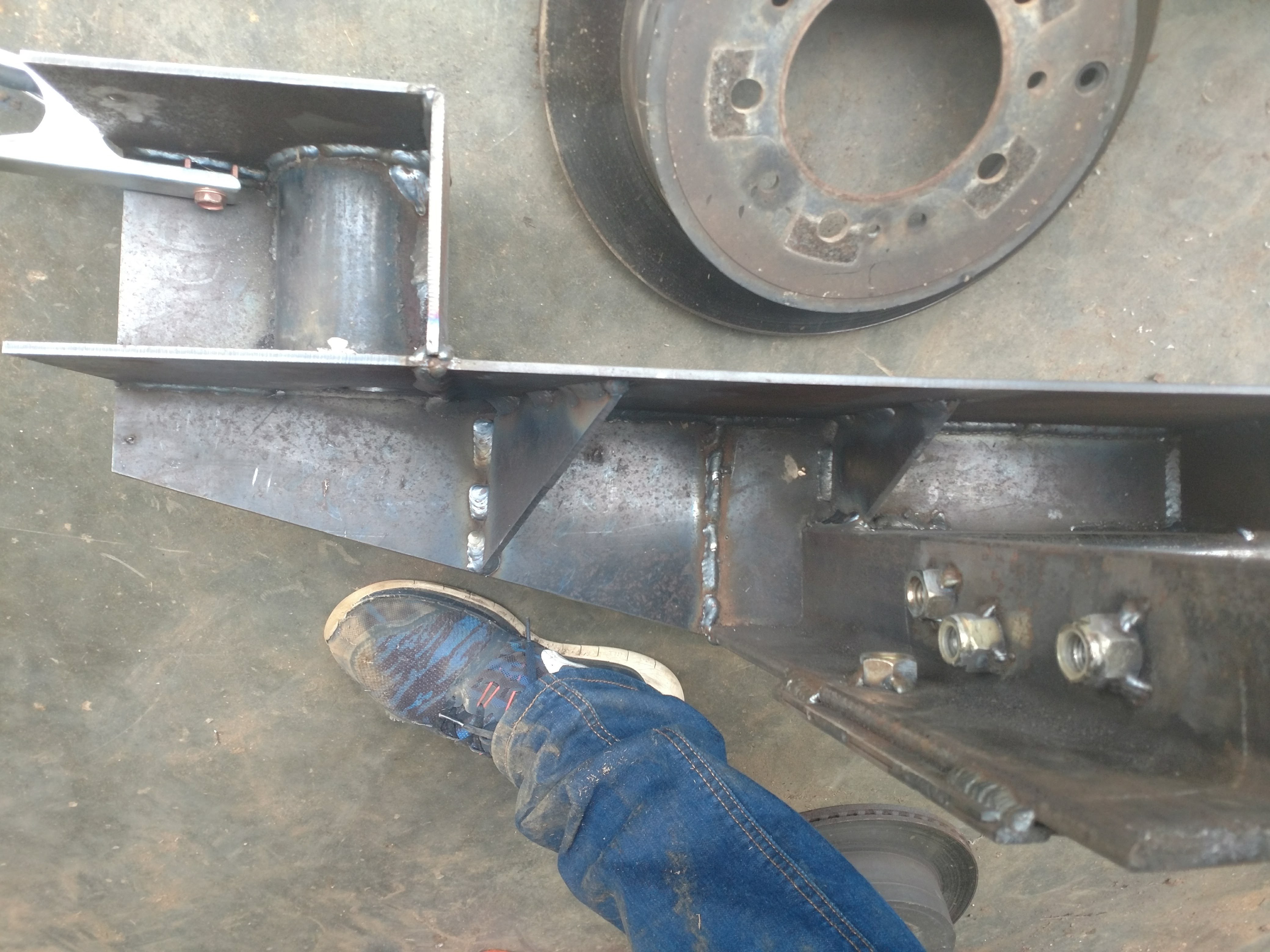

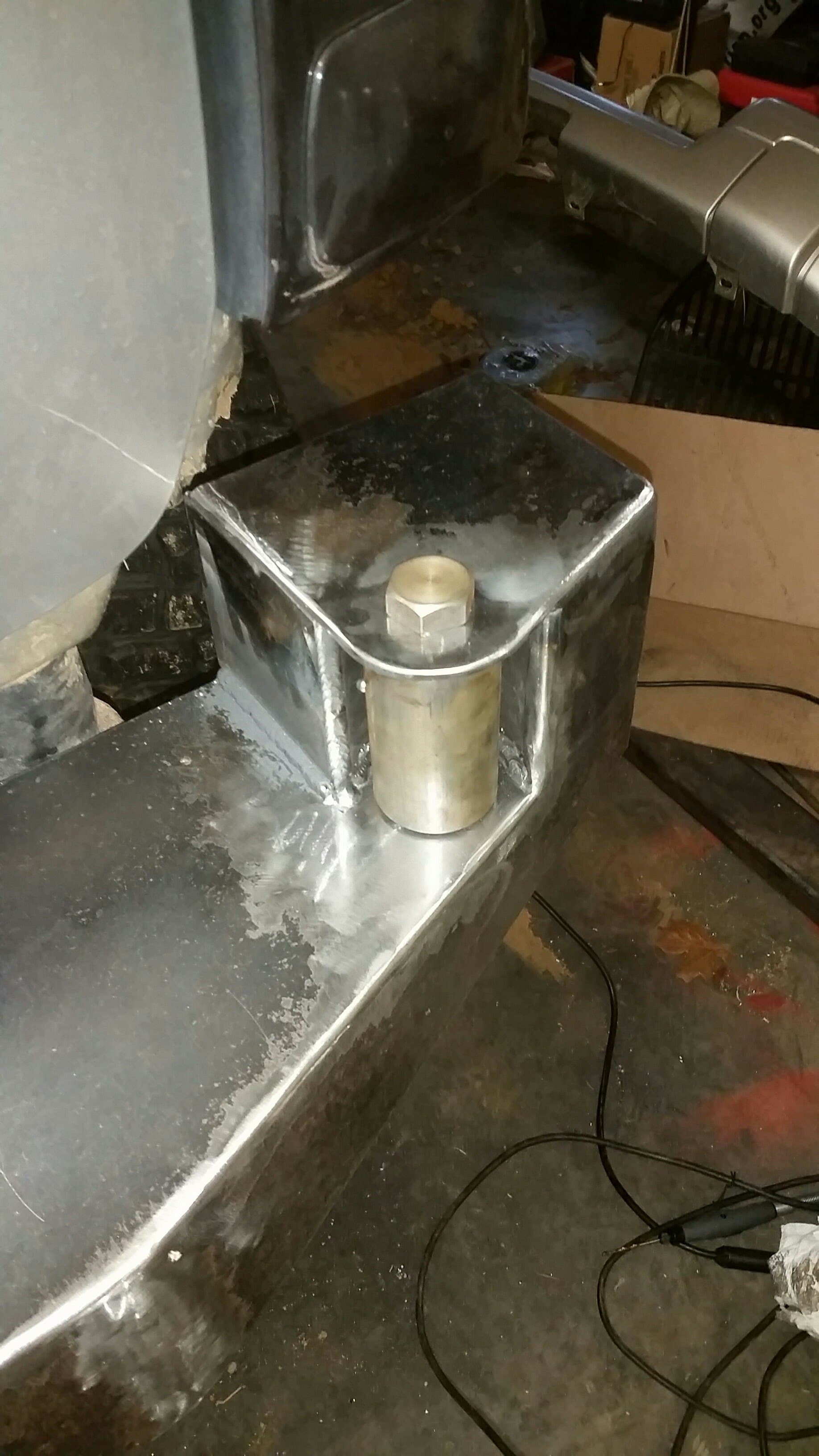

by mason10198 » Wed Feb 14, 2018 5:51 pm
Mostly finished with the hinge side. Nasty welds until the gap fill on the sides of the radius. Underside hasn't been welded yet either, gotta go refill my bottles. Those random looking plates on the bottom of the mounting arms are just spacers to help line up the 90 degree on the angle fit up in the rounded corners of the frame rail, so didnt spend much time measuring or cutting those. Just kinda threw them in there and welded them on.

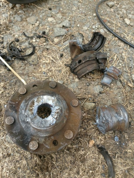

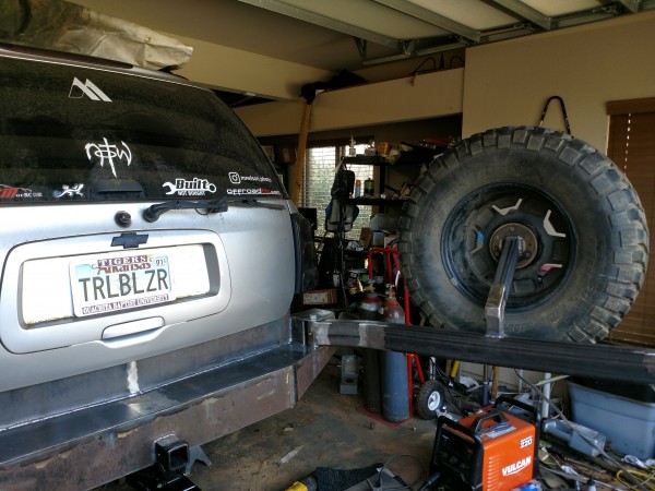

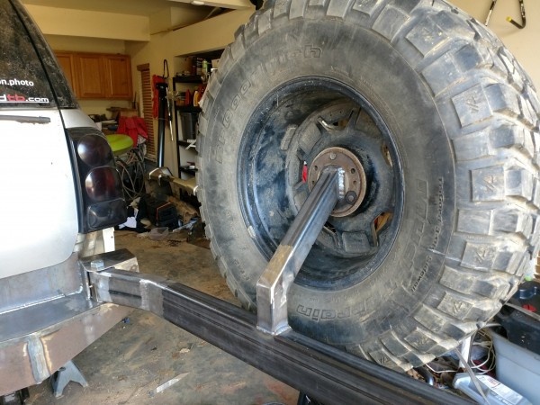

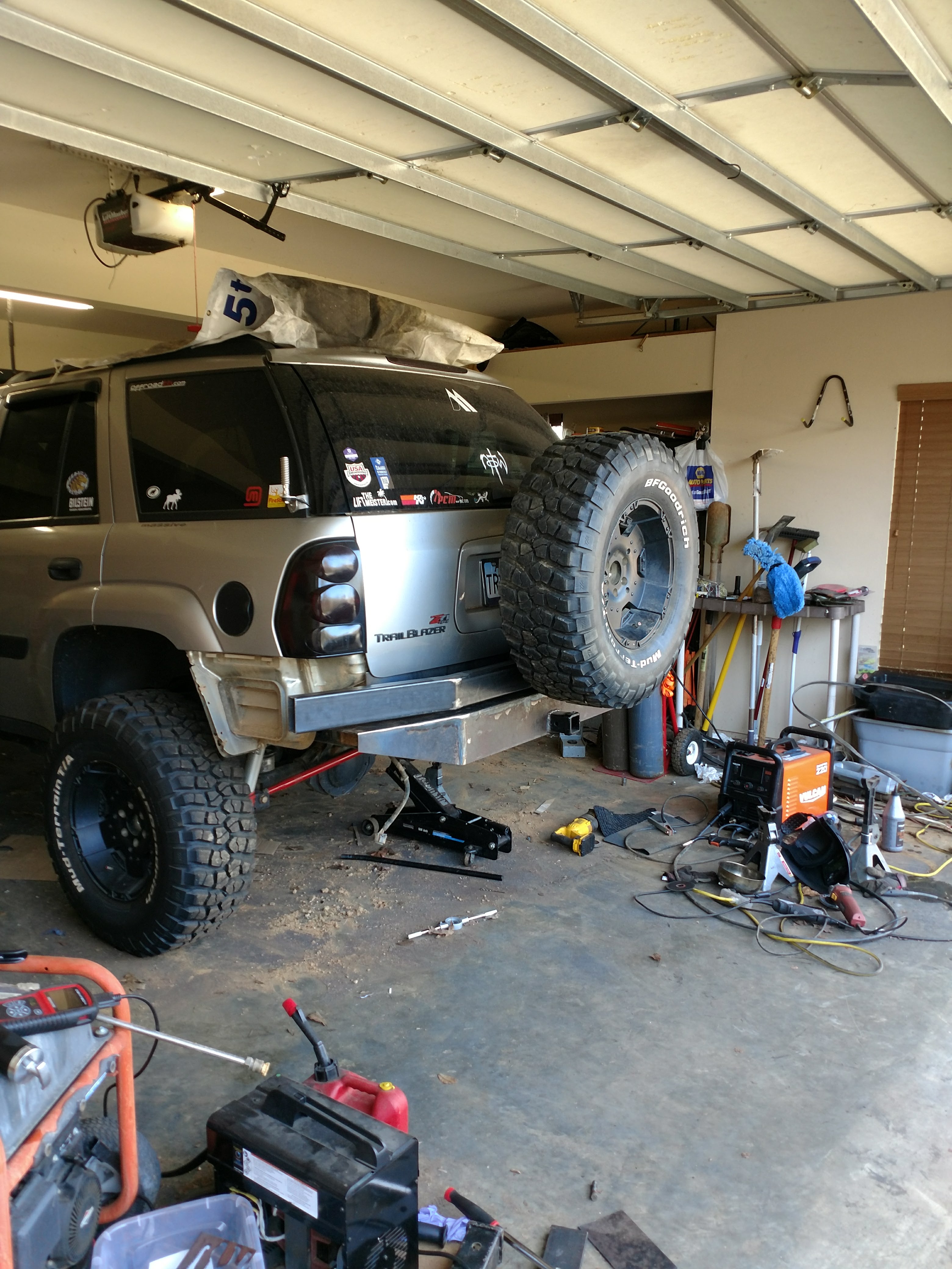

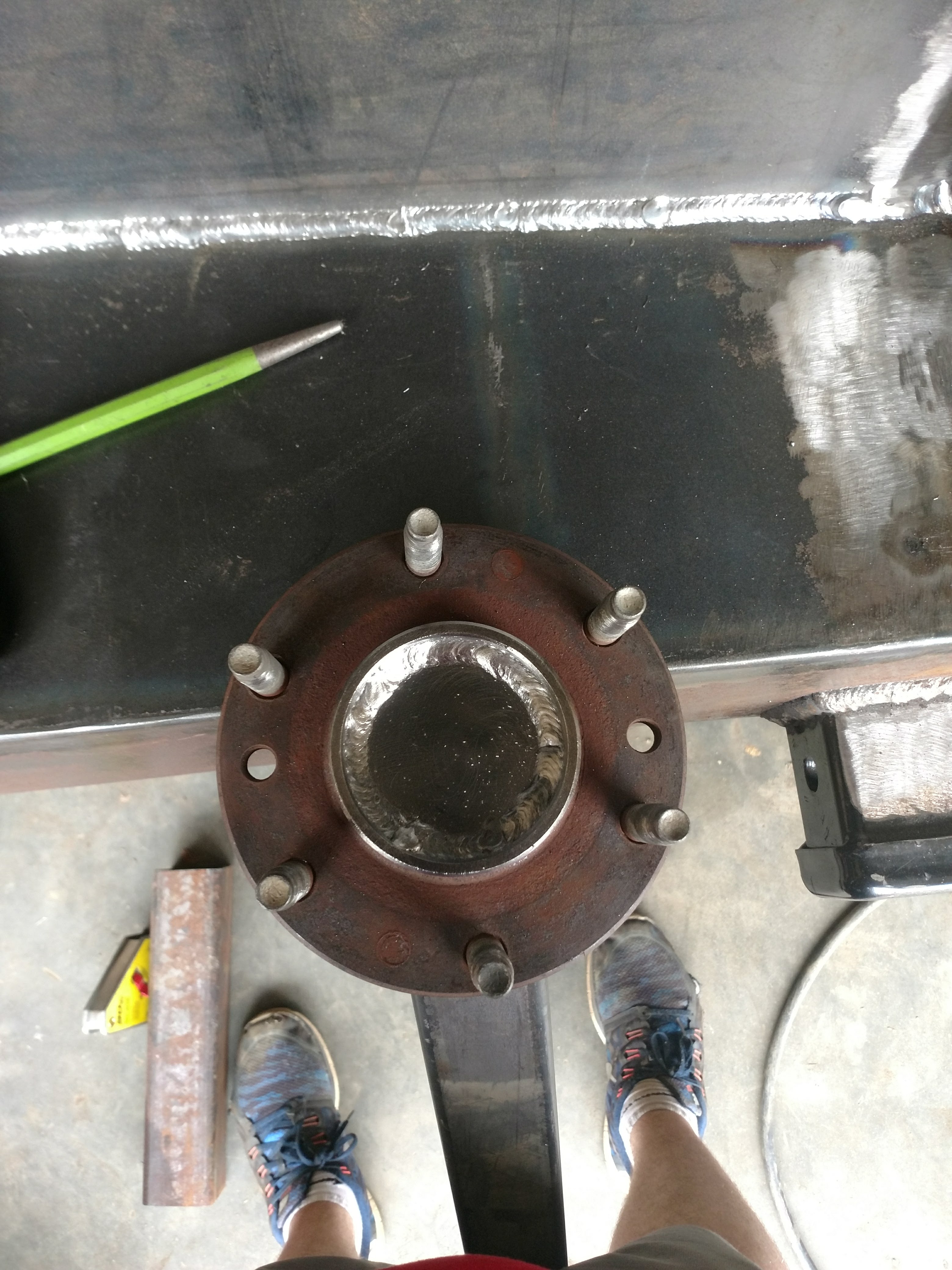

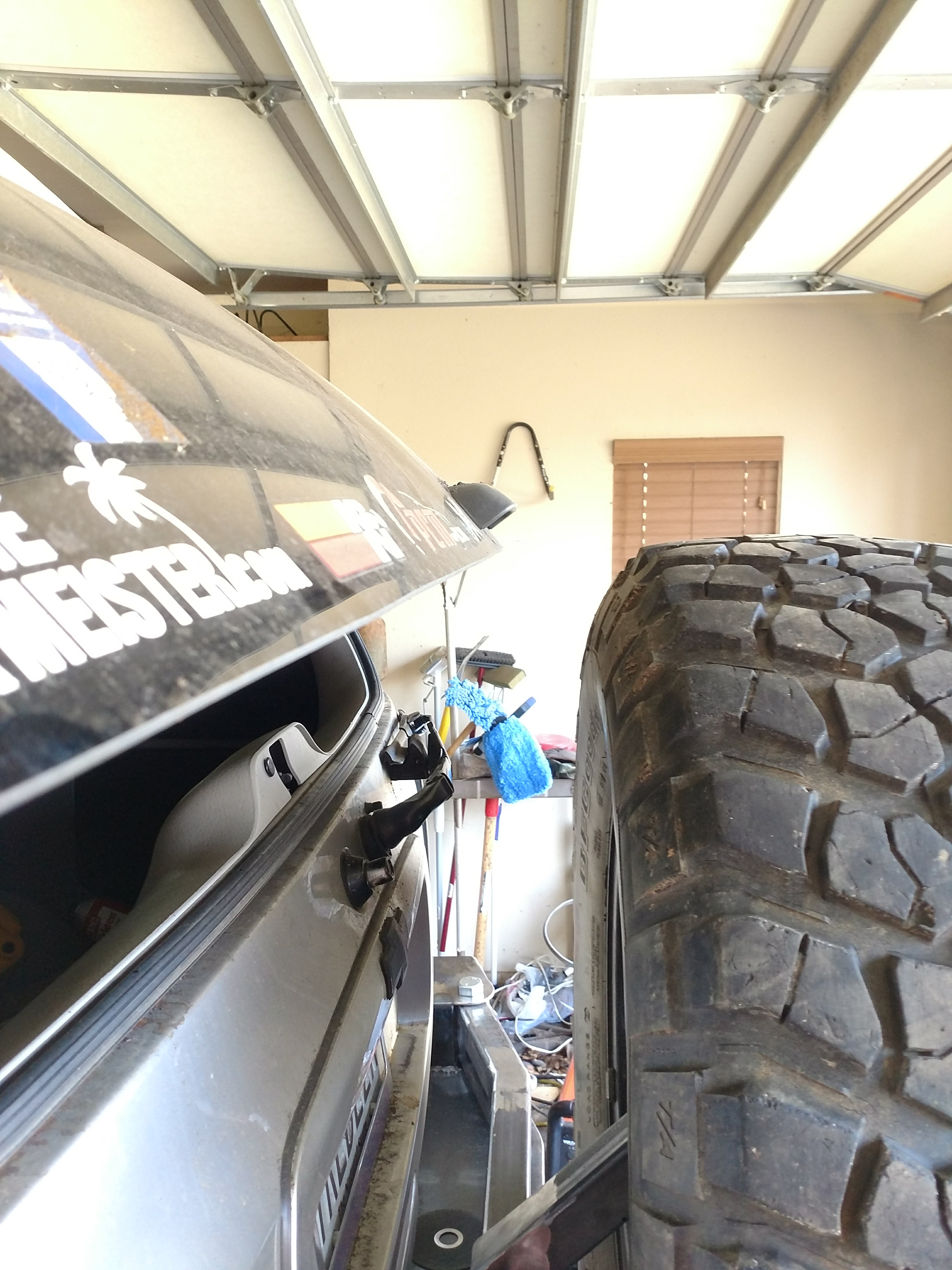

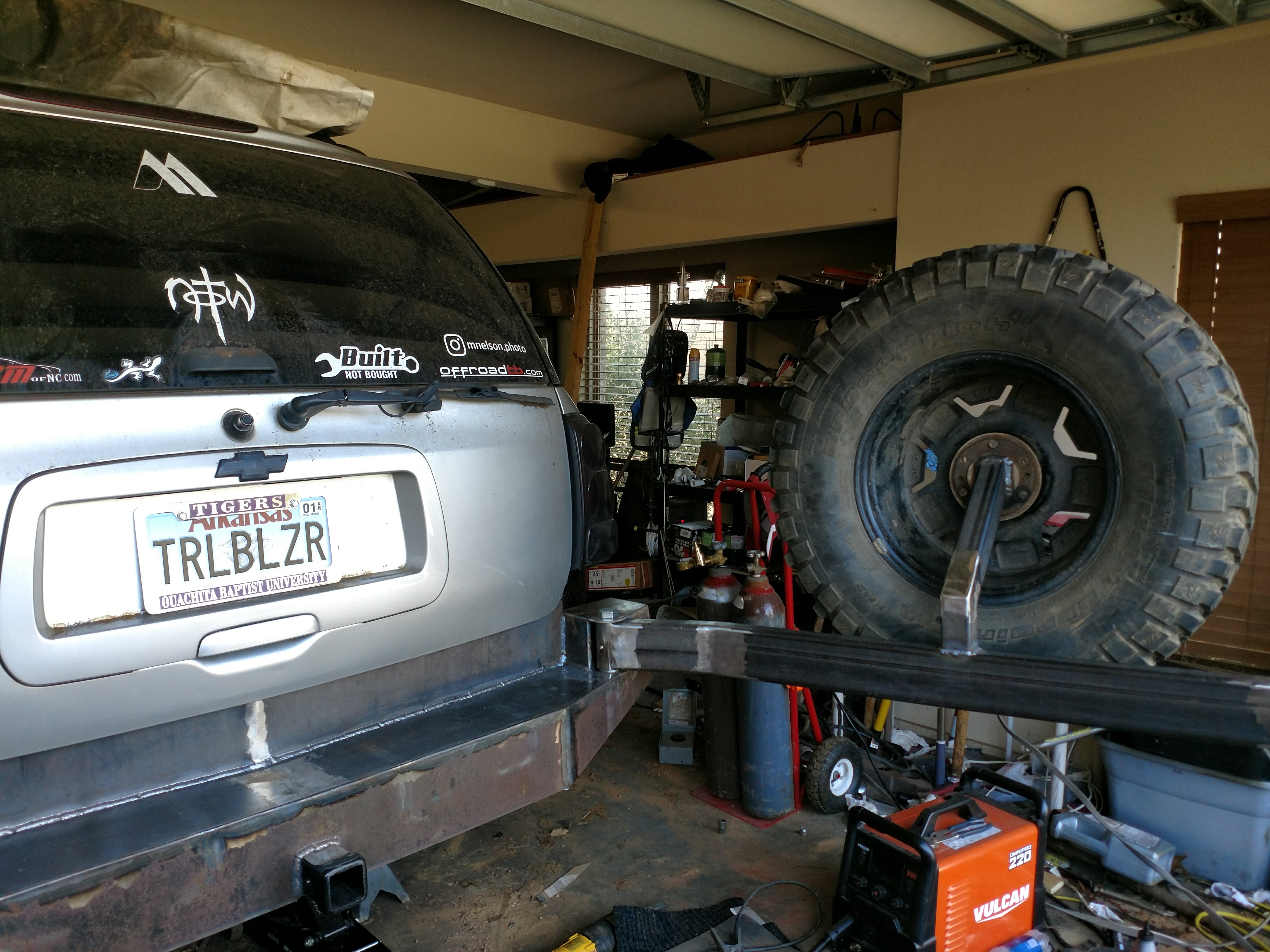

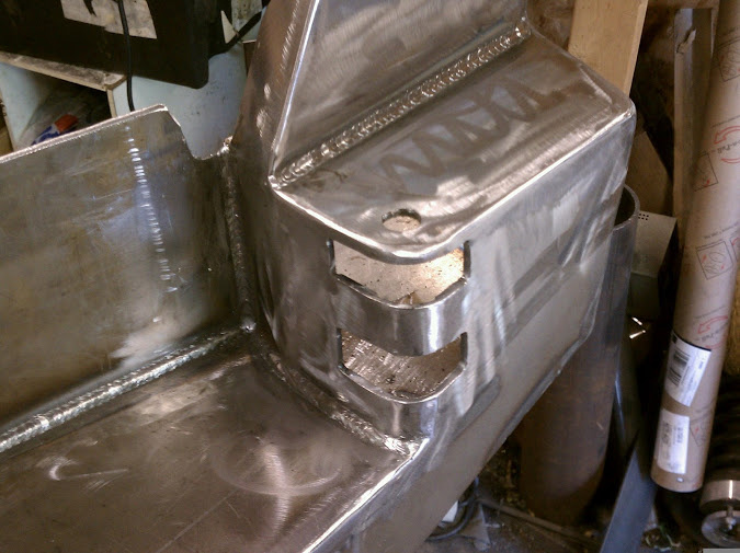

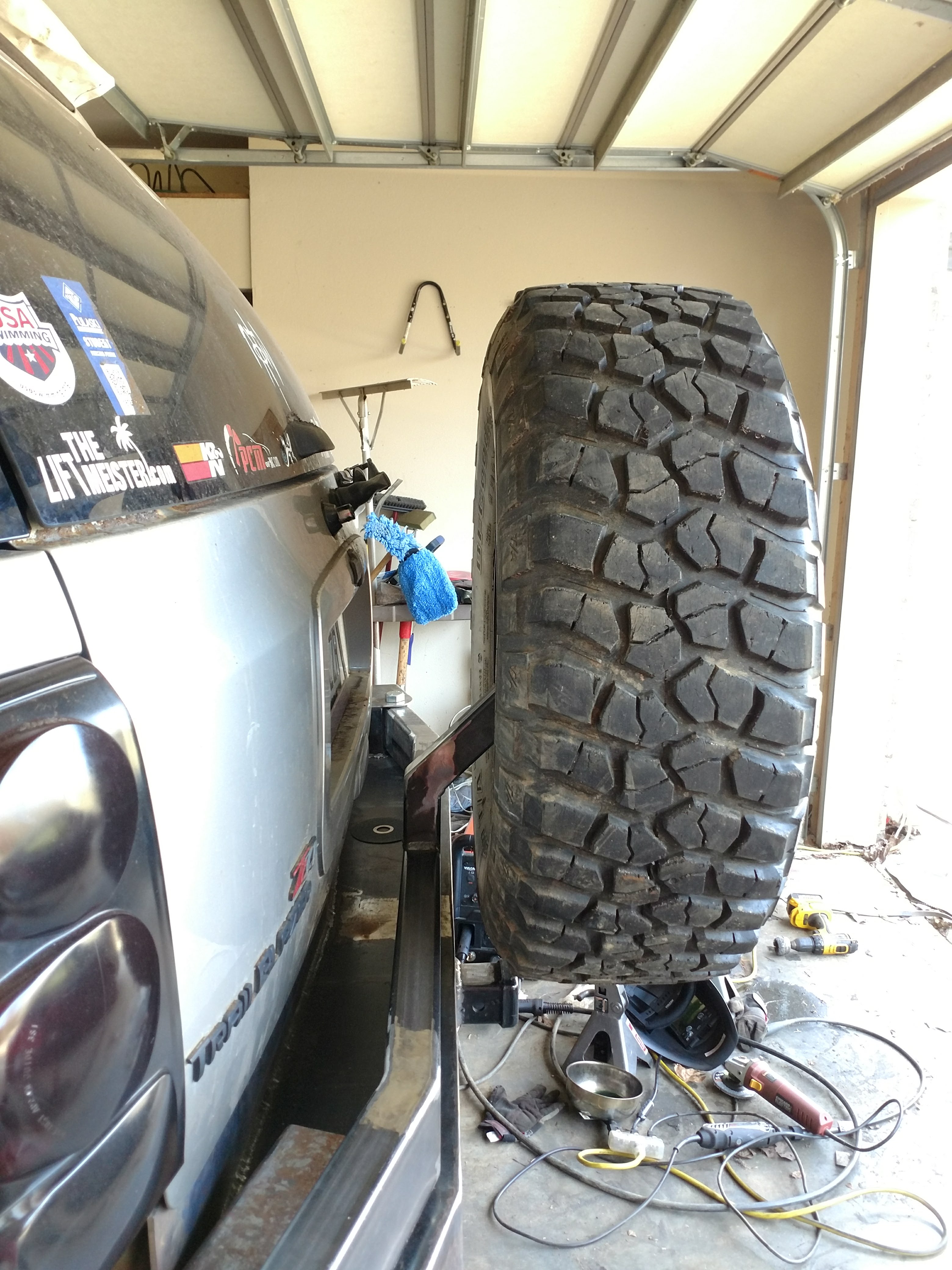

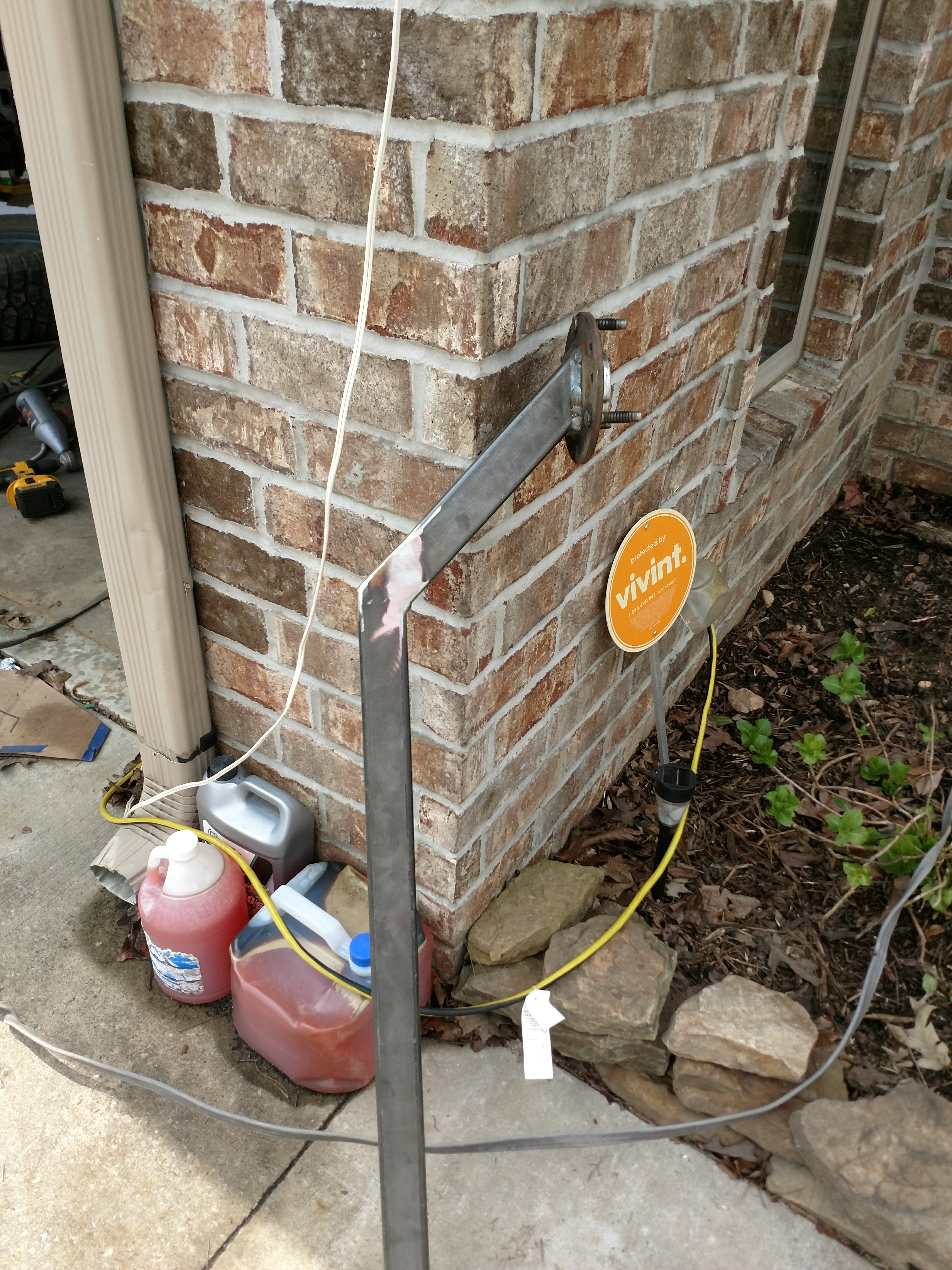

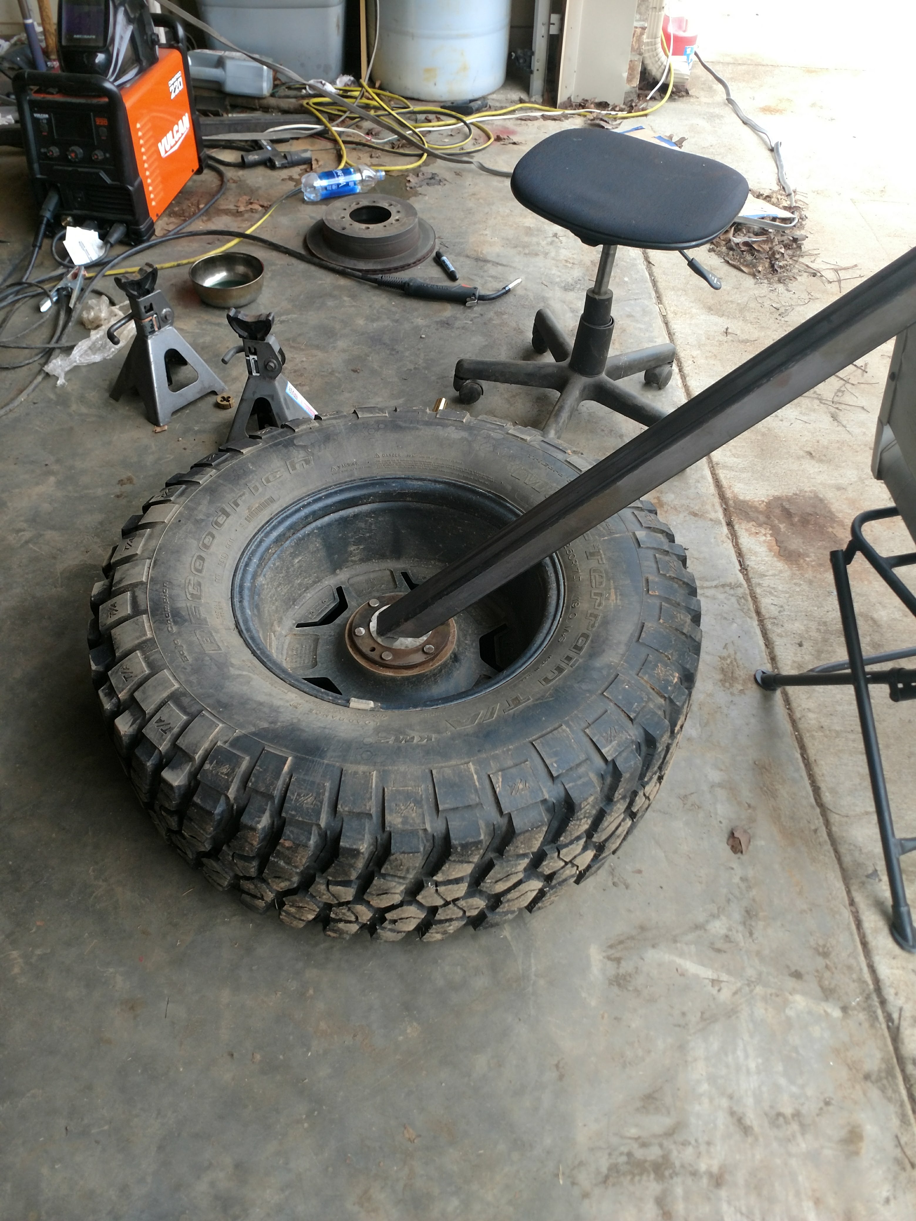

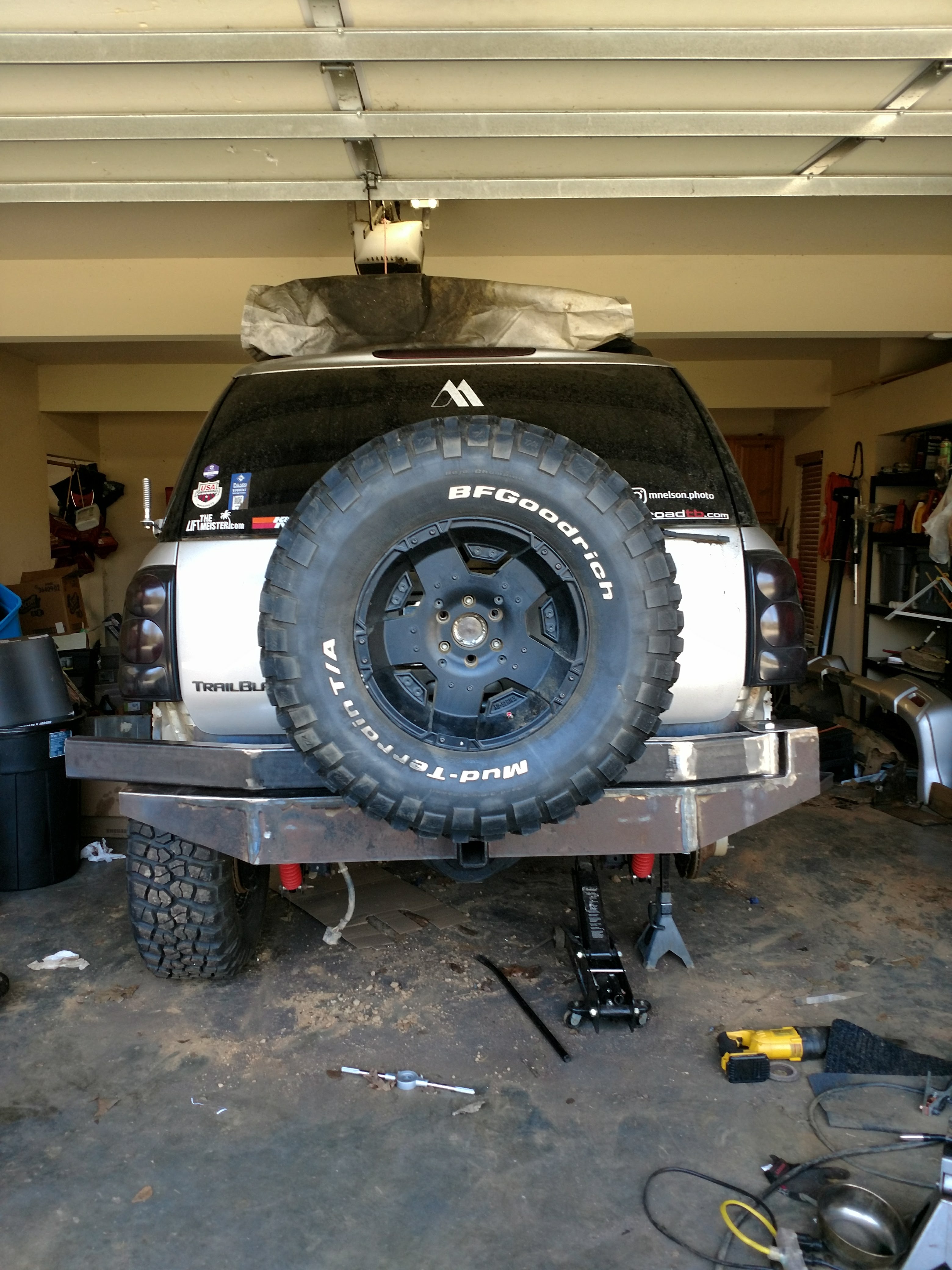

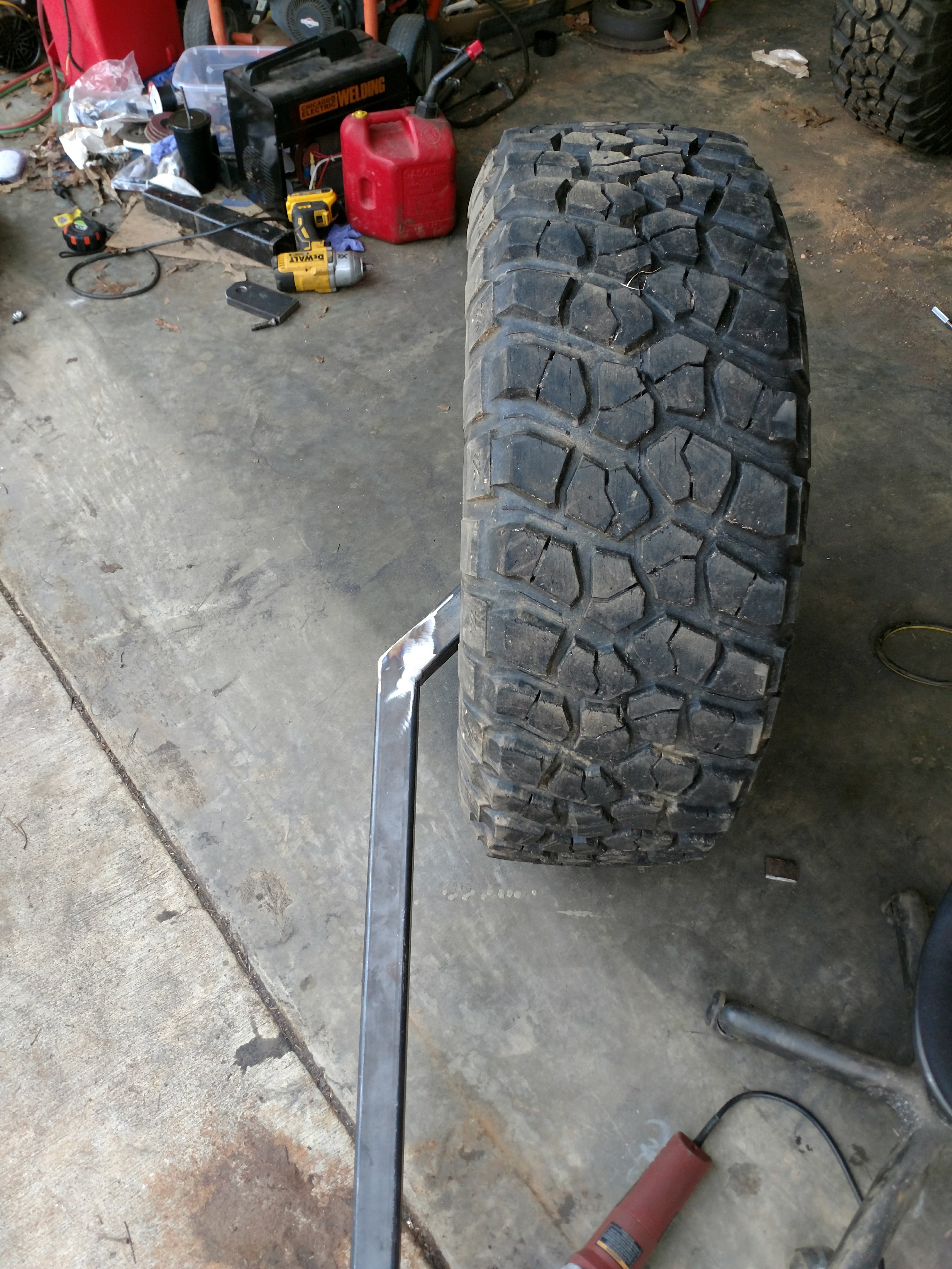

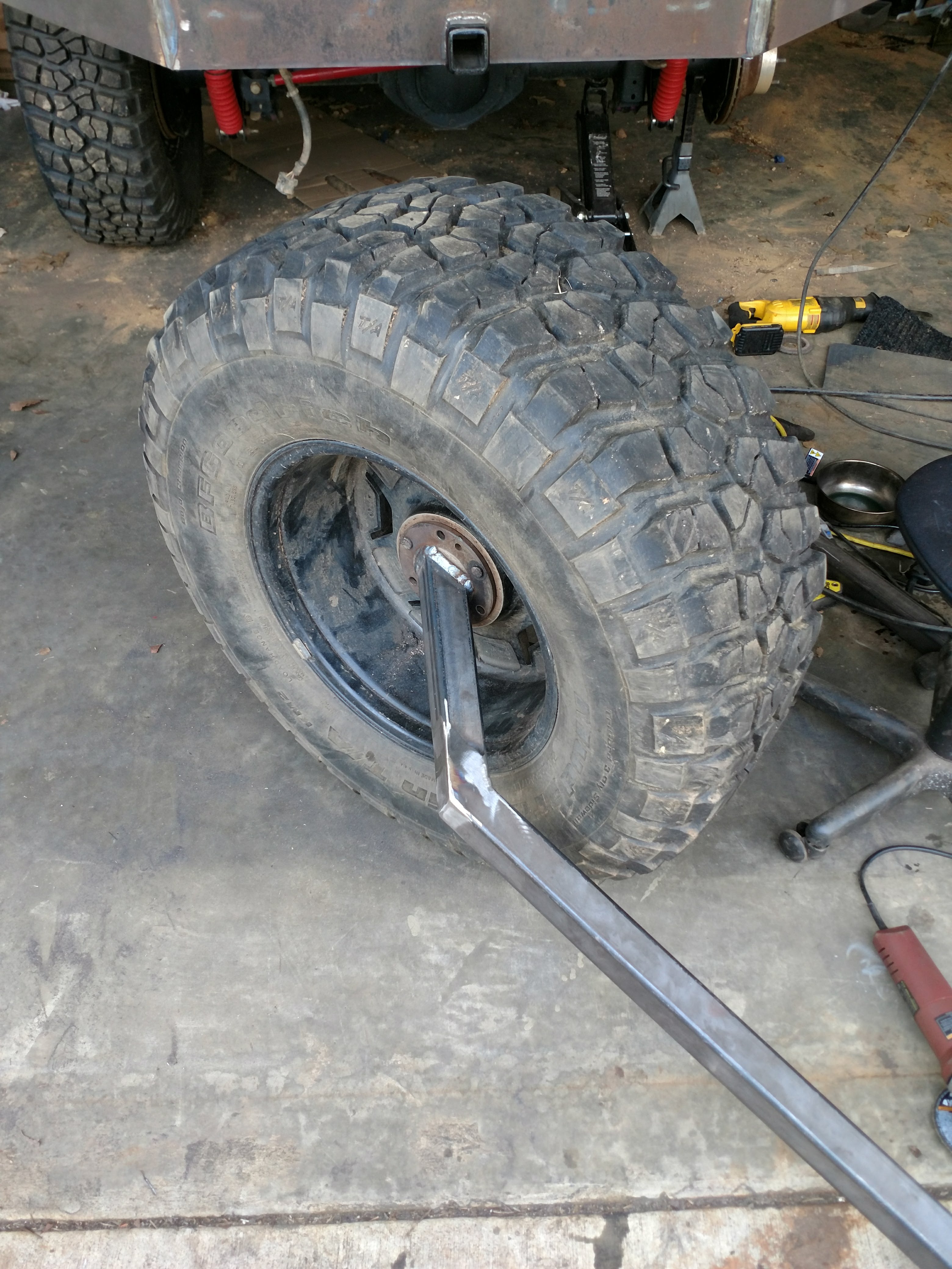

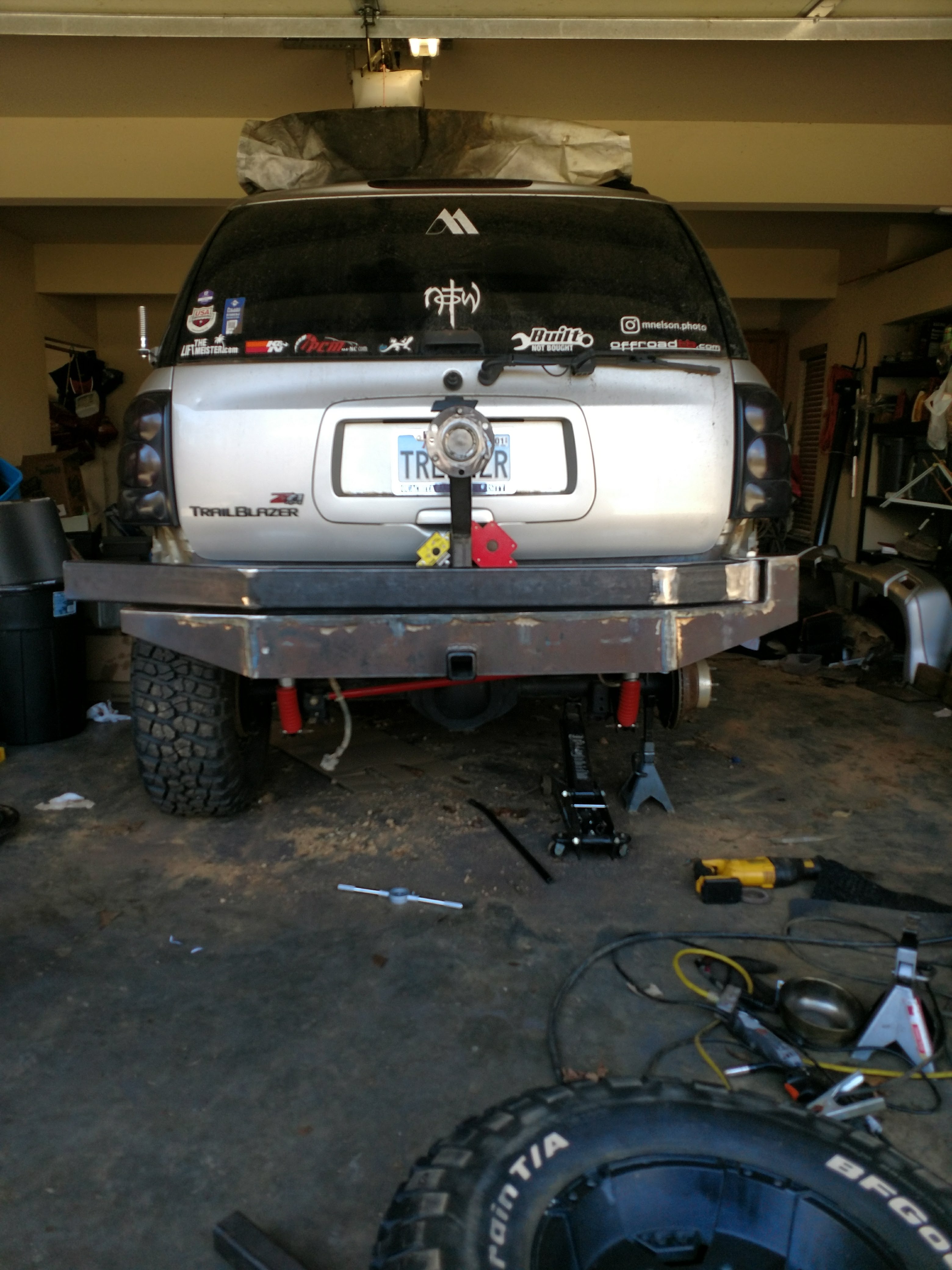

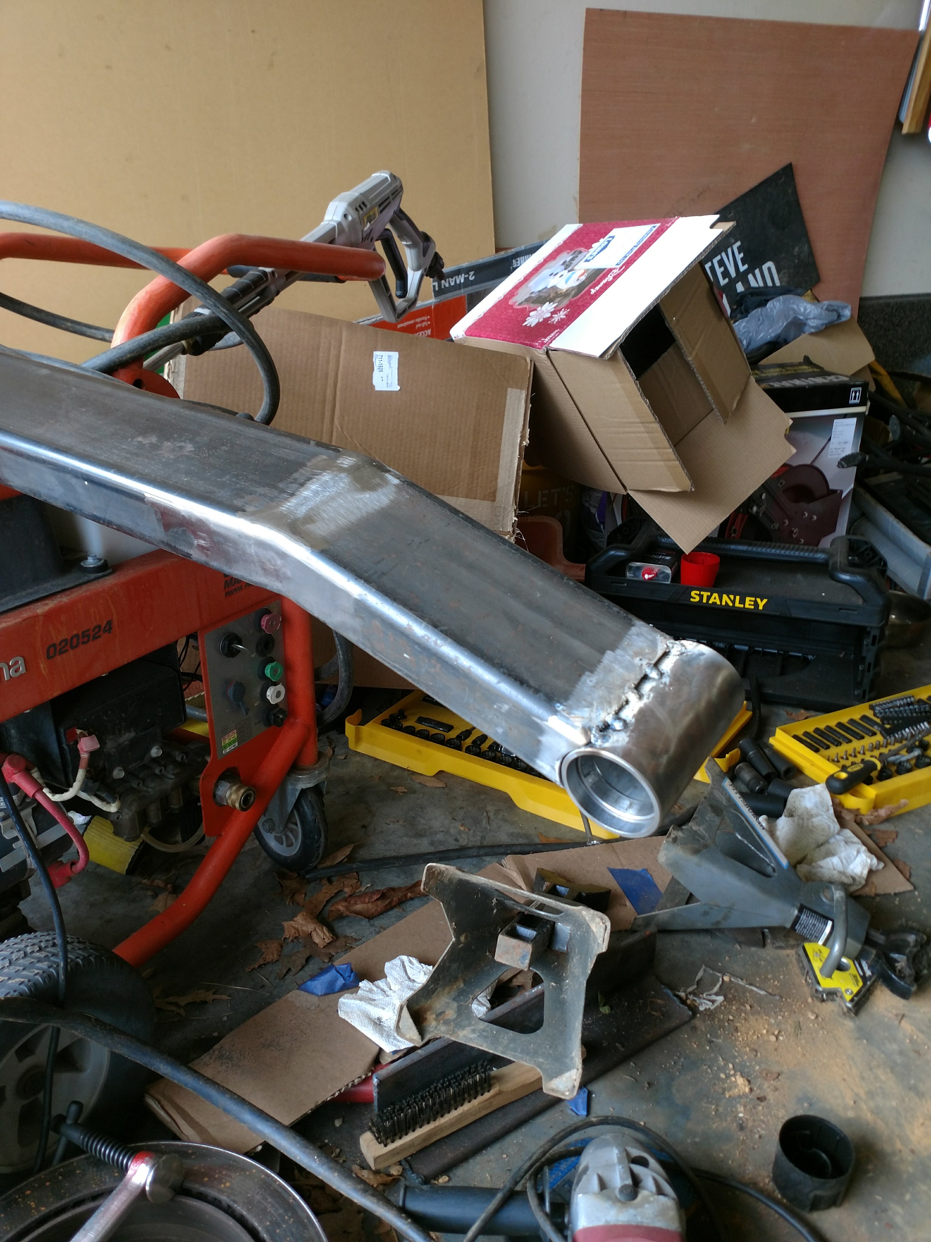

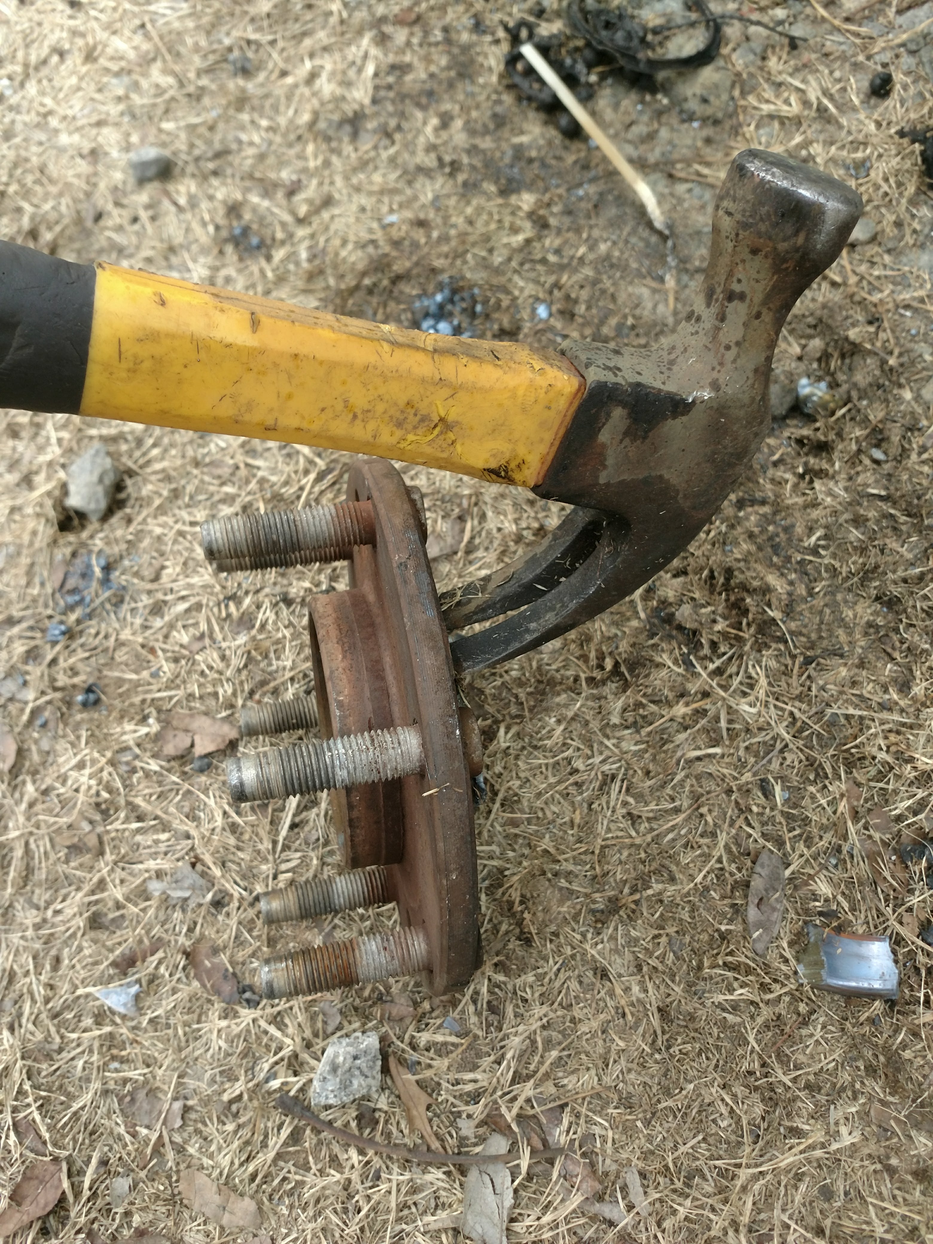

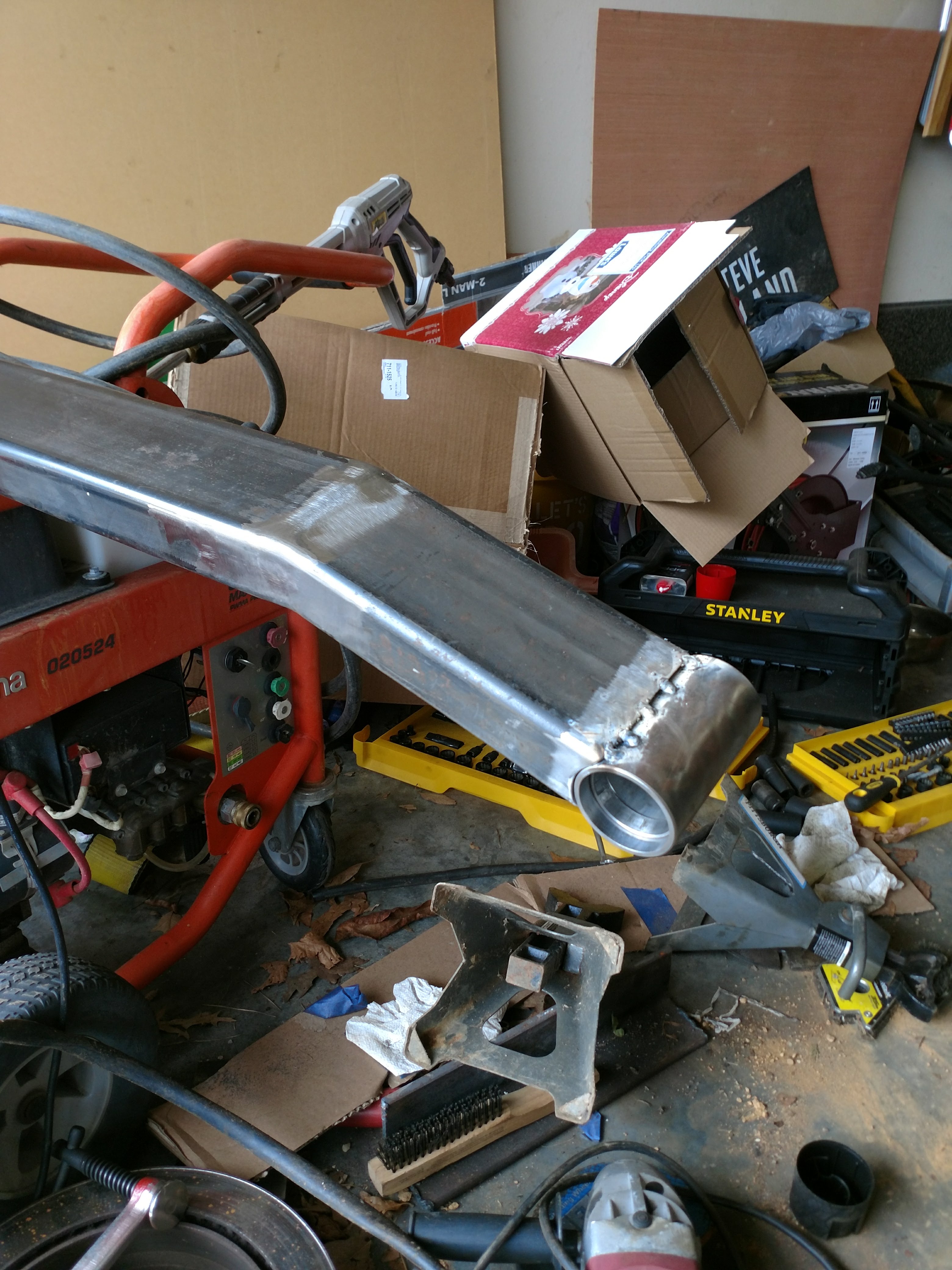

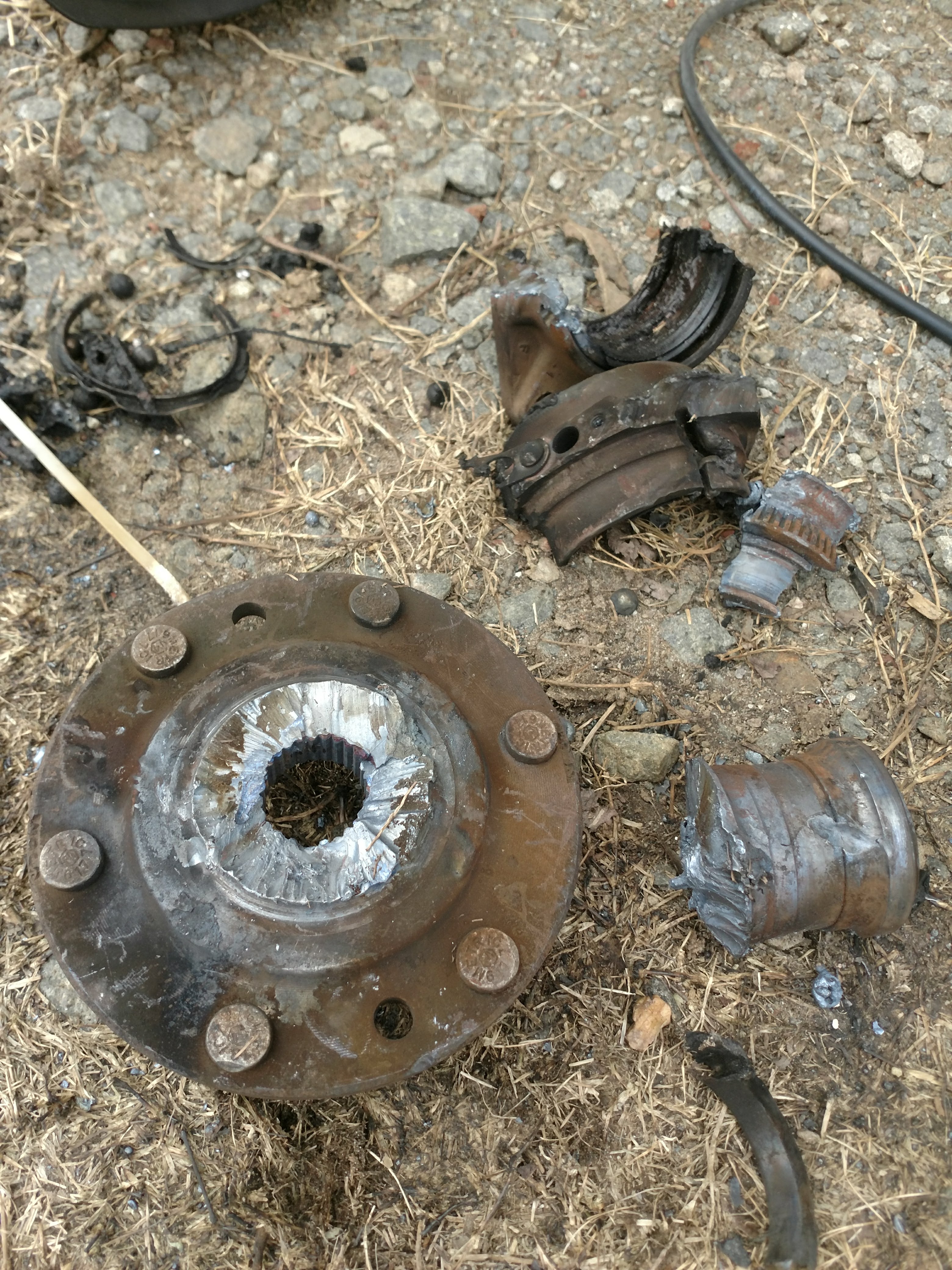

I've build most of the arm, tire mount, and passenger side of the main bumper. I added some more structure to the hinge side to minimize deflection when in the open position. I took a plasma cutter to an old front hub assembly for use as a tire mounting plate, which was full of grease and probably gave me cancer. After plasma, I ground the backside of it down relatively flat and welded it to a *45 on the end of some 2x2 to form the stick out angle. I had a piece of scrap laying on the ground from a hole saw that just so happened to fit perfectly in the center of the hub, so I used it to fill in the CV shaft hole and seal it all off. Did some more measuring and chopping until I came up with a good mounting stand and welded it to the arm. There is plenty of room for the back glass to open with the arm closed (new 35" tire shown), probably enough room for a 37".

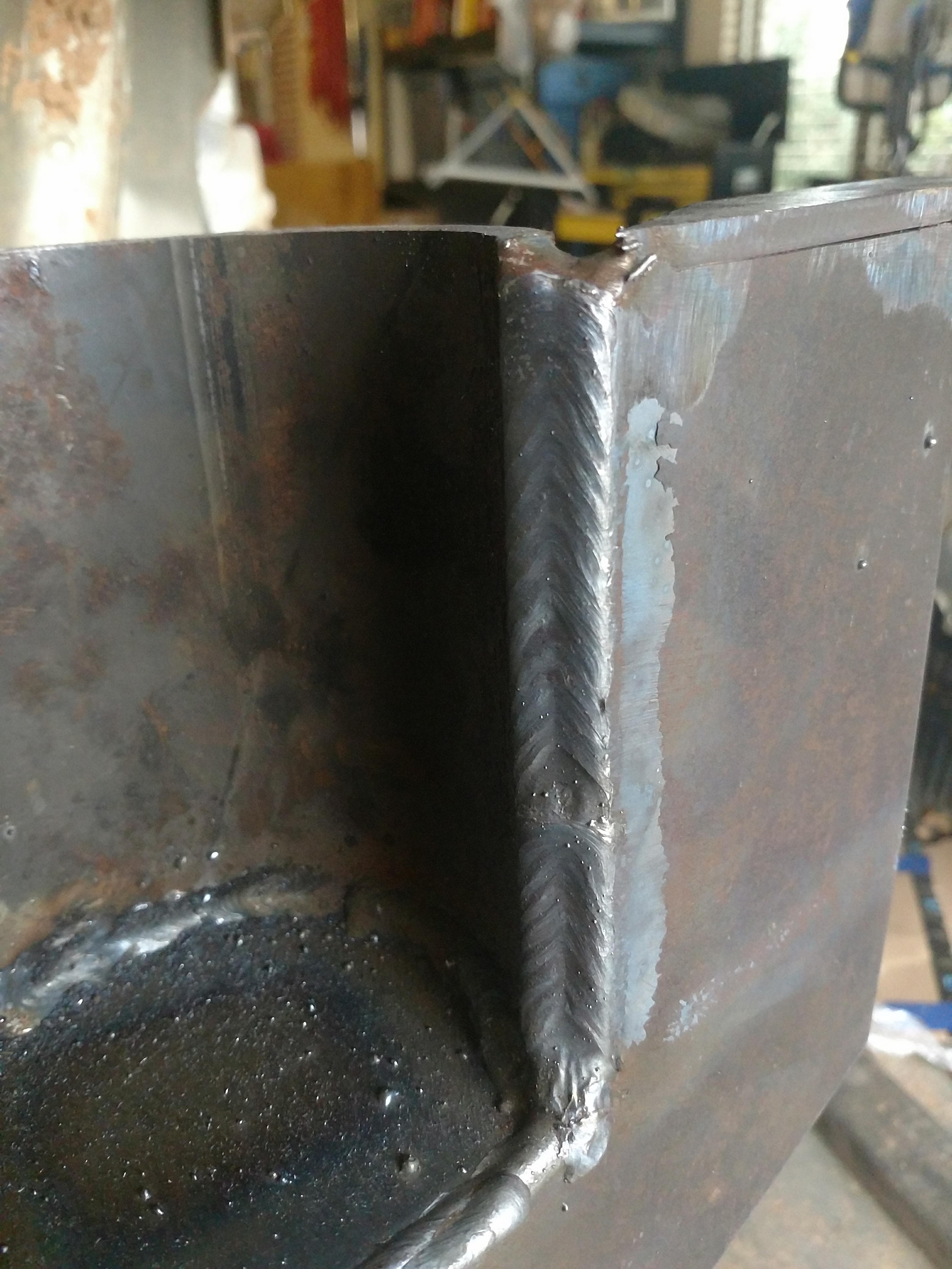

Sidenote as I sit here looking at my welds... I am by no means a welder. My dad taught, er... told, me how to half-moon a puddle with a 110V/90A FCAW when I was 13, and I've been self/youtube taught ever since. I built my front MDB kit winch bumper with the same 90A machine. I just recently upgraded to a nicer 240V/220A multiprocess machine, this bumper being the first project I've used it on. With that said, I've been MIG'in this thing together with little to no clue what I'm doing. Sometimes I lay down pretty beads, sometimes I try to wipe it off because I'm so convinced it came out of the backside of a bird with the flu. Just throwing that in there for anyone looking through the pics trying to contain their laughter :lol:

by ETB1 » Tue Apr 17, 2018 6:46 pm
Looks good brother. I personally like the jerry can idea. That is why i chose to do the dual swing arms. Jerry cans are cheaper and in my opinion will last longer. Though i may be partial being from military background and all.

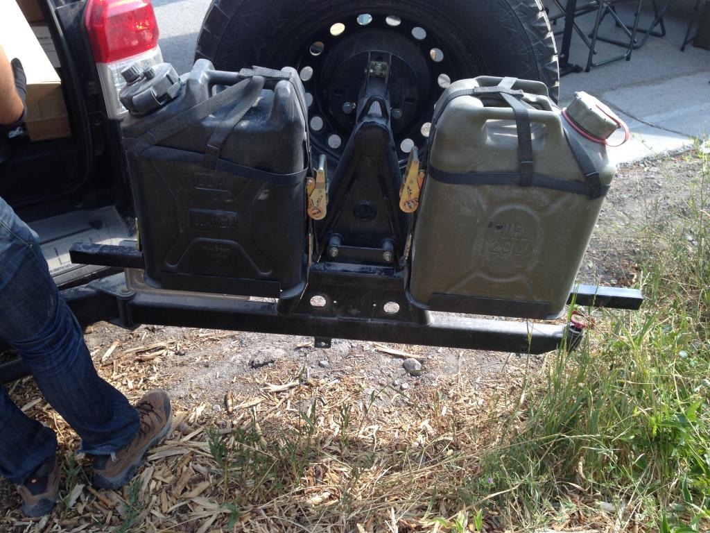

by Trail X » Wed Apr 18, 2018 10:16 am
My jerry can holder seems to work pretty well. Granted, my old holder bracket rusted out (the one pictured here), but the single ratchet strap concept works really well. Just needs some oiling from time to time.

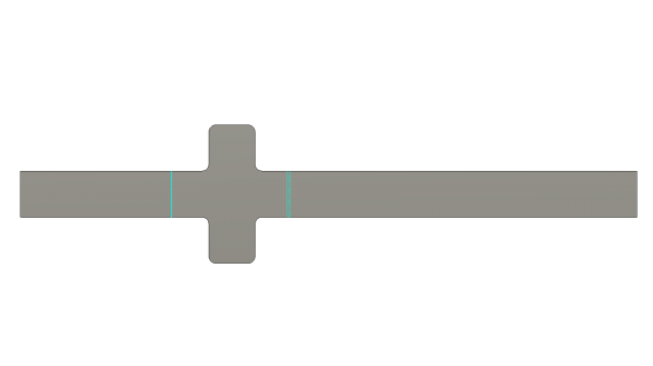

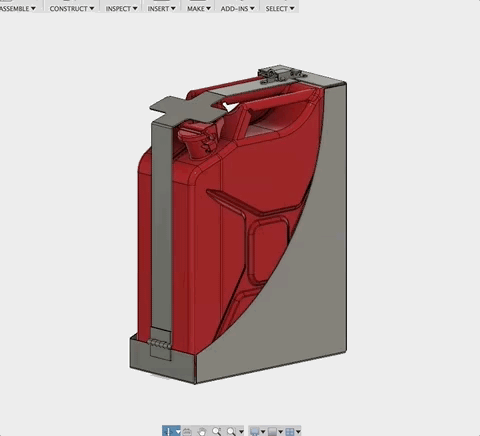

by mason10198 » Wed Apr 18, 2018 12:43 pm

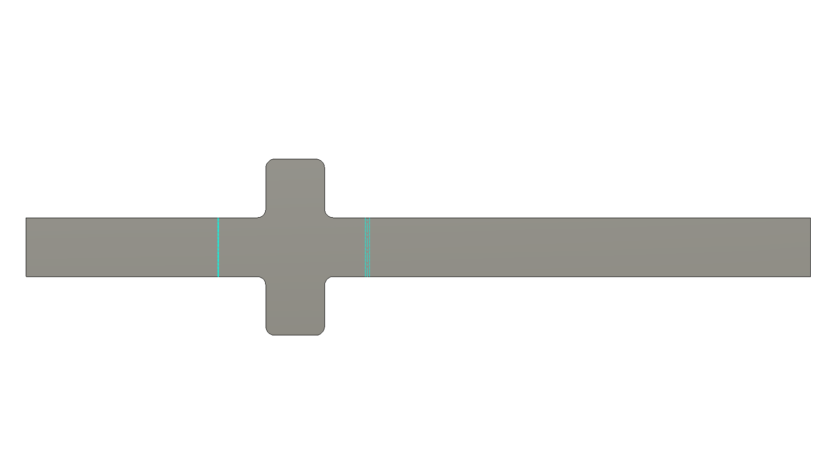

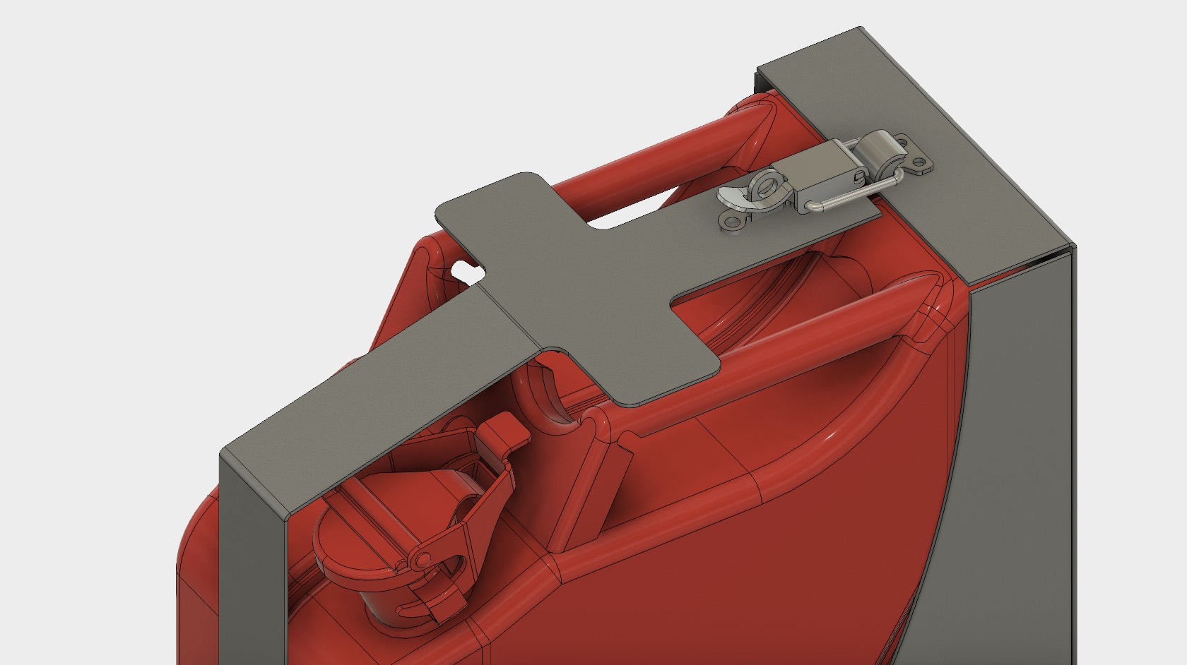

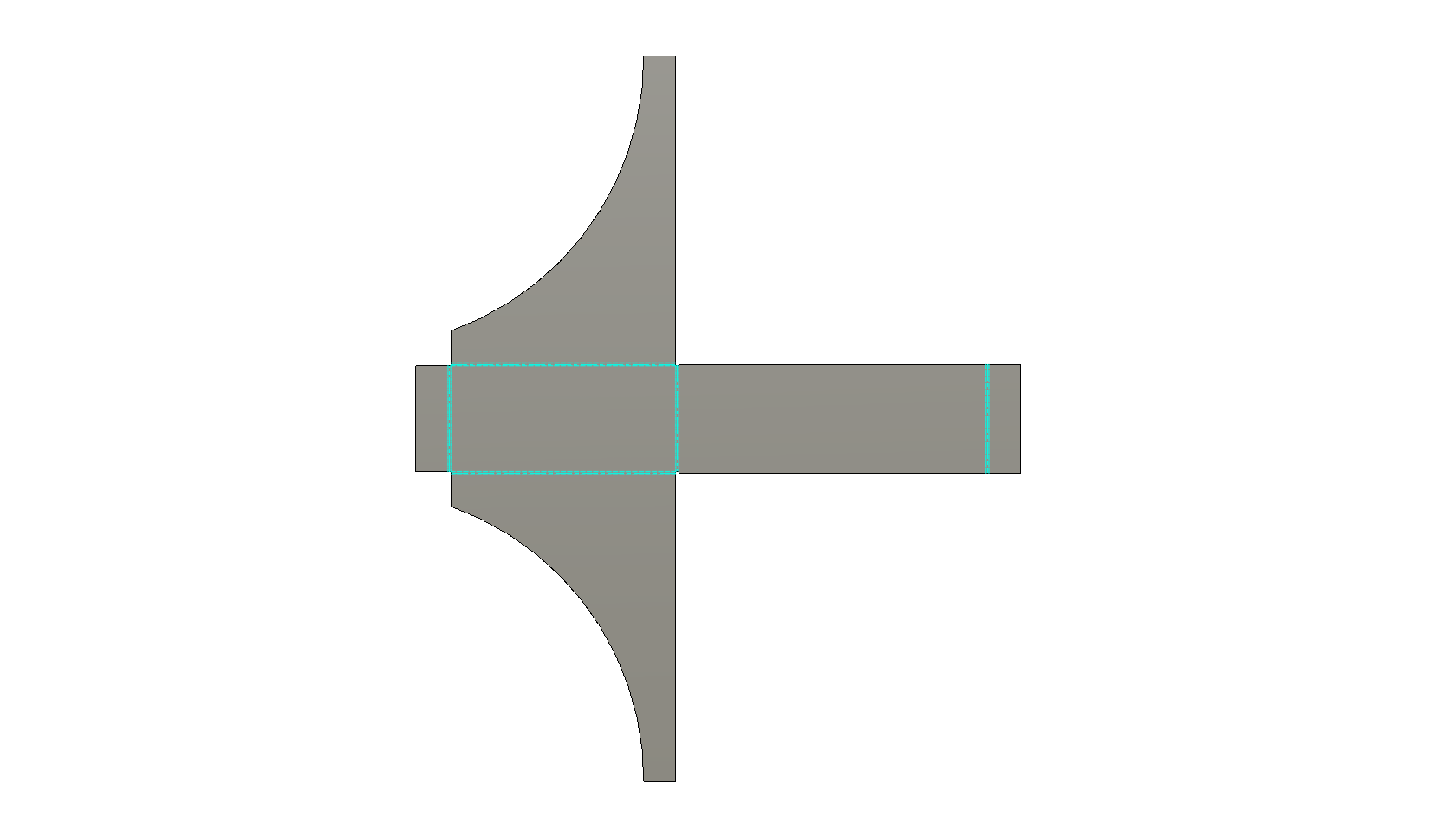

I made a quick sheet metal copy of in Fusion, should be pretty easy to bam these out of some... lets say 14 gauge... on the plasma and bend them up. A couple of small hinges and padlockable draw latches from McMaster will cover hardware. Then I'm thinking I'll put some adhesive neoprene foam in there to keep it from rattling. Eh?

by mason10198 » Wed Apr 18, 2018 6:22 pm
These will fit back behind the tire perfectly!

by Trail X » Thu Apr 19, 2018 9:26 am
Those look good too! I like the little gifs Mason. Pretty sweet!
I always try to keep the cap accessable, because I use a siphon. Much easier to siphon from where its mounted than to pick one of those things and try to pour them in your tank.
Also, the gas cans are rather thin. They hold up for a while, but I'd recommend putting some rubber or something under them. Mine finally rusted through (I think where the mounting screws were rubbing) on the bottom and started leaking gas.

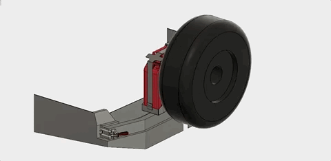

by mason10198 » Thu Apr 19, 2018 2:01 pm
Moved crosspiece back towards can handles
