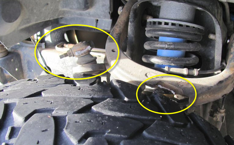

by Trail X » Mon Jan 13, 2014 12:31 am
Thanks for the thoughts Eric. I'm really not worried about it. The only bending put into the plate is from the slight moment arm of the ball joint, and the strength against bending of my new arm is much stronger than the ball joint rod/stud. So if something were to fail, the ball joint rod would break before the UCA ever will. I haven't ever heard of one of the ball joints breaking on these trucks, so I see no real reason to design any more strength into the arm.
And Mike, yeah, I agree. The rear end arms are simple compression and tension, not cyclic bending on 2 axis.
