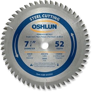

by bartonmd » Wed Jan 30, 2013 10:37 am
These are the blades I'm talking about. They go right into your $40 circular saw, and before I got my plasma cutter, I would get about 1 custom bumper out of a blade, if I used it right:

These pictures will be a great help towards creating my own setup, and I will def. pickup that blade.
