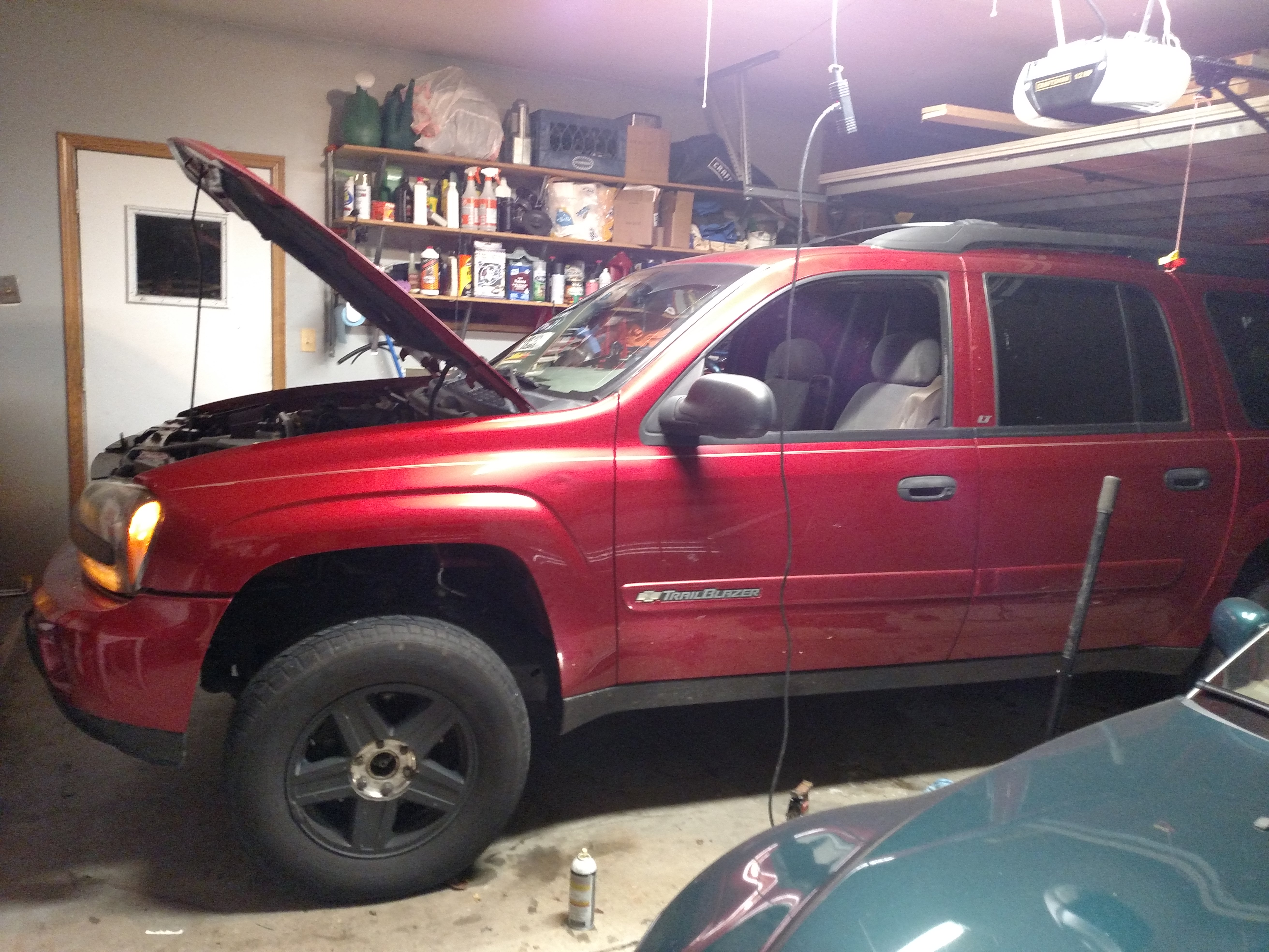

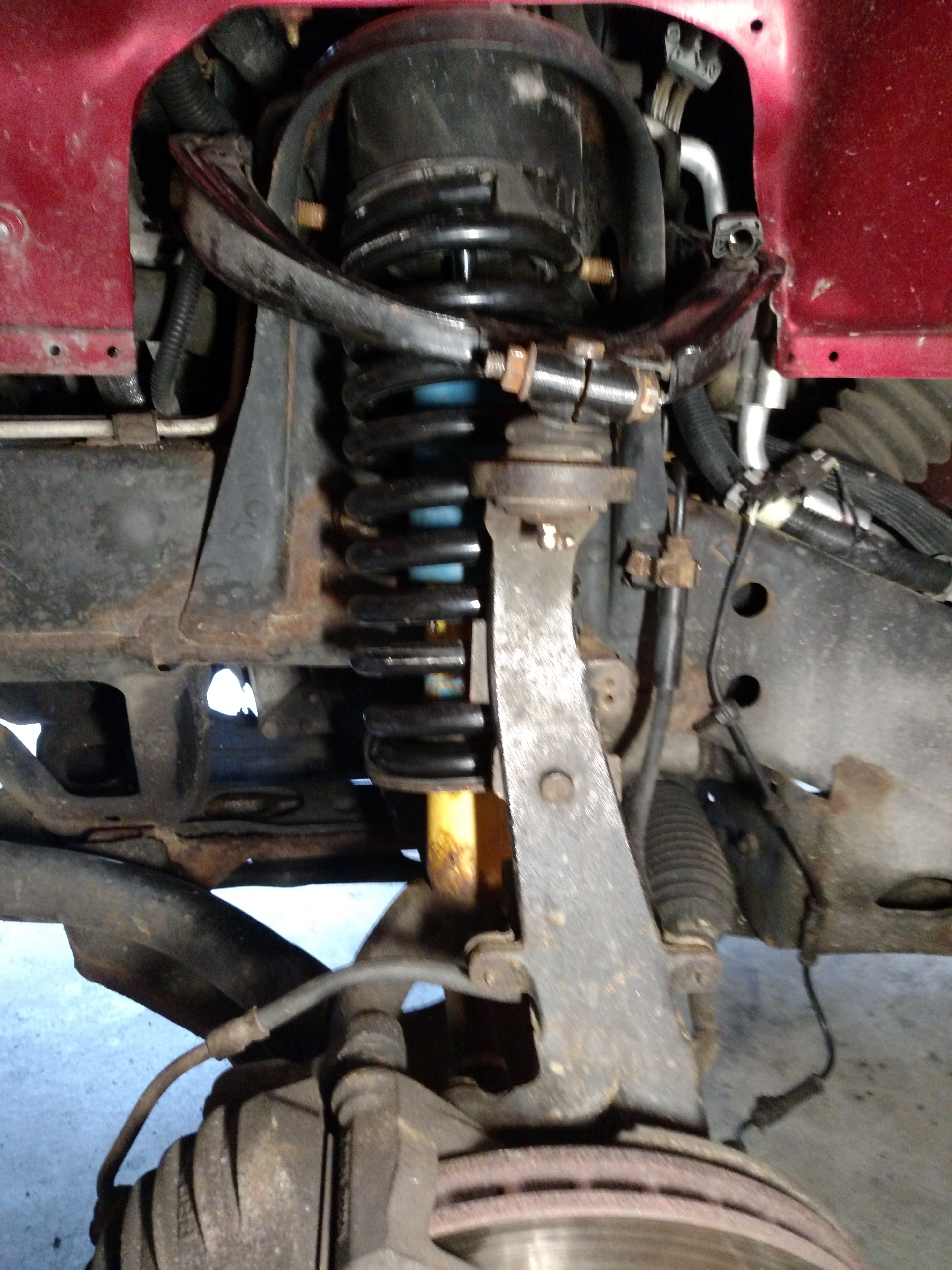

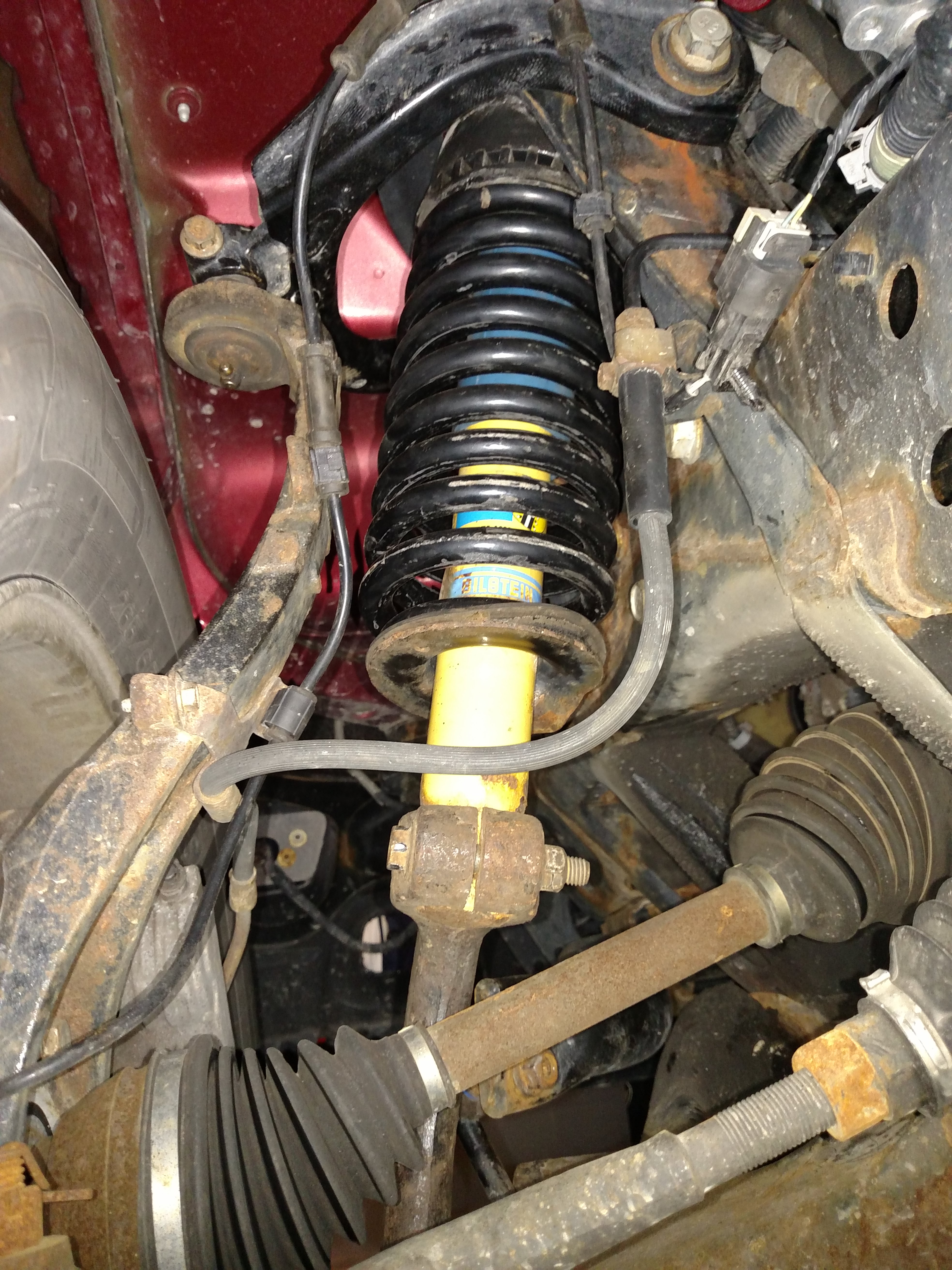

by Mrandersonxd » Wed Dec 16, 2015 11:16 pm

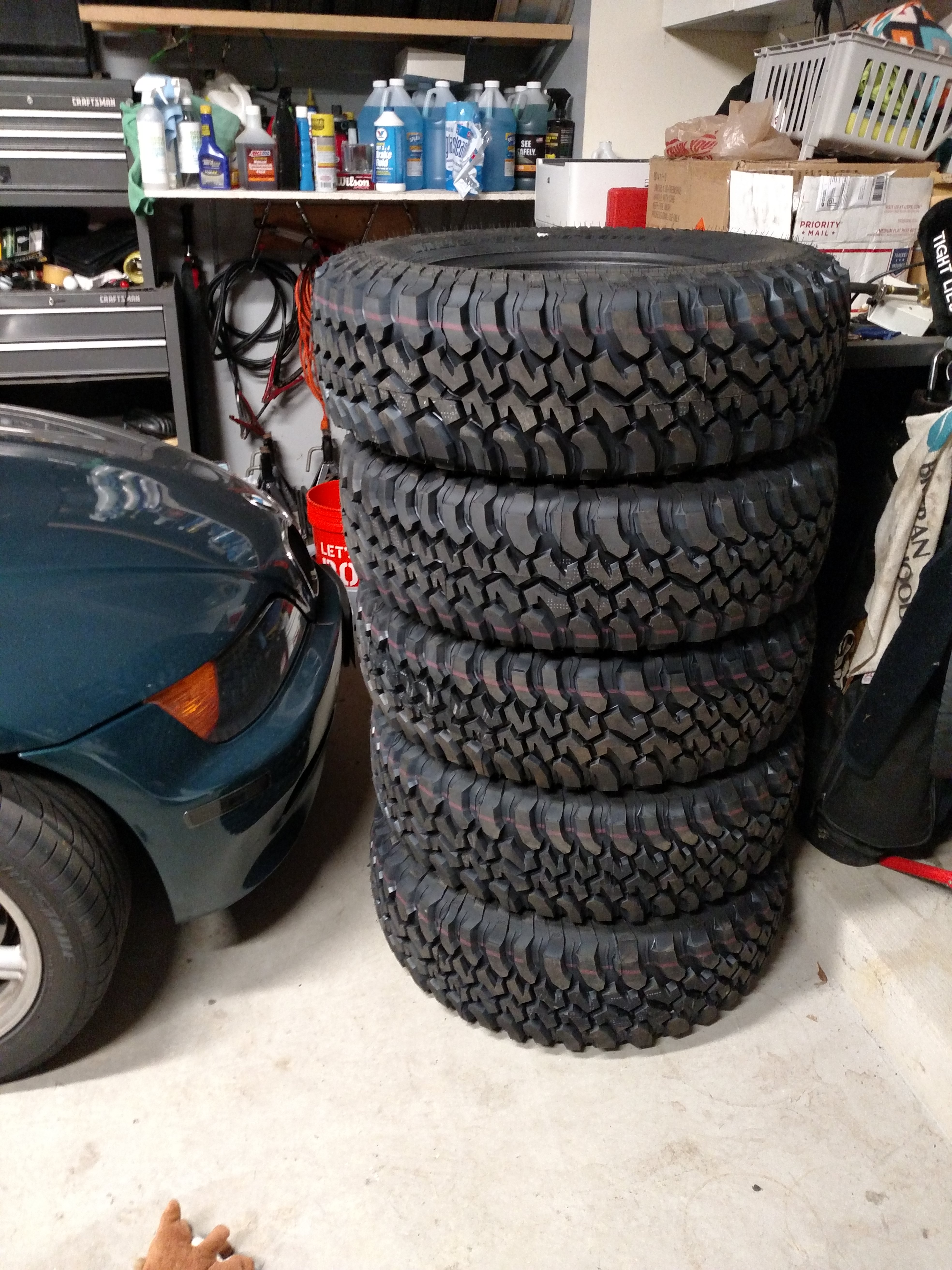

Here's what I've done so far:
INTERIOR:
LED interior light swap
Removed 3rd row seat
4 new kicker CS65 speakers
Panasonic head unit(going into my boat in spring)
12" Kicker CVR in a ported box w/ mono amp
ELM327 Bluetooth OBDII device(running torque on my droid turbo, getting my note2 repaired for this)
Mount for my Droid Turbo on dash
Removed carpet in old 3rd seat area, and rear cargo area
Shaved down studs and brackets and Herculined exposed metal
EXTERIOR:
removed factory step bars
herculined plastic moulding
plasti-dipped stock wheels
plasti-dipped front grille
HID Headlights
DRIVETRAIN:
Upgrades:
removed intake resonator
removed exhaust resonator
removed stock air box, replaced with K+N filter
drilled and tapped new vacuum fittings
Maintenance:
replaced 4L60E with a rebuilt(Shift-Rite Kankakee, IL - 3yr/36k) - August 2015
did fluid changes on the diffs/transfer case when I put the trans in
replaced thermostat(Stant) - December 2015
6 new COP, 6 new plugs - March 2015
new belt - December 2015
Water Pump - October 2014
SUSPENSION:
Upgrades:
Bilstein's - They're old 2011 maybe(40-50k on them, will see how they hold up, just did my lift today)
Flipped and swapped UCA's
MarkMC 3" Lift/Level kit
MarkMC 1.5" wheel spacers
MOOG 81114 front springs
OEM EXT rear springs
(5) BFGoodrich MT TA KM 255/75/17 on stock wheels
Maintenance:
4 new calipers, ceramic pads all around - October 2015
bled entire brake system - October 2015
tie rods, ball joints, sway bar links, UCA/LCA bushings - May 2015(the only work I haven't done myself)
Mrandersonxd
Posts: 24
Joined: Tue Oct 13, 2015 9:06 am

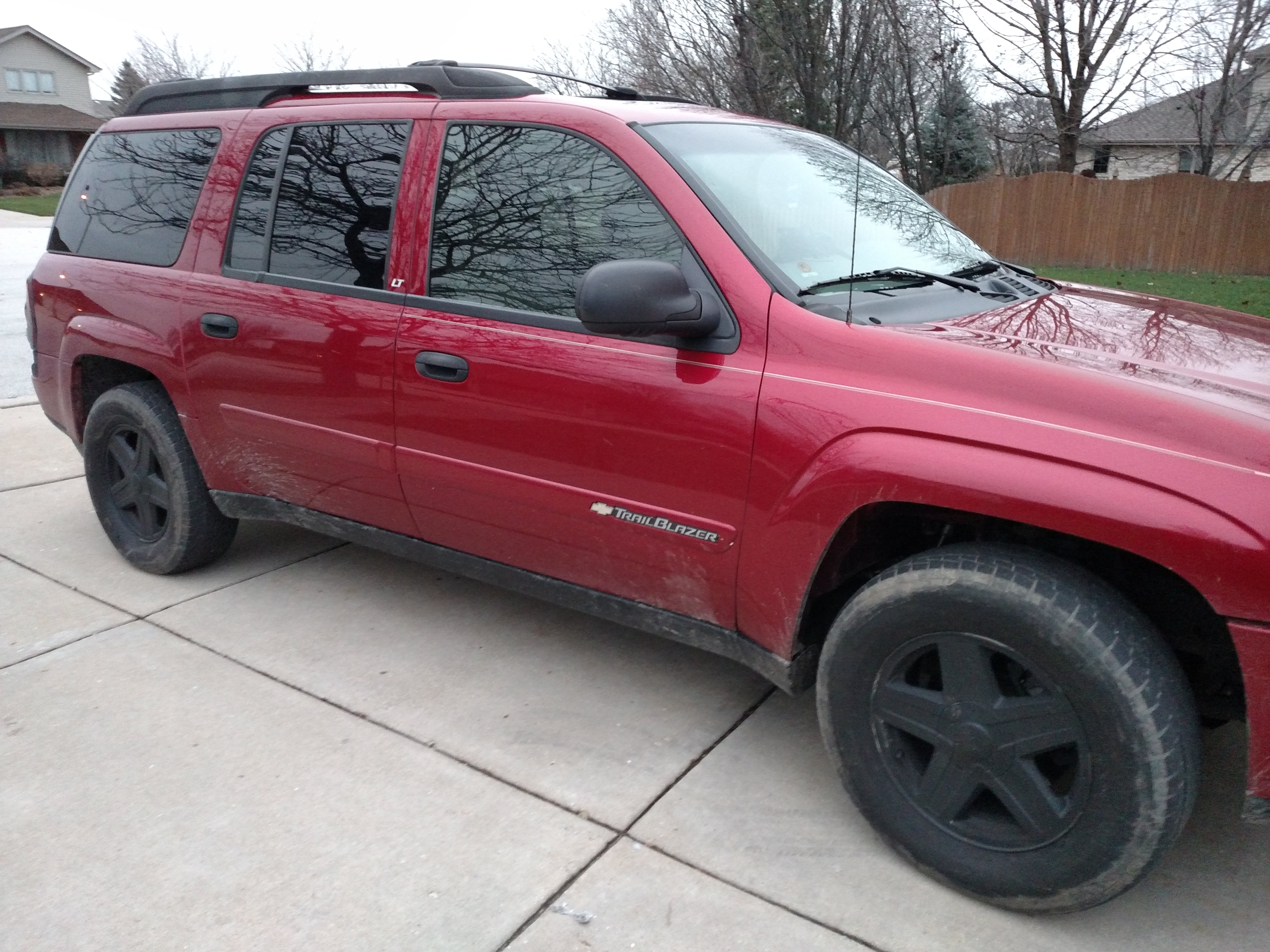

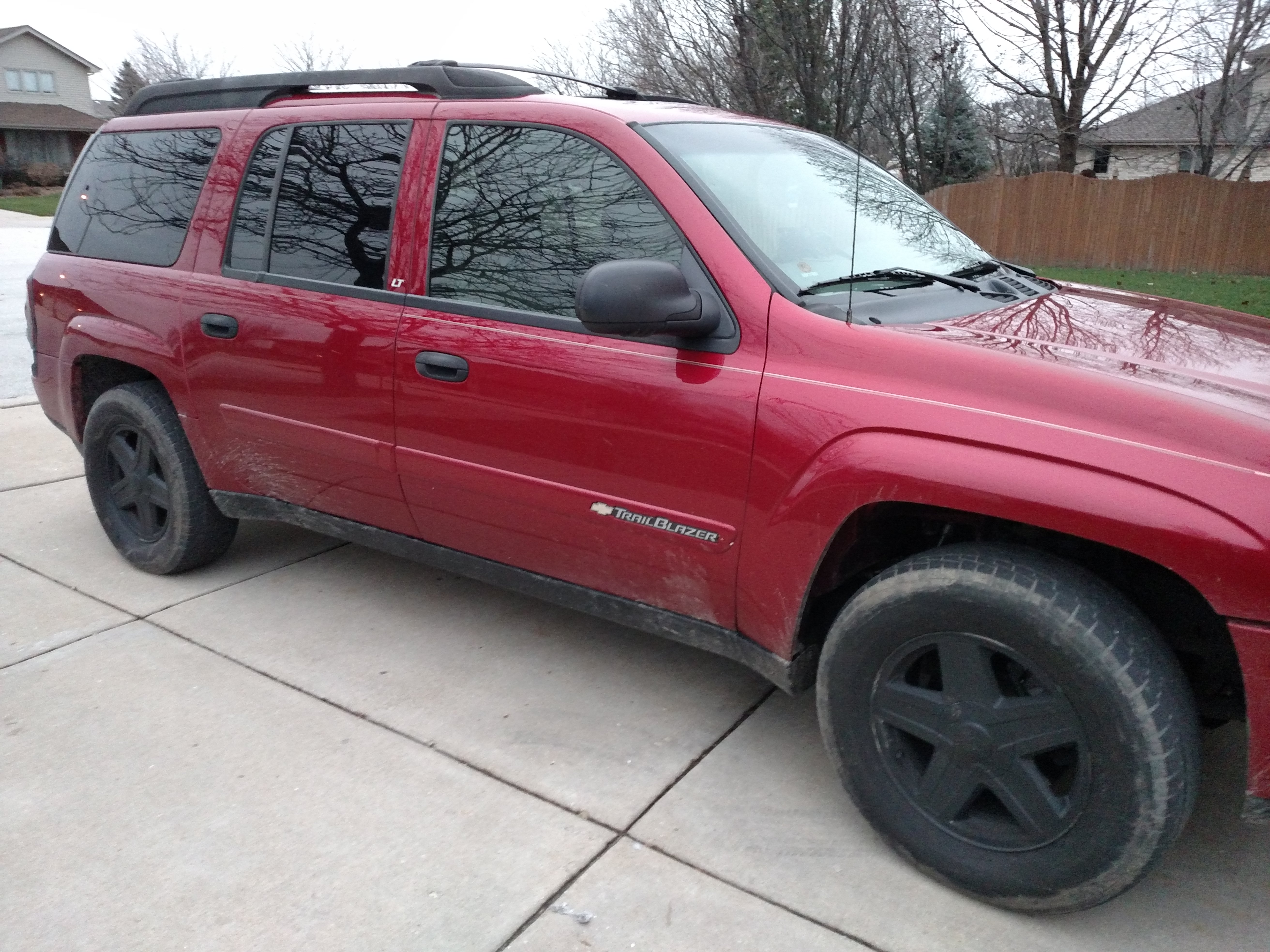

by Mrandersonxd » Wed Dec 16, 2015 11:21 pm
Lift Done.

by v7guy » Thu Dec 17, 2015 7:21 am
We need more pictures! LOL
by DirtyBacon04 » Thu Dec 17, 2015 12:15 pm
v7guy wrote:We need more pictures! LOL
That's Jason... he's our local Creepy Cowboy. Mostly harmless... unless you're a tree.
by v7guy » Thu Dec 17, 2015 2:32 pm
by Mrandersonxd » Thu Dec 17, 2015 4:45 pm
Ask and you shall receive.

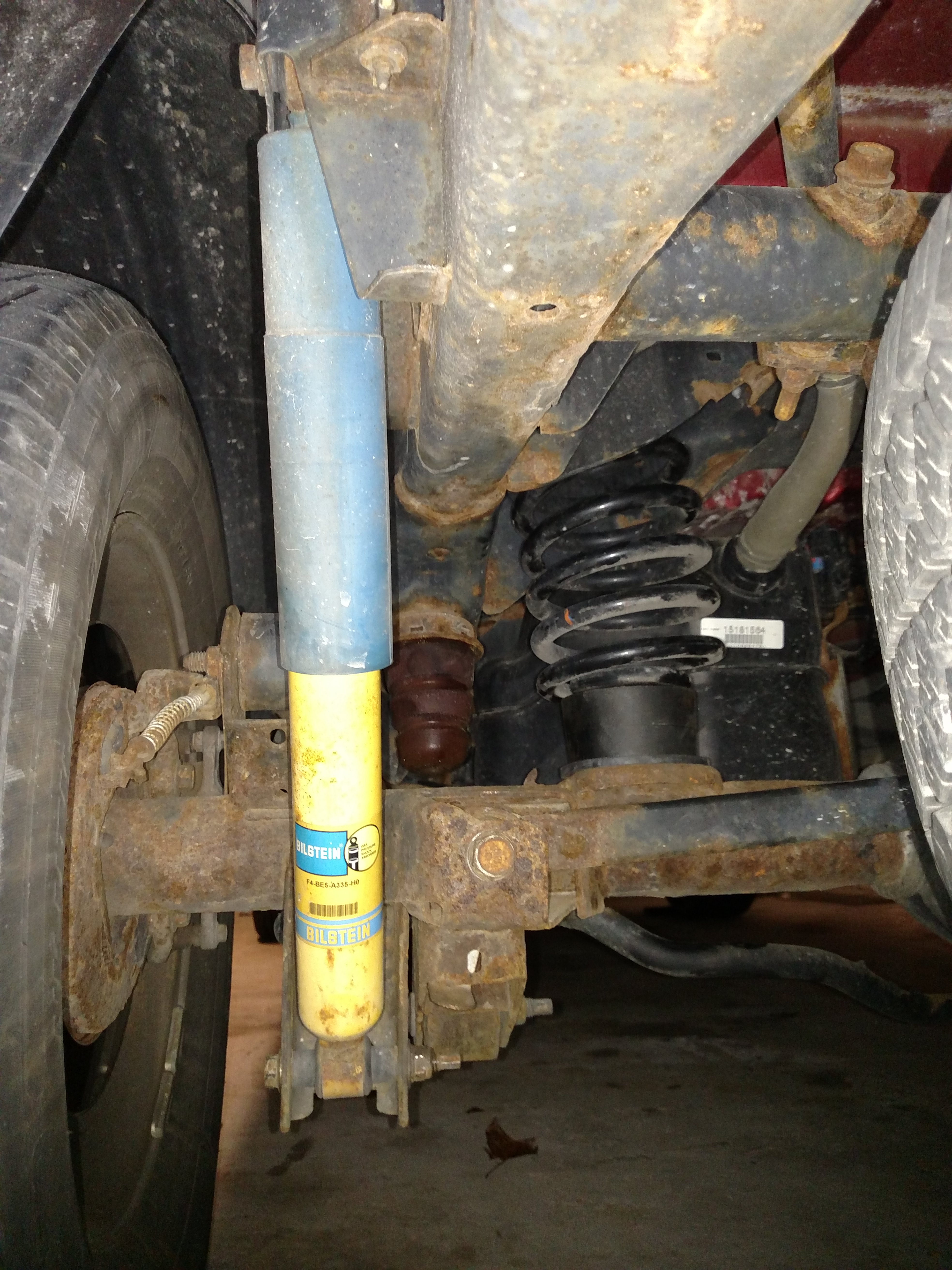

Just driving it to and from work the past 2 days my front bilsteins seem to be doing nice. I cross a rough railroad crossing and a terrible gravel road to get to my shop. I hear a knock from the rear when its extended, fronts handle it great. Could this be the end links hitting the UCA? I need to get that sway bar out of there.

Mrandersonxd wrote:I hear a knock from the rear when its extended, fronts handle it great. Could this be the end links hitting the UCA? I need to get that sway bar out of there.
Naw your stock EXT rear shocks are topping out. With the lift you need longer rear shocks which has been stated. A lot of guys run skyjackers n8030.
Skyjacker (N8030) 2" Slim body Softride Nitro Shock Absorber https://www.amazon.com/dp/B001B4QVR0/re ... Dwb20H94FN

by TBYODA » Sun Dec 20, 2015 11:24 am
Good deal, BTW you gonna need to use bunch of washers or some kind of spacer on the bottom shock mount. So the shock doesn't bang around.
