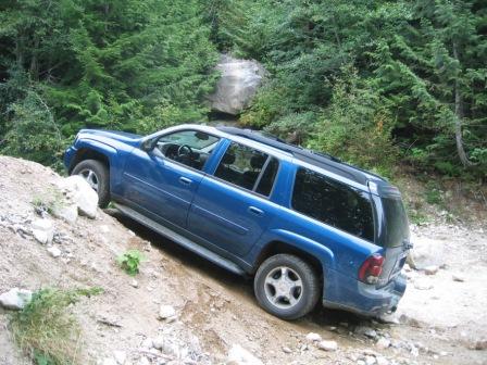

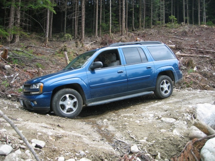

I managed to resize a few pics of my first trail run, here they are:
by BC backroader » Fri Sep 12, 2014 11:48 am
Well, that didn't work, all I got was a corner of each photo to show up. Sorry about that, I'll have to upgrade my Paint skills, obviously.
There we go - got it done :D
