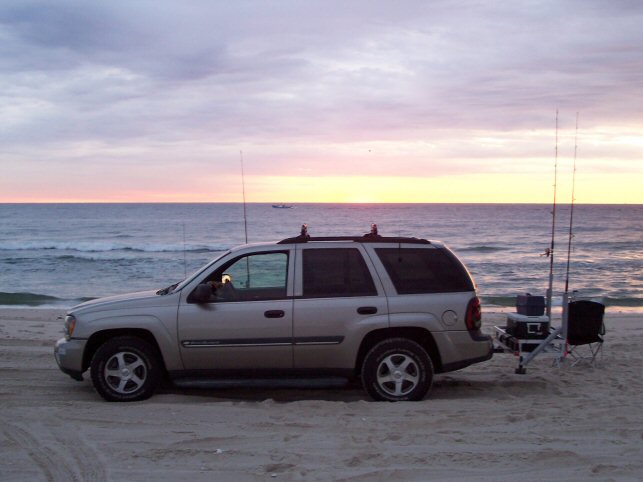

Hi everyone.....Lurker here. My name is Matt from Levittown, Pa. My 02 TB with 73k on it is stock for now. It doesnt go off road often , but I am gonna get a beach permit for Island Beach State Park this year and will need to lift it. I had it on the beach for 2 years prior and it did just fine but needs some more height. Knock on wood I never got her stuck, but never put her in a situation where I was unsure how she would do. Back to my lift, I am gonna do the Liftmeister 3 inch but am not going with bigger tires. I want new struts and springs upfront and new shocks and springs in the rear. And I want to get rid of the moans and groans and thumps it makes when I go over speed bumps but thats a whole nother thread. So I need to do more homework. It is dizzying all the options there are to do. I dont want to change the ride, dont want to lose the awesome turning radius. I like the way it handles. It will still be my family truckster, and want I it to be highway capable. Any input from you guys would be greatly appreiciated. I have some ideas from a fellow Levittowner and what he did to his TB, and am probably going to something similar.
