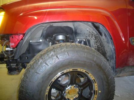

with the wheel adapters you shouldn't have any trouble with the ball joint. We're you testing the wheel without the spacer/ adapter?
if you're concerned about having a lip there I'd just slice the lip, cut the fender back for clearance then tack the lip back to the fender. As long as you go slow you shouldn't have any issues with it warping.
the problem with that lift goes beyond just the ball joint, you also end up binding the CV at the tripot. We had a new guy come on here talking about destroying his diff and t case and CVs by using that lift. You've been warned.

Wow. I'm glad I read and ask questions before I order crap off ebay! lol I'll work on other methods for the lift! If I can find the funds, I'll just go Radflo. Otherwise a local lifted TB guy suggested he'd buy a new 3" kit from mark and let me borrow his 2.5" until I buy my Radflo. Still looking at options!
I was test fitting with MarkMC's wheel adapter installed. I'm aware everyone says it fits, but seriously, it was going to hit. lol We worked with the left front. We installed a +25 wheel and put a straight edge on it. I was straight on with the bolt for the upper ball joint. Considering that allows for no bulge of the tire at all, this wheel is not going to work for me. Sorry I didn't get pics of the ball joint clearence.
Youre fender idea is the same as what I'm hearing locally. His looks good! I love what he did with his floor pan, that's on my To Do list. For the fender I think it would be more work and stress than just relocating it.

Update: I was test fitting with 8 1/2" wide wheel. It seems most guys with the +25 are running 8" wide wheels. Is it possible that makes part of a difference?
by djthumper » Sat May 11, 2013 10:52 pm
ErikSS wrote:Update: I was test fitting with 8 1/2" wide wheel. It seems most guys with the +25 are running 8" wide wheels. Is it possible that makes part of a difference?
Yes that will make a difference in the fit.
Yes, and that is why I ONLY like discussing these matters in terms of backspacing... offset seems to only complicates things unless you have a calculator and sketch pad in hand.
by djthumper » Sun May 12, 2013 2:10 am
:Iagree: And of course had we known he was talking about 8.5" wheels vs 8" it would have been caught sooner.

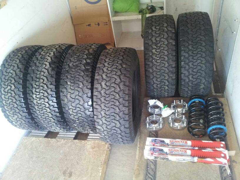

Tooling up!

Due to a bunch of kind offers from Offroad Trailblazer friends, my lift could happen sooner than expected! Infact, if everything falls into place, I may be lifted for the June 1st GMTnation event near Chicago!
