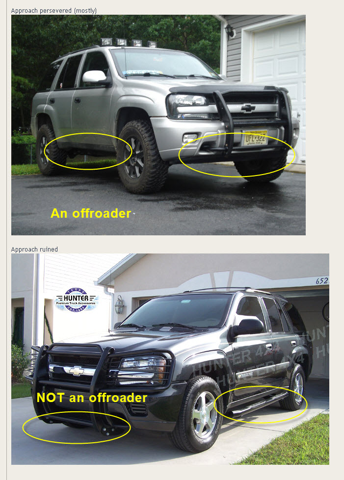

DetsTB wrote:This got my attention! I don't want to be shooting myself in the foot. Excuse me in advance if this a newbie question but how will it ruin your approach angle? How is it different from the steel bumpers like MDB? Can you elaborate.
The answer is simple, which one mounts below your radiator and then sticks out in front of it, and which does not? I feel pictures will do the best educating here.
Where it gets mounted is important.
Approach persevered (mostly)
Approach ruined

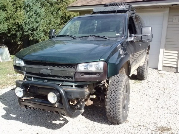

Add 2 inch lift, then add 2 inch bull bar that hangs below front bumper. :facepalm: And we've seen it done, on this site:
Dammann35 wrote:
Don't be like Dammann35. :poke:

by Cable810 » Fri Feb 07, 2014 11:10 pm
mikekey wrote:Add 2 inch lift, then add 2 inch bull bar that hangs below front bumper. :facepalm: And we've seen it done, on this site:
:lol: sorry couldn't help it :lurk:
by DetsTB » Sat Feb 08, 2014 4:45 am
Approach ruined
Pictures tell a thousand words. I just got learned. Thanks.

by Diacom » Sat Feb 08, 2014 1:54 pm
Here is a reason you want to preserve your approach/departure angles.
BTW, that's the same Hunter brand brush guard on the front as the previous photos, just modified by Mike when he mounted it to the bumper I ordered from him.
