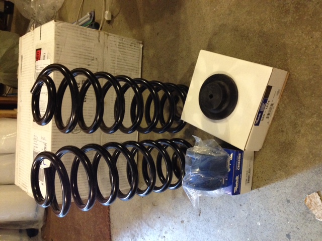

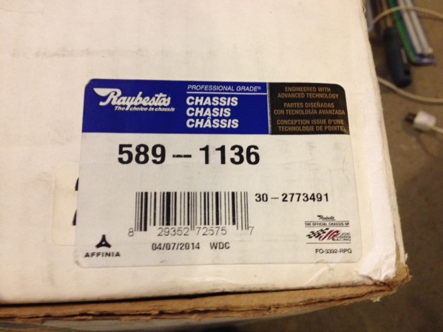

by CarbEnvoy » Wed Apr 16, 2014 1:42 am
My new rear springs arrived, along with insulators, and front sway bar bushings. The springs are the Raybestos EXT/XL springs. The label on the box is dated the day I placed my order. This just adds to my belief that springs from Raybestos, Moog, NAPA, and maybe others, are all the same, just labelled differently.
Springs, insulators, swaybar bushings
Springs and parts.
Label for the springs. Plain white box, with a sticker dated the day I ordered them. I'm guessing they have these boxes sitting there, and depending on what you order, Moog, Raybestos, etc. they slap that sticker on the box.
Spring label
