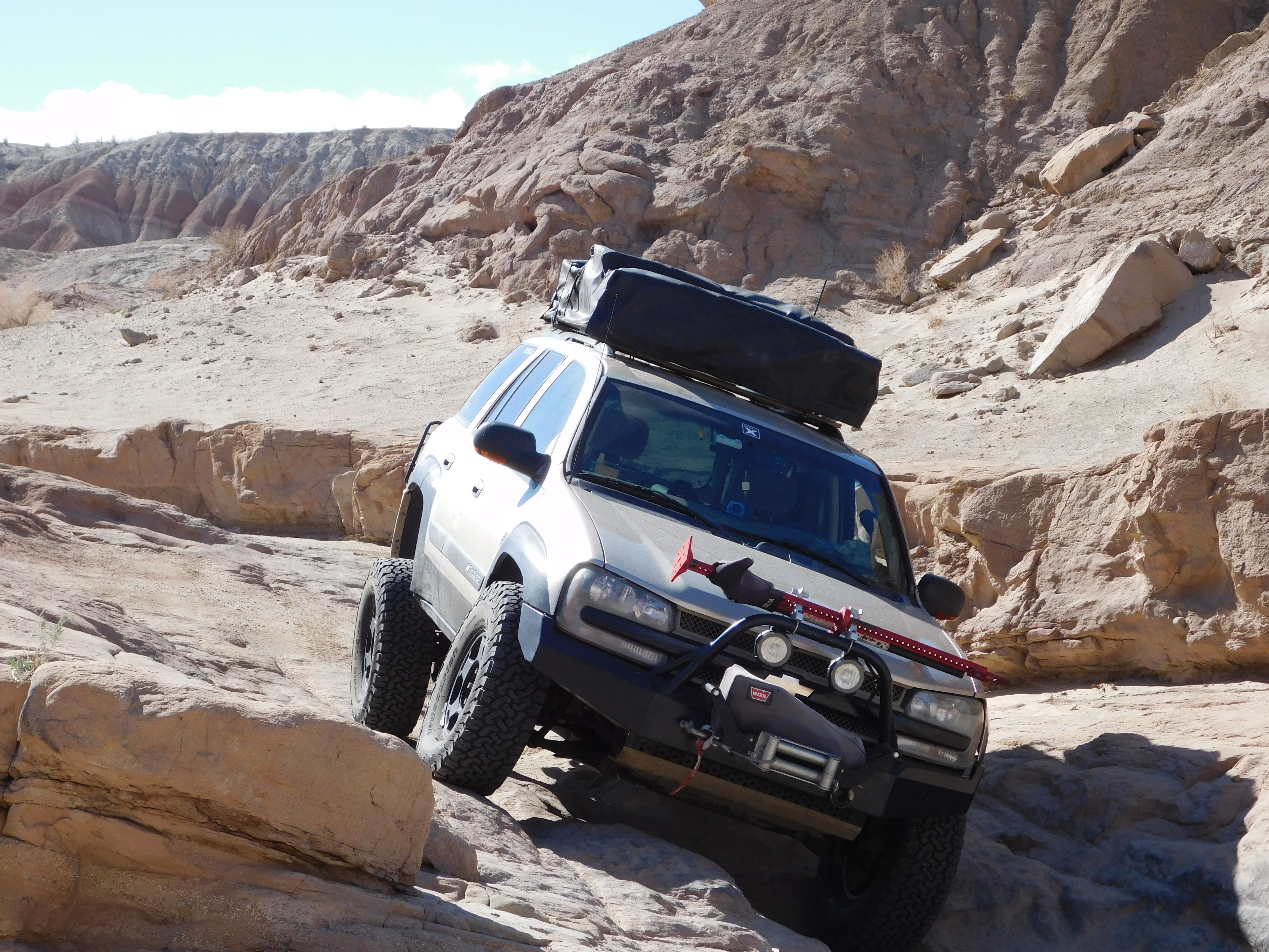

2004 Chevy Trailblazer LS
Drivetrain Specs: 4.10 gear ratio, 4WD w\ Powertrax No-slip auto locker (rear)
Suspension Modifications: RADFLO coilovers in front, BDS 2" spacers in rear, BDS FOX 2.0 gas shocks (rear), Rear Z71 springs, flipped Moog UCAs.
Exterior Modifications: MDB custom front bumper, MDB oil pan skid plate and MDB radiator skid plate (rhino lined), MDB Custom swing-open rear tire carrier, MotorSport Tech 1.5" spacers/adapters, Chevy Silverado Rims, BFG A/T KO2 33's (285/75R16), Fancy Envoy side mirrors with turn signal and defroster, Herculiner on Fenders, Doors, and Grille, 14ga SuperStrut roof rack cross bars, Smittybilt Roof Top Tent, MDB Rear swing-out tire/jerry can carrier.
Engine Modifications: Magnaflow Catbacks, PCMofNC tune
Drivetrain Modifications: AWD Sleeve mod, Hayden Maxi-Kool XL model 243012 Xmsn Cooler with thermostat, 8.6" rear axle, 4.10 gears, Powertrax No-Slip Auto Locker
Interior Modifications: Cobra CB Radio, Scan Guage II, Extra lights in cargo/tailgate area, Fram Cabin Air Filters installed, red/white Dome light installed, RAM Mount, Front/Rear dashcam, deleted single side rear seat, custom "coffin" drawer/sleeping system.
Recovery Equipment: Warn VR10000 electric winch, (2) tree saver straps, (2) snatch blocks, 48" Highlift mounted on front bumper, Lift Mate, HighLift Offroad Base, SmittyBuilt Element Ramps, 3x30 recovery strap, (3) 3/4" shackles, Shovel, SuperFlow Air Compressor, Staun Tire Deflators, Tire repair kit, Bugout bag (in case I have to abandon vehicle again)
Electrical Modifications: Optima Yellow Top battery, (2) 4" Hella Optilux HID offroad lights, 2" LED Alley lights (camp lights), 12" rear LED bar
