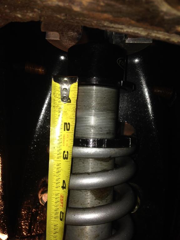

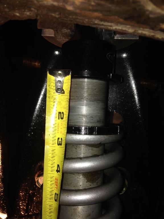

Installed my long a waited Radflo's. I did not adjust them at all yet. The screw thread is at 1 3/4" and 1.75" higher at fender from stock with 245/65r17. The ride is so much better not as stiff as I thought they would be with stock tires.

I got a great deal on some new to me lift parts from a fellow member, Rad & oil Skids, Z71 springs, 2" rear spring spaces, Mark's 6x5" wheel spacers and five stock 16" wheels and Guard dog tires. One still new thread and four about half used. Boy do they hum! So the other day I set to install the lift with the help of my son Nick. We had some trouble muscling in the Z71 spring and 2" spacers until I noticed we were fighting the rear sway bar connections. Once I remove the connection it was very easy. I started off adjusting the Radflo's with everything connected other than the tires. Not the smartest move. :wallbash: Found removing the upper ball join and moving out of the way may it very easy along with spraying the crap out of the treads with PB blast. :mrgreen:
I adjusted them to 2.5" for now, not sure if I will go higher down the road but I am happy with the out come.
fender to centr of wheel.JPG (19.11 KiB) Viewed 1122140 times

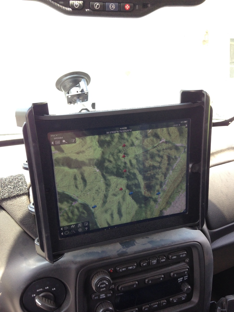

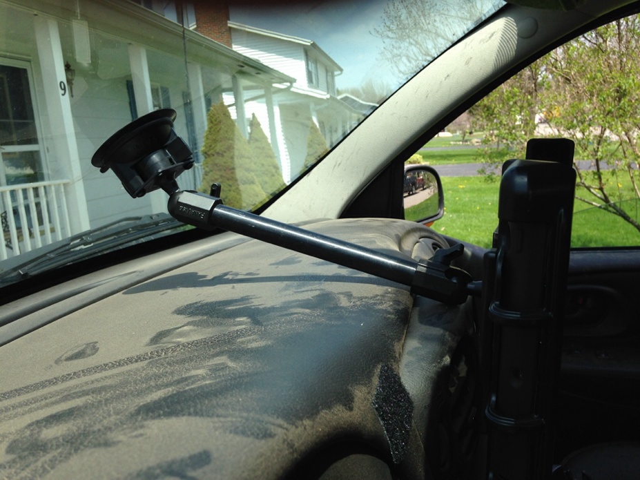

Got a Ram mount to be able to use my iPad for a off network Topo maps, dash cam and a monitor TB via. ELM327. Will only be use when on the trail. :flex dirty:

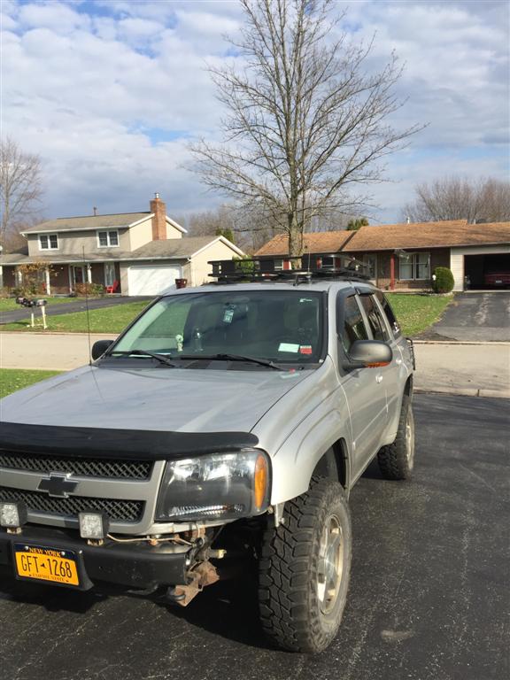

by TBYODA » Tue Jul 15, 2014 12:44 am

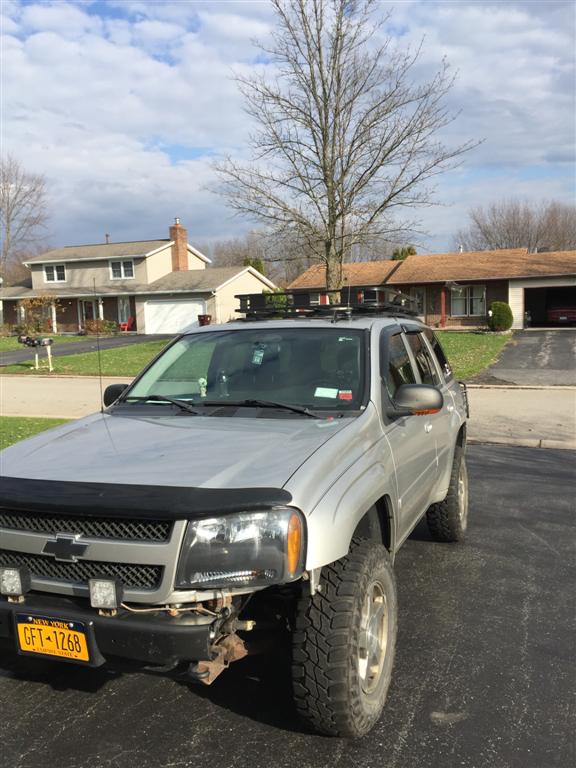

Installed some off-road lights and trimmed the bumper.

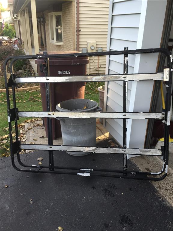

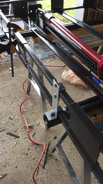

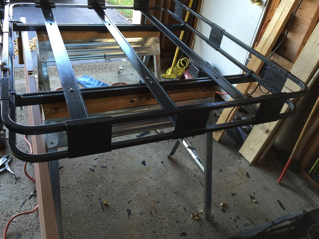

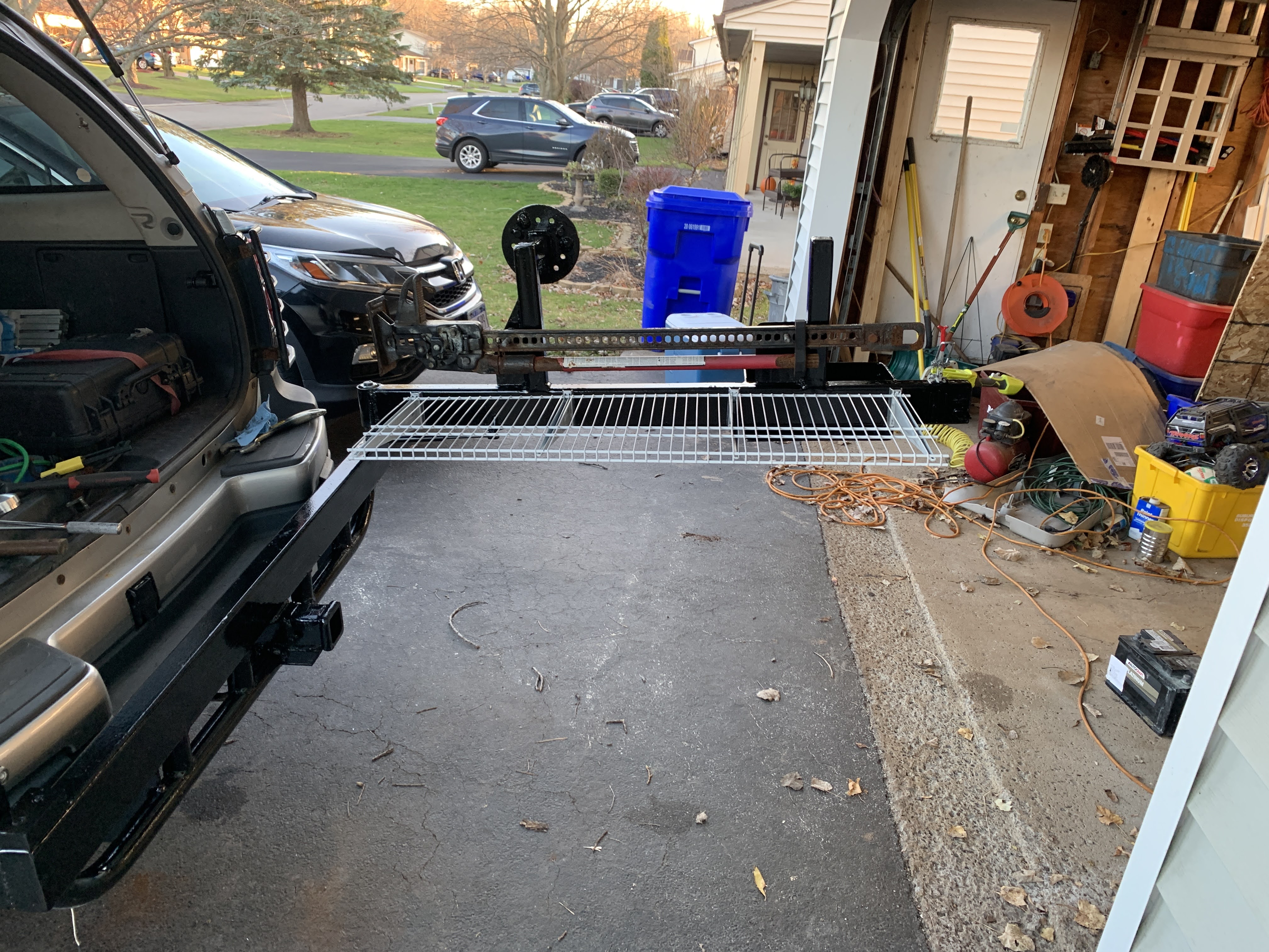

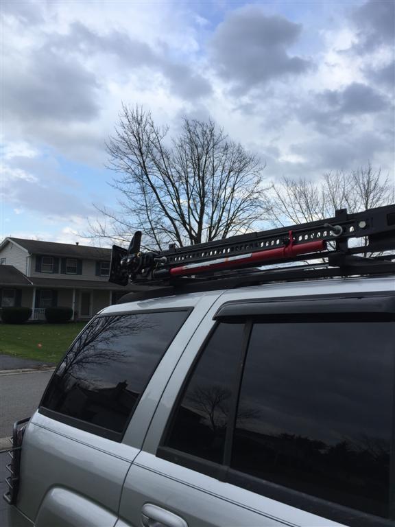

I had a small project that I have been working on and off for the last couple weeks. I picked up this Surco S5060 50 x 60 Safari Rack for dirt cheap ($70) off CL. :happy whip:
BTW the distance between the two inter screws mounted on the channel on the inside of the basket is exactly the width of your stock rails. Thank you Roadie and Alex G when google searching . :thumright:
I bought a qt of Rust-oleum Hammered black and went to town on the basket. I figured if I brushed it on it would be a thicker coat. We will see how it holds up.

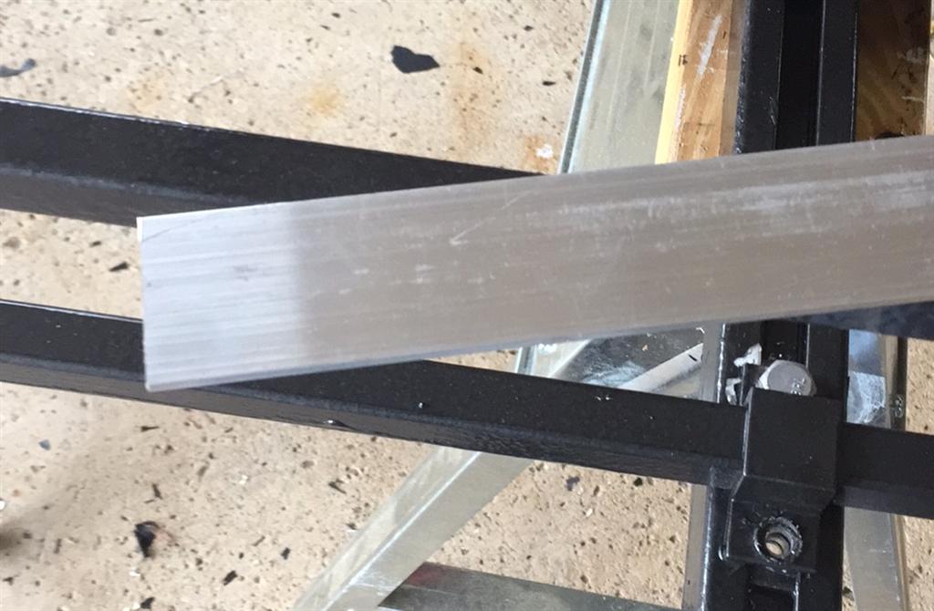

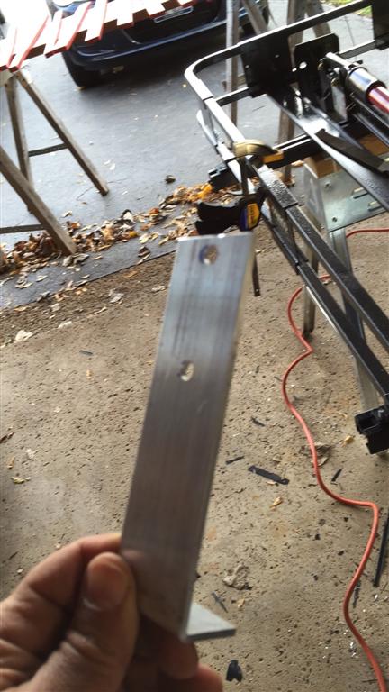

I also decided to mount my hi-lift to the basket and made some brackets out of aluminum flat stock. To mount the Hi-lift I used 1/2" galvanized hardware.

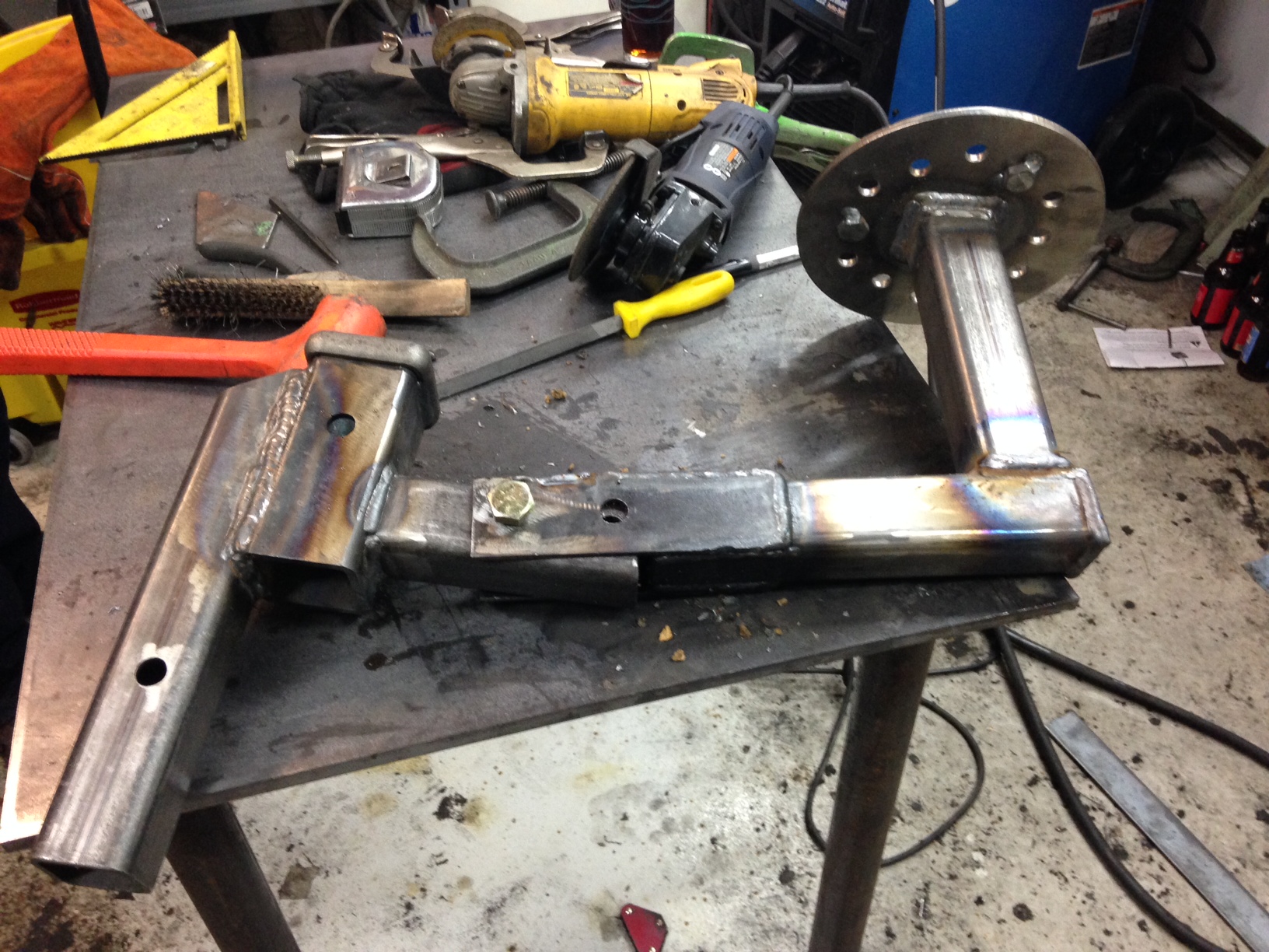

by TBYODA » Thu Jan 26, 2017 12:54 am

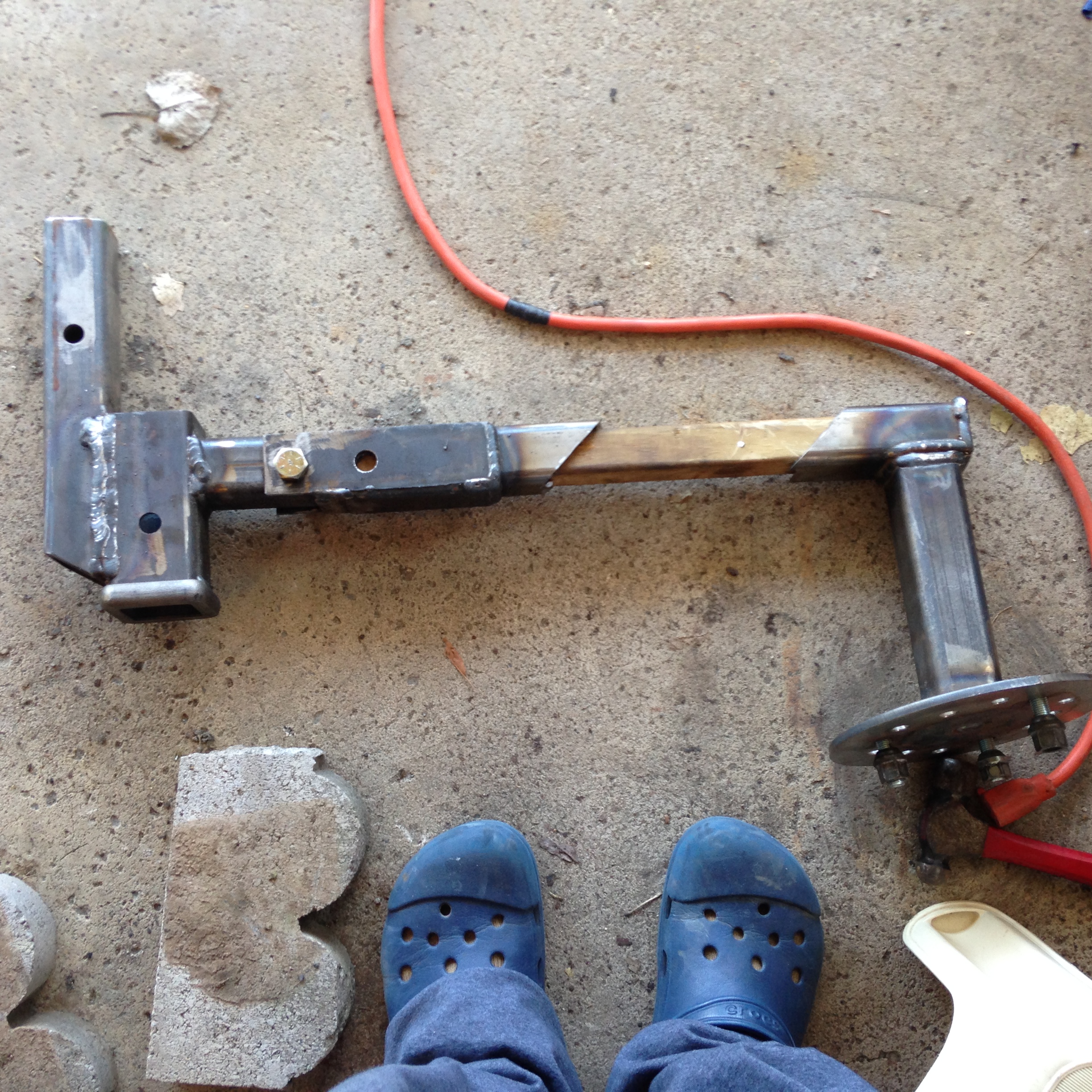

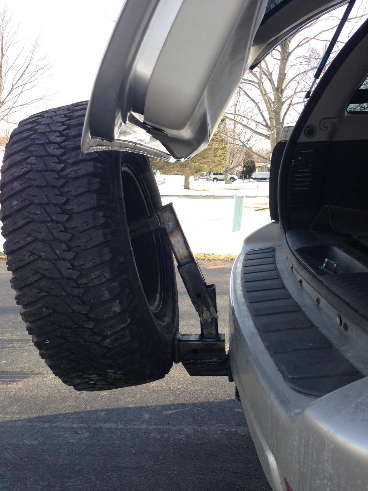

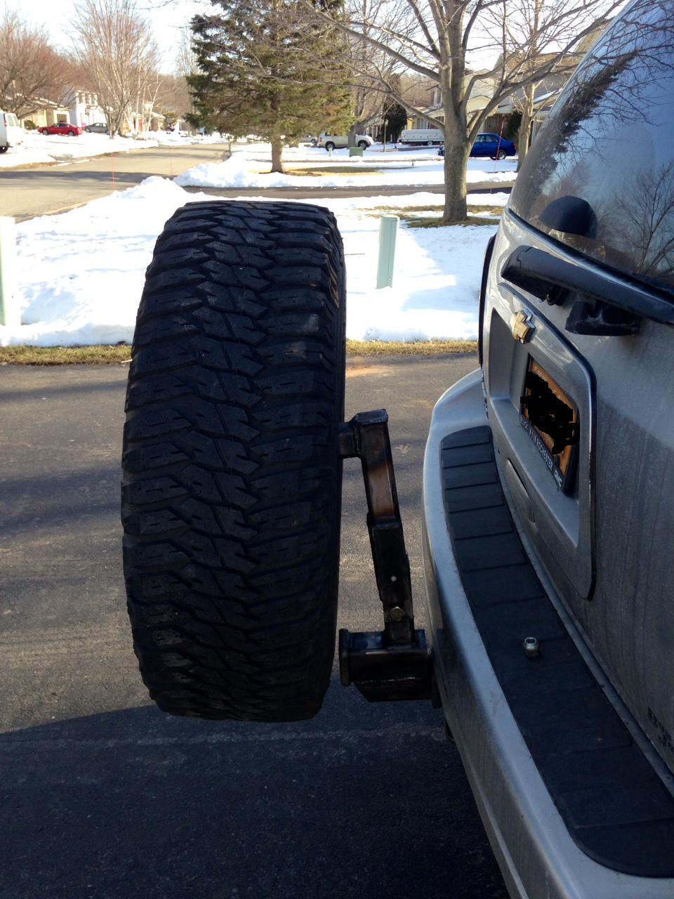

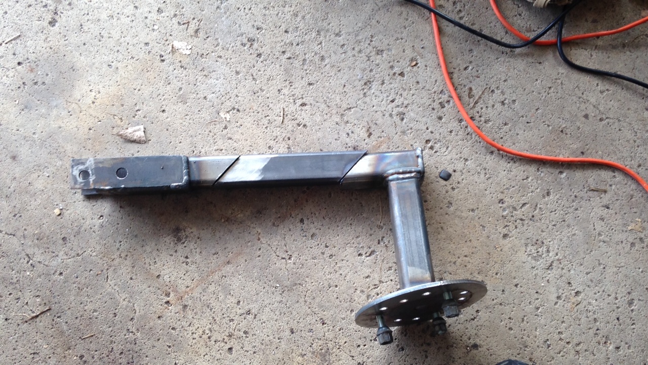

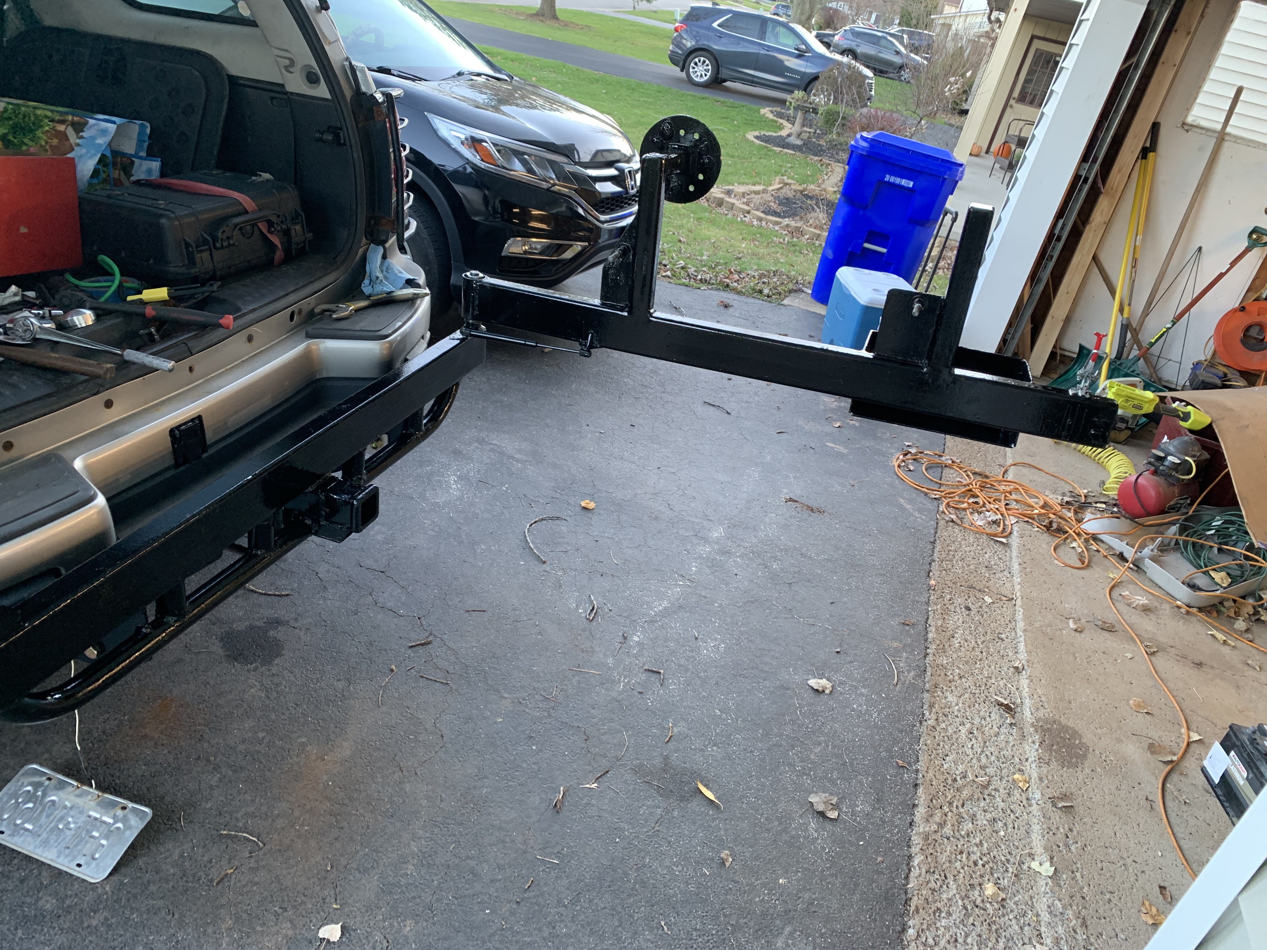

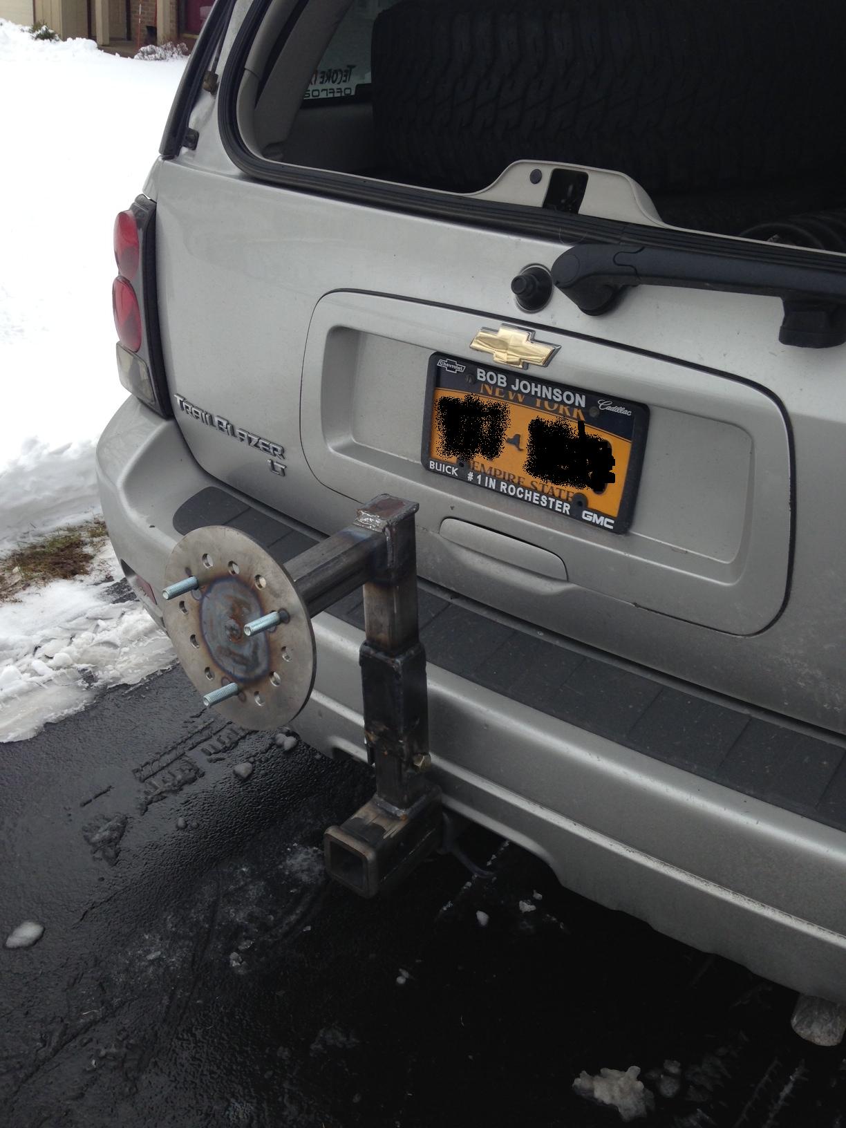

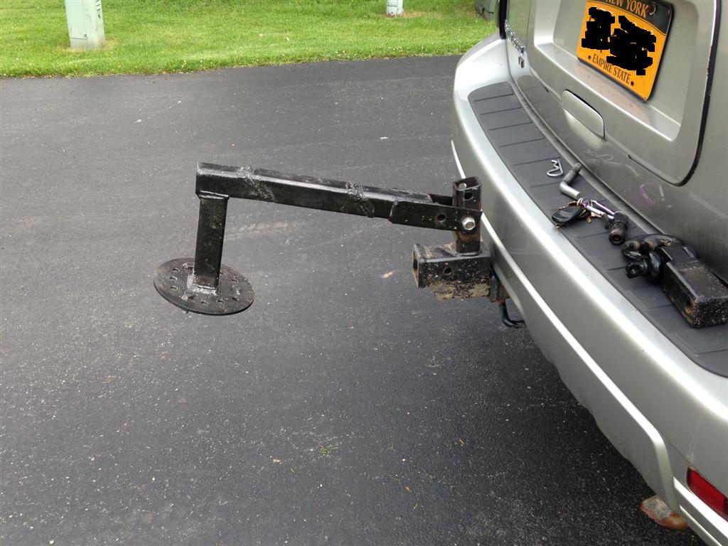

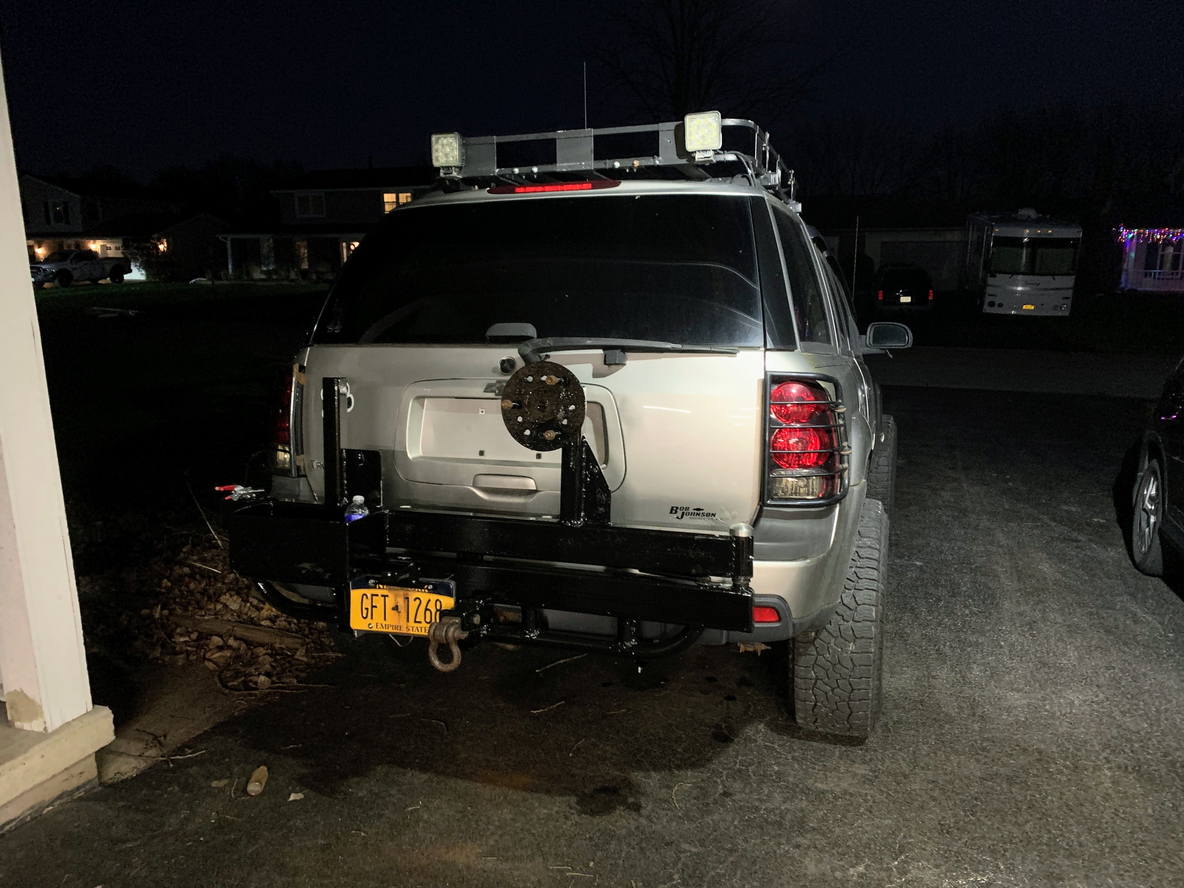

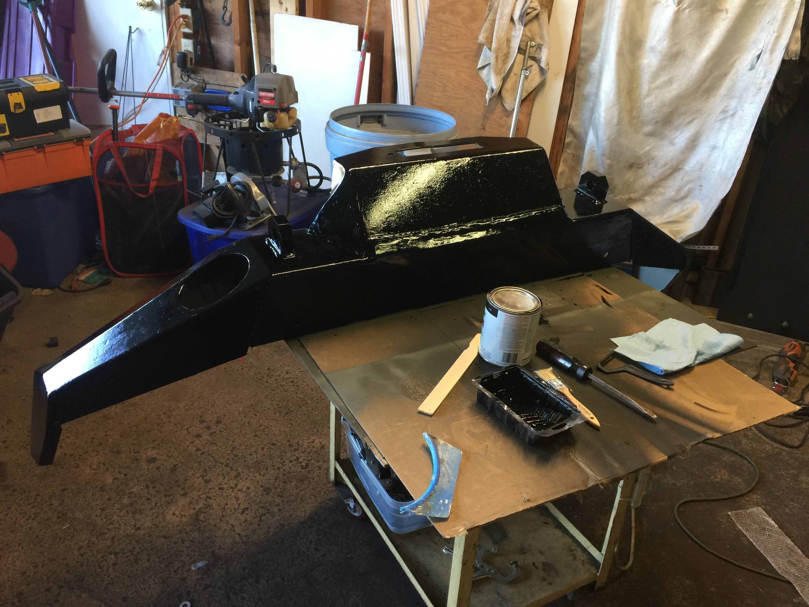

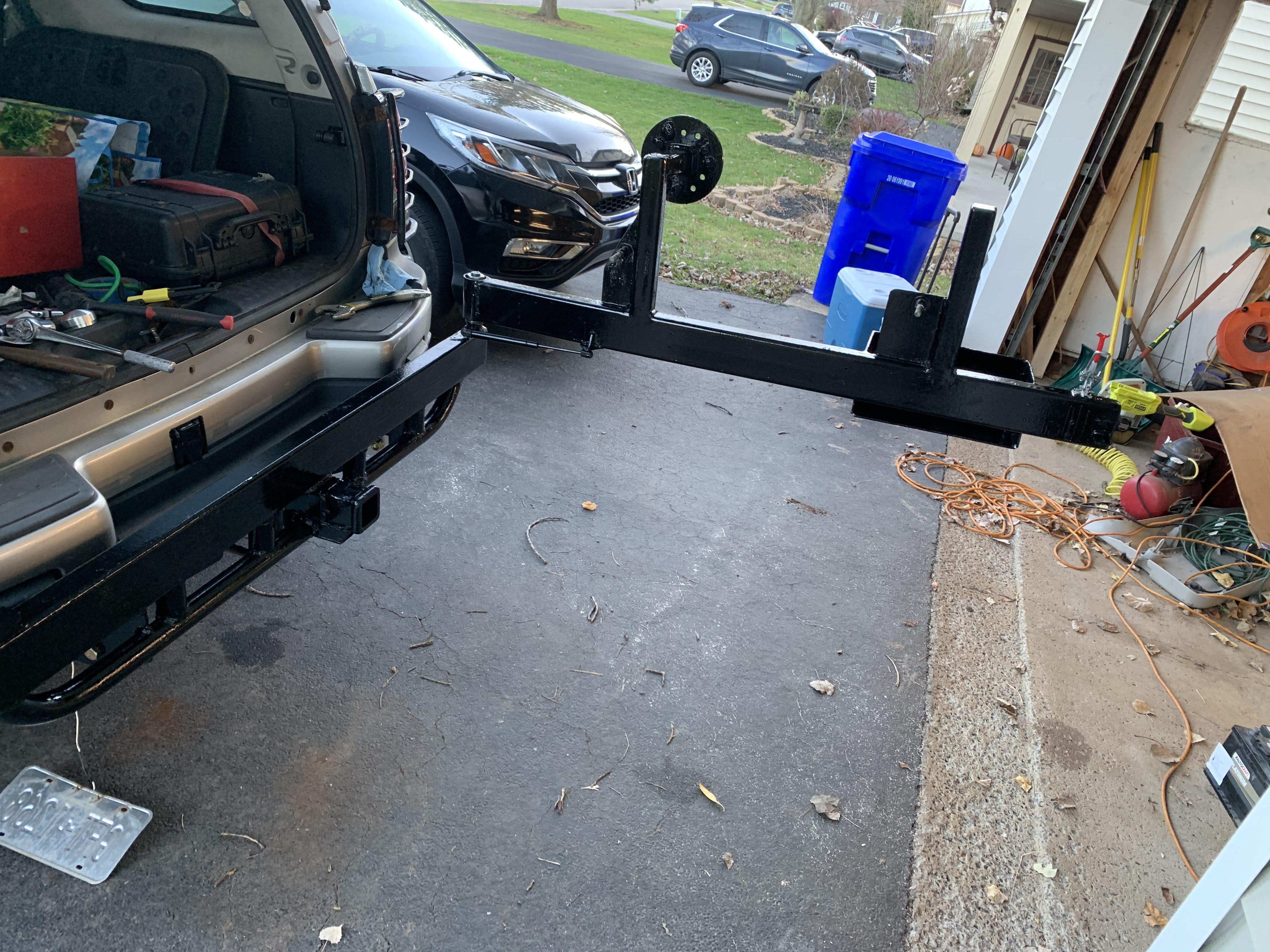

Been awhile since I updated my build. Had a few projects at the end of 2015 and in 2016. First I never liked that my spare tire blocked the view out the rear view mirror. Final plan is a steel rear bumper with swing out but until then let the third tire carrier rebuild start. :wallbash:
Version 1
Test fit hmm looks to low
We have problem
Oops that not gonna work
Version 2
mock up
New steel
Final Version 3
by TBYODA » Thu Jan 26, 2017 1:00 am
That's the ticket!

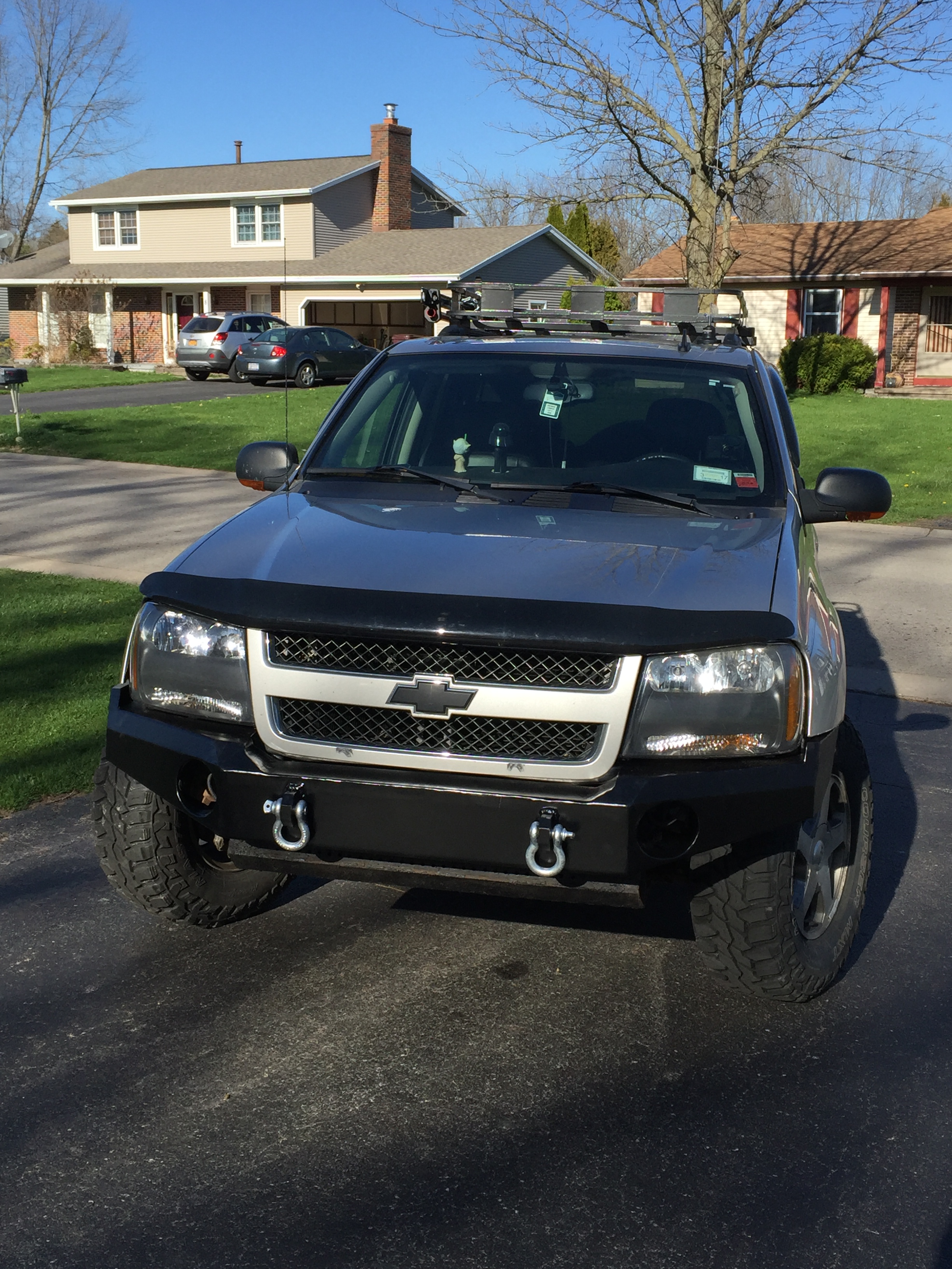

by TBYODA » Thu Jan 26, 2017 1:21 am

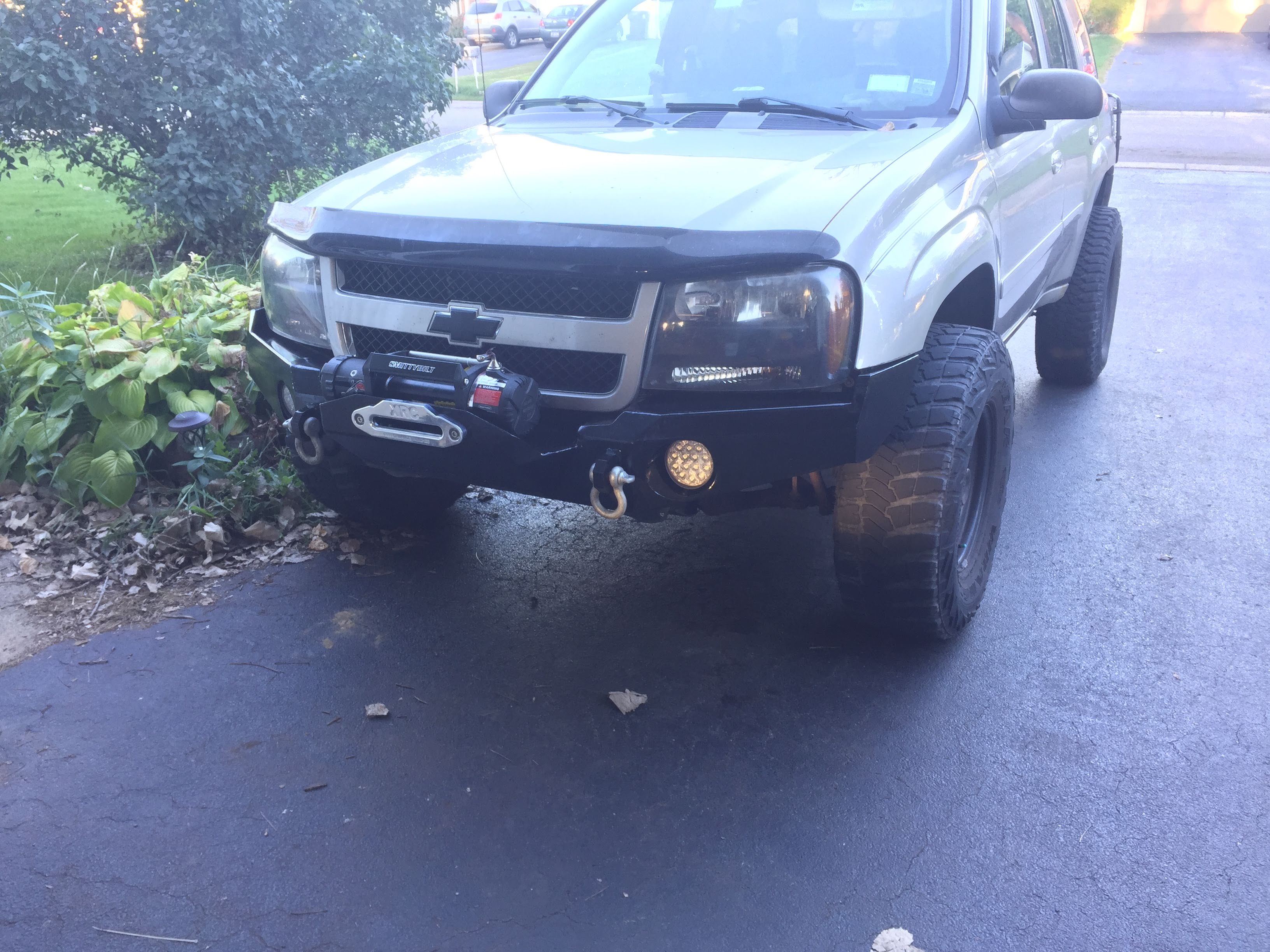

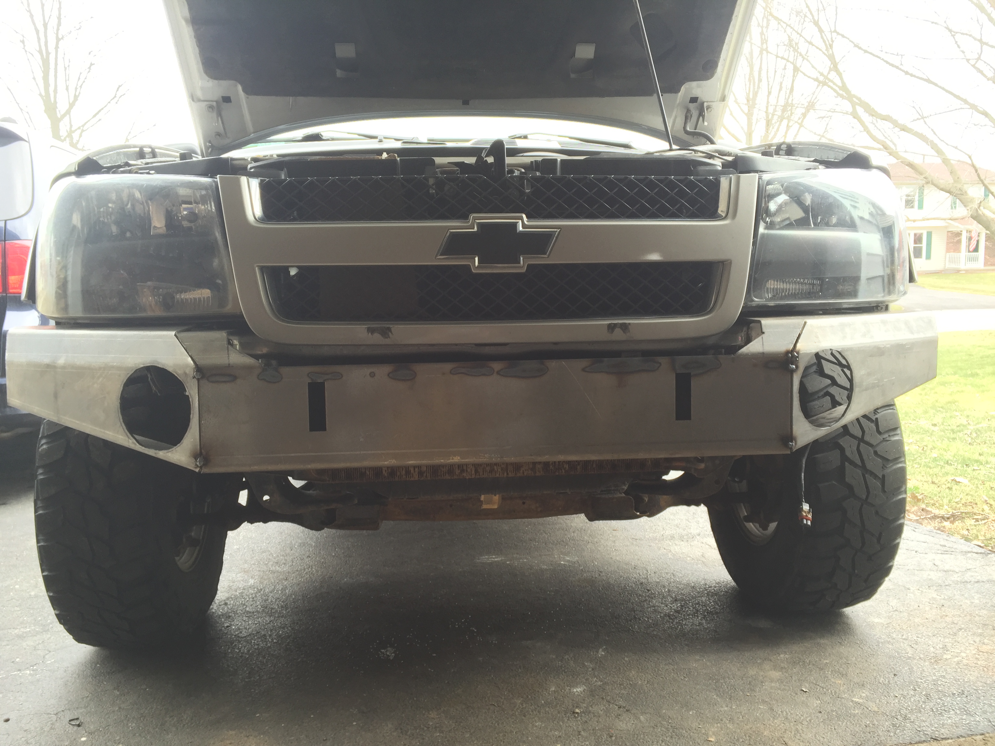

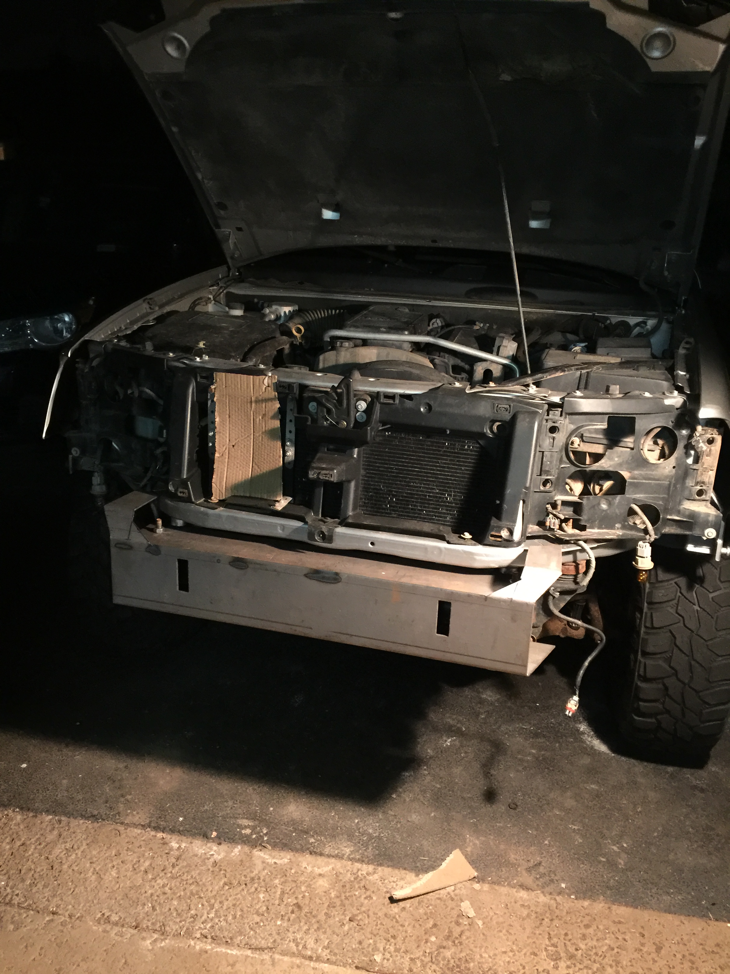

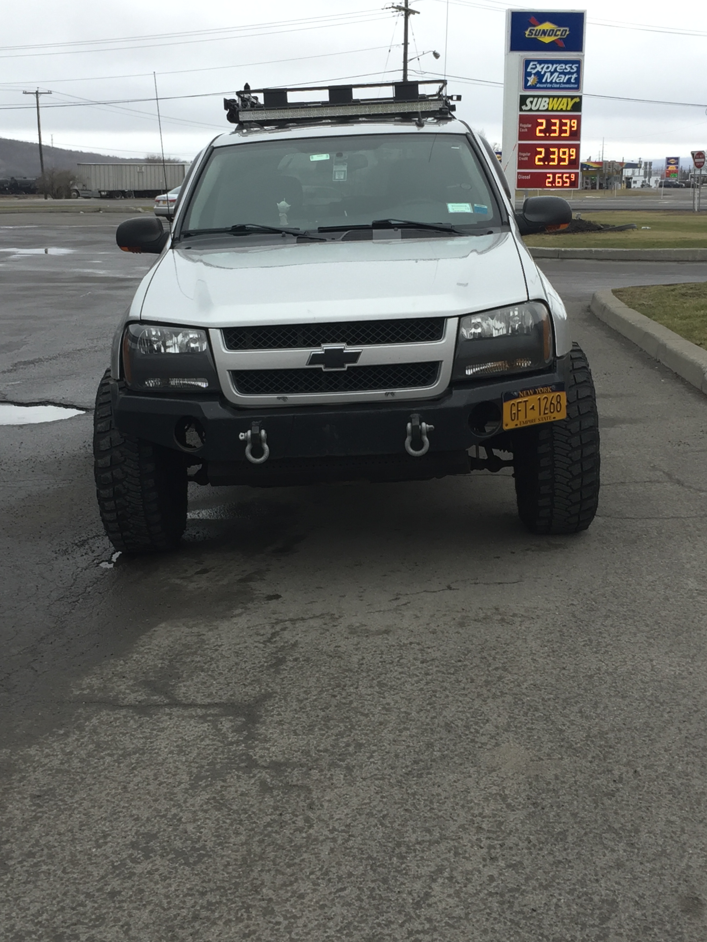

The first project of 2016 in the middle of winter was a MDB LT non-body lift front bumper kit. :excited: :woot:
I do want to say many thanks to Mr. Barton for answering the numerous questions along with help on mistakes from the newbie fabricator that I am.

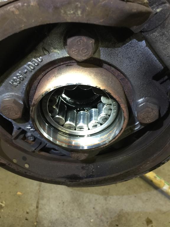

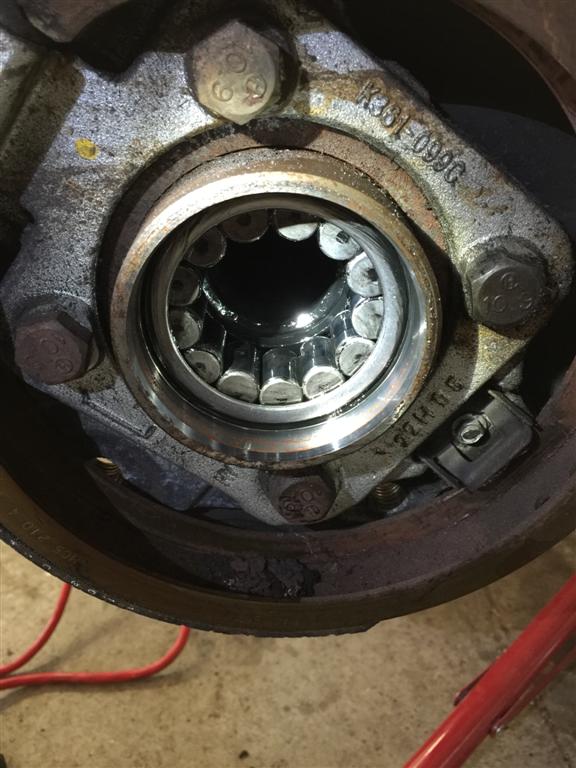

by TBYODA » Thu Jan 26, 2017 2:00 am

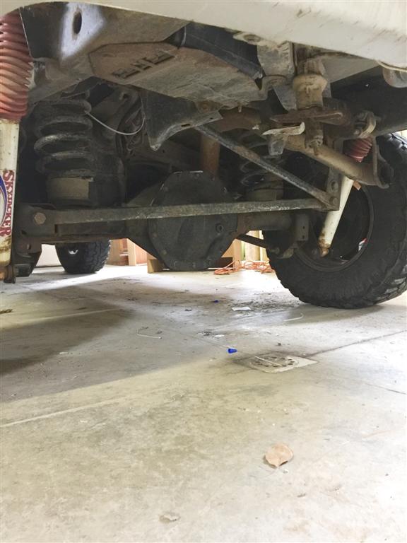

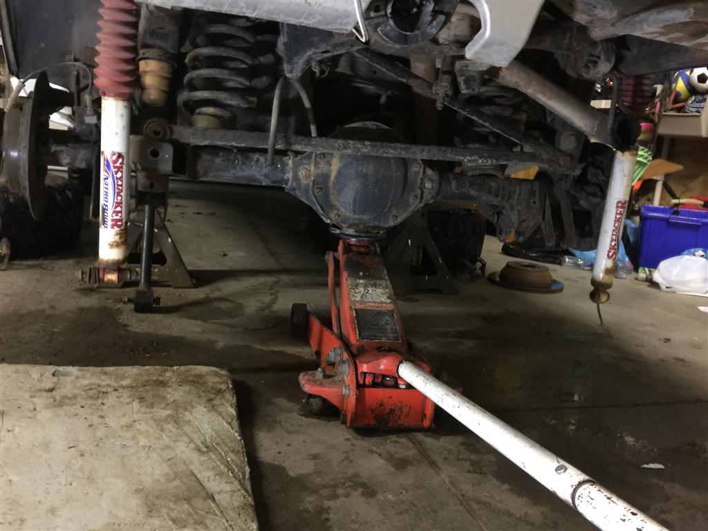

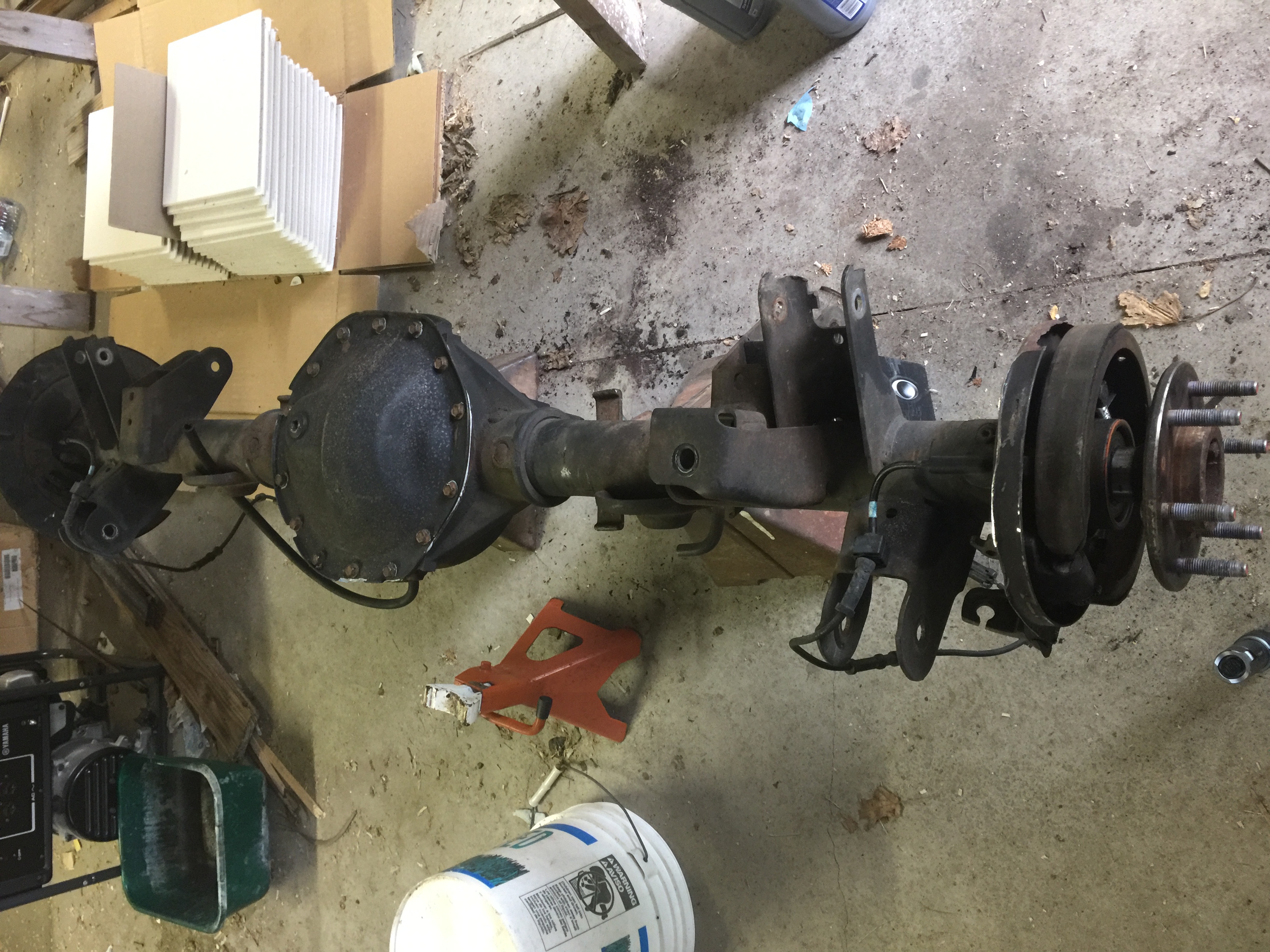

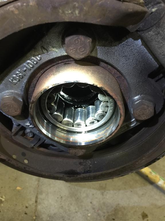

As luck would have it while surfing Craigslist I stumbled on a SS part out about 1.5 hours from me. Hand him $250 for the axle and off I went. Score!!!
I followed HARDTRAILZ SS axle build as many other have. Thank you and any other for pioneering the swap. :salut:
Parts list
1 SS axle of your choice, preferably low miles. mine had about 75k Score!
1 Moog 447 (or equivalent) U-joint adapter for drive shaft at rear joint
1 Moog 492-10 clamp kit
1 shortened steel drive shaft by 1.5", YMMV with rear adjustable control arms, measure 3 times, cut & balanced DS once.
2 axle seals ACDelco 291-315
2 wheel bearing ACDelco RW2010. (I did not replace mine as they looked good)
Out with the old 8.0 3.42 axle
In with the SS axle

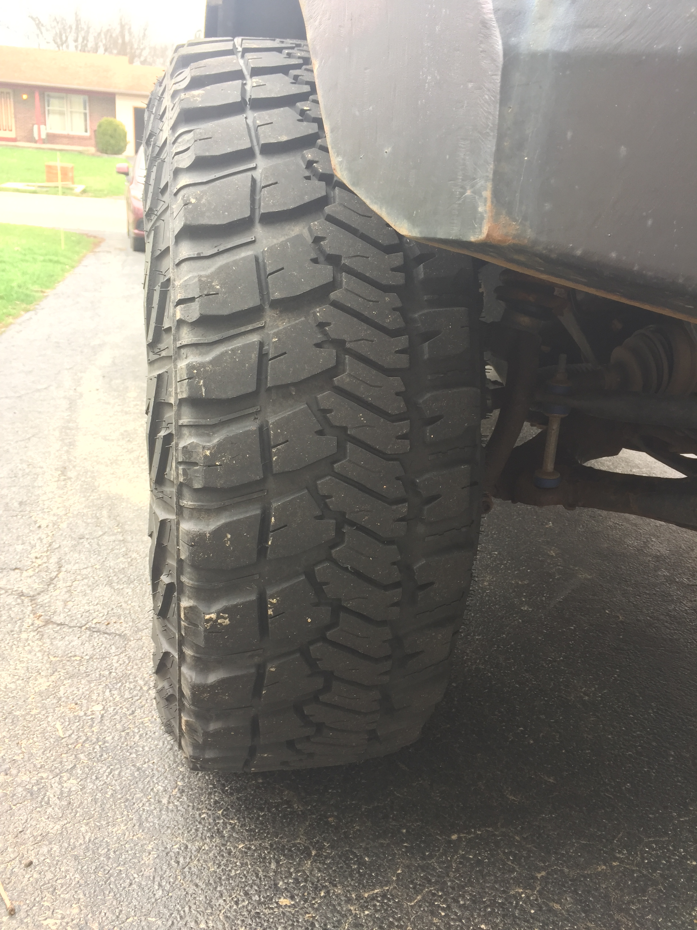

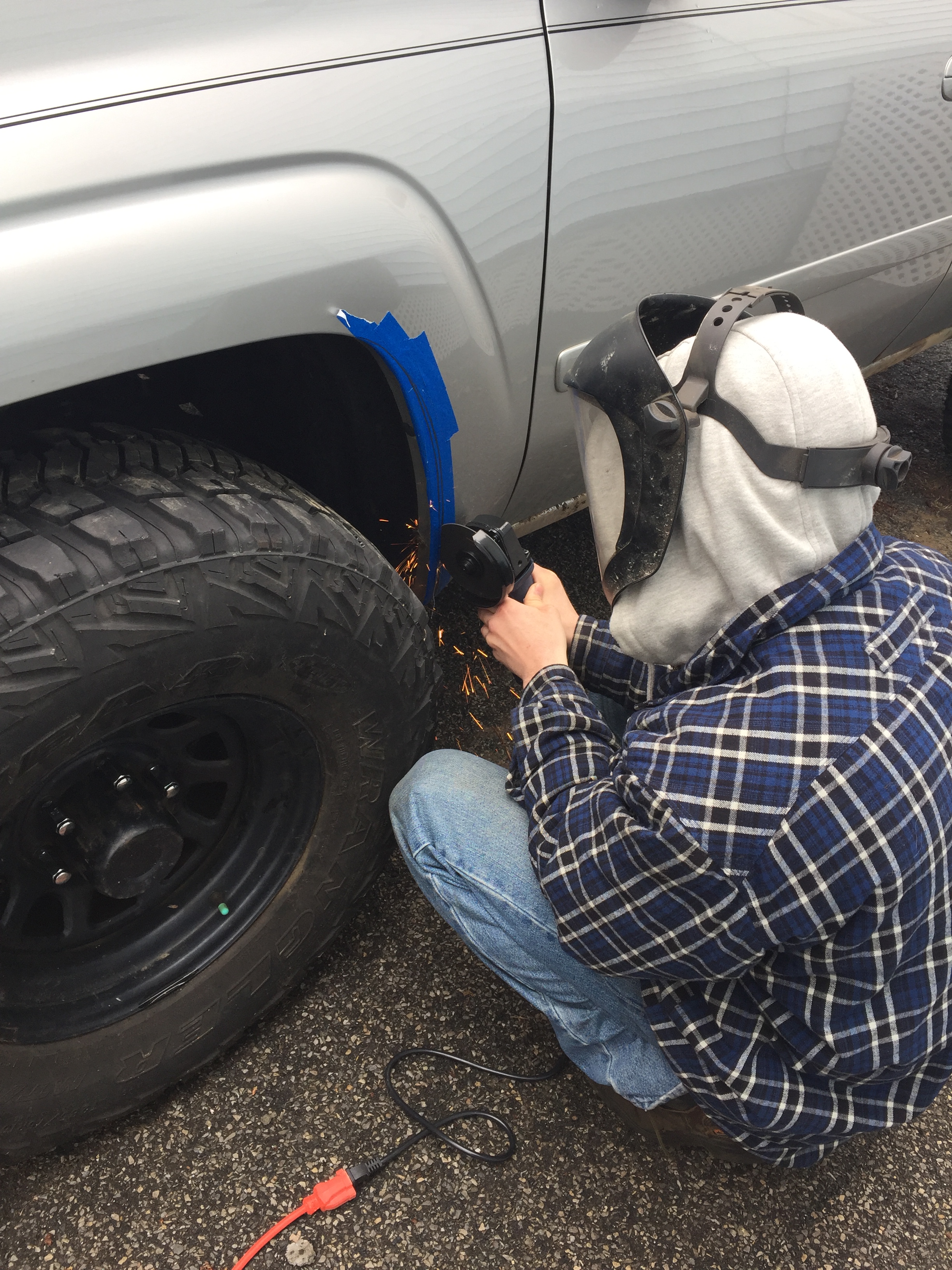

Got a great deal on some Goodyear MTR LT286/75R16 & some Pro Comp series 51 wheels from Moots1288 that I could not pass up. :woot: Needed to do some fender trimming but thanks to my good buddy Jason V7guy it was done in short order. I was unsure of the wider stance but now that I have the wheels and tires on I am digging them. :flex dirty:

Been a while since I have updated my build thread I have since sold my non-BL bumper to fellow member and bought a MBD winch bumper. I have also bought a rear swing out "kit" tire carrier from MBD. Very happy with the swing out.

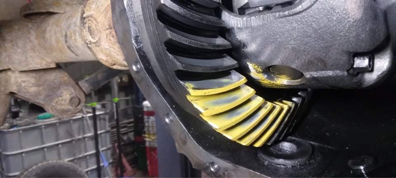

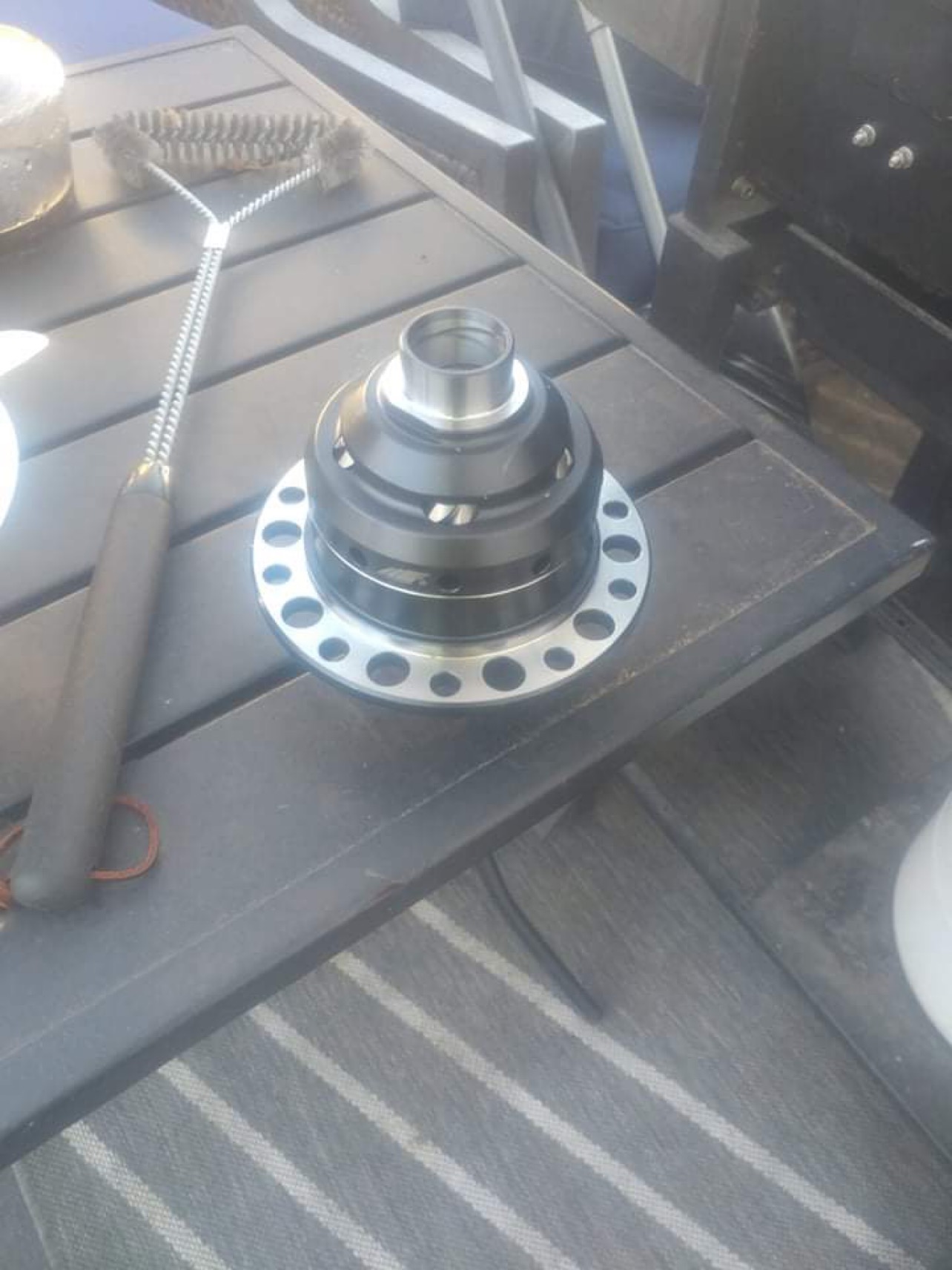

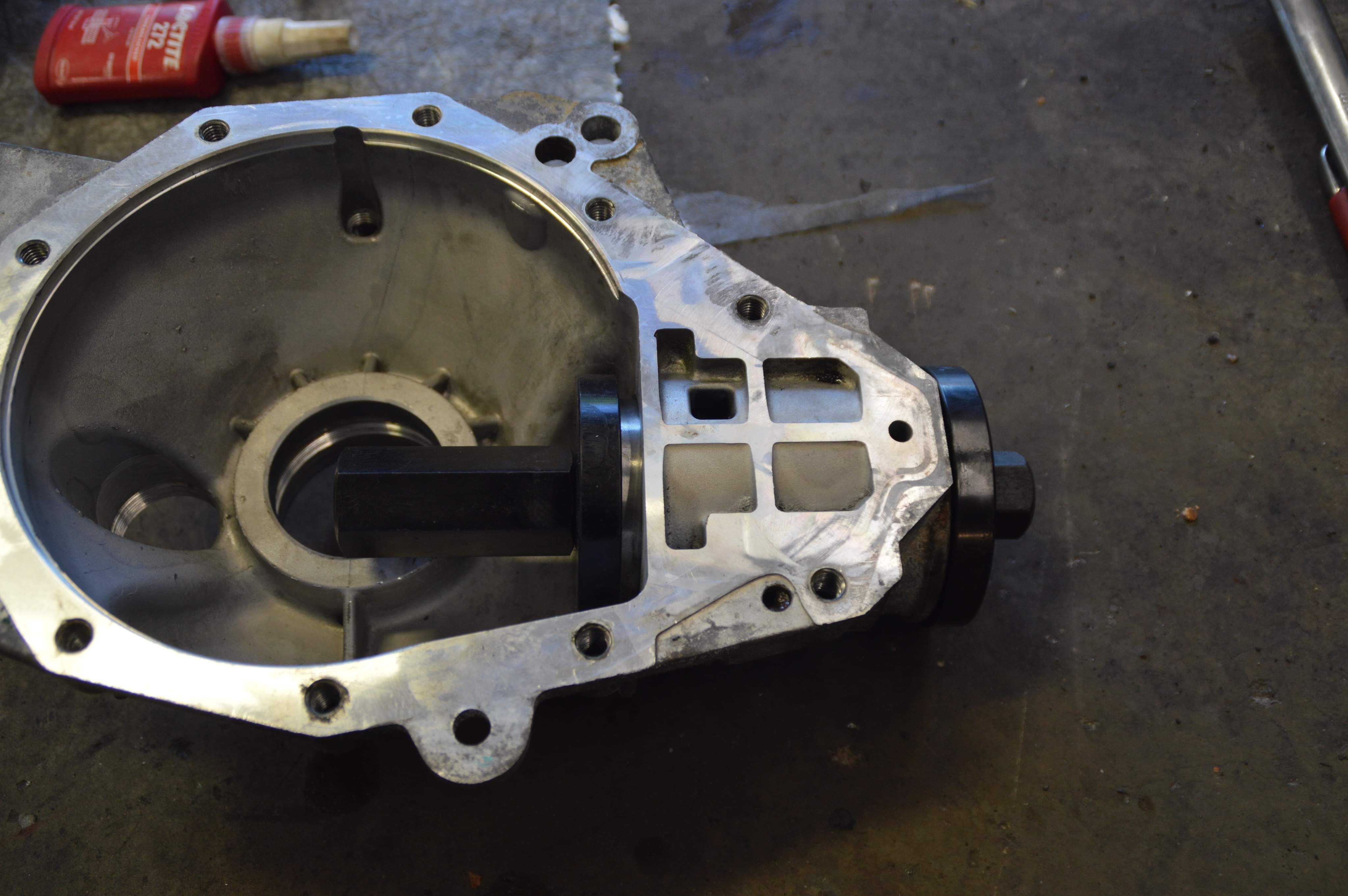

On a week long camping trip with dvanbramer88 my stock G86 wasn't cutting my current needs in the old GM 9.5" SS so in 2/2022 I bought a reman 9.5" G80 off ebay and had it installed, nice pattern on the used gears.

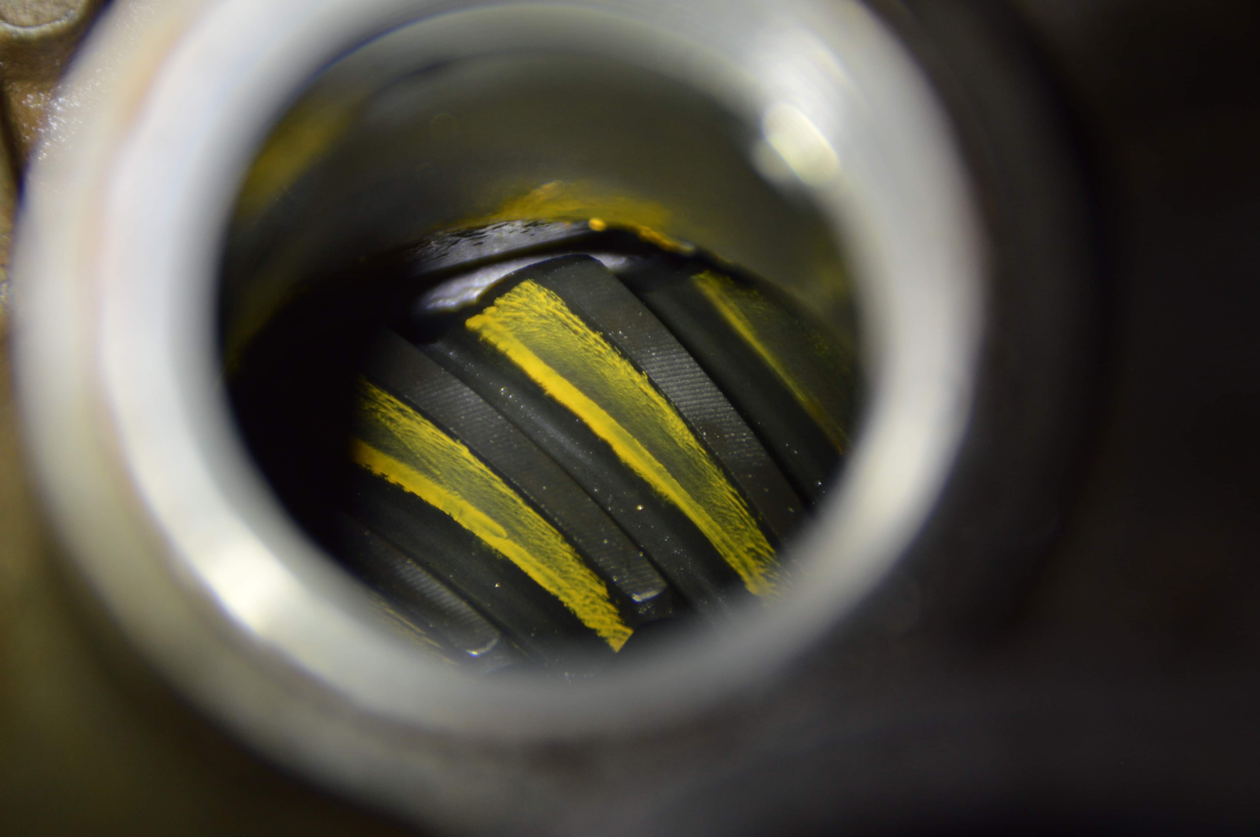

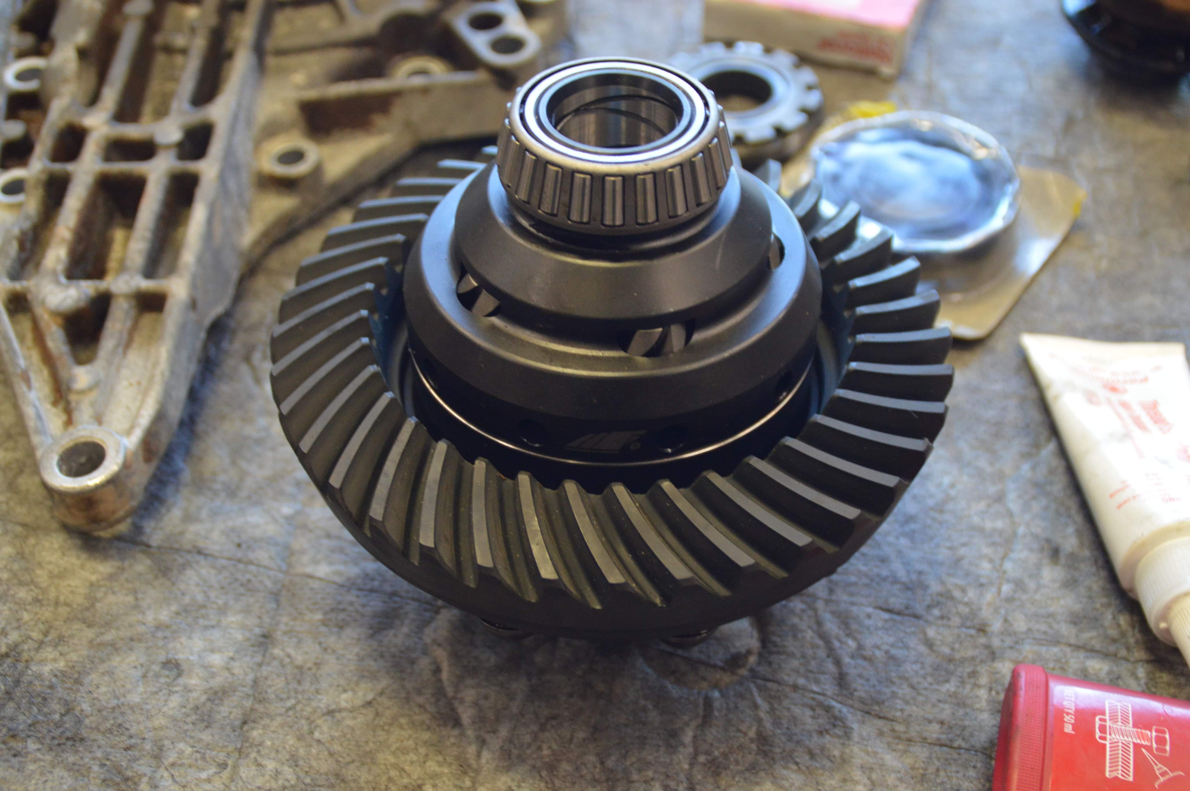

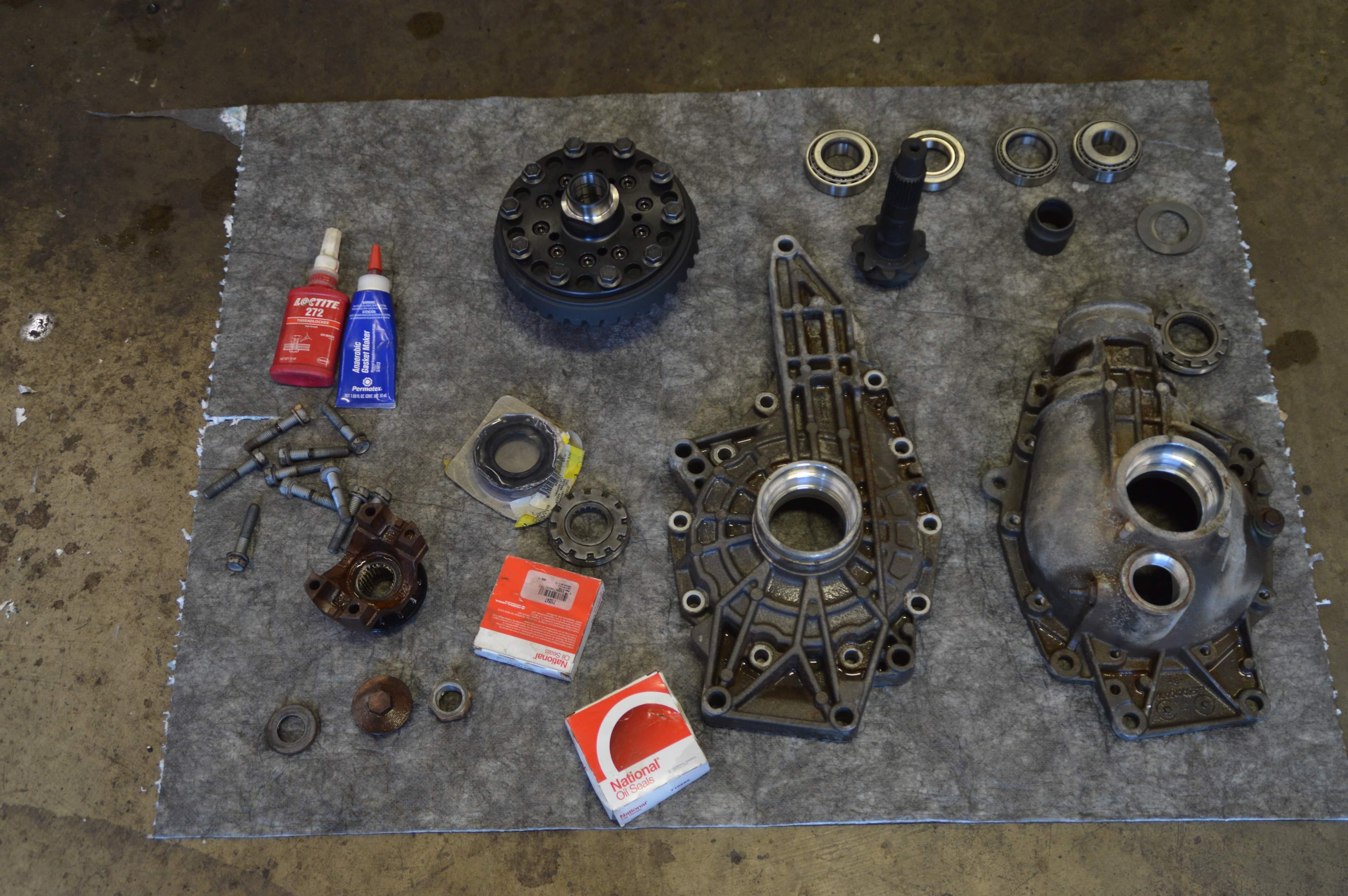

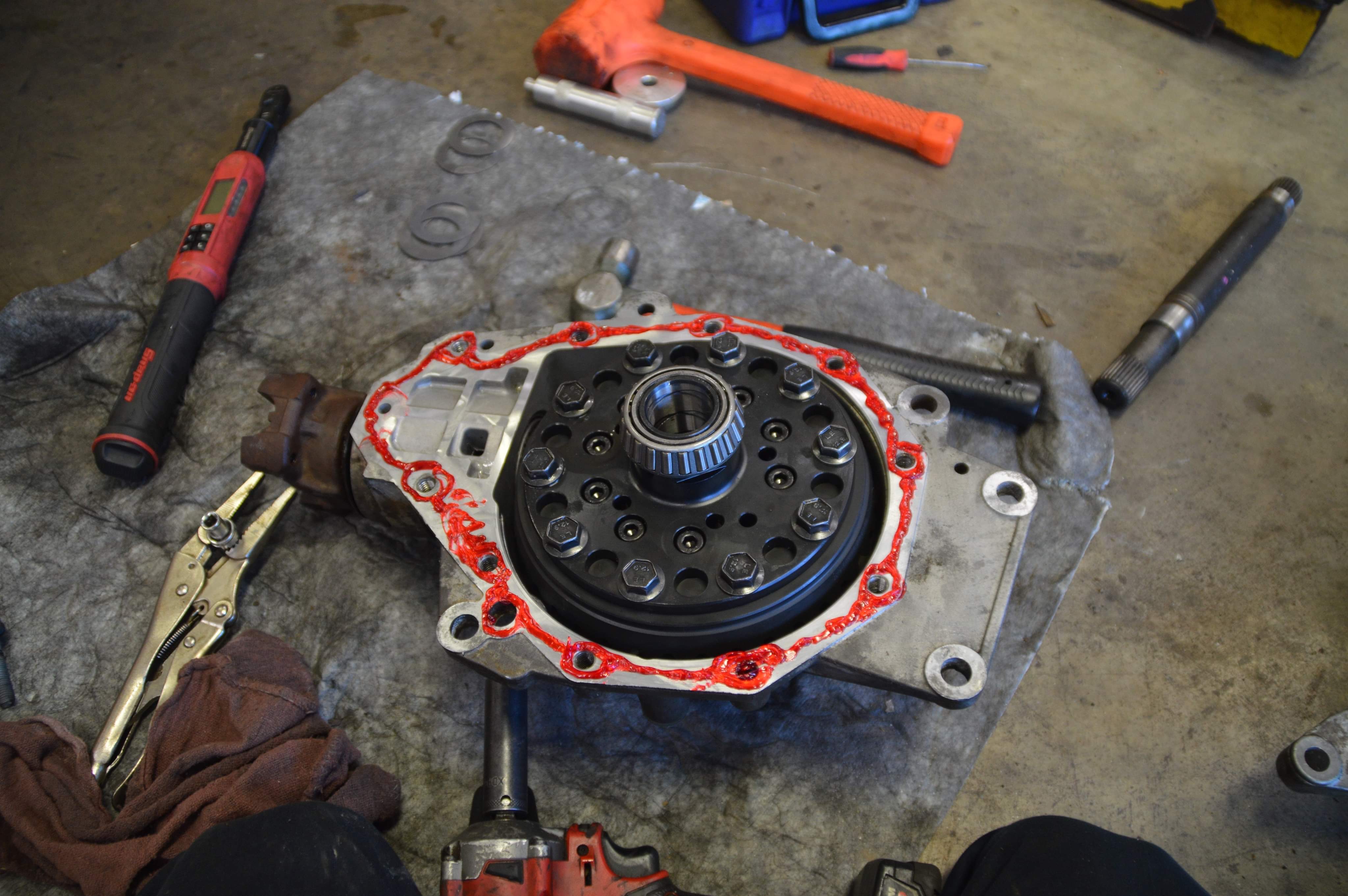

I got a good promotion at work, so as treat to myself for all the hard work. I bought a front 7.2" LSD from Bully Racing, new 4.10 gears, a master rebuild kit and shipped them along with my old 3.42 front diff down to my buddy dvanbramer88 to set up for me.

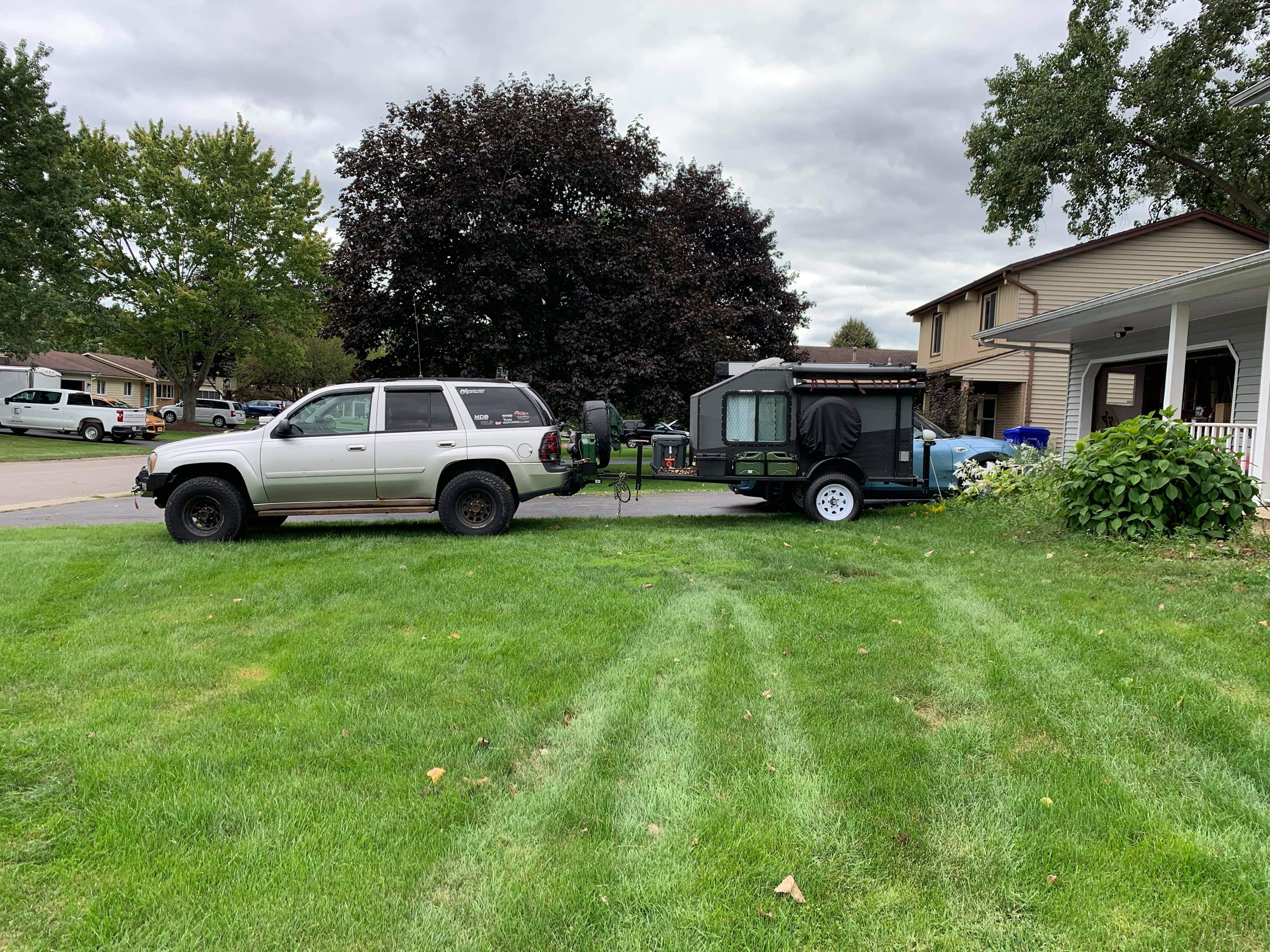

In March 2021 I bough two person square drop camper and June of 2021 just before the crazy high prices of cars I bought a 2017 Mini Cooper Clubman S All :drive: . So now the old TB is now in full time adventure status. :flex dirty: :camping: :safari:
