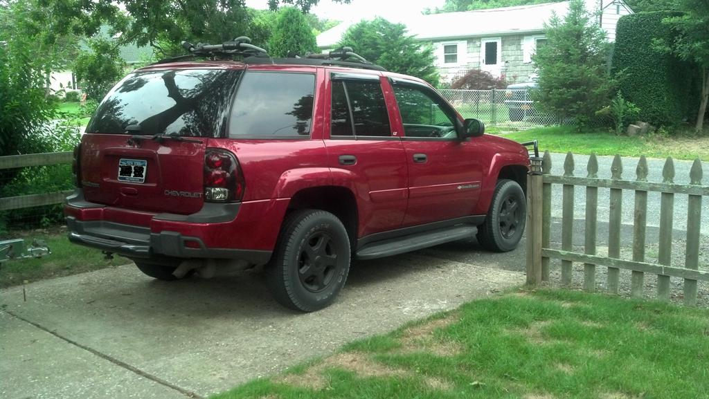

2003 Chevy Trailblazer LT 4x4
Drivetrain Specs:
3.73 (no G80)
Suspension Modifications:
Mark’s 2.5” Lift
Bilstein HD Struts
Moog Front Sway Bar Links
Rear Sway Bar Delete
Exterior Modifications:
Plasti Dipped: Emblems, Stock 16” Wheels
Brush Guard
Rear Hitch Guard
Dual Kayak Roof Racks
Window Vent Guards
Engine Modifications:
Trans Go Shift Kit
Corvette Servo
ATP 111002 4x4 Axle Disconnect
Interior Modifications:
None
Recovery Equipment:
10 ft Chain
20 ft Rope
Portable Air Compressor
Electrical Modifications:
6000K Low Beam HID
3000K Fog HID
Quad Beam Mod
- Attachments

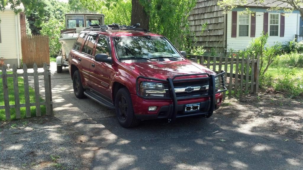

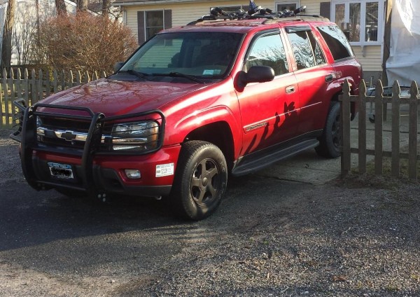

These are before and after pictures of Mark's 2.5" lift. Unfortunately I don't have install pictures.
Before:
Driver Front 33"
Driver Rear 34"
Passenger Front 32.5"
Passenger Rear 34"
After:
Driver Front 36"
Driver Rear 36"
Passenger Front 35.5"
Passenger Rear 36"
Total Lift:
Driver Front 3"
Driver Rear 2"
Passenger Front 3"
Passenger Rear 2"

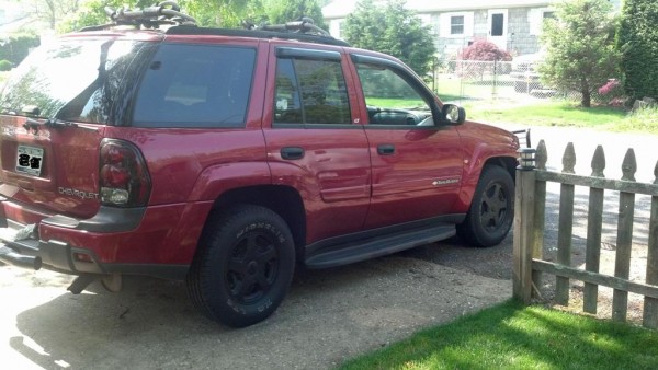

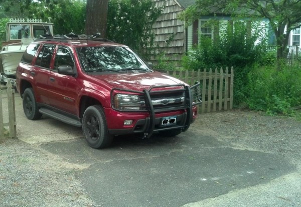

Here is some more pictures on the lift difference.

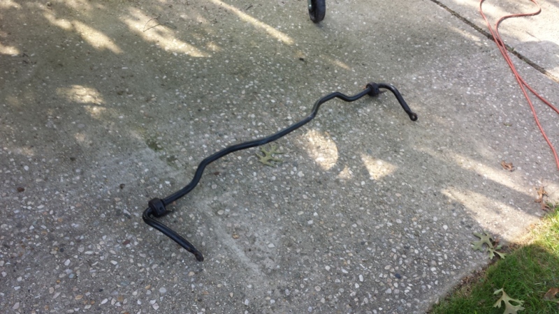

by c0a8l0v6i8n9 » Tue Dec 03, 2013 3:47 pm

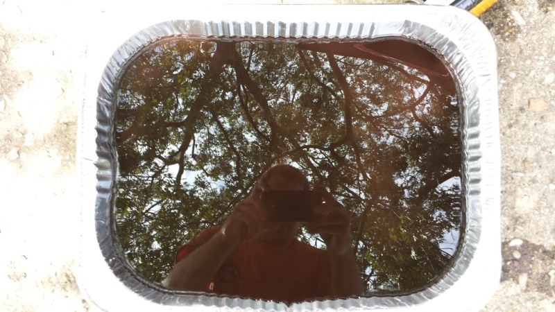

Sway bar delete and my transmission fluid from the pan drop to install the shift kit and corvette servo
![Facepalm :facepalm:](./images/smilies/facepalm.gif)
thank you previous owner
