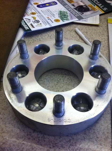

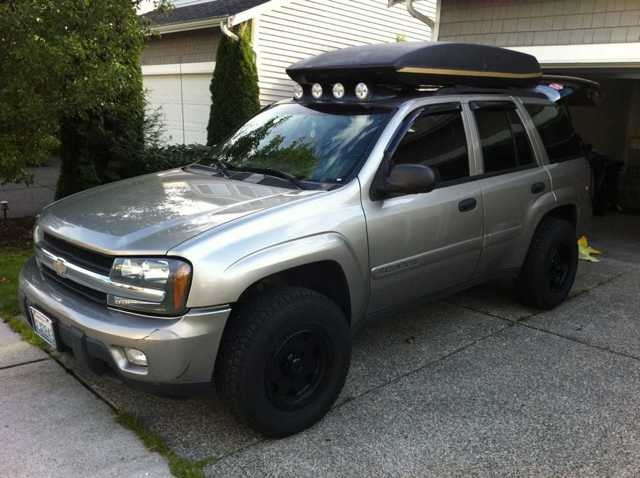

What started it all was the light bar I found on Amazon. I then got the Packasport from Craigslist for next to nothing, I felt like I was taking advantage of the kid,but he assured me it was the price he wanted. Then came the wheels, also from Craigslist. They originally were steel, so I took them to Seattle Powder Coat where they did an amazing job turning them black. I then got 1.5" inch wheel spacers with the right bolt pattern conversion to fit them on.
5 on 5 to 5 on 6.5

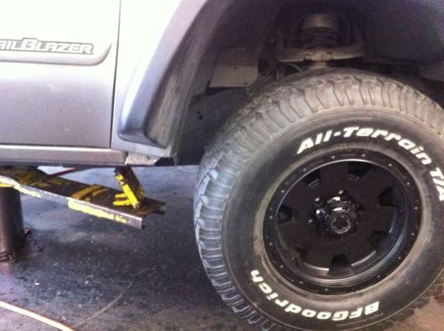

Then came the Mark Mc's 3" Leveling Kit. I got the tires off Craigslist...BF Goodrich TA/KO 285/75-16

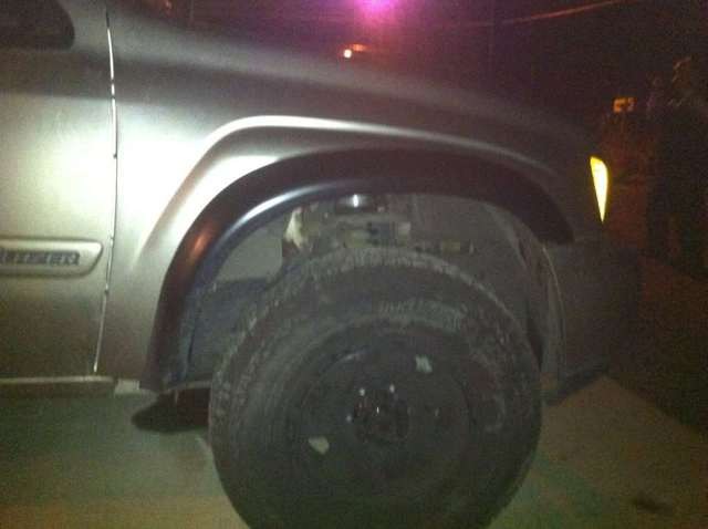

These are Bushmaster Cut Away fender Flare's which I had put on originally because when I was looking for the bolt-on which I have now, I was unfortunately mislead to believe that these were supposed to be what I actually wanted. So I put these on the front only for most of the winter.

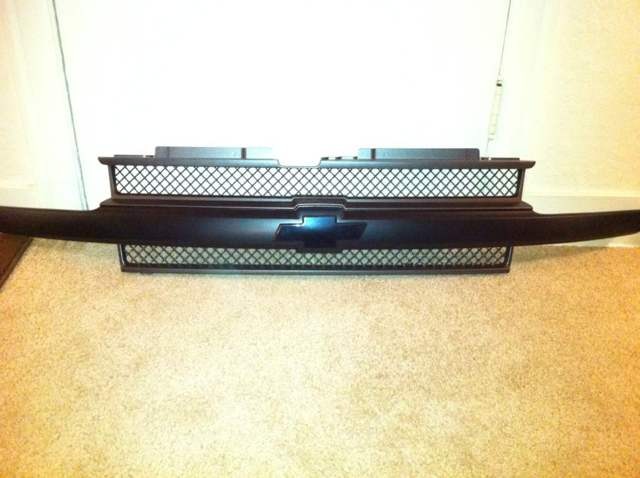

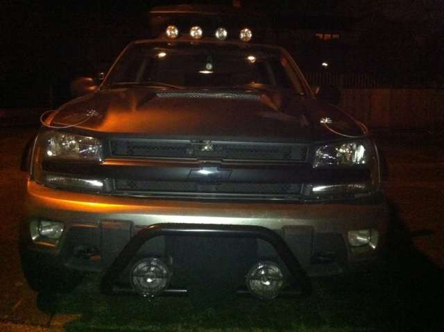

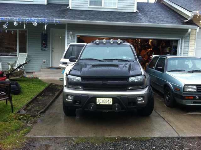

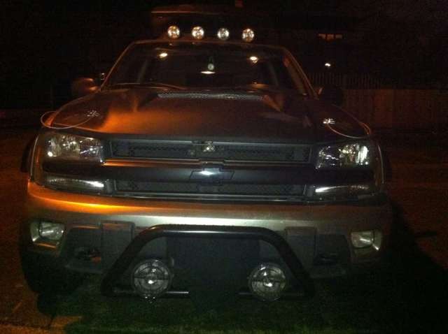

Westin Bull Bar and Hella Black Magic 500 Lights
2002-2006 Cheverolet Trailblazer Blacked out Mesh Front Grill

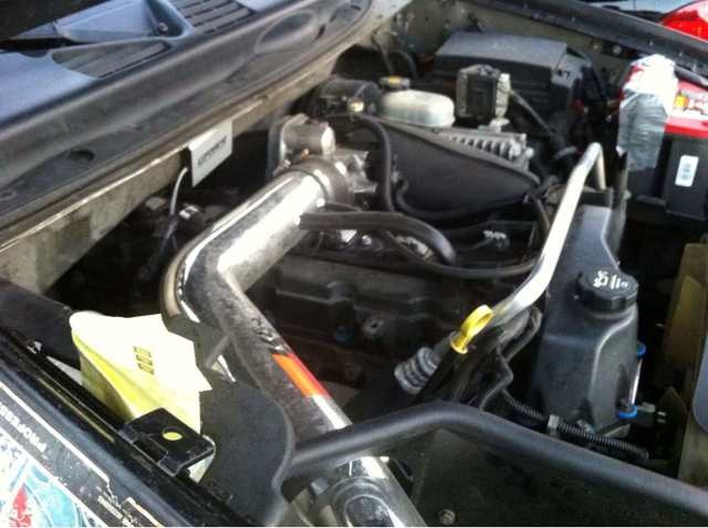

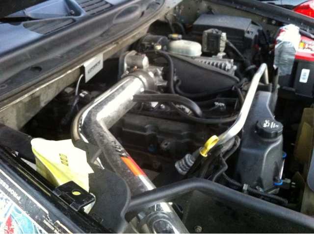

K&N 77 Series Intake.

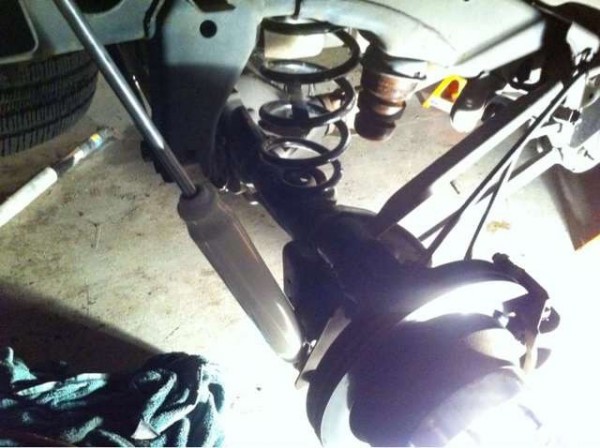

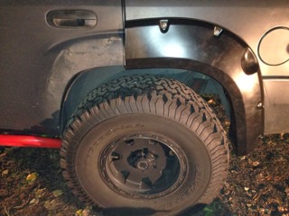

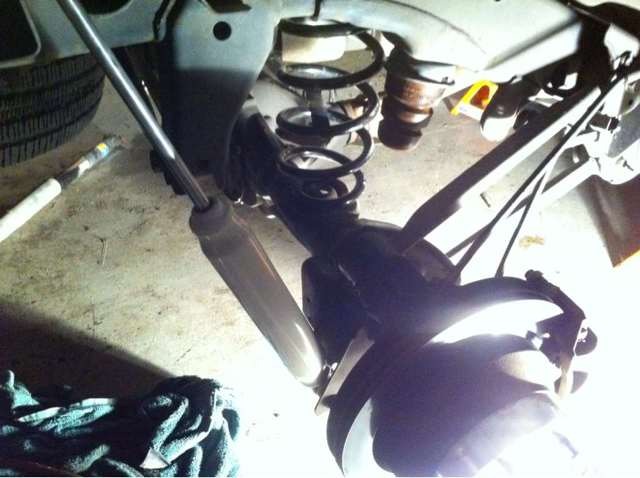

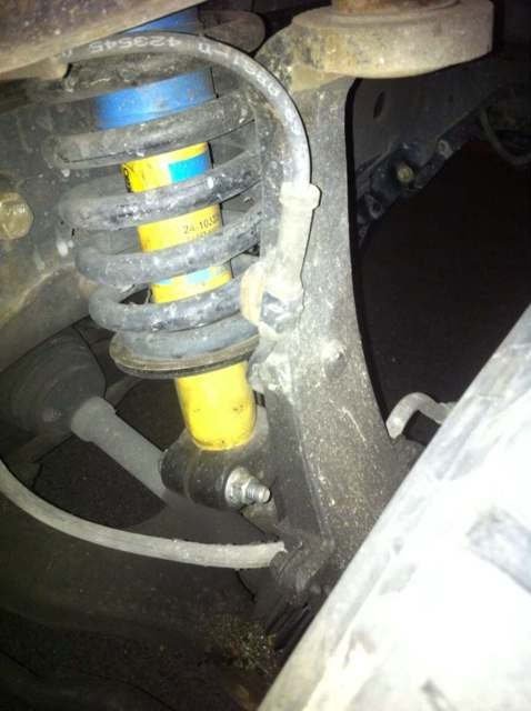

Replaced the rear springs with Z71 Coils and put the rear springs in front with Billstein's HD Strut's. The Z71 Springs are paired with Procomp 9000 Series Shocks.
I eventually was able to get ahold of the correct fender flares I wanted in the first place. They are called the BUSHWACKER* Bolt-on Cut Away for late 90's - early 2000's model Jeep Cherokee.
*(I just realized that twice earlier I was calling the fender flares by the wrong name. So please note that I stand corrected and that the fender flare company I purchased from is named BUSHWACKER not Bushmaster.)

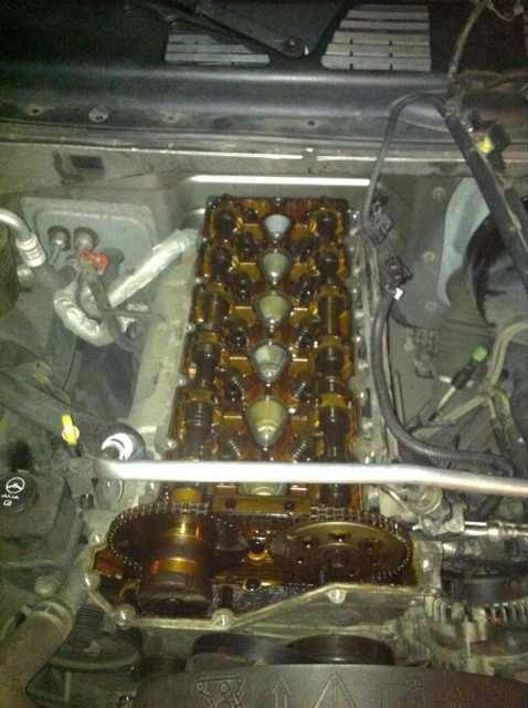

Replacing Gaskets

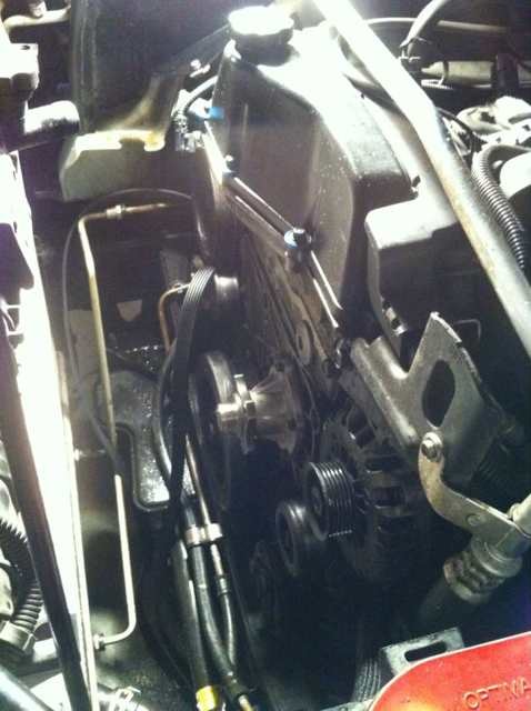

The water pump went out and was leaking like a faucet. This is a picture of the new water pump I installed.

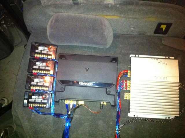

I already had 2 Kenwood 10" Subs. With 1000w Kenwood amp. This is a picture of the 4 crossovers and 720w amp I installed for the MB Quart component speakers I put in each door. Let me tell you...my TB sounds absolutely amazing!!! The clarity is like nothing I've heard before...

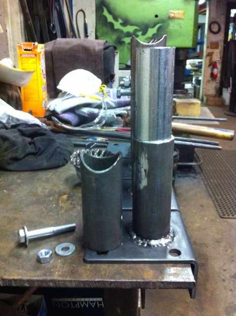

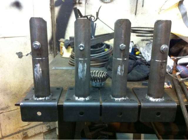

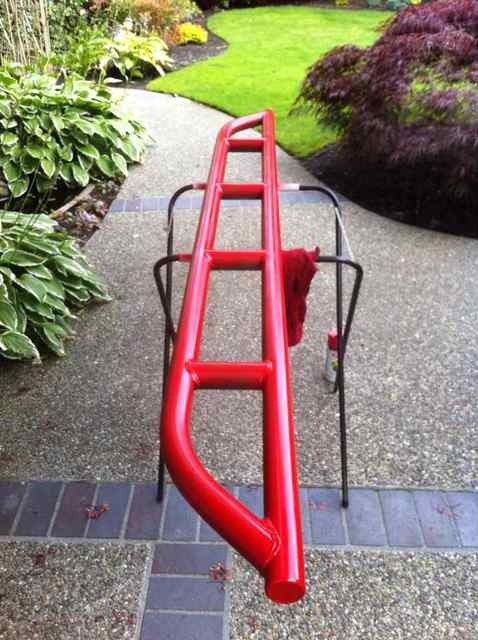

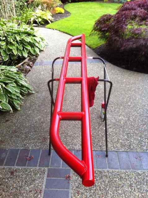

Rock Slider Bars from Trail Gear. I painted them red to add a pop of color.
We actually cut the mounting bars in half and sleeved them so that they could be removed easily if needed the sleeves are extremely strong which add additional strength to the bars in case of heavy banging around when out on the trails.

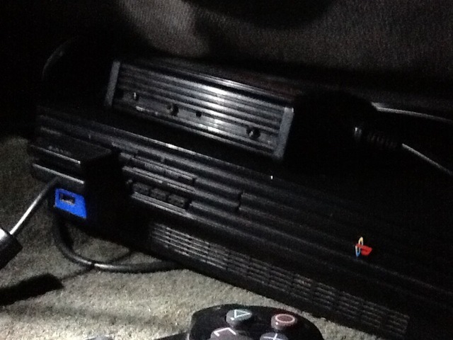

by charliesrobinson » Sat Dec 01, 2012 7:52 am

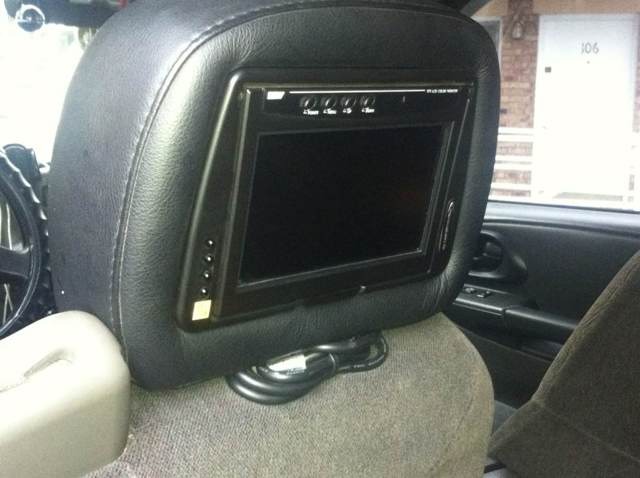

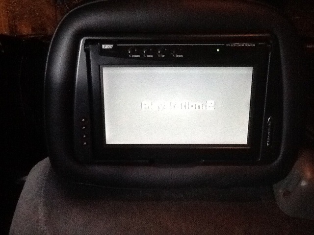

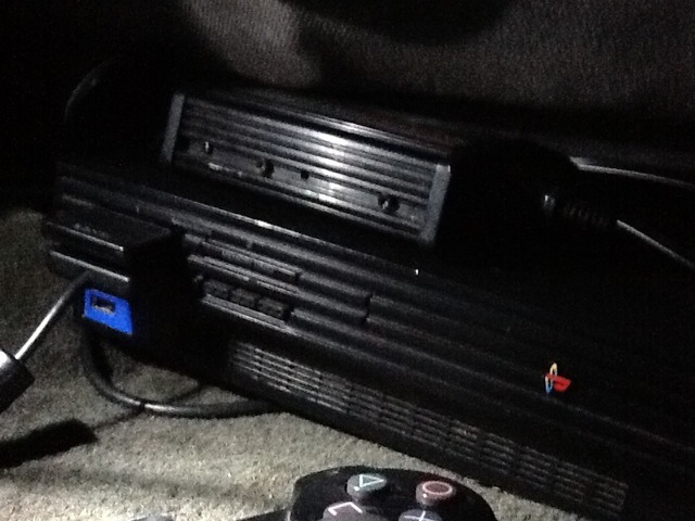

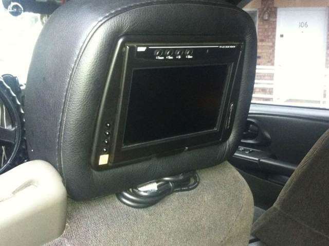

In addition to the speakers I installed or I should actually say took the OEM headrests out and put in the new ones with monitors. I ran an RCA to my Jensen head unit so movies can be played on all 3monitors. Otherwise in the back seat you can watch you own film or play games on the PS2 I installed under the passenger seat.

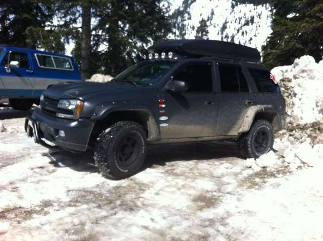

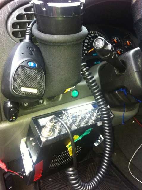

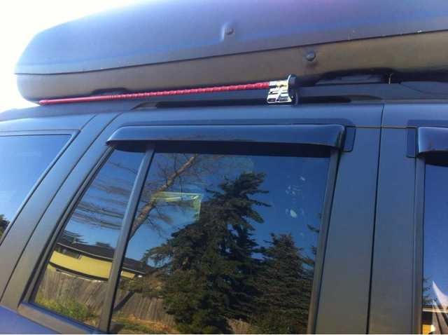

I got a Cobra 29Ltd Bluetooth CB which I installed underneath the steering wheel on the door side.
I toyed with a number of different mounting locations for the dual antenna. A good friend gave me the idea to place them horizontally attached to the roof rack rail...Thanks E!!!

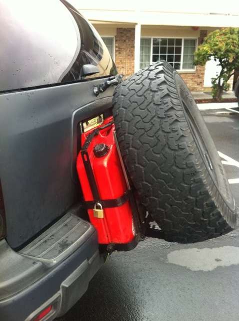

I've purchased a Curt hitch mount spare tire carrier. Next on my list it to modify it to put a hinge so I can open the gate. As for not the pair of 5gallon gas cans sit perfectly on the step while being wedged in by the spare tire.

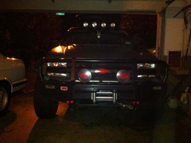

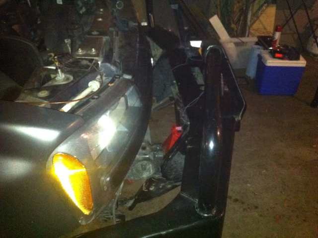

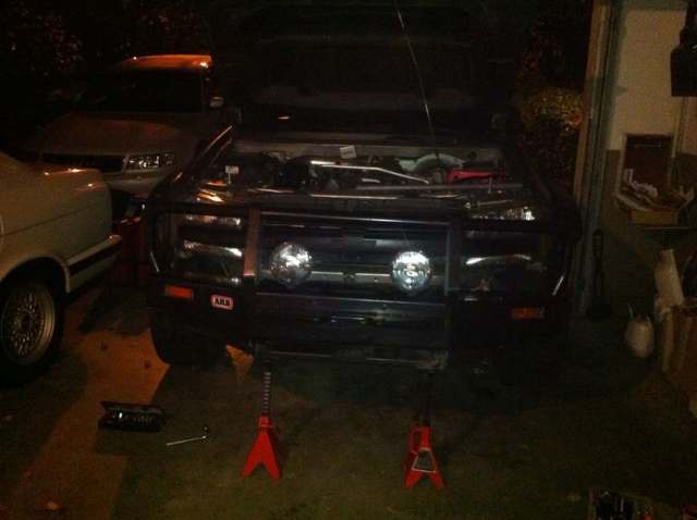

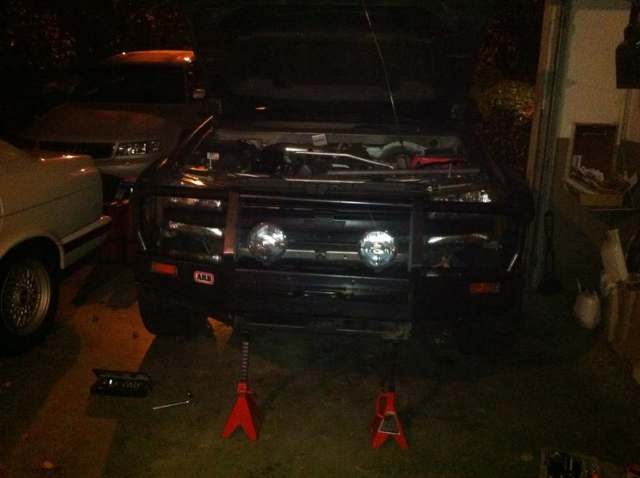

The last thing I have done, better yet most recently is a new front bumper. I got a screaming deal off my favorite place, Craigslist for an ARB winch mount bumper. Which let me tell you. I have had to do some serious cutting, drilling, screwing and a little bleeding to get it on so that it didn't look completely wrong and out of place.
I was able to find a Warn winch from Craigslist as well.

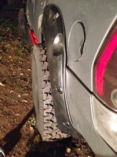

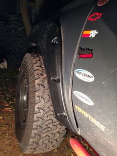

by charliesrobinson » Tue Feb 17, 2015 2:25 am
Changed Fender Flares a little while ago. Here is some detailed info about them. Bushwacker Pocket Style Fender Flares. Part # 40937-02. You only have to make minor adjustments to the rear at the door split. Otherwise they fit near perfect.
