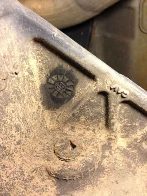

What year and model do you have? If you have a 8.0 rear end then there is really no easy way to get a aftermarket locker other than swap out rear end for a EXT or SS because they have a 8.5 more options. More experienced TB owners please chime in if got it wrong.
You can confirm if you a 8.0 by looking at your rear diff near the fill plug. If your 's is 06 or older going to have stay with a 06 or later rear ends because of anti locking breaks, etc.
