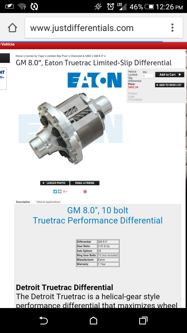

by Itsmytime9110 » Fri Sep 02, 2016 12:54 pm
I know this is a dead thread, but I'm having a hard time finding an 8.6 rear end. What are your opinions on a 8.0 LSD?

by mason10198 » Fri Sep 02, 2016 1:07 pm
Wait, do we have that option?
Sent from my SAMSUNG-SM-G870A using Tapatalk
by Itsmytime9110 » Fri Sep 02, 2016 1:28 pm
I think so, but I'm pretty new to all this....

by TBYODA » Sat Sep 03, 2016 3:41 pm
Itsmytime9110 wrote:I know this is a dead thread, but I'm having a hard time finding an 8.6 rear end. What are your opinions on a 8.0 LSD?
Look on www.car-part.com pick trailblazer EXT
