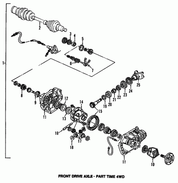

In the diagram, Number 22 is what I am talking about. It looks like it just slides in. Is it something that is pressed on or am I missing something? I apologize for my ignorance. Not sure why I couldn't take that out.

by v7guy » Thu May 21, 2015 1:16 am
It's pressed on to the pinion and rides on a replaceable race inside the case. To get it off you have to press the pinion out of the case, it's fun like that.
To top it all off there's two bearings, so even if you could pull that one out it's very likely the other one is fubar'd too... and who knows what the differential bearings look like. There's no quick fix for this one.
