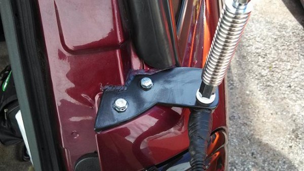

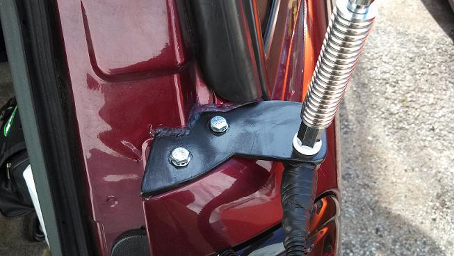

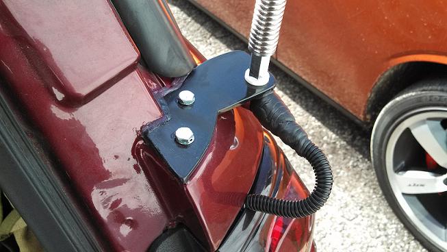

Got the CB put in. Just wanted to get the pics up. Not much time as Im getting ready to leave work. I can answer any questions later.

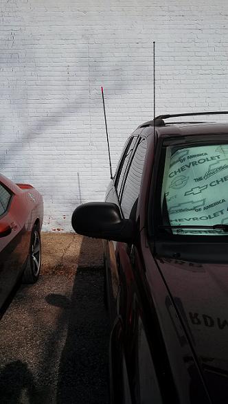

by Conner299 » Tue Jan 08, 2013 5:22 pm
:cheers:

by v7guy » Wed Jan 09, 2013 5:08 am
Looks real nice and it's different. I really dig it.
The angle the antenna sits at would bother the hell out of me.
by Conner299 » Wed Jan 09, 2013 7:31 am
Yeah... the antenna angle is definitely goofy. I kinda like it though. I may try to go back to it at a later date and try to straighten it up. I would normally be anal about something like that, but surprisingly it doesn't bother me.

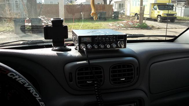

by Conner299 » Thu Jan 17, 2013 10:03 am
Well... Just a little update on the install. The Ol' Lady was definitely not pleased with the location of the CB mount. LOL. Said she would've rather had it somewhere below the dash. Go figure. Good thing I used the velcro command strips. Makes removal and putting it back in pretty easy. Says she wont even ride in the Blazer unless I take it down. Hmm... Maybe I have finally found found a way to keep her out of it. Second, there is a nice, low pitched whistle from the mount itself. Usually happens at speeds above 35 mph. With the radio going, it is barely noticeable, though. Other than that, everything works flawlessly. SWR's are really good. The needle doesn't move off of 1 on channel 20, and only gets up to about 1.2ish on channels 1 and 40. Still waiting on a part to do the "dead-key" mod, and turned the wattage up already via the VR4 adjustment pot inside the radio. I have even taken a couple phone calls with the bluetooth function and I love it. Overall, very pleased. Big thanks to my install team consisting of the brother-in-law, and a my buddy, Grady.

by Conner299 » Thu Jan 17, 2013 10:24 am
I'm 99% that it is coming from the mount. The plate already has a few degrees of up angle, and combine that with the wind funneling between the body and the antenna mount.

by Conner299 » Fri Sep 13, 2013 11:02 am
Just wanted to throw out a little update/review of my CB set-up. Overall. the system is working really well. Two things aren't, though. First, the mount for the CB. I used 3M Command "velcro" strips to make it removable. Well, this made it removable, at times I didn't want. When I installed it, in the winter, they worked great. Once warm weather came along, small bumbs would make it start coming apart. At one time, while taking a turn, it started sliding across the dash. The sound of it coming apart, over bumbs, was annoying as well. I blame this on the strips warming up. When they were cold, they were stiff enough to hold to each other. Not so with summer temps. I have since removed these, and put in regular Command strips. When I removed the velcro, there was no damage to the dash, which is why I chose these to begin with. The regular Command strips have been holding great throughout the summer.
Second, I'm still having troubles with the mounting for the microphone. I have tried the velcro Command strips, and automotive double-sided tape. The velcro couldn't handle the weight, and the double-sided wants to keep coming clean off the dash, with the summer heat. Right now, the microphone resides in the driver side cupholder, and looks like it will for a while. Just for reference, I had it mounted next to the driver side center air vent.
Long story short: I recommend the regular command strips, when you need to keep something in place, and there is not too much load. I have five strips keeping my CB in place, and they are working well. I don't reccomend the velcro strips(black in color) for anything. I'm still brainstorming on how to keep my mic in place, without making holes.
