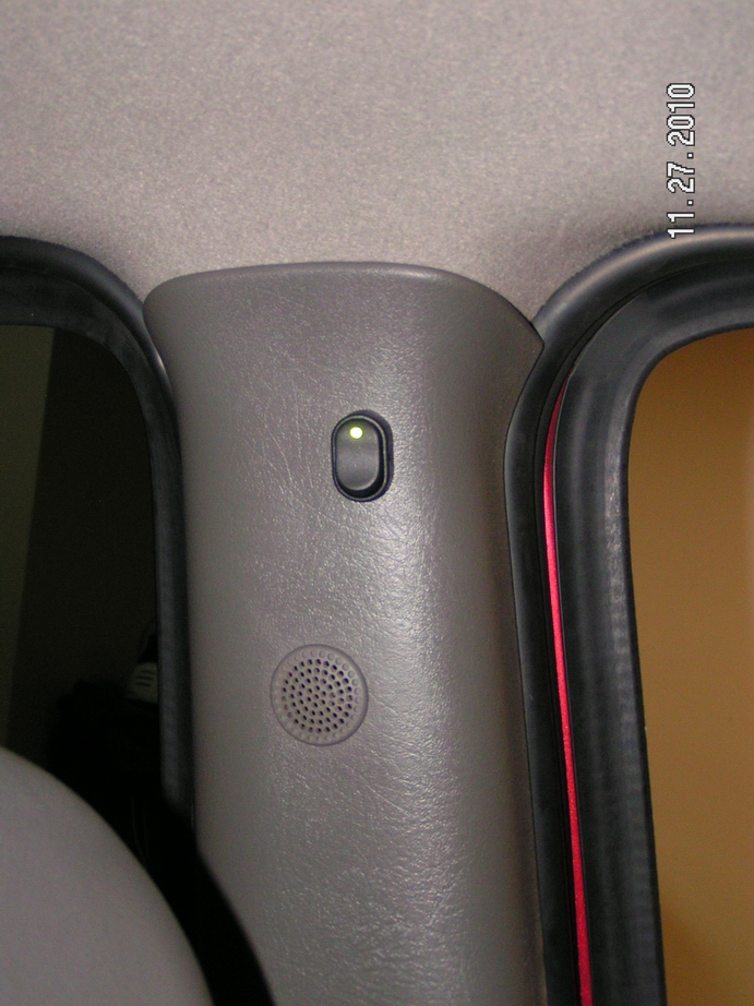

I also got the # 6303 add on switch which I mounted here:
That not only made running the wiring easier but it's easily accessible from the outside of the vehicle while facing rearward with the window open. It's wired so it'll turn them on even with the vehicle off.
So if I'm in the mountains shooting until dark or any other activity which needs cleanup behind the vehicle at the end of the day, I can just reach in and switch them on.
